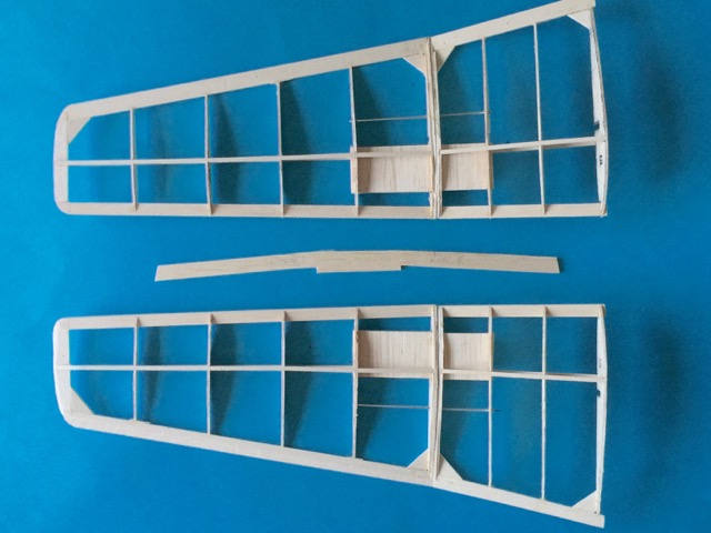

11 Jun 2017 18:58 #52 by Ex-Member
Replied by Ex-Member on topic 150% KK Fairey Gannet for FF Rubber Power
I can't believe it's six months since I last did any work on this one! Either way, it's time to get it into the air.
The tail feathers are just about ready to cover, the fuselage needs sanding:
One wing has been partially sanded, the other needs work.

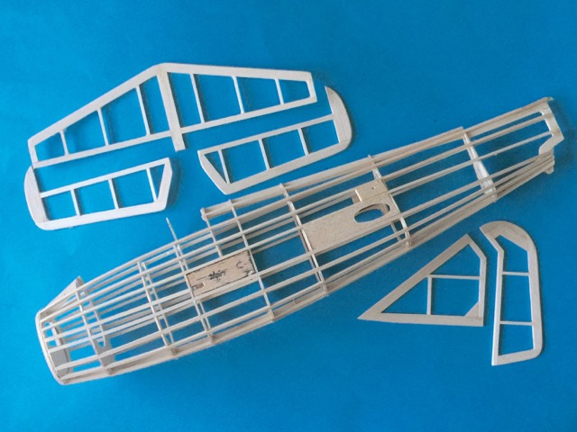

16 Jun 2017 11:02 #58 by Ex-Member
Time to get back 'on-topic'!
The fuselage progresses with work around the nose area, addition of a main spar, some lands added for the tissue covering and a lot of sanding:
The tail group has been sanded and separated and is ready to cover:
16 Jun 2017 11:07 #59 by martynk
Replied by martynk on topic 150% KK Fairey Gannet for FF Rubber Power
I had to look twice, you mixed up the right elevator and rudder.. :)
Thanks: Ex-Member, boz
16 Jun 2017 11:11 #60 by Ex-Member
I wondered if anyone would notice that!
Well done Martyn, very quick response too.... ;) ;) :lol:
