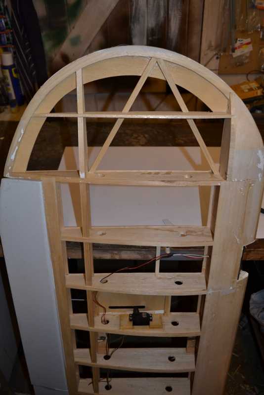

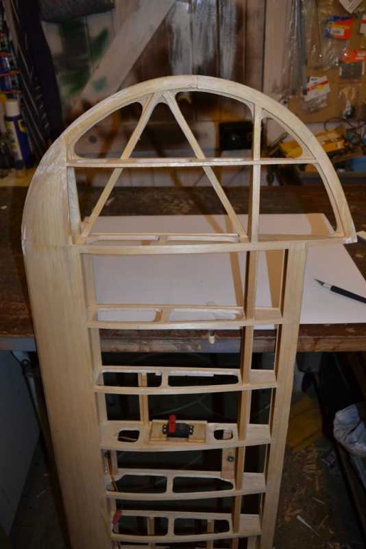

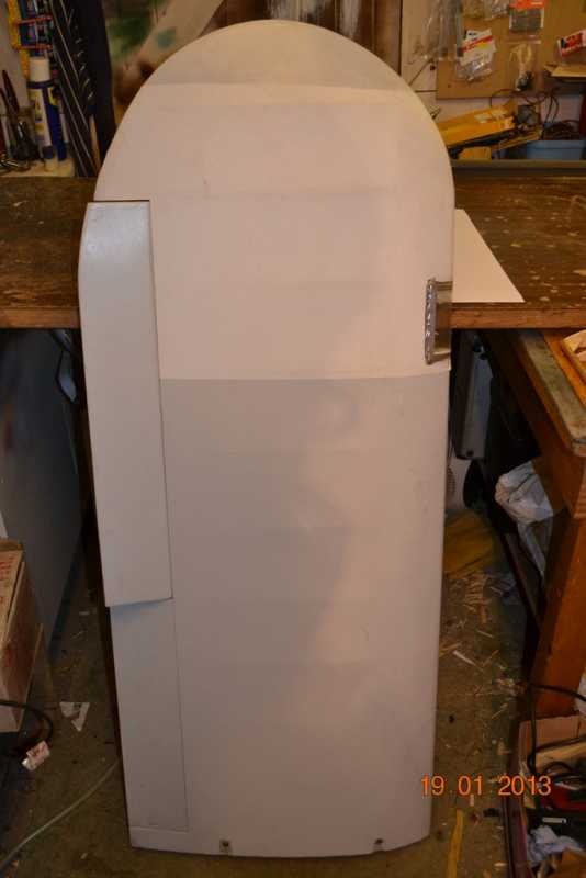

one of the objectives of this refurb is to put the tripacer on a diet, so wings first, here is a wing panel pre any work
here is the same wing panel naked
next post i start the work

this is the other wing panel after a bit of work, the problem with this plane is that all the wood is solid sheet/blocks everywhere so the aim is to remove all unwanted tree
Attachment DSC_0016.JPG not found
Attachment DSC_0018.JPG not found
since the photo,s were taken and the work done i have had another rethink on the wing particularly the wing tips and i will be making new ones compleatly from the last full rib it will be replaced with an alluminium tube outline and a light ply rib to rplace the ply balsa and solid block at the LE

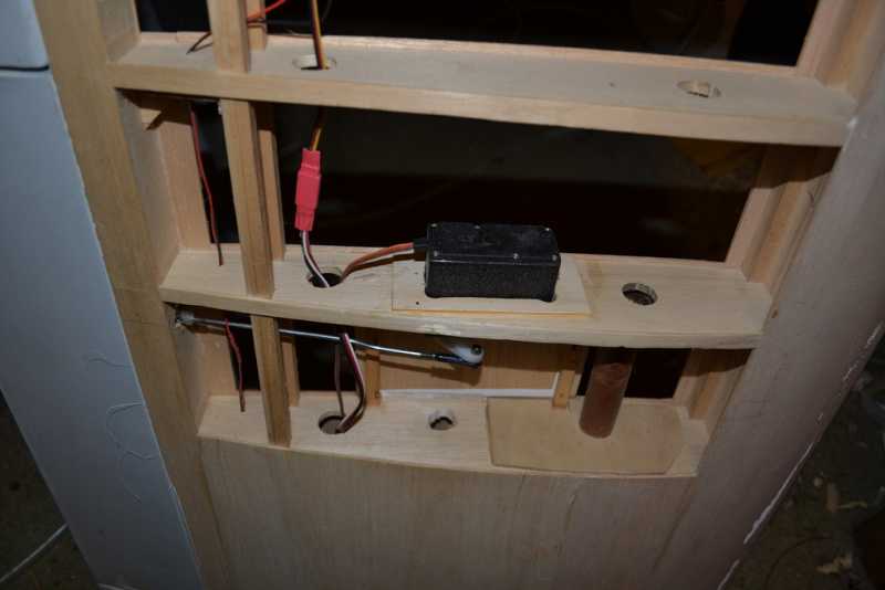

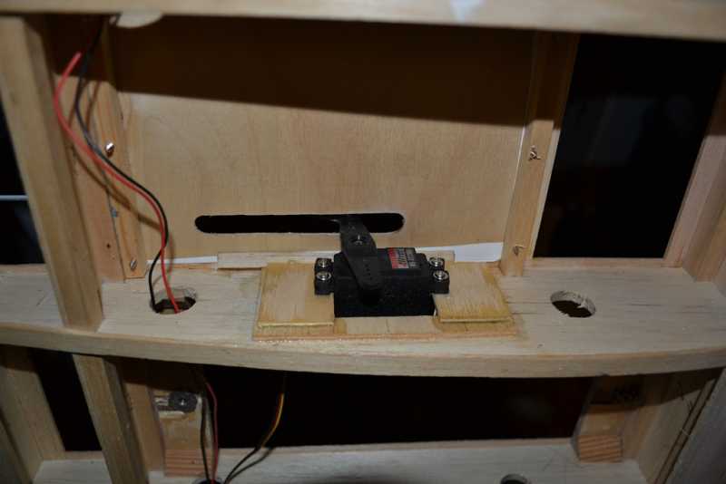

if you look closely on the wing panels you will see that the servo,s on the fretted out ones, have moved this is another tweak whilst work is being done to put them in a posistion to allow either fully internal linkages or semi internal so i dont have great big ugly holes in the under surface, i will be CNC cutting some new aileron and elevator control horns from GRP sheet soon to give the right angles to get full movement especially on the flaps.
old pos,ns
Attachment DSC_0017.JPG not found
new
to be honest you cant tell the servos have moved in the pics cos its only a few mm to get them into centre of ribs, just me being piccy, but i have moved em honest.
