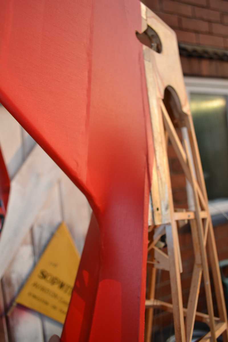

this just shows the back of the fus where it fairs into the fin, on the real one the fairing is just fabric, so thats what i have attempted to reproduce on the model, solar tex is attached to the fus and fin LE as well as the TE and the first "rib" up from the base, you have to do this whilst warming it a bit here and there to get it to stretch and shape to all the odd angles, then with careful use of a heat gun the fabric is slowly shrunk so it pulls to a natural curve, had to do one side twice first time looked like it had been covered in a crisp packet,

now that looks very nice.
love the way you molded the fabric round the fin to fuselage joint.

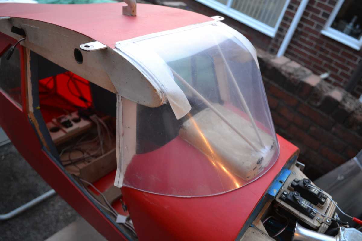

first up is the finished template for the windscreen made from firstly several pieces of card to get the shape of individual parts of screen ie around the wing root then all stuck together and a complete shape cut and fitted and trimmed and refitted till it well fit!!
then two of the fitting of the screen
here you can see the masking tape around the edges and the pencil marks for the hole pos,ns for the fixing screws, size 00 x 3mm self tappers,
finally one from the front which shows it fitted albeit temporarily as it will be fitted with an alluminium frame once all is painted
chris

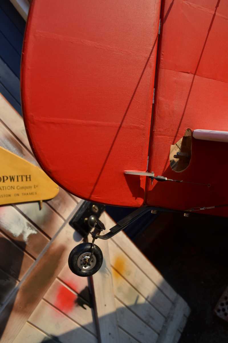

tailplane rigging is double what is on the real one to allow for the removeable tailplanes to be locked in place by it and to give some protection to the elevators and rudder from the tow cable, its carbon fibre rod and 2mm clevises and extenders, will be clad in heat shrink when finally at the correct settings
tailwheel is a commercial sprung unit,
just needs the bracket on rudder bottom cables and springs,
a quick look into fus at the rudder servo and RX installation, elevator servos are above the rudder servo in another tray on fus centre line
