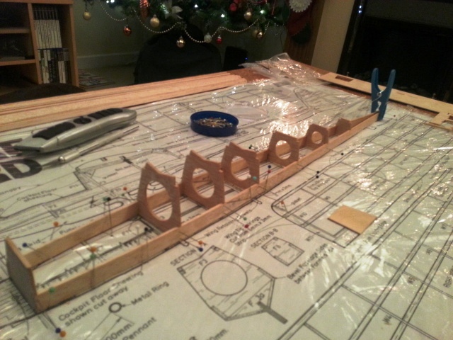

First expletive of the night!!!!!!!!!!!
How the bloomin eck are you supposed to pin the formers upright whilst holding a 90 degree angle of wood at the same time???? arrhhh! run out of fingers, and it keeps falling over!
And I have a bouncy fusalage, what is the best way of pinning that to the board so it doesnt keep bouncin up, the balsa is only 4mm thick, dont want to risk splitting it by pinning it directly down through the balsa
Last edit: 16 Dec 2013 23:31 by Sarah-Jane Smith.

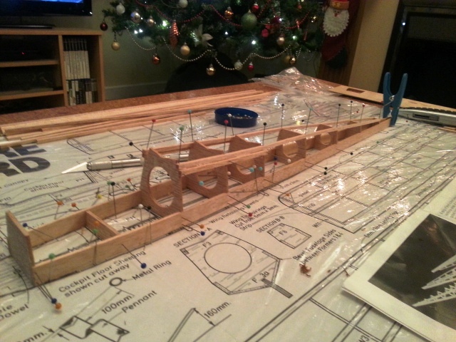

  • Sarah-Jane Smith's Avatar Topic Author
16 Dec 2013 23:51 #19 by Sarah-Jane Smith
Replied by Sarah-Jane Smith on topic D.P.R Rare Bird Sailplane
Lol.yeah as I add a former and curve the fuslage side around it- it pops up!!
Have beaten it, it looks like I have a pin fetish but oh well there are worse!! :lol:
formers F3, F5, F4,F6, F7, F8 and F9 all glued, checked to 90 degrees and pinned within an inch of their lives!! :woohoo:
Wayyyyyhaaaaaaaaaaaay!!! I like this!!!

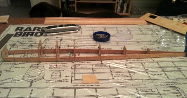

17 Dec 2013 00:36 #22 by Sarah-Jane Smith
F2 and F9 glued into place
2 x 10.2 cm lengths of 3mm x 3mm balsa cut to form the wing seat doublers across formers F3, F4 and F5
and 2 x 40 cm lengths of 3mm x 3mm cut to form the fuselage top longerons across formers F3-F9
little rascels did keep trying to pop out but am assuming the wee water on your wood effect would work on that too to make it a bit more pliable to bend with the curve
and voila, we now have a very large flat banana shaped fuselage woooooot!!!!!!!!!!!!!!

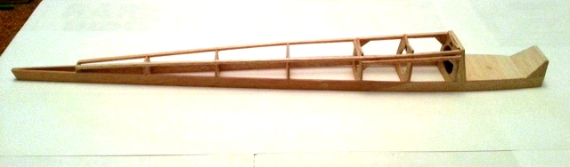

17 Dec 2013 19:42 - 17 Dec 2013 19:43 #30 by Sarah-Jane Smith
PMSL Would rather be a rare bird than an over cooked one!! :lol:
Ok loads of fiddly bits done today along with lots of sanding (have I mentioned I love sanding? :) )
