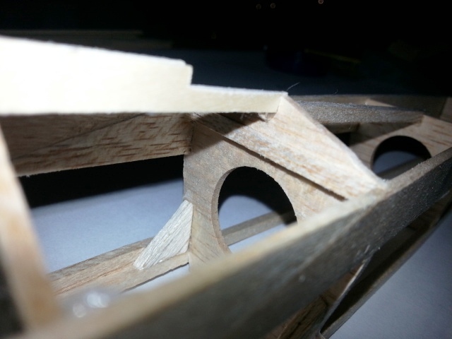

there were additions to be added to the formers when the plane was upside down each with a notch cut in for the towhook, these were all glued in place and the towhook glued into the notches.
Except slight smally problem at former F5, the tow hook was short by a midges........toenail!! Checked the fusalage to the plan, checked the length of the towhook as it came out of the dye cut wood=- all fine, just must have miscalculated when they made the kit but had an idea of making a smally ledge with some of the very light wood and glued this in place on the other side of the former so that the notched former for the towhook could be brought forward a tiny bit. Seems to have worked and am assuming as this is near the middle and the wings, shouldnt affect the weight etc much? Well I hope not lol, or will have to revise this!

Sarah-Jane Smith wrote: Reeeeeeeeeet, Fin done bloomin instructions a tad dodgy here!
F12, F13 and F14 ;are all marked, all face the same way.......oh nooooooooo they don't!! You will notice F12 is missing (bottom left brace. Thats because the makers had printed the number on the wrong side!! Didnt notice until had glued it already lol but rescued, redone and another gusset (especially for Alan :kiss: :lol: ) inserted.
Strips for the uprights and cross members are from 3mm x 3mm
leading and trailing edge are 6mm x 3mm
The two uprights are NOT glued together, that is because I have to cut at the topand then hinge the rudder so it can be adjusted- although not sure how, the two small metal flat plates in the box ...erm..... no idea how to attach? wondered if was meant to bend them around the wood?
Can we have a pic of these plates please, they sound like hinges ??? If so the do NOT wrap round the edges

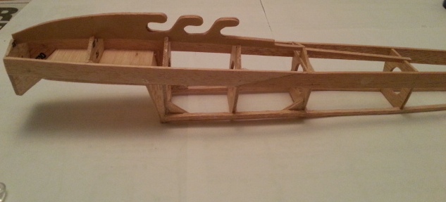

Fuselage edges bevelled as well as the 2 pieces of 1.5mm fuselage bottom sheeting. After getting these to fit, with a bit of reshaping, bevelled the straight edge so it would fit against the towhook and these were then glued and pinned.
Nose block added and loads of sanding which was really satisfying watching it all take shape, and am really chuffed for my first time :) :) :)
Bit more sanding to do to make sure all is nice and rounded/flush and possibly a bit of filler? Dunno, what do you think guys- I am a bit of a neat freak and perfectionist so would like it to be completely smooth and but am I being too finicky?

Just looking at the wood and the construction I'd say this bird is going to be quite heavy, in terms of oz/sq ft.
