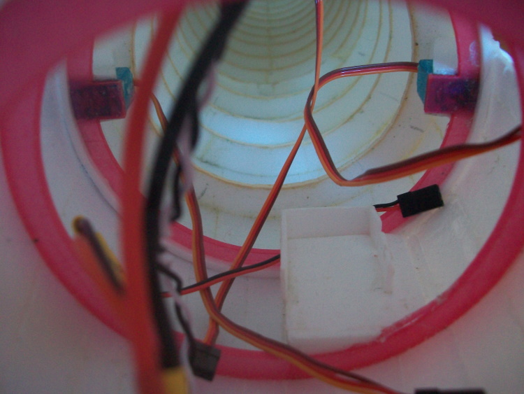

As the V-2 is a stressed skin skin structure you just have to accept it requires a big but temporary hole to be cut to get something like the rx in and coupled up.
The ESC is mounted close to the top skin to be as far away as possible from the rx which will be mounted low down.
A view inside looking back through what will be the battery hatch.
3 servo wires, a power wire from the BEC and throttle from the ESC to be connected.
The stab rx is neat enough but it requires the usual trial and error roundabout of servo connection and Tx 'reverse' to not only get the controls (elevon and rudder) to work in the correct sense but also that the stab action works in opposition to an external influence. Get it wrong at your peril!
Ultimately the only rx 'hatch' will be small one directly over the gyro gains so they can be adjusted with a long screw driver. ;)
