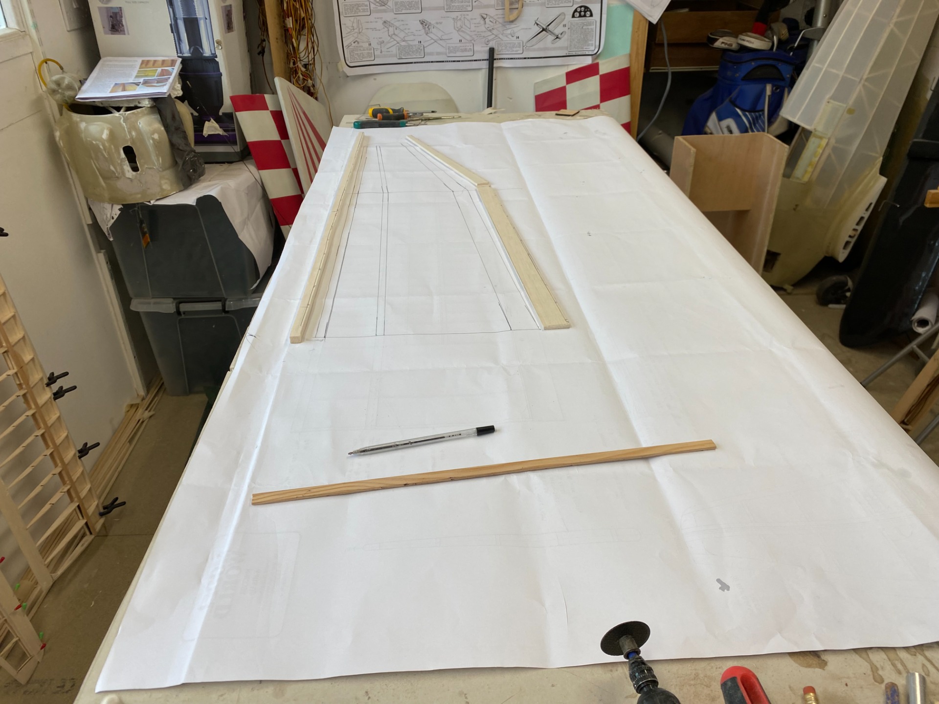

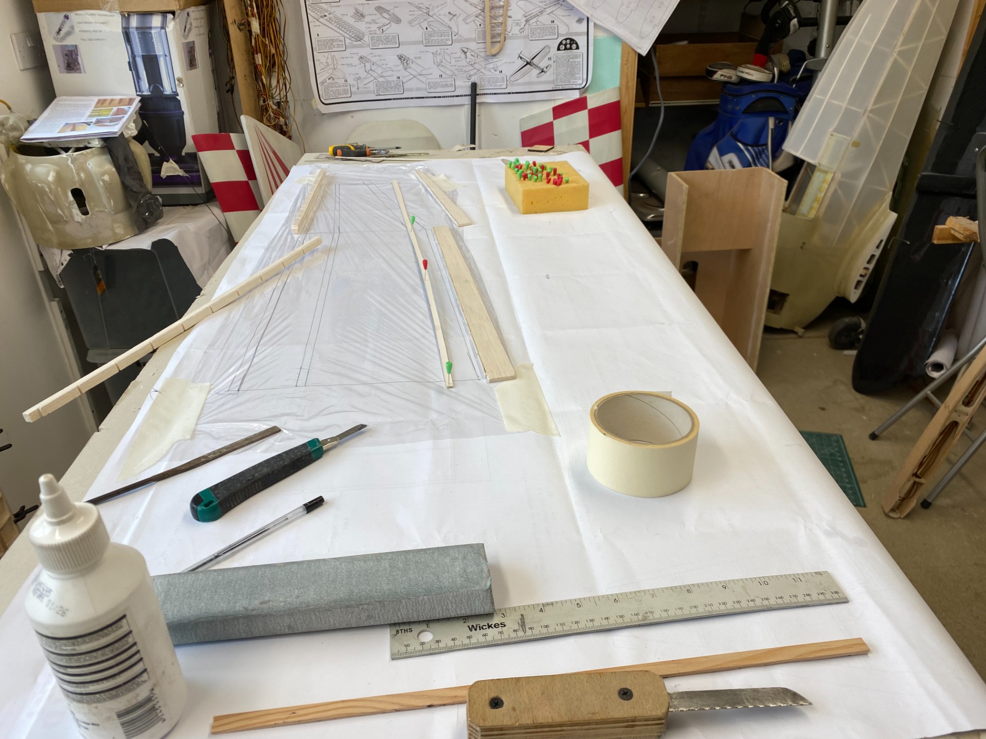

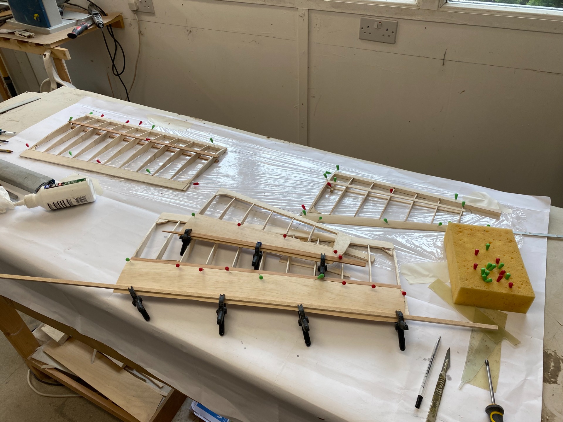

Just to catch up on the build as it has progressed a little bit

25 Apr 2025 03:45 #25 by THE BLACKBIRD
Replied by THE BLACKBIRD on topic ASW 17 Sailplane
Klippy the new outer panels will be flat like the middle panel

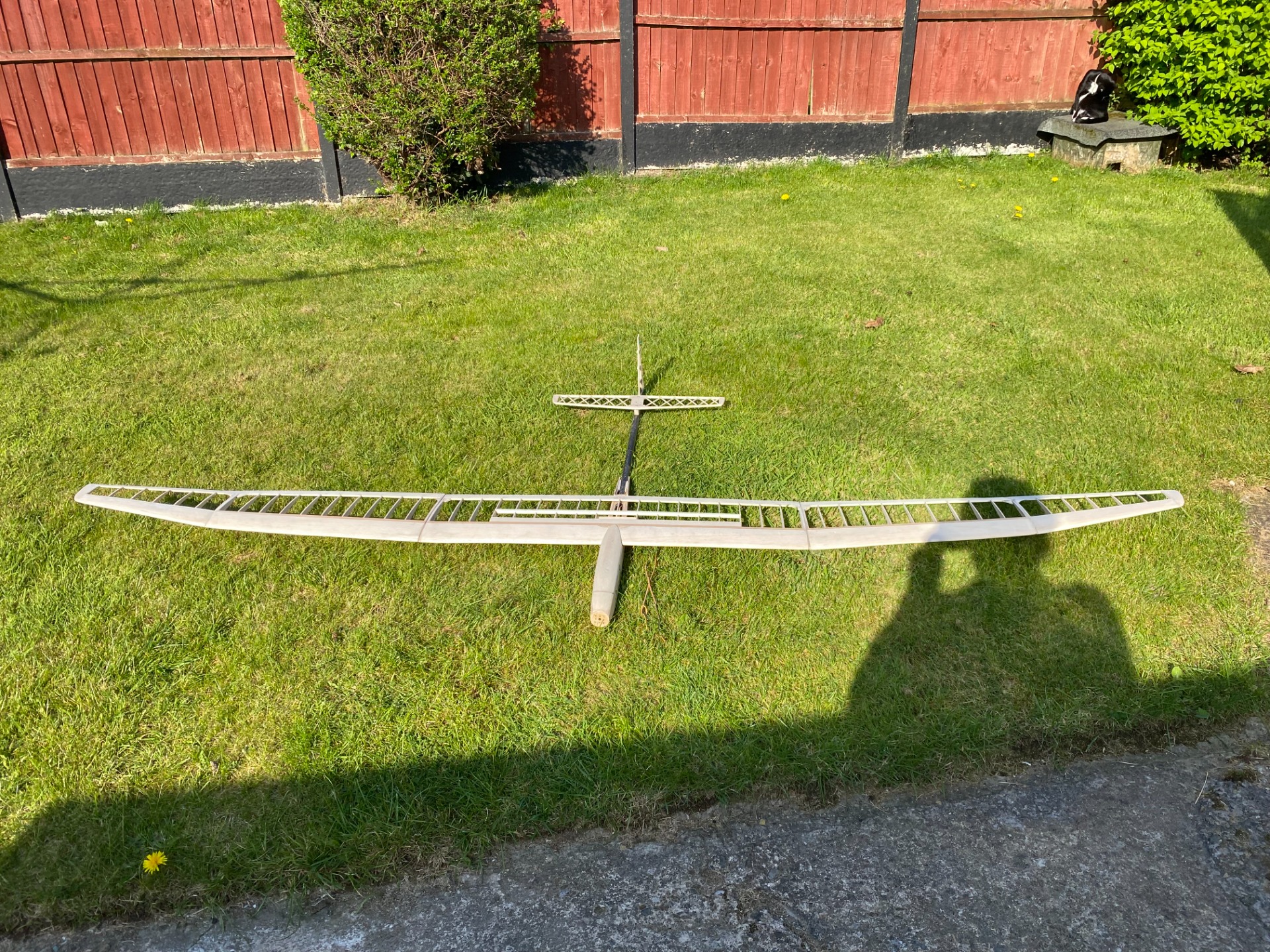

26 Apr 2025 11:46 - 26 Apr 2025 11:50 #26 by THE BLACKBIRD
Just about got it built

And it has loaded this one

26 Apr 2025 11:54 #27 by Klipkopwildlife
Replied by Klipkopwildlife on topic ASW 17 Sailplane
A lot depends on the amount of content in the picture, Windows has a very good Image Resizer which I use all the time. Otherwise looking very good.
