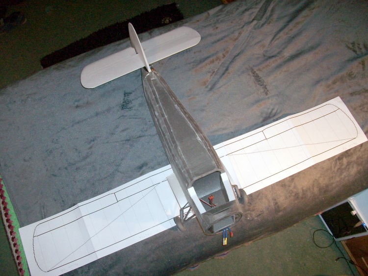

04 Apr 2013 11:17 #6 by Quorneng
Replied by Quorneng on topic A tiny scale plane
Well I have problem :ohmy:
I have tile printed the full plan to a 28" span and it all looks very nice but there is no way the resulting plane would be adequately powered by those particular tiny brushed motors or even look sensible. :huh:
There are some options:-
I could make it smaller, it would have to come down to about 20" span, but as the overall weight would still be similar it might not even fly at all.
Or
I could use brush less motors but the whole point of the exercise was to use the brushed ones!
Or
I could build a simple non scale plane to use the brushed motors.
On reflection I think this is what I will do.
But
The Cessna O2 is a very nice subject and should give a stunning performance so it will be back! ;)

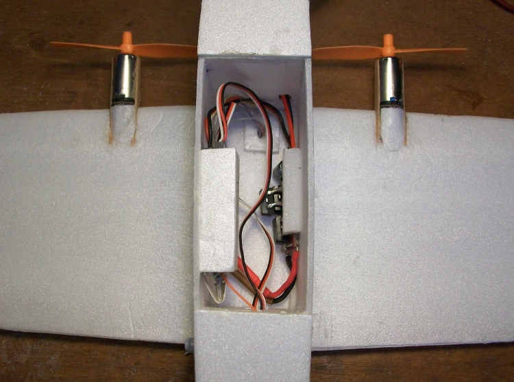

07 Apr 2013 20:13 - 07 Apr 2013 20:14 #11 by Quorneng
I did something very unusual today I destroyed two airframes! :woohoo:
I normally like to keep everything I make even if no longer flyable but my absolute lack of space meant I had to make some room. One was already stripped of bits but the other was completely flyable. :pinch:
There is now a pile of Depron bits in the bin!
However some of the leccy bits will go into the Twin Wren.
The rudder and elevator servos are mounted in exactly the same way as on the Wren - glued together to form a 'servo block' that fits exactly across the inside of the fuselage just behind the wing..
It looks like the Twin Wren will weigh about 1/2oz more than the single. Not too bad seeing as it has brushed motors. ;)

08 Apr 2013 17:43 - 08 Apr 2013 17:47 #12 by Quorneng
A first run of the motors restrained by a big chunk of lead. It makes quite an interesting noise. :P
The ESC and radio installed under the wing.
The final job is to position the battery to give the same CofG as the other Wren. ;)
