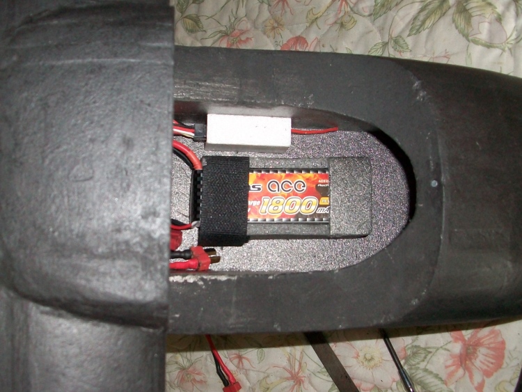

20 May 2013 17:02 - 20 May 2013 17:03 #64 by Quorneng
Replied by Quorneng on topic A tiny scale plane
Controls all connected up and battery mounted to give a 25% CofG (on the spar).
The radio box is white Depron so you can easily see the LED - which hopefully will not be flashing. ;)
Even without the bracing struts it easily passes my wing tip test so it is ready - but I am not sure I am. :ohmy:

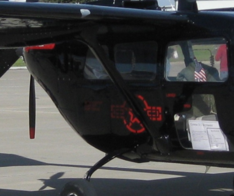

22 May 2013 20:23 #66 by Quorneng
The night version of the O-2 appeared to have a 'stencilled' USAF star in one colour - red.
This is the best detail I have found.
I have no idea if this will work but I am going to try and make a stencil.
Terribly fiddly to cut out. The one for the fuselage will be even smaller.

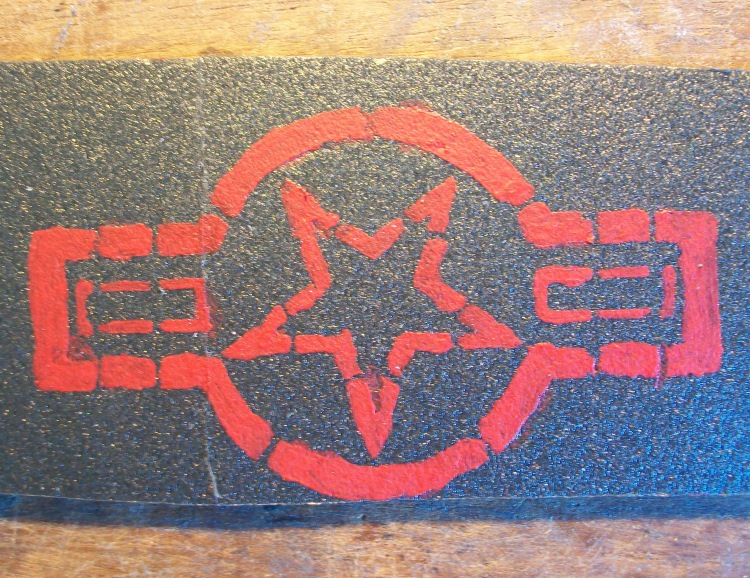

23 May 2013 15:54 #67 by Quorneng
My first experiment with the stencil using red emulsion and a stiff brush on a grey Depron test piece.
I was not entirely happy with both the quality of the finish and the fact that once applied it would be almost impossible to remove from the black emulsion paint on the plane.
So I reverted to using the stencil but with a red spray paint on sticky backed plastic.
Of course the paint would dissolve the Depron if it were applied directly!
Still not ideal as both the plastic and the paint have a much higher gloss finish than the rest of the plane but I will live with for now..

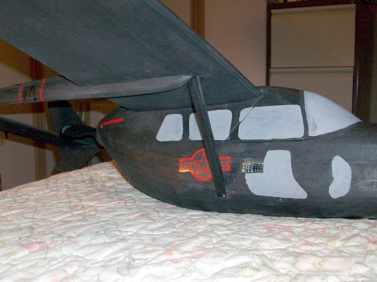

24 May 2013 09:43 #68 by Quorneng
The wing underside decal.
Slightly better this time. I might redo the top one.
Made a start on the windows - decided pale grey looked best - with the paper cut out as a guide.
The extra low down windows are only on the other (pilots) side.
A few more bits of red, mainly prop warnings, to do.
Then that smaller 'star and bar' mask for the fuselage, :huh: and finally the wing struts. :P
Hopefully the current Arctic weather (in 3 weeks the days start getting shorter again :woohoo:) will be annoying somewhere like Norway by then!

28 May 2013 10:59 #71 by Quorneng
The fuselage Star is done.
I have just realised it is not on quite straight! :ohmy:
I would have done more 'decorating' but it was absolutely still this morning, touch of drizzle but nevertheless still.
So the Cessna went for 'loitering' flight using 'just the one' with the HK altimeter on board.
I wanted to check its visibility at height so I let it gently continue climbing. Black against a completely overcast sky is actually very good indeed. I could have gone quite a bit higher but the cloud base looked quite low..
It was definitely not at the LVC but the drizzle had turned to light rain. The DX6i and I were getting rather wet :woohoo: so I called a halt.
Nearly 29 minutes is not bad.
