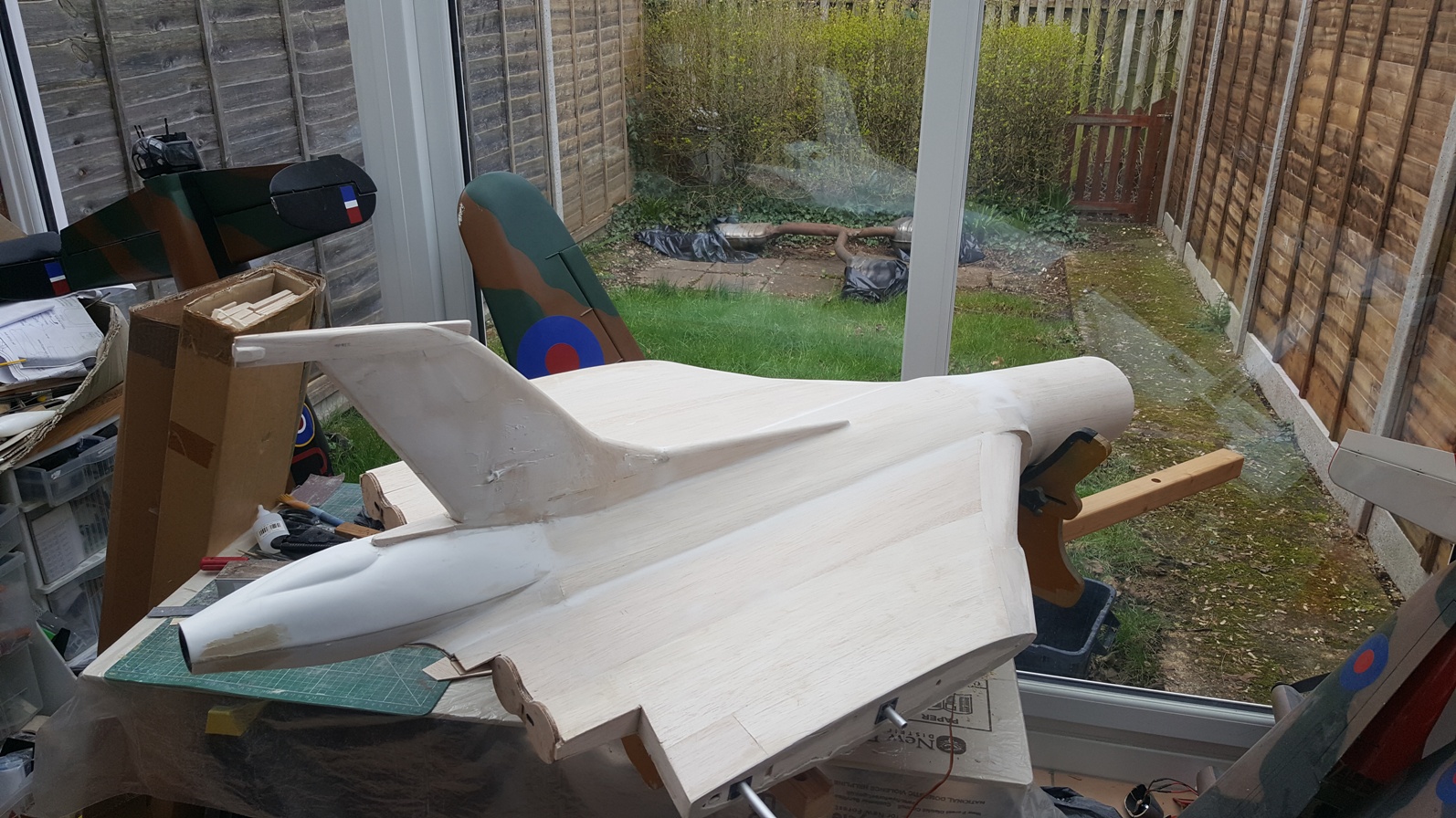

Top sheeting is pretty much complete. Just got to install a few paper guide tubes for the wiring and I can sheet the underside.

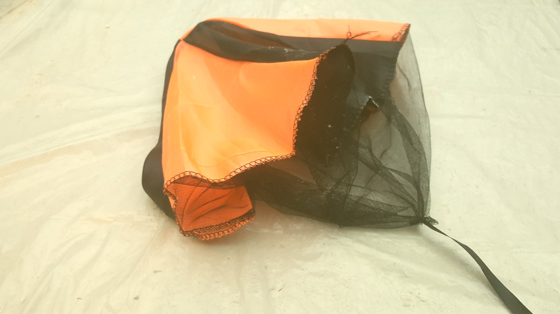

I try to install an unusual scale feature on my scale models. The Lancaster was able to drop the bomb. On the Vulcan i've decided to have a drag chute for braking when landing. Of course it could be interesting if it deploys during flight!!! :ohmy: :ohmy: So searching fleabay I managed to pick up two 450mm diameter parachutes for £4. They are quite reasonable quality, made from cloth. The tie lines are actually netting so prevents tangling.
I shall design and print a tube and pusher piston to slide inside the tube with a spring to push the parachute out when activated by a servo. The assembly will fit inside the tail cone of the Vulcan. Now I just need to come up with some form of release mechanism that is failsafe. :dry:

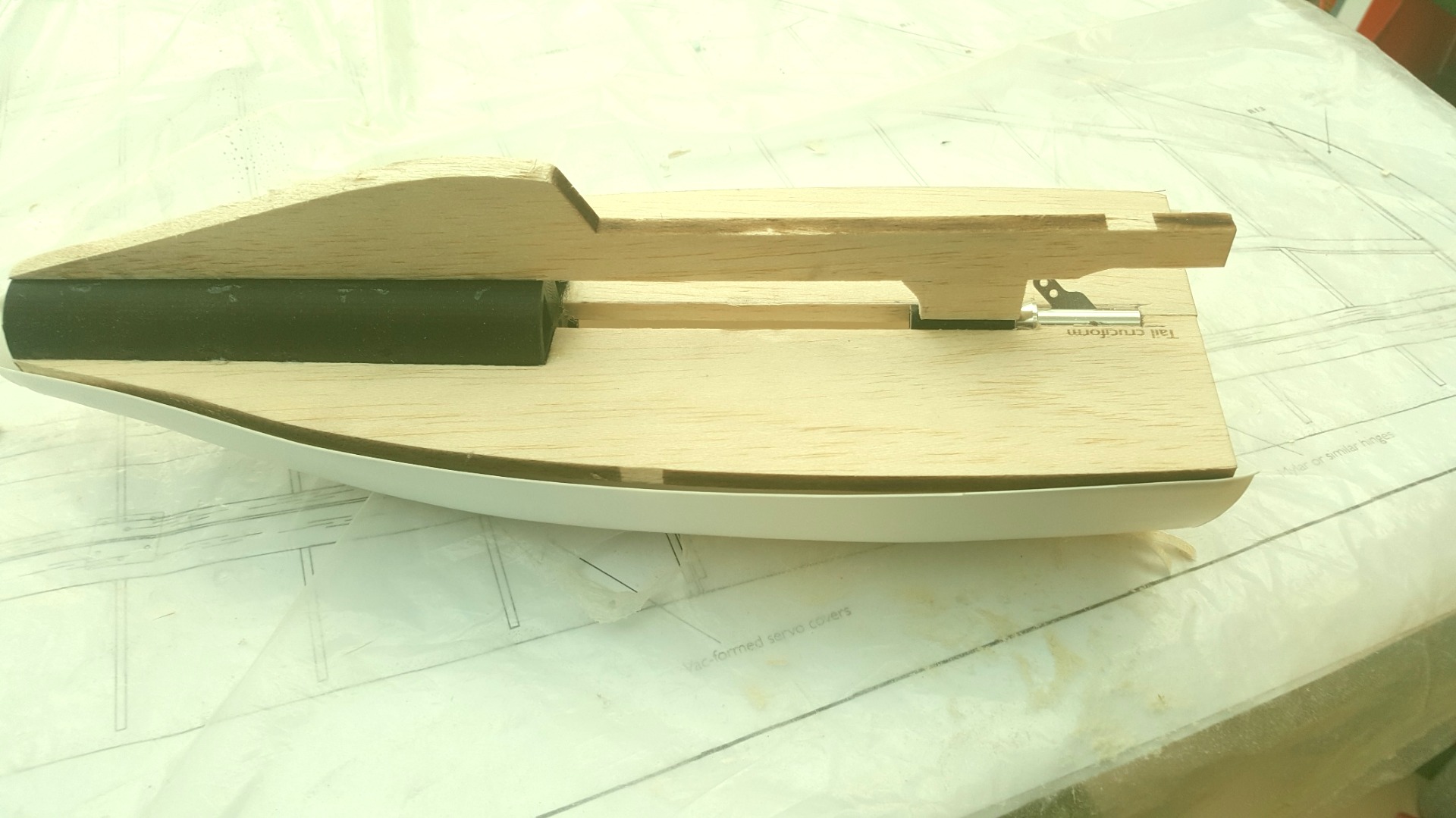

Good idea. I like adapting everyday thing into parts for models. However, I came up with an RC glider tow release mechanism. Hobbyking sell them for £3.99. Really simple and the tension keeps the catch closed.

I too like to incorporate the odd 'gadget', it lifts the model out of the ordinary. Landing lights look good and are easily done now that there are superbright LED's. I always thought that the 'garden gate' airbrakes would look good on a Vulcan.
Is it just the camera angle but the nose section ahead of the wing in the pic above looks disproportionately long??

13 Jan 2020 13:16 #24 by Ralpharr2001
Replied by Ralpharr2001 on topic Avro Vulcan build
Hi Stu. I agree something to create a bit of lift to the model. I would like to add the air brakes. Just got to design them! The plan shows them folding down onto the wing surface not popping up as per the full size. Don't like that idea so would rather not fit them at all.
Its the camera angle. The overall outline is pretty close the the 3 views.

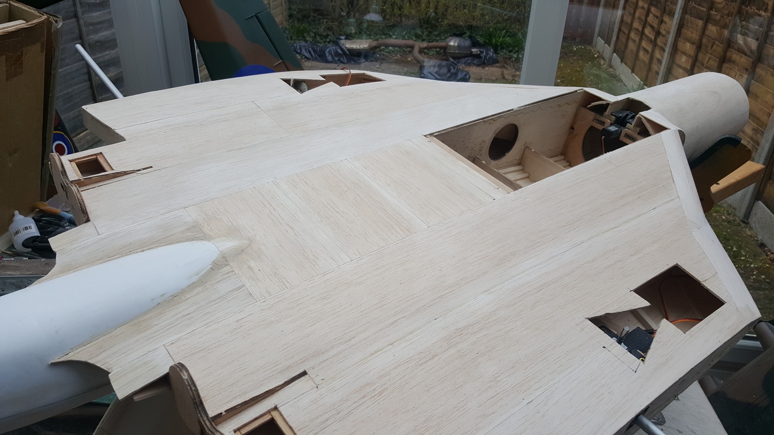

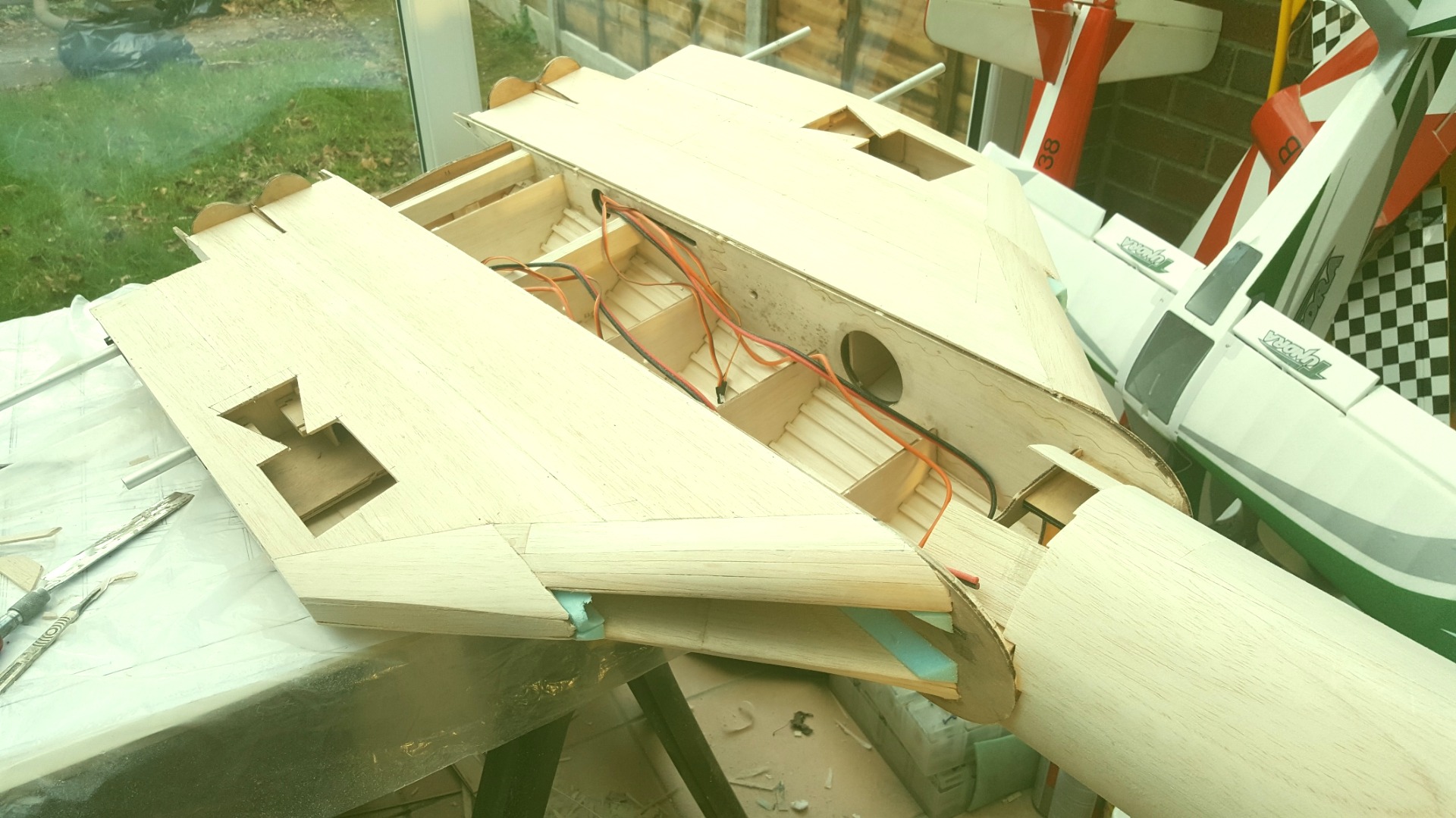

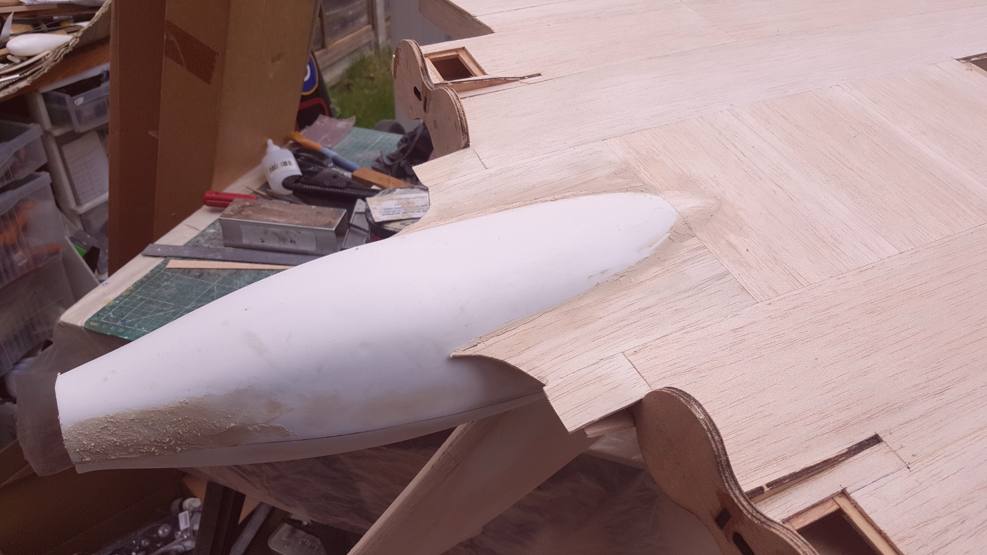

Been working steadily on the Vulcan. Wiring in for the motors and servo extension leads also fitted. Underside of the fuselage is now sheeted. Just got to add leading edges. The cutouts are for the undercarriage. The triangular part is attached to the oleo leg and the rectangular cutout is the main gear door.

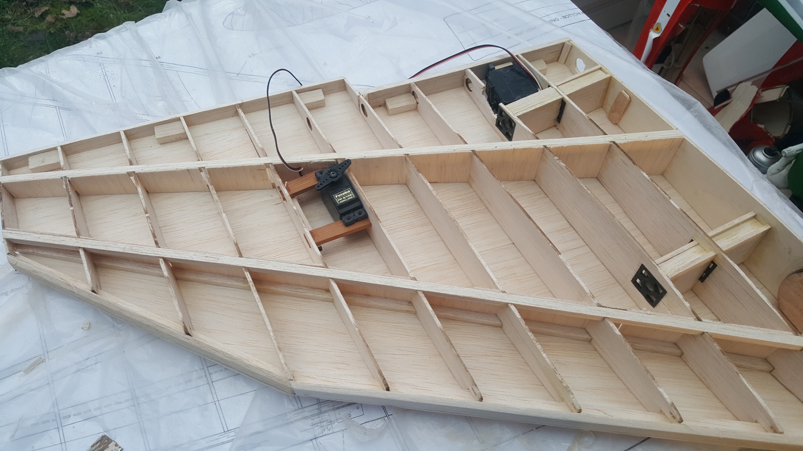

Servos fitted to each wing. I'm using some old Futaba S148's that I had. They're quite big so not an easy fit into the wing. Had to make a few cut outs.
The parachute release mechanism is fitted into the rear tail cone. A bit more work and it will be ready to fit.

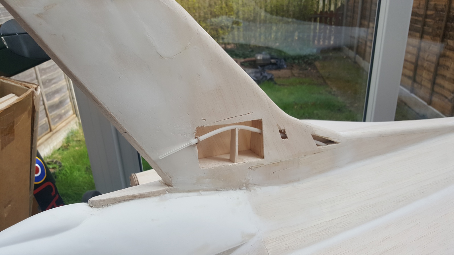

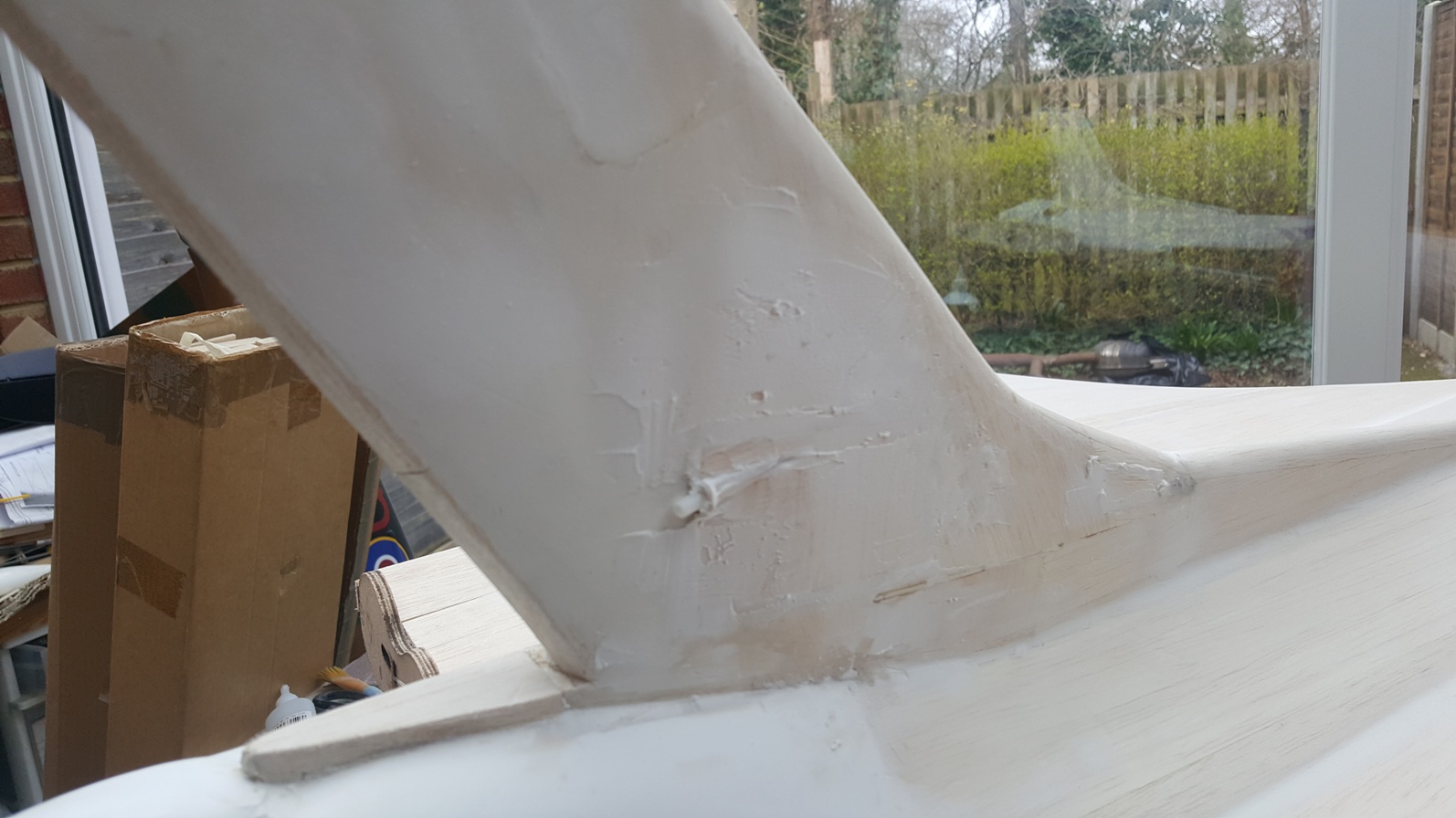

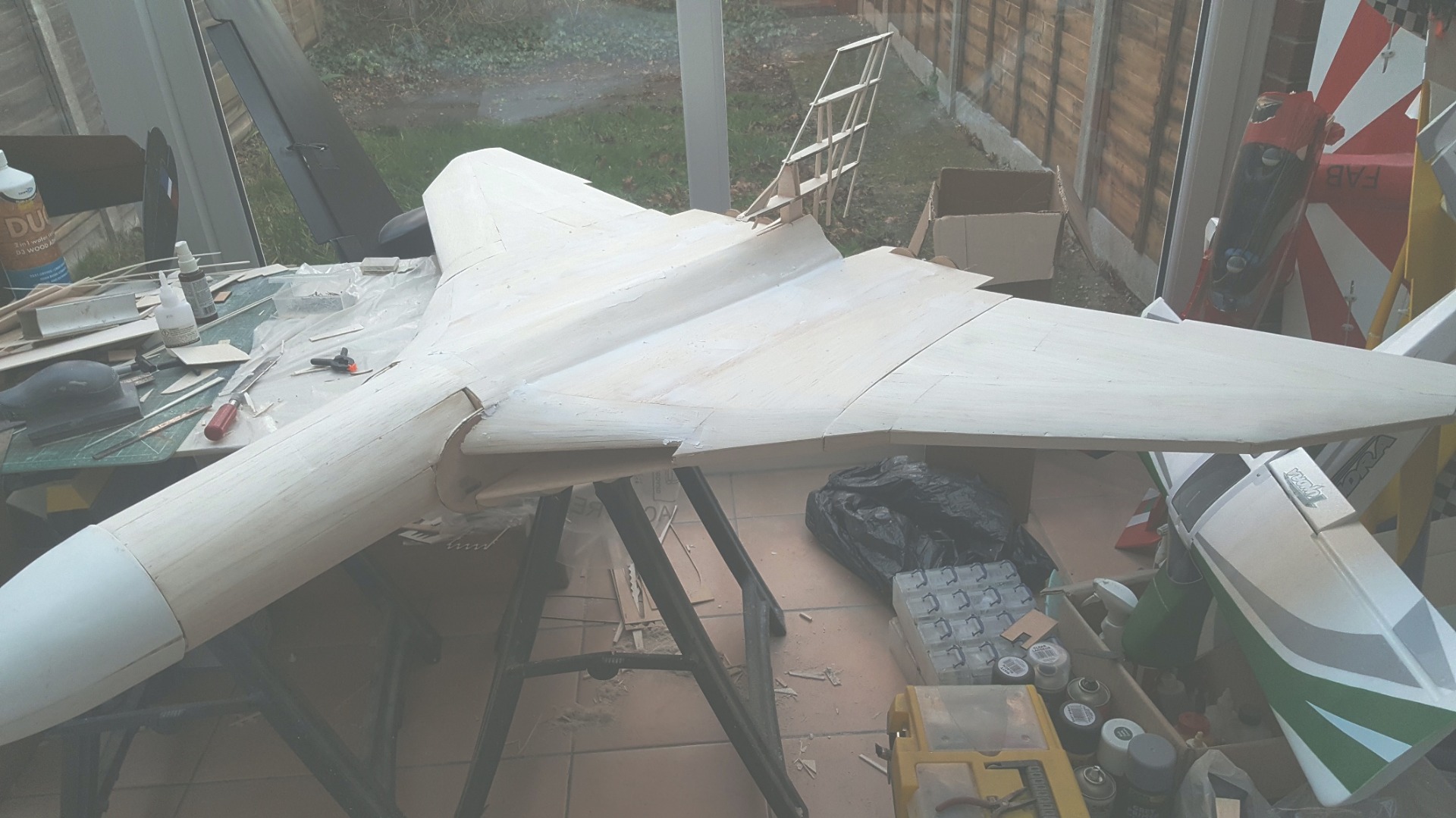

Started sheeting the center section of underside, glued on the tail cone and fitted the fin. However, being a muppet I forgot to install the rudder control snake!!:blush: :blush: So had to cut some of the skin off and make a way through for the snake.
The wing panels are sanded and glassed with 50g cloth and I used G4 pond sealer (£22 for 1kg). I used 50g cloth instead of my normal 25g cloth as I had sheeted the wings in 1/16th balsa and wanted to see if the G4 warped the skins like the WBPU varnish I used on the Lancaster. It didn't!! :lol: This is a polyester single pack resin. Never tried this stuff before. Goes on like resin using a brush but no mixing with hardener. Just paint it on, let it go tacky (about 60 - 90 mins) apply second coat. Let it dry for 24 hours and sand. Clean brushes in cellulose thinners. Just waiting for them to dry and I'll weigh them. The test pieces I did are really hard and sand nicely. Can't use on foam as it will eat the foam.
