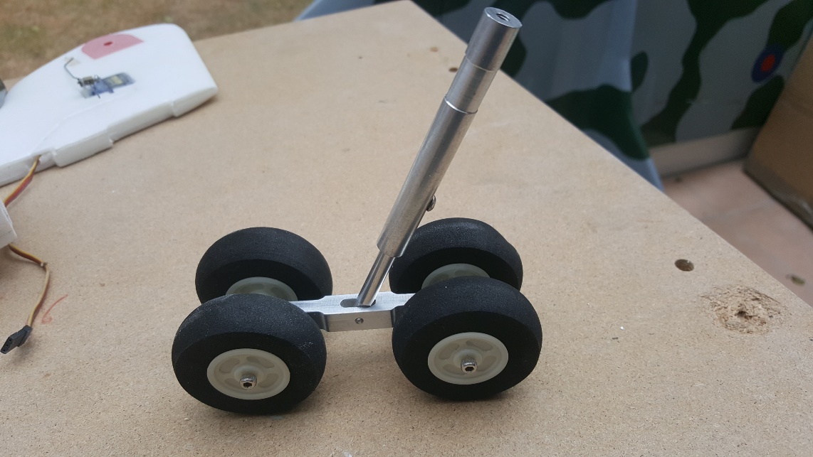

03 Jun 2020 17:38 #66 by Ralpharr2001
Replied by Ralpharr2001 on topic Avro Vulcan build
A bit of bling arrived today from Bangood. Need to modify the bogie to bring the wheels closer and also to allow more tilt angle so that it tilts more on retraction.

Well nearly finished the Vulcan this weekend. Fitted out all the radio gear, i'm using Jeti. Installed the 10 channel Jeti Assist receiver. This is a gyro assisted receiver with an on/off function. Very complicated to set up. There are some great tutorial Youtube videos by Harry Curzon on setting up Jeti radio. He has seven 10 minute videos on just the Assist receiver set up!
Modified the bogies I got from Bangood. They were way to long but the idea was sound. So I machined up some new bogies slightly shorter and moved the pivot point forward by a few millimetres. This helped them hang properly so they looked scale. They don't tuck away completely into the wheel wells. I will put some foam in there so that the foam pushes the front wheels down lifting the back wheels up into the well.

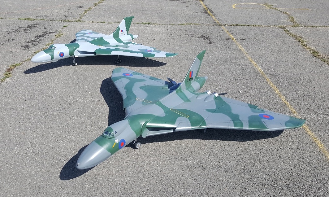

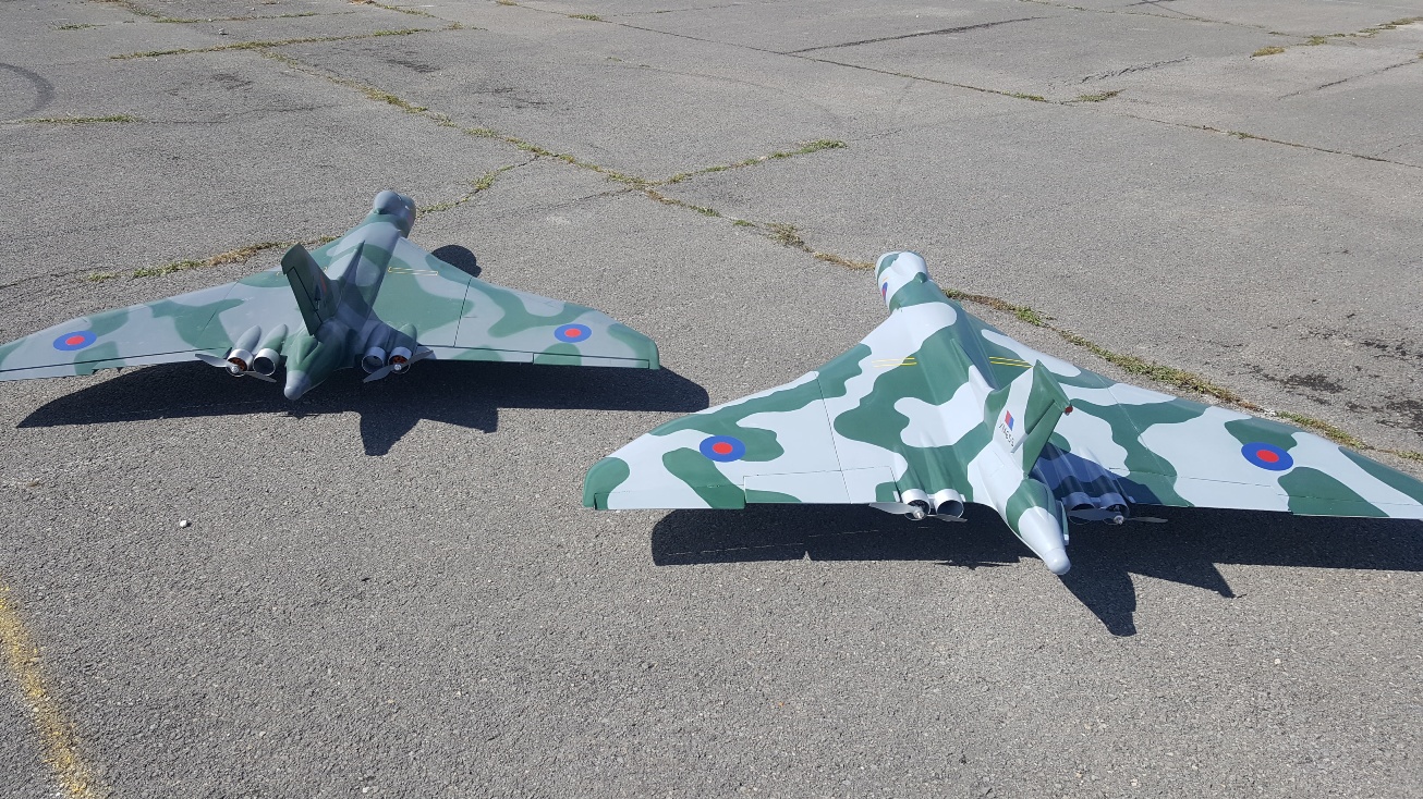

26 Jul 2020 12:35 #70 by Ralpharr2001
Sorted out all the electrical issues. Did some taxi trials last week. The CG was too far forward and nose leg too high giving to much angle of attack. So spent a little time this week sorting out those issues. Had to re-make the battery tray and machined 15mm off the nose leg.
So with no further excuses its was the maiden today. A good stiff breeze straight down the runway. One of the guys I fly with also built a Vulcan at the same time as me. So we tested both today. He tested his first and had no issues other than not enough elevator throw. His elevators were as per the plan.
Then it was my turn. We checked my CG against his and I was very slightly more nose heavy, so safe. Interestingly my CG was as per plan. My elevator throws were more than his, but more scale with a larger chord. A good long straight run and she lifted off very nicely, retracts up. Slight left roll and little nose down. I did not start with any reflex on the control surfaces so was expecting a little nose down. Set the trims and she was hands off. Very pleased.
A few things to sort out. Add reflex to the elevators and ailerons. Too much play in the undercarriage bogies so it wandered during the takeoff roll, nothing that cant be sorted with a little machining. Move the CG back about 15mm.
