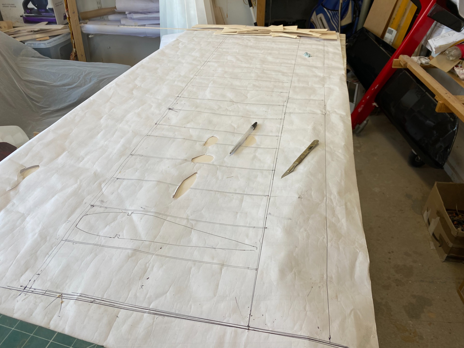

Ill get started on the drawing, about a 48 1200mm wingspan to suit the balsa sizes i think would be best, my drawings are always done by if it looks right it could fly ok

I was waiting for my boy to take me shopping at Tescos yesterday and popped into the shed to sort some paper out for the fun fly plan
He never showed up but i got a bit done had a sort through what little balsa i had and the scrap box

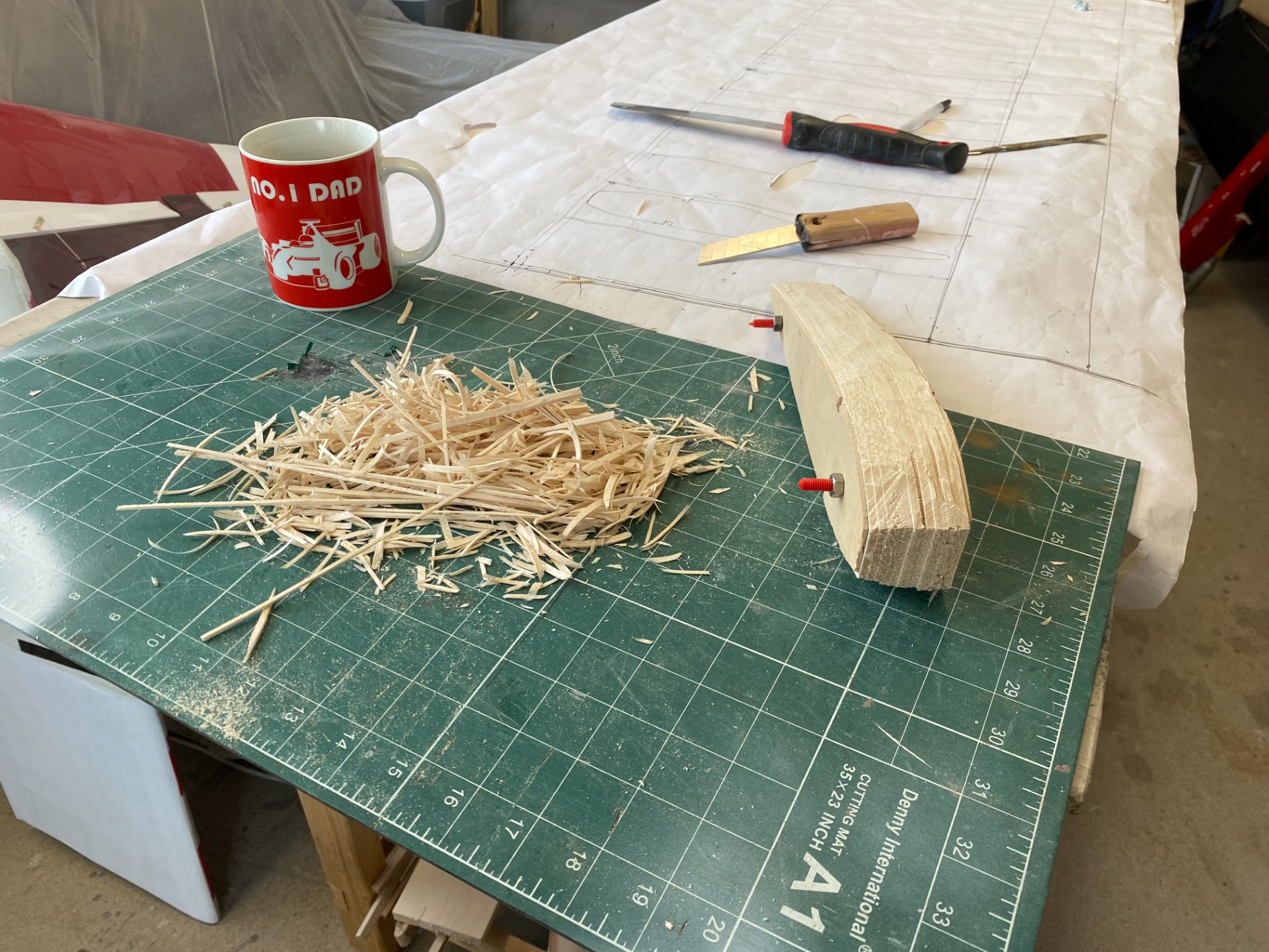

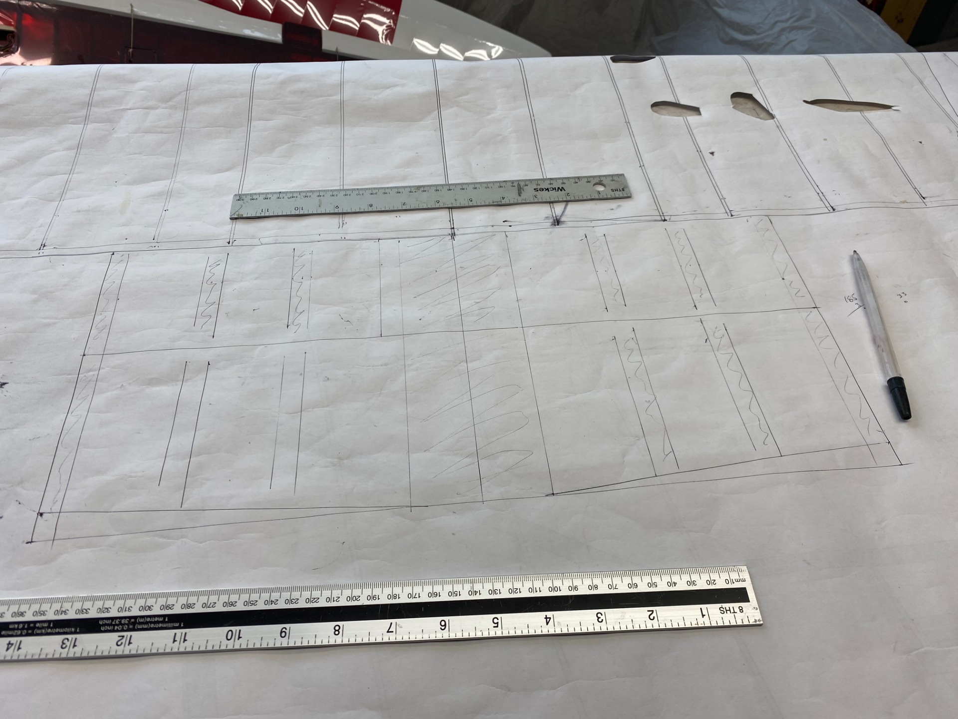

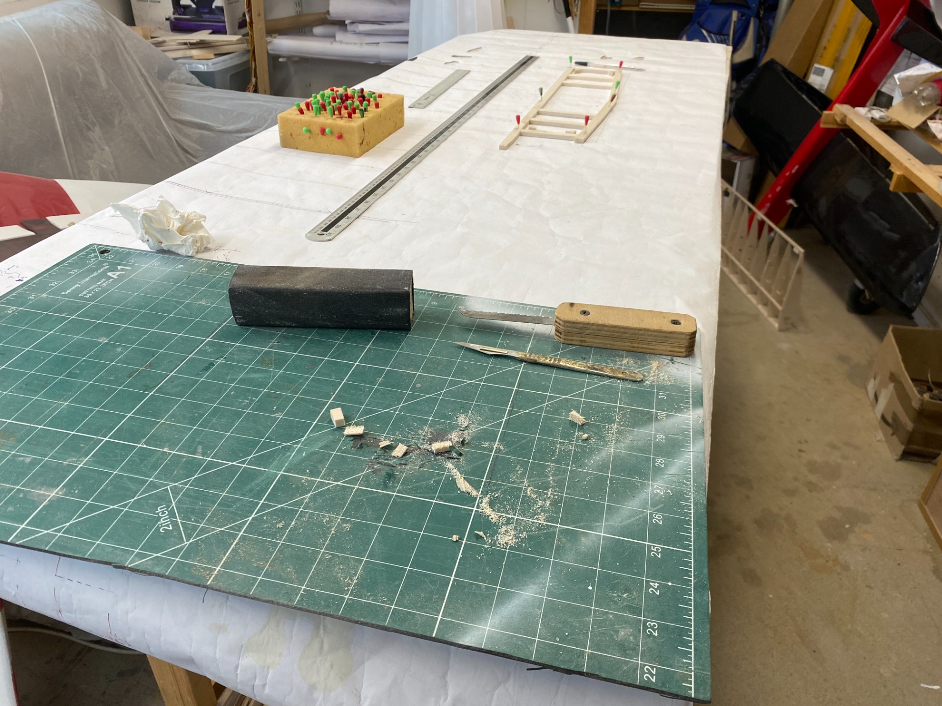

13 Oct 2025 19:56 #15 by THE BLACKBIRD
Replied by THE BLACKBIRD on topic Fun fly

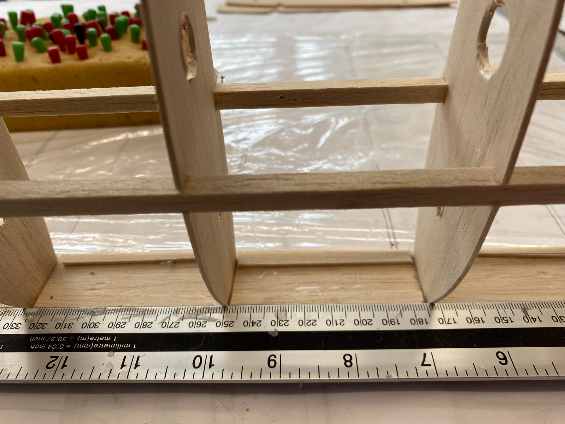

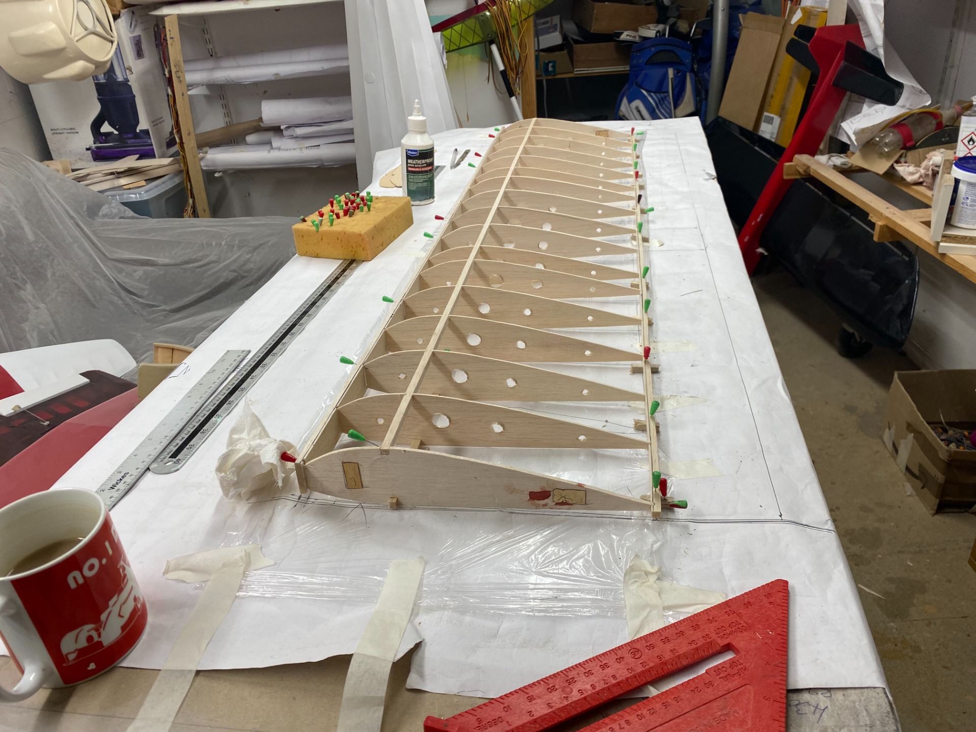

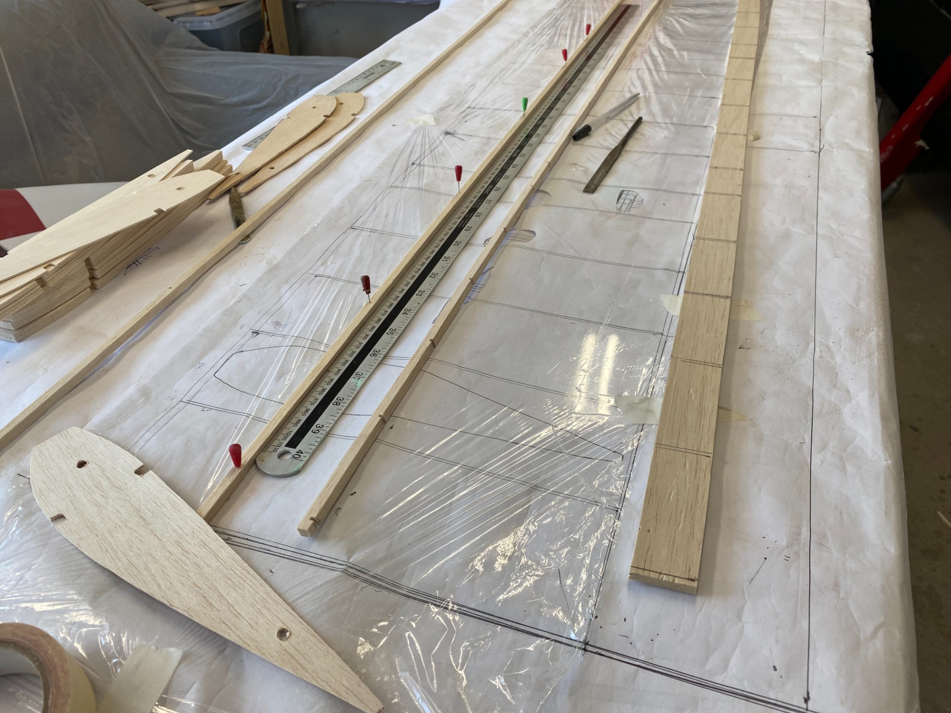

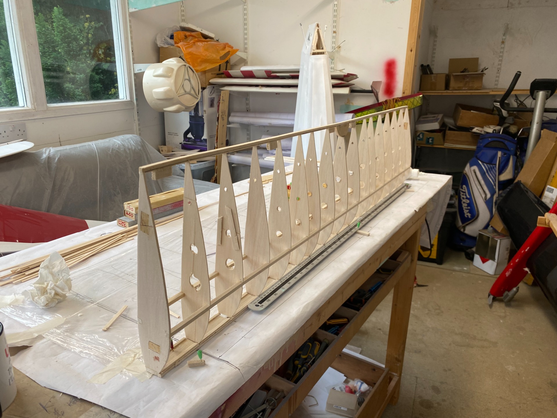

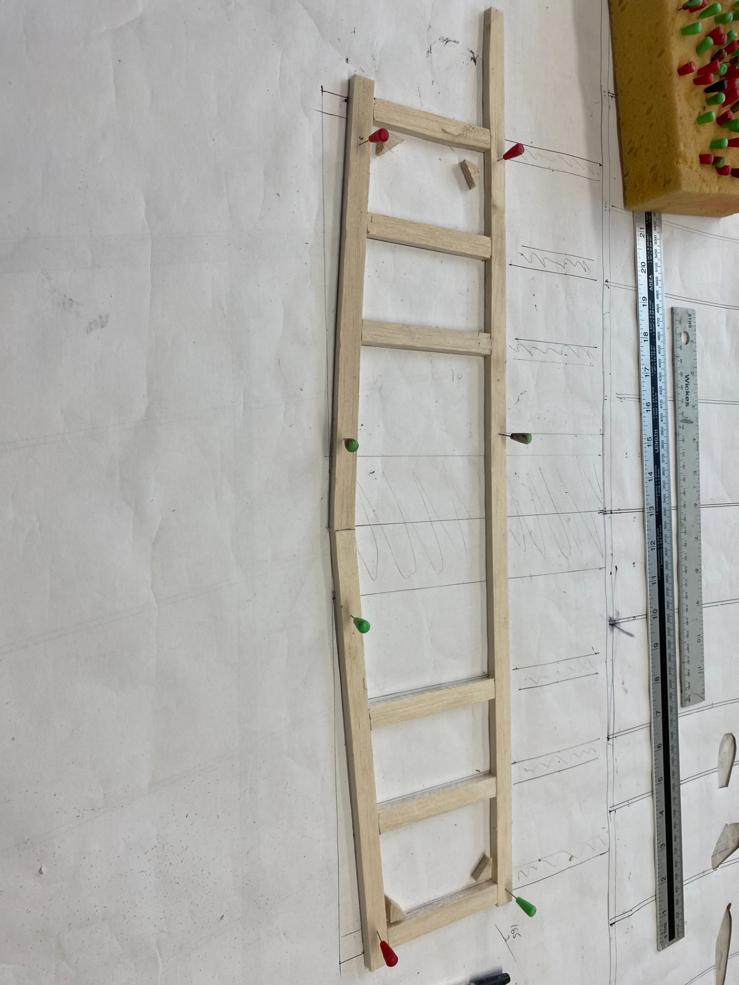

Looking for something to do while my parcel with the expensive balsa in turns up i found some 2mm balsa in the scrap box and cut it in pieces to go inside the leading edge between the ribs to carry the 2mm sheeting that fits over top and bottom of the leading edge
Then i doodled some lines on the paper for the tail feathers
Found some scrap 6mm and cut and dry fit to the doodles
At which point im out of scrap and things to do
