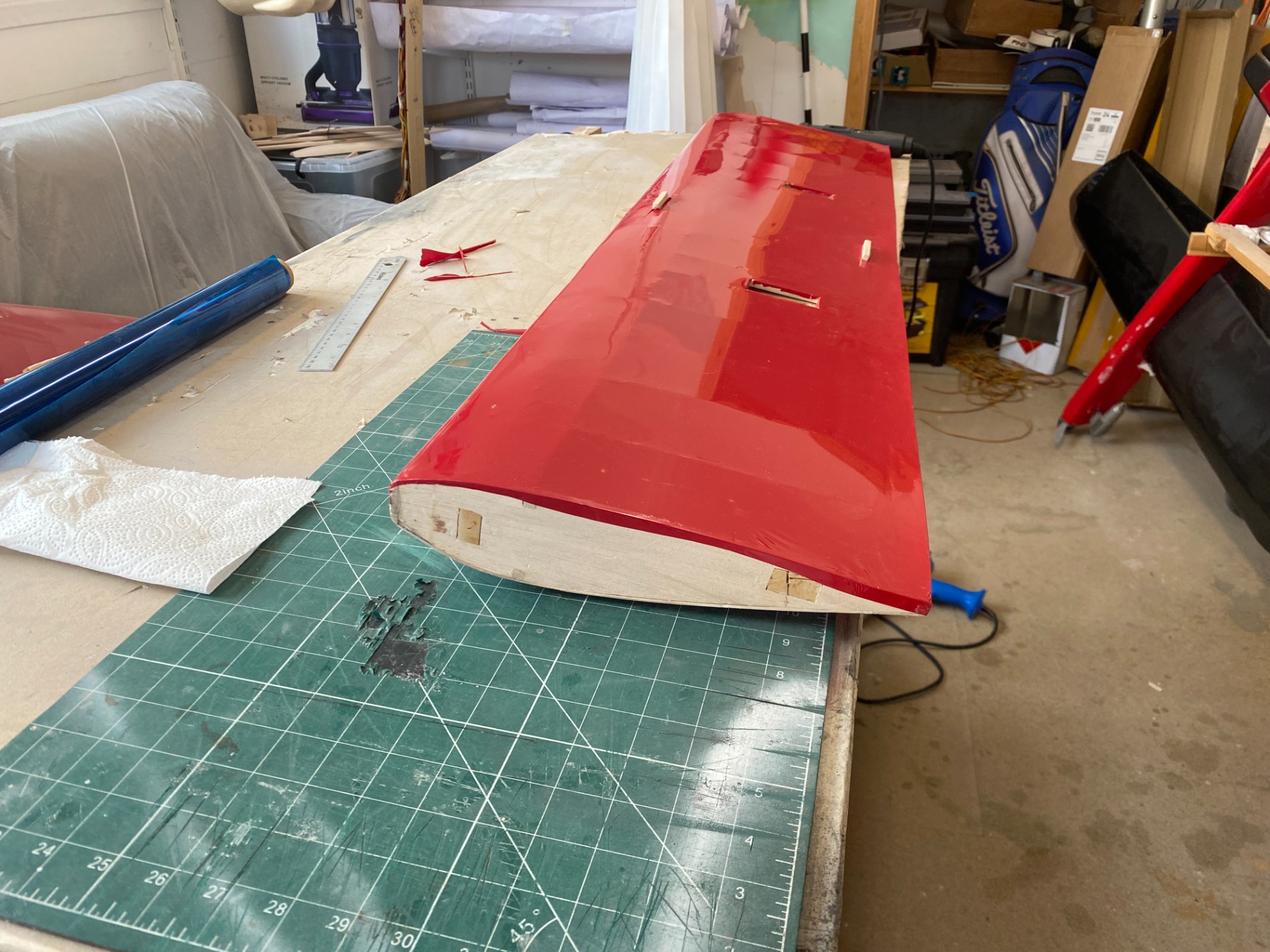

Covered the bottom of the wing, thats the only bit of covering i had big enough

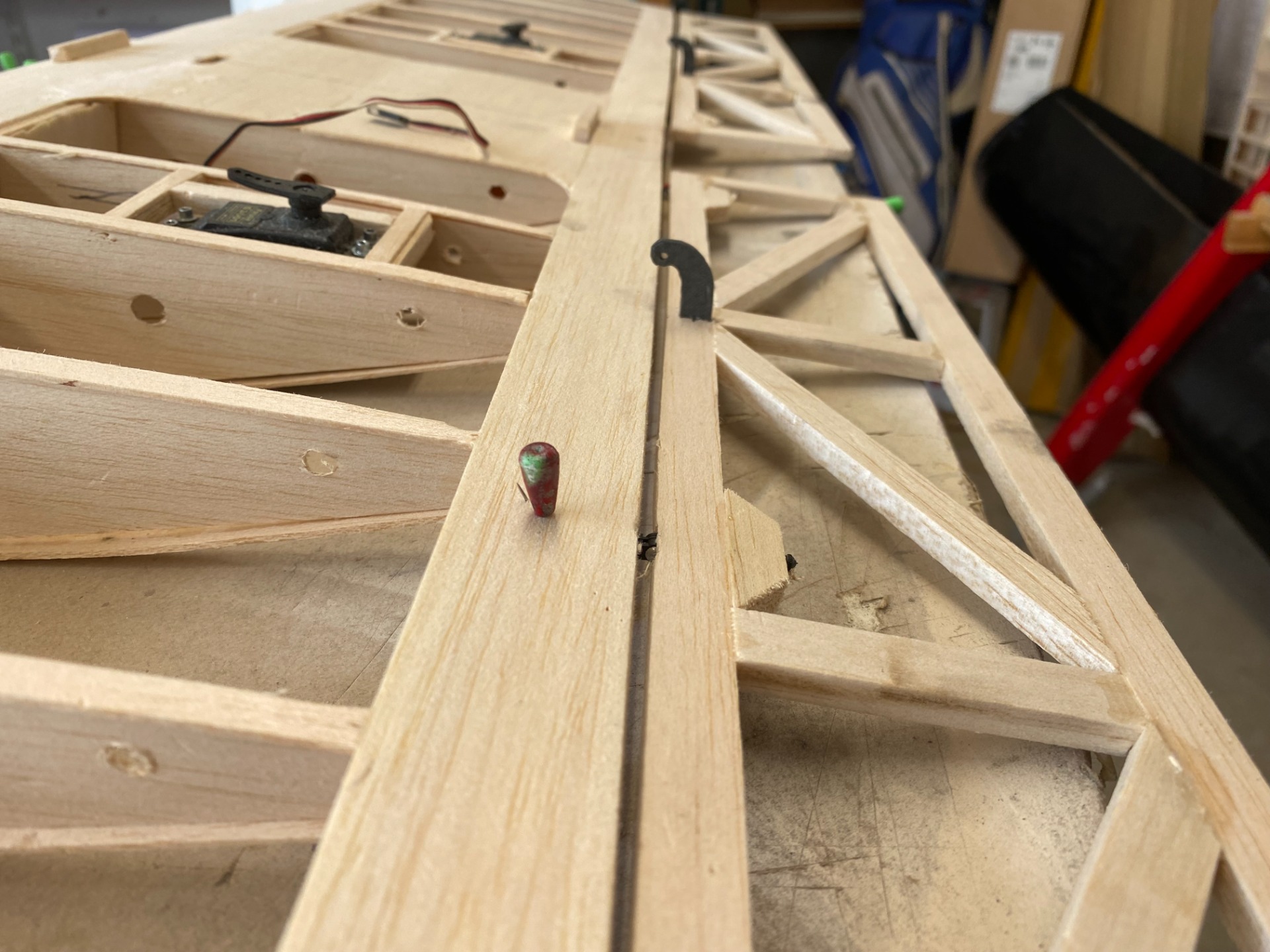

And made the horns for the ailerons
And thats it for today or until my order from leeds model shop turns up

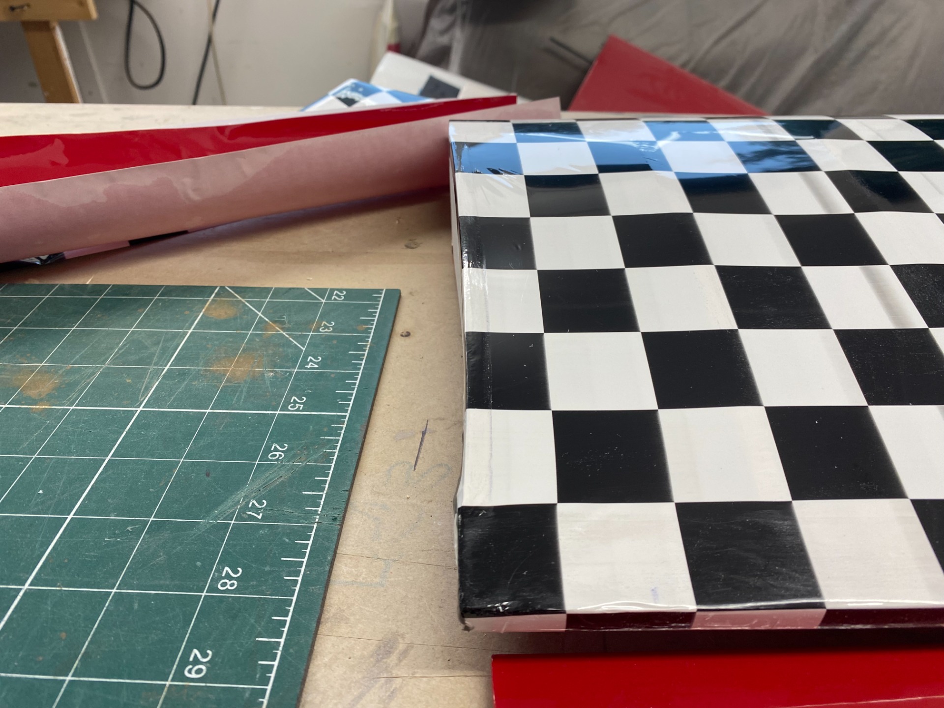

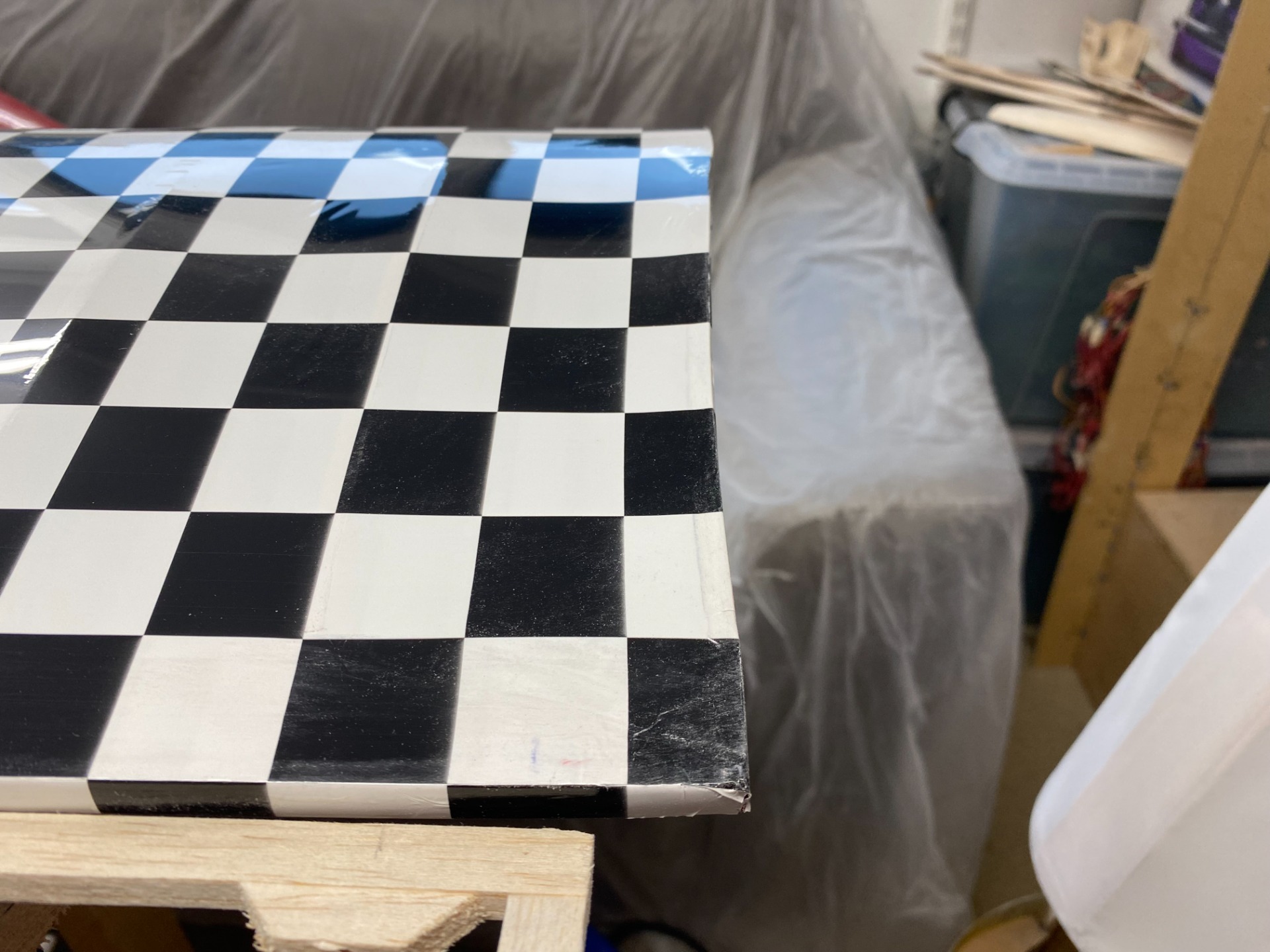

Today my order from Leeds model shop came, i only ordered it yesterday morning so done a bit more of the hated covering, iv never liked doing it since it first came out in the 1960s always got on better with nylon dope and paint on my competition stunt ships
Anyway the usual shit job i made of it
Now having learnt from the glider when the film pulled in the end ribs i put some bracing between the end rib and the next one in
But its made no difference
It stays like that now cannot be arsed with it

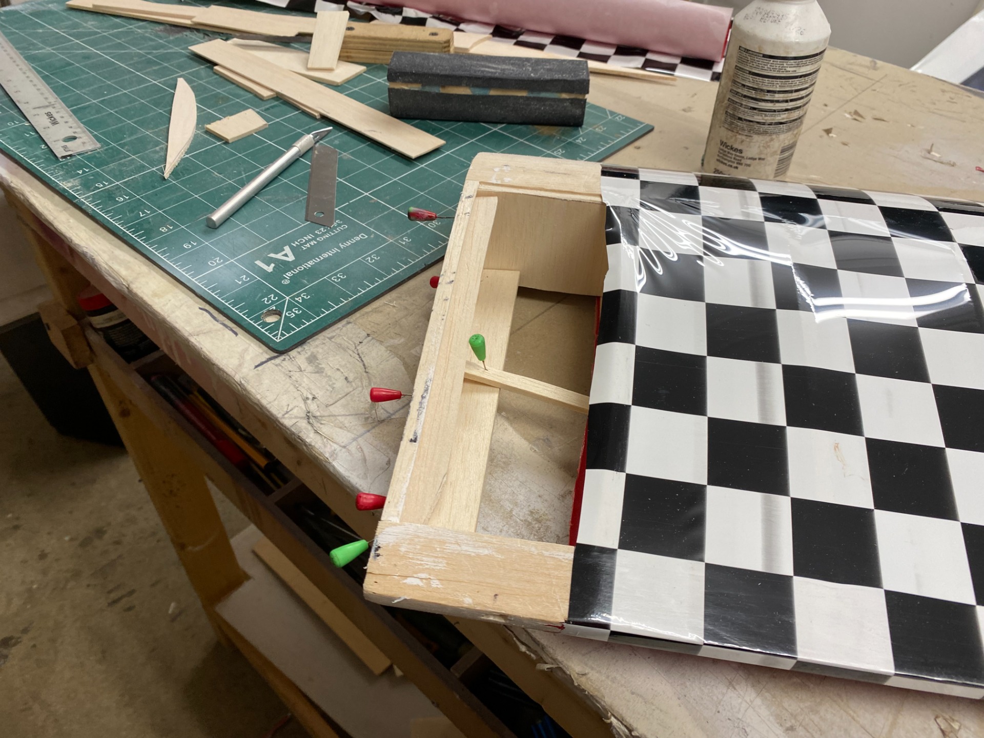

21 Oct 2025 21:52 - 21 Oct 2025 21:54 #40 by THE BLACKBIRD
Replied by THE BLACKBIRD on topic Fun fly
The wingtips were bugging me so much, so i went and opened them up to do the job properly
I suppose now the fun bit starts
Last edit: 21 Oct 2025 21:54 by THE BLACKBIRD.
21 Oct 2025 22:46 #41 by Eric
Replied by Eric on topic Fun fly
That is why most open-structure wings have a solid wood tip. I thought you were going to do that!
