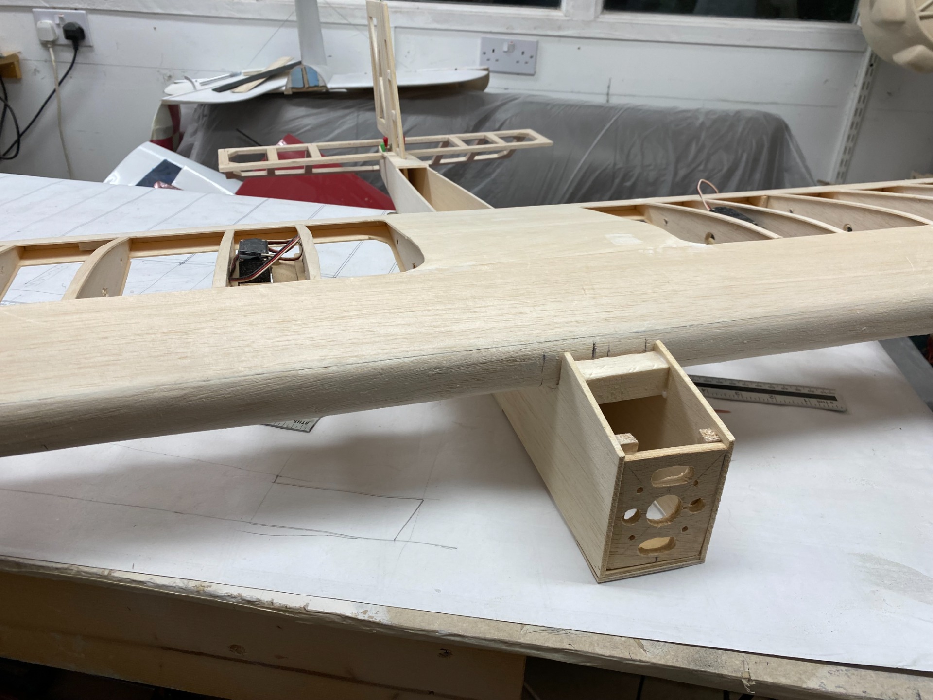

Got my parcel so done some more, drew the fuselage sides and cut them from 3mm balsa
and marked out the former for the motor to mount on and glued it in place

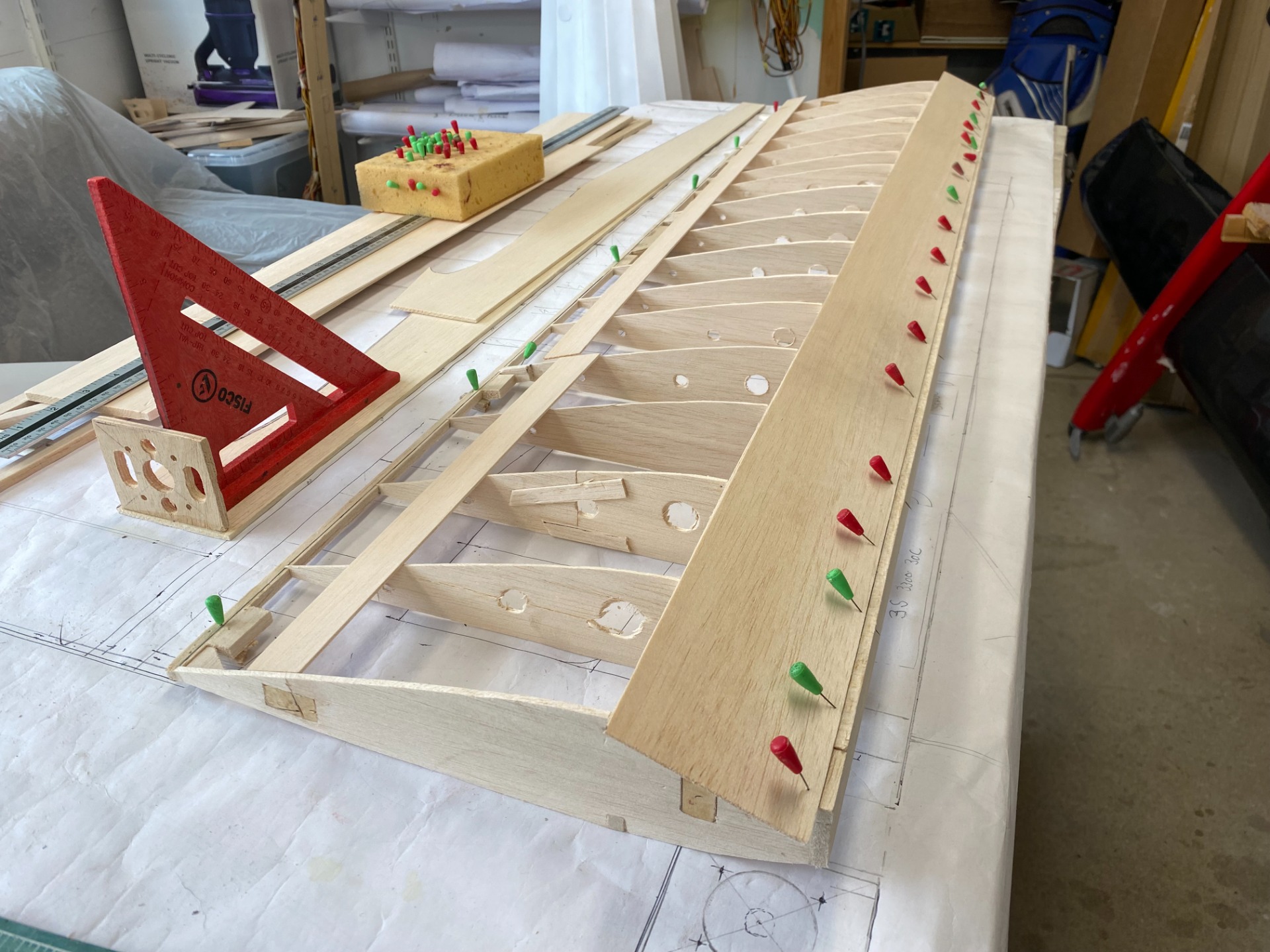

then i started on the underside of the wing, sheeting the leading edge and trailing edge and then the cap strips
Also made up a former ror the fuselage
Then started on the under side of the wing, pinned the spar down and packed up the trailing edge to keep everything true

Little more done, wing all finished and sanded with the aileron servos fitted, fuselage nearly done so i popped it together to see what it would look

Looks really nice.
That is a pretty substantial wing section. Lots of slow speed lift but no speed merchant.

Big gap in the middle of the elevator. What are you going to mount the horn on?
18 Oct 2025 11:22 #21 by THE BLACKBIRD
Replied by THE BLACKBIRD on topic Fun fly
Was a big gap in the middle of the elevator its all filled in before this was posted
