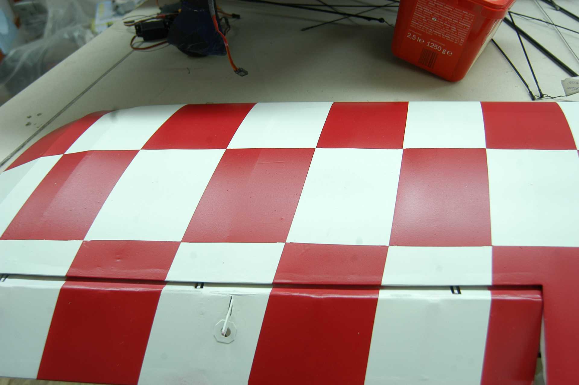

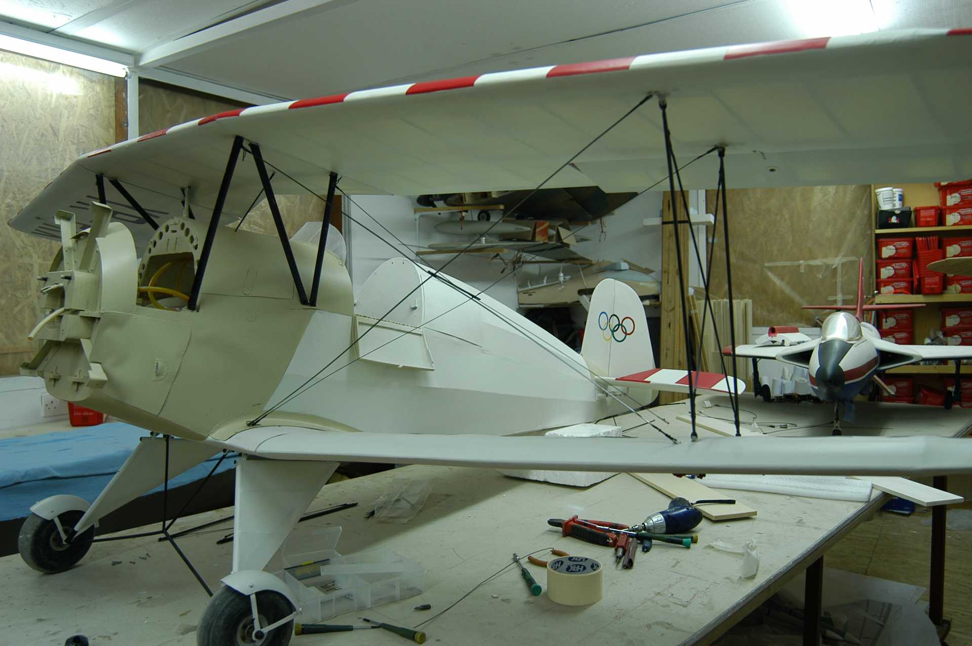

Took the masking off this morning and
Pleased with it, I shall know what to do next time, if I can remember :huh:

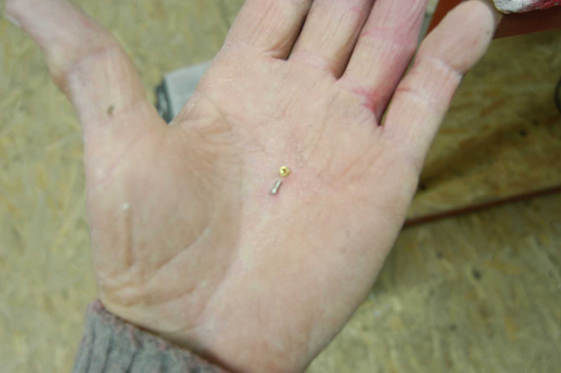

And started to put the rigging back together
And spent a lot of time trying to fit these, not to drop them, but my Arthur Ritus fingers did not cope well, so spent a longer time trying to find them on the floor :S

19 Dec 2016 07:17 #198 by Klipkopwildlife
Forceps clamps? As used by the medical profession, I use 1 pr angled and 1 pr straight, works for me.
You are going to 'Locktite' them aren't you?
19 Dec 2016 08:24 #199 by THE BLACKBIRD
A blob of CA on them after everything is lined up I thought, as they should never need adjusting again
as this 3mm x 1mm stainless steel wires are not going to stretch ?
And if anything breaks it wont matter as they hold the wings on :S

Got some of them clamps but some times you cannot use them, 300mm long very useful
Not been a good day, only started this evening due to trying to keep the house warm, brrrrrr
I set the wings up with all the rigging when I first did it, then labelled it all when I took it apart to paint
Would it go back together, Noooooooo put on the other wing tonight stood back to sight it up, a big twist in the wing, had to remake four of the parts, its all ok now and it should never need to be taken apart

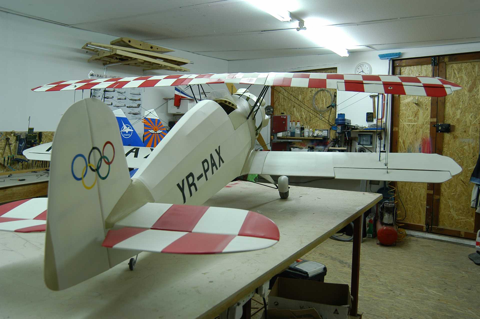

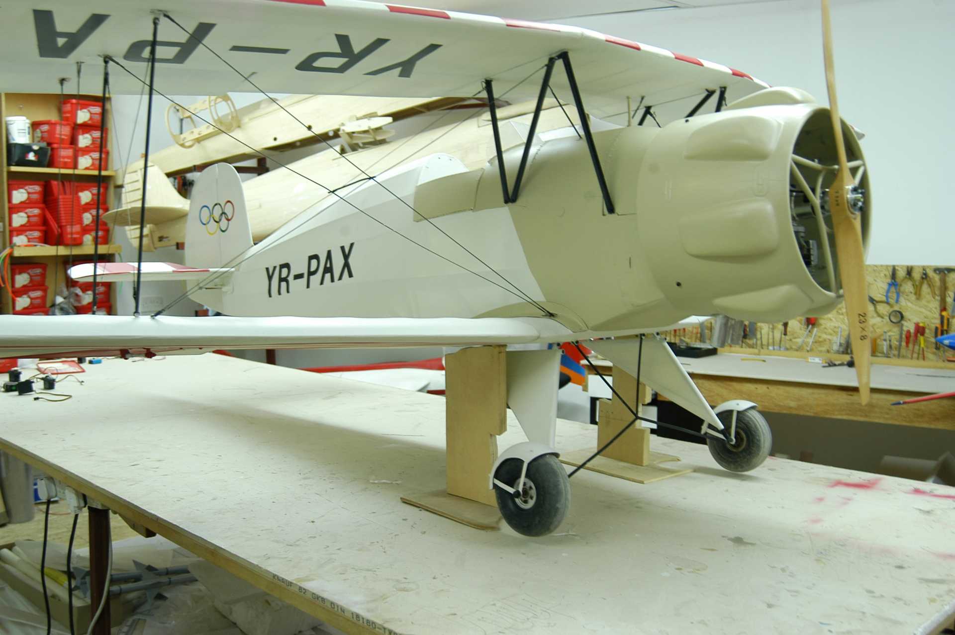

20 Dec 2016 19:42 - 20 Dec 2016 19:47 #207 by THE BLACKBIRD

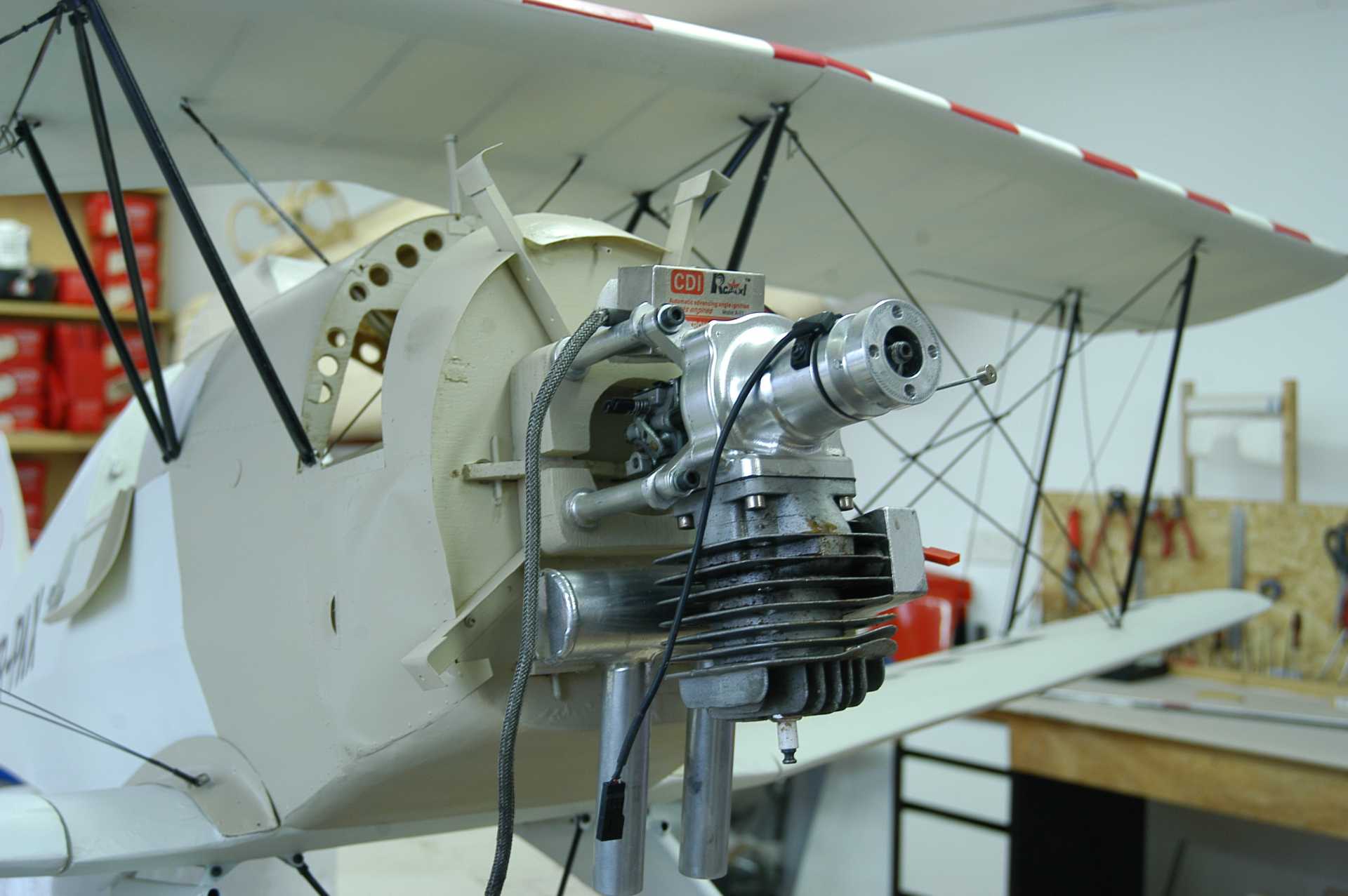

Been fitting the engine tonight, and cowl, she's almost done

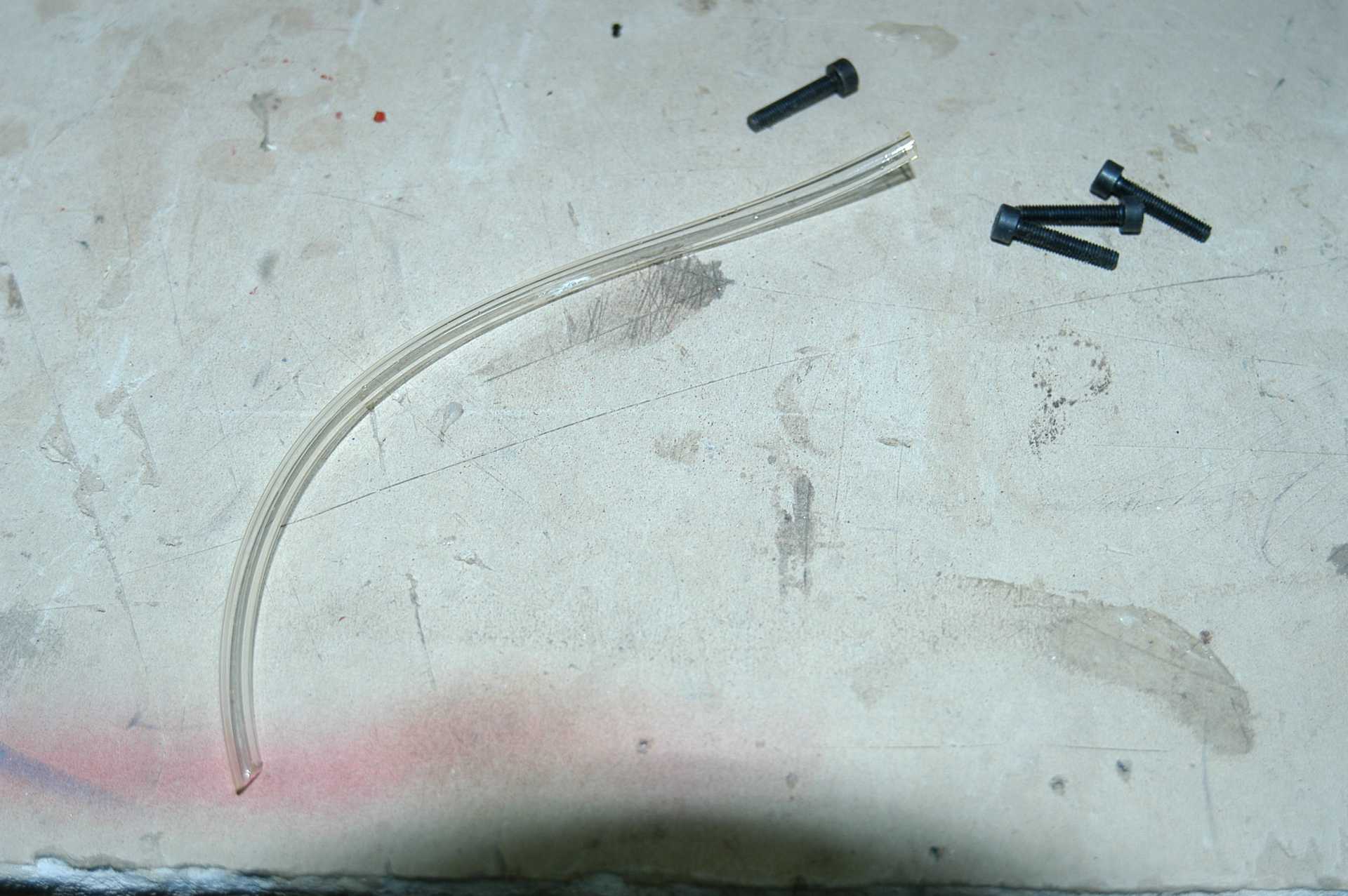

I put 3mm cut offs of 4mm fuel tube on the 3mm bolts that hold the cowl on, if you read this Mr Beard don't forget to put pieces of tubing on thing that don't have lock tight on them, or they vibrate off, like my canopy on my Revolver
Thought I was nearly there until I spotted something
And it balances spot on as built, got the two lipo's, receiver and the ignition switch to go yet

21 Dec 2016 11:04 #209 by Eric
It might be the camera angle, but that right upper wing appears to have a load of wash-in on it!
