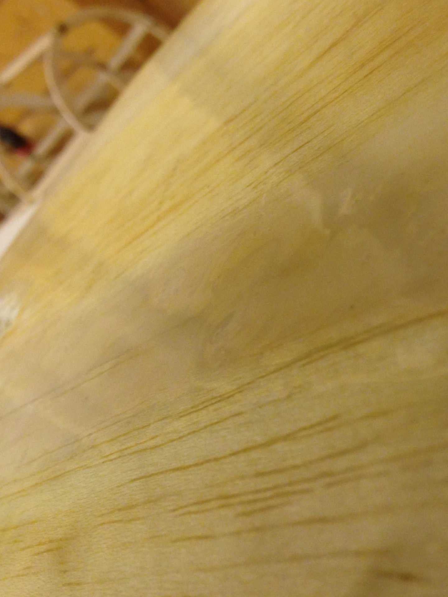

09 Sep 2017 00:03 #41 by bond007mas
Replied by bond007mas on topic SR71 1:10 SINGLE TURBINE
Naaaa, the problem is leaning over where ever you are. You have to work from the inside outwards, if you get anything that needs further work, your stumped
  • bond007mas
09 Sep 2017 20:39 - 09 Sep 2017 20:46 #42 by bond007mas
Like i said Tony, like glass!!!!
Put a thin layer of mixed resin on surface first, then cloth, and then another thin layer, allow to dry, sand, then another thin layer
Last edit: 09 Sep 2017 20:46 by .
Thanks: Klipkopwildlife, , THE BLACKBIRD, boz, Firewood
09 Sep 2017 21:05 - 09 Sep 2017 21:07 #43 by THE BLACKBIRD
Replied by THE BLACKBIRD on topic SR71 1:10 SINGLE TURBINE
Add much weight with three costs of resin, I know nothing about glassing only what iv mumbled through, you do it totally different to me that's for sure, im doing it wrong :(
I presume the first coat is still wet when you lay the cloth on and apply the second coat
Last edit: 09 Sep 2017 21:07 by THE BLACKBIRD.
  • bond007mas
09 Sep 2017 21:30 #44 by bond007mas
That's how it tells you to do it on the box
10 Sep 2017 15:18 #45 by THE BLACKBIRD
Haaaaa you read instructions :S :whistle: ok I lay the cloth on then work the resin into it, when dry sand it off, that's it :woohoo:
So on the A10 I have got it all sanded apart from a bit of the fuselage, so I will now give it a second coat, then sand it again presumably ?
I was going to apply primer/filler next
I learn every day
