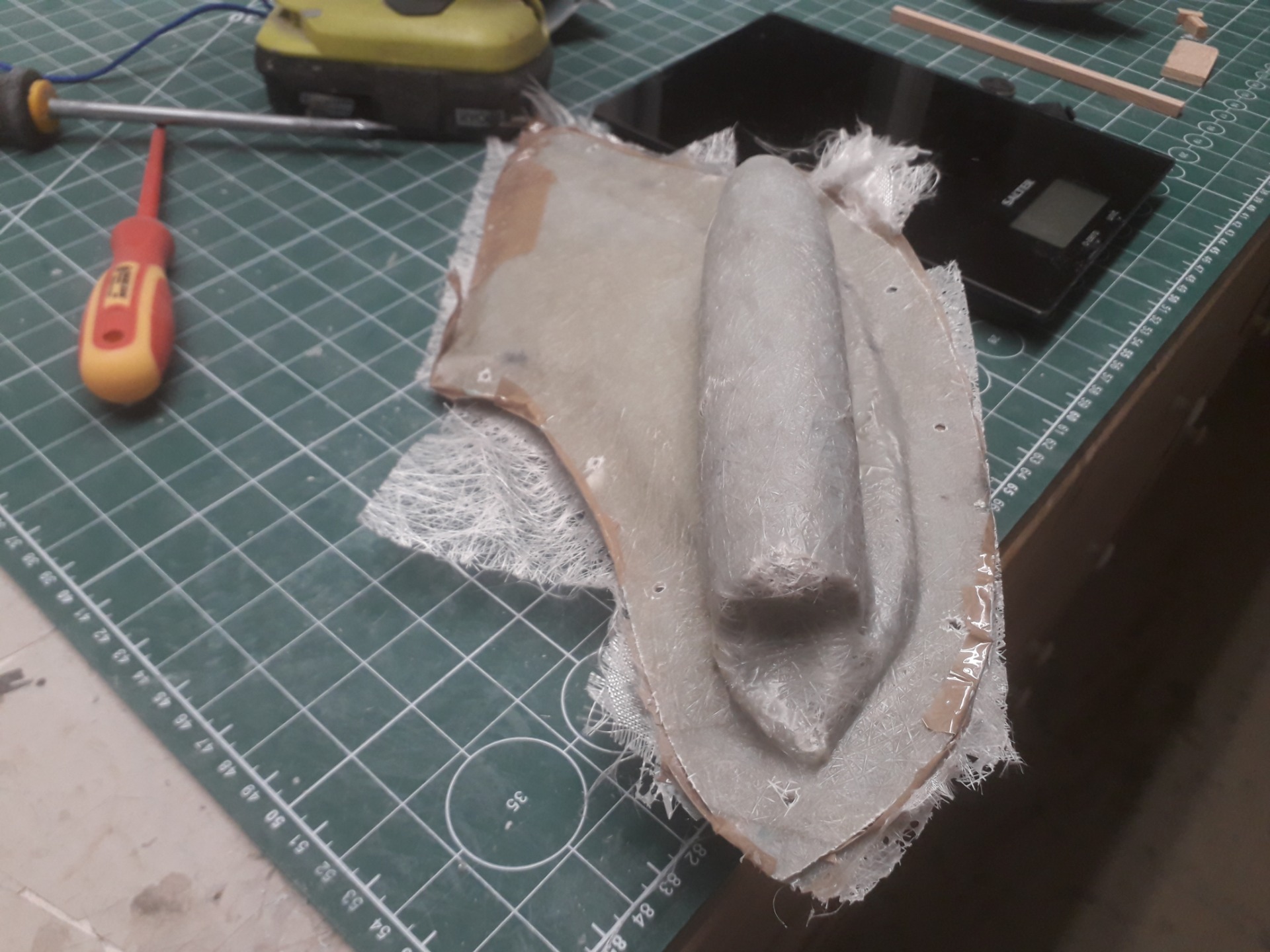

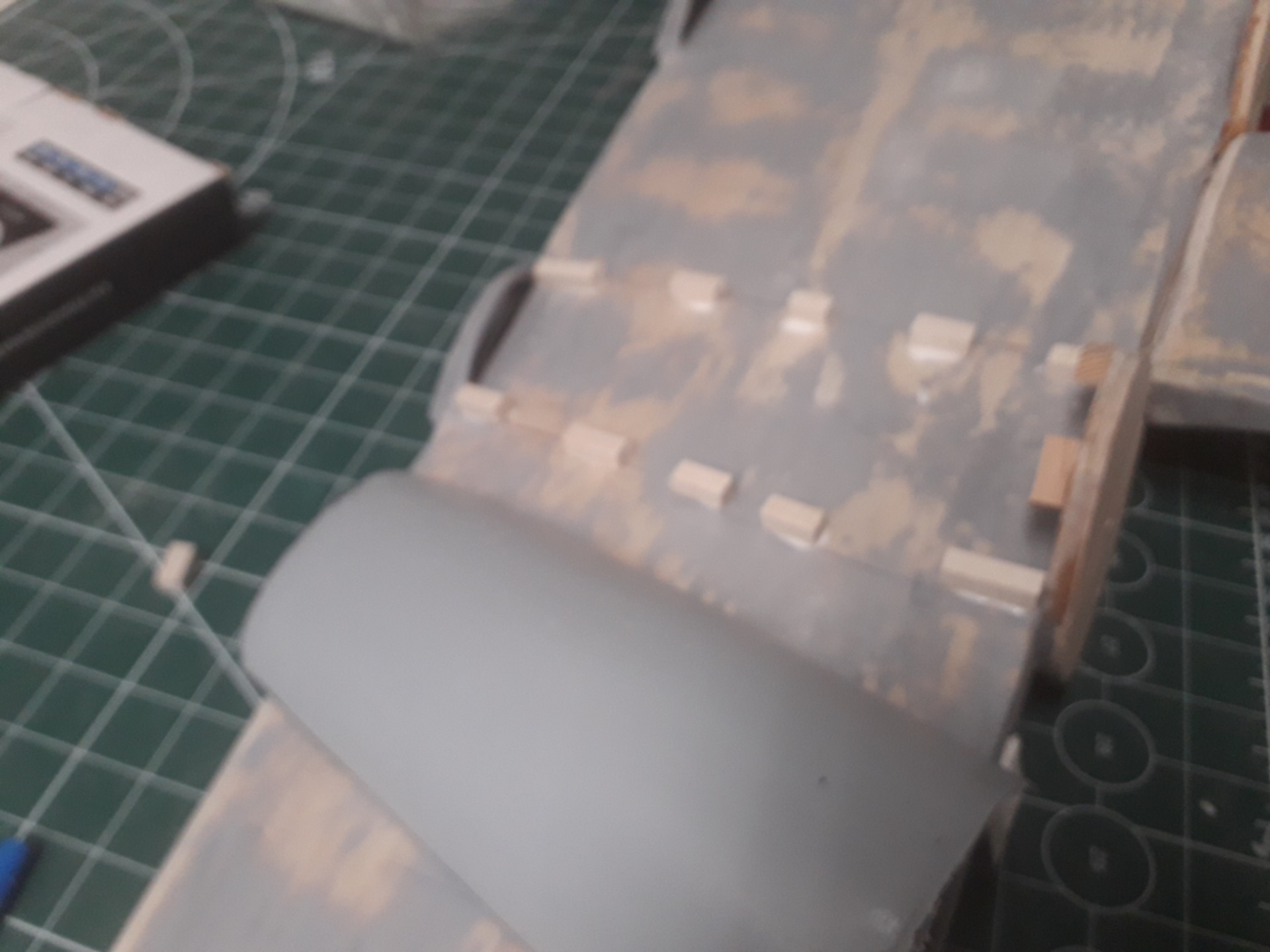

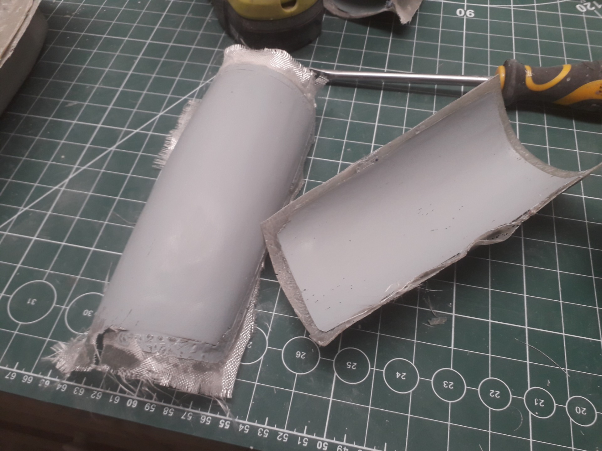

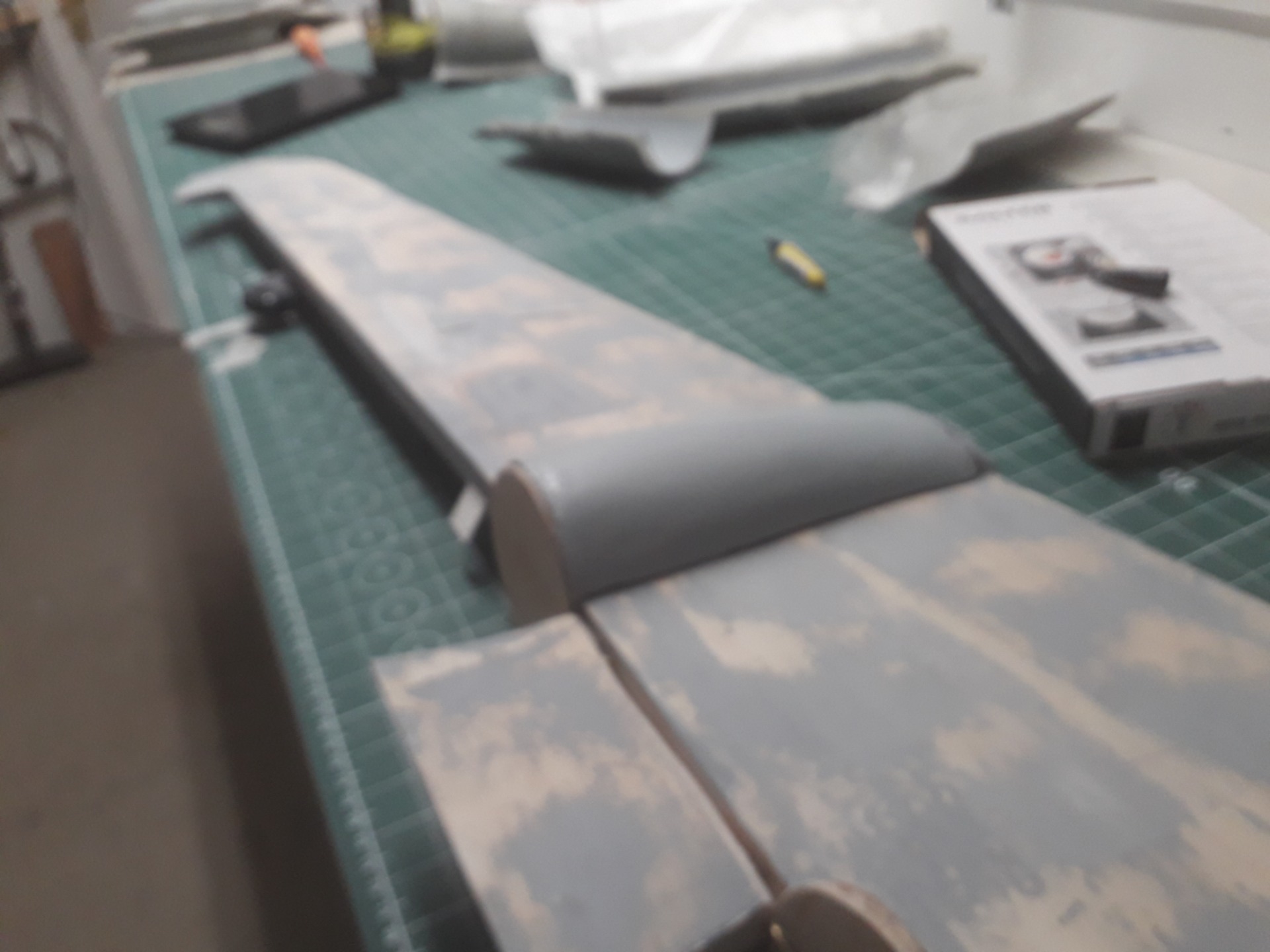

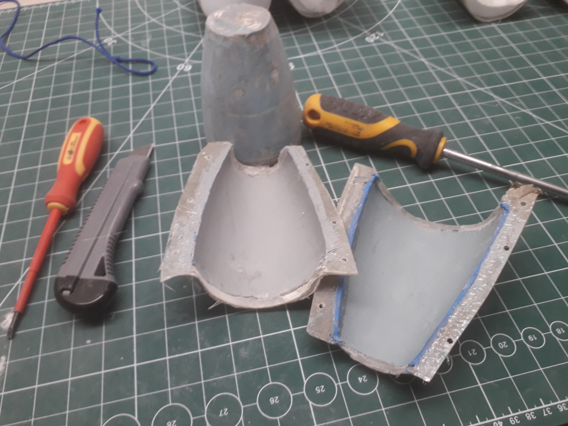

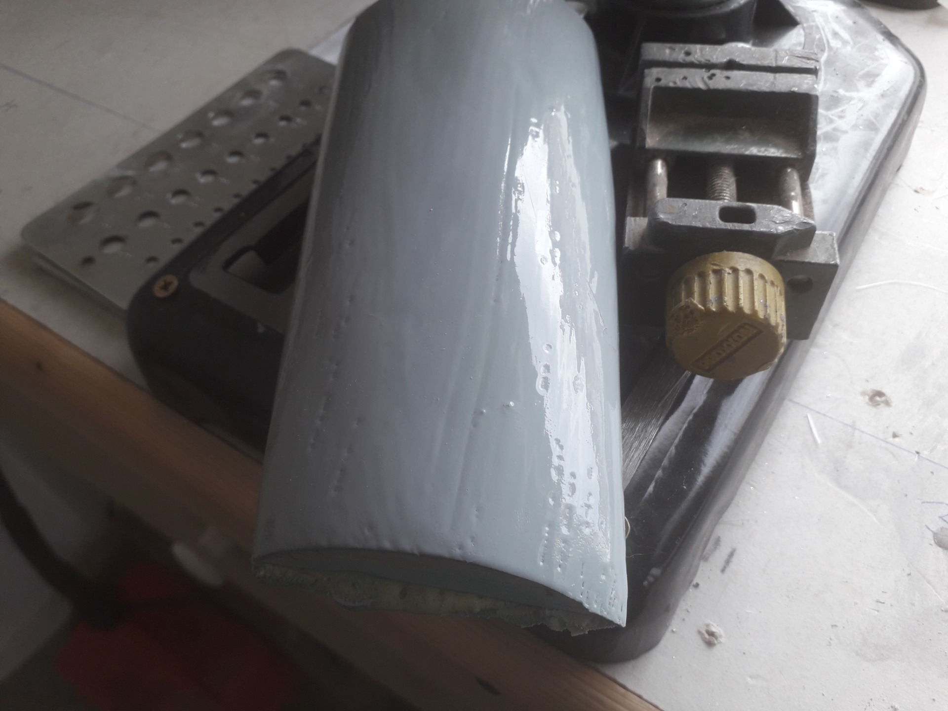

I have the mould for the cowls done
Also made the first of the air ducts under the wings
It weighs 1.5 g
And i cannot get the jet pod plug out :evil:
