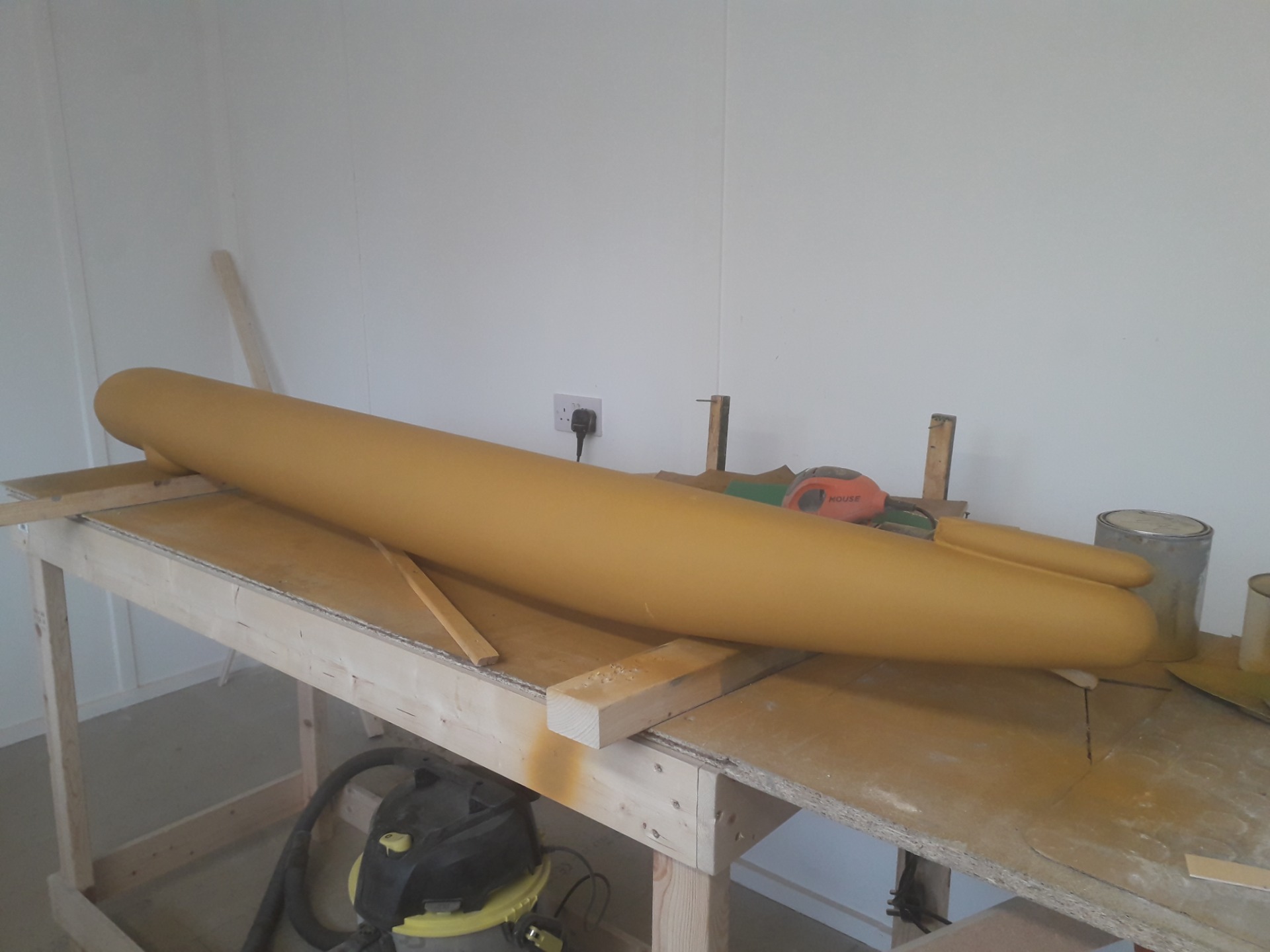

Iv crawled out of my death bed into the shed for half an hour
Wiped the plug down with acetone and given it its first coat of primer filler

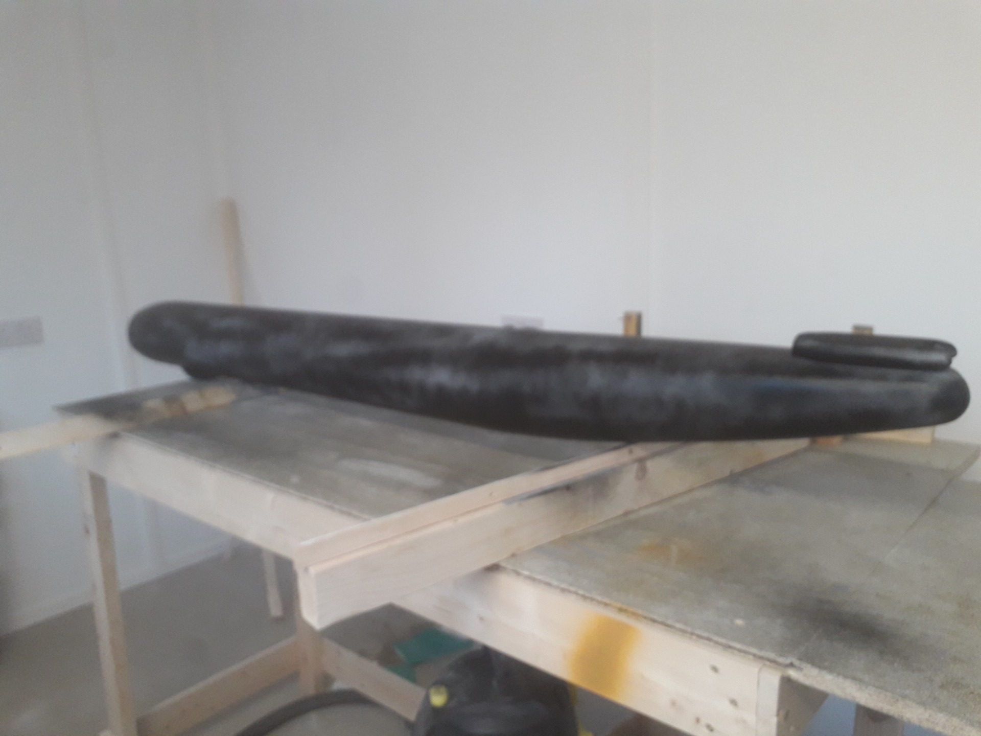

12 Feb 2020 00:14 #77 by THE BLACKBIRD
Replied by THE BLACKBIRD on topic Six Turning, Four Burning
Crawled out to the shed and gave it a light coat of black. Now when i sand it down any low spots will show up black
13 Feb 2020 17:14 - 13 Feb 2020 17:16 #78 by THE BLACKBIRD
After three coats of primer filler sanded back between each coat i had it spot on, looked good, very pleased with the outcome,
I cleaned it up hoovered the bench ready to wipe the fuselage with acetone, casually stroking my hand down it
Bugger iv gone through the glass in three places on the tail section
Had to glass some more cloth on to it
Last edit: 13 Feb 2020 17:16 by THE BLACKBIRD.

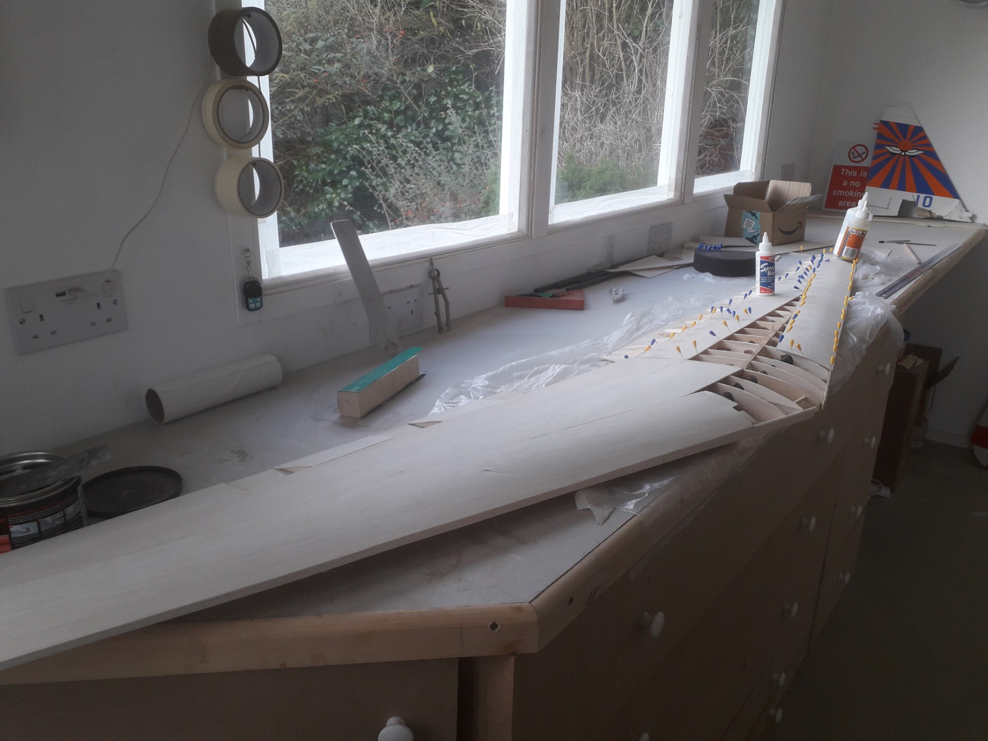

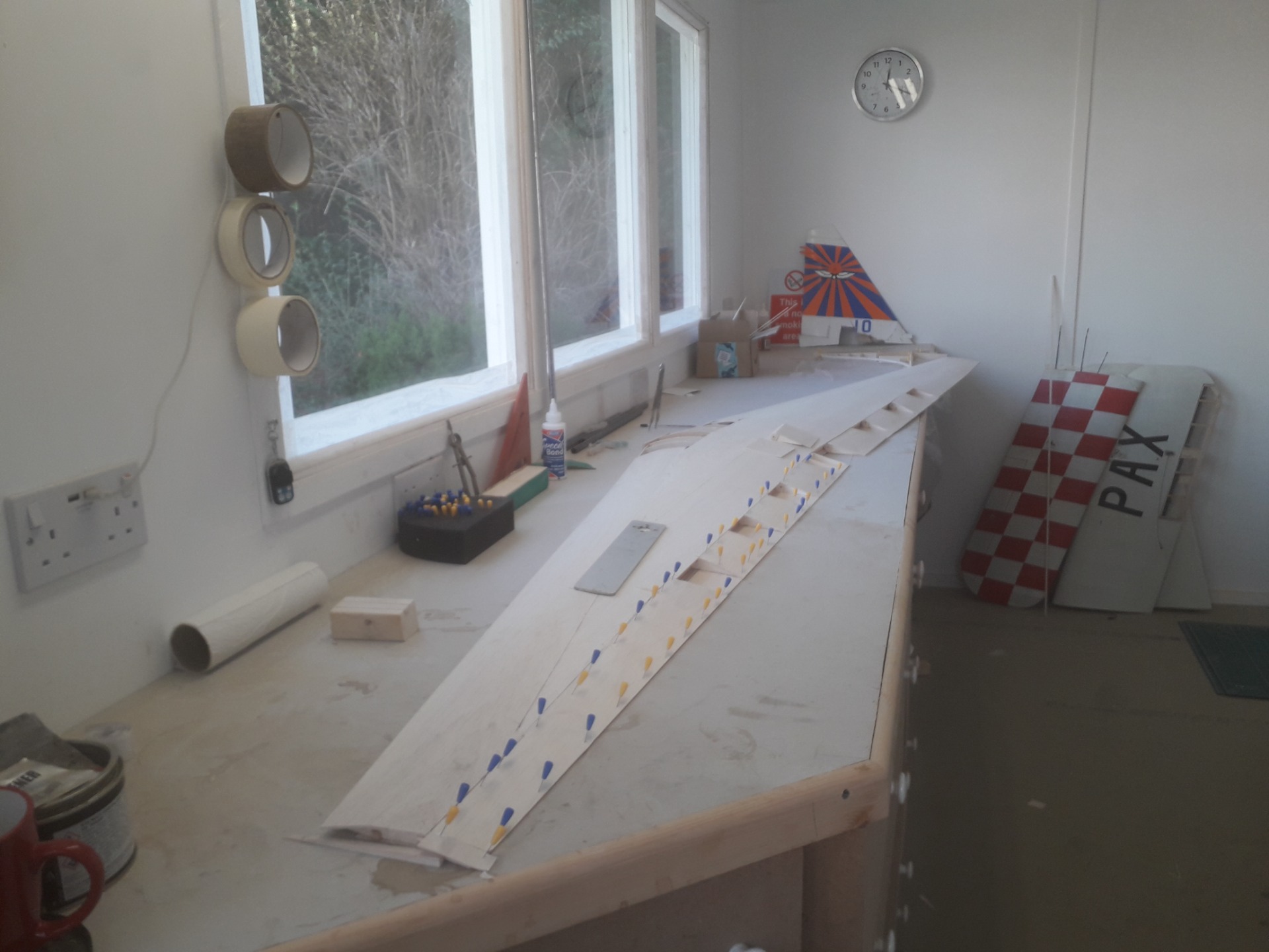

25 Feb 2020 11:06 - 25 Feb 2020 11:24 #80 by THE BLACKBIRD
The fuselage plug is now ready to finish painting
And the wings are started
I also contacted 4max for their advice on an electric set up
He thinks my weight estimate is way off, he thinks 20 / 25 lbs and has based his proposed set up on this figure, never delt with them as i think they are expensive, dont know how to put his email on here
But his power set is EXPENSIVE
Last edit: 25 Feb 2020 11:24 by THE BLACKBIRD.
Thanks: Phil Wood, Klipkopwildlife, Quorneng, Ralpharr2001, crash happy
25 Feb 2020 11:21 #81 by Quorneng
Replied by Quorneng on topic Six Turning, Four Burning
That's very impressive.
I presume the wing joint position means there will be 4 engines outboard of it.
Interesting that you have set the wing joint perpendicular to the airflow rather than aligned with the sweep of the wing.
Apart from the geometry involved I can't see it makes any difference.

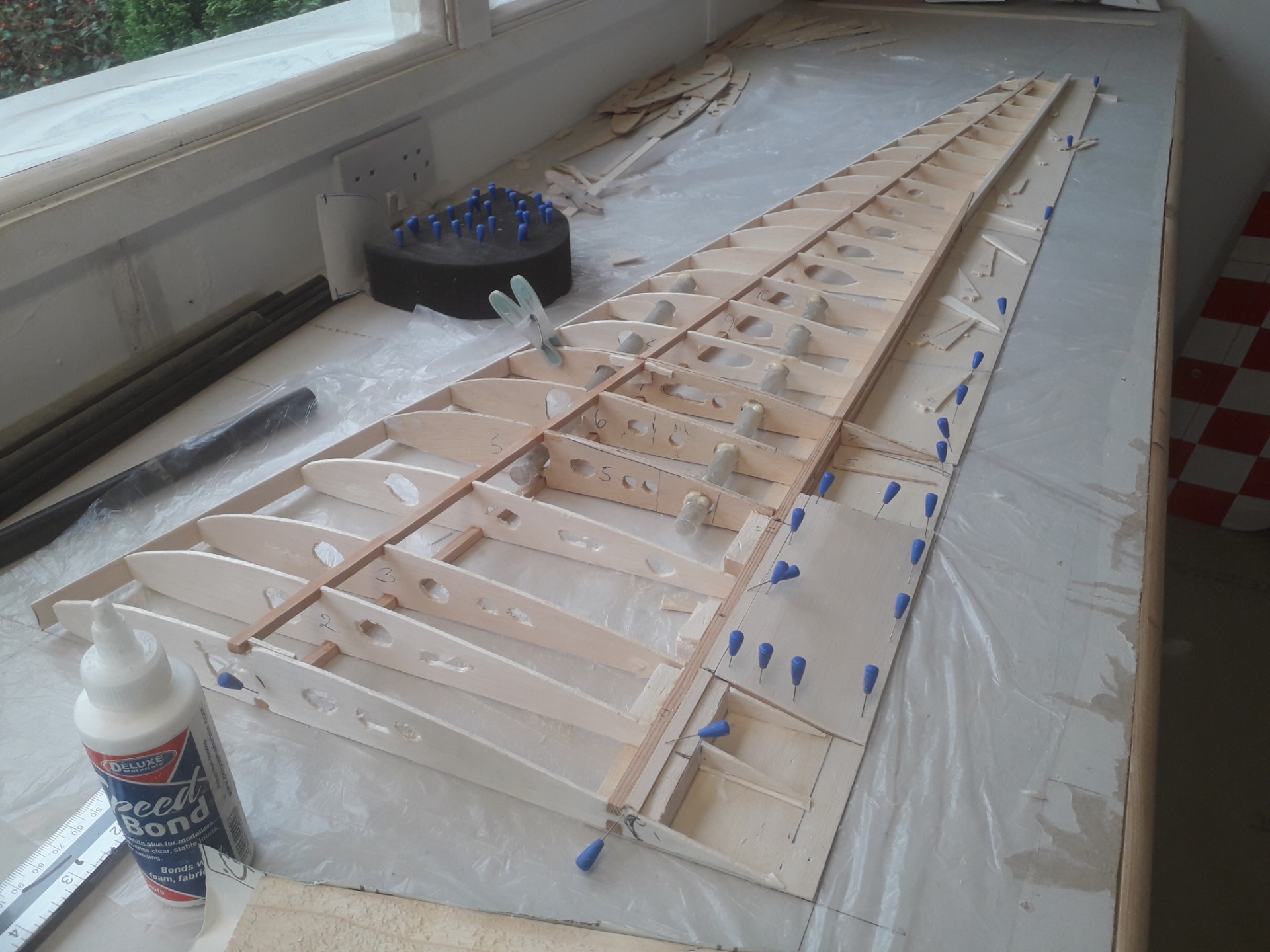

29 Feb 2020 21:17 #86 by THE BLACKBIRD
A little more done ⁹
