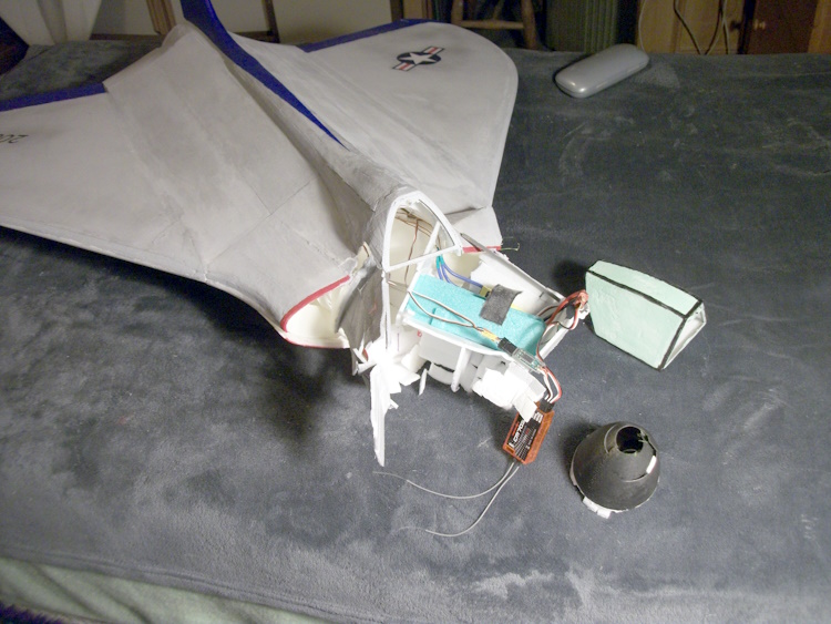

Well that did not go well!
Looked good to start with but a real nose plant!
I am pretty certain I know what happened. Would you believe it I had not set the ESC throttle range correctly. Doh!. The launch was at reduced power but the sudden loss of power as I moved up the throttle (the motor stopped dead!) had a dramatic effect.
The impact completely crushed the nose back to the intakes but everything still worked. The energy absorbing capability of the Depron ensured nothing else was damaged in any way.
The repair is not as significant as it might look as the nose was built as a separate unit originally
First the fuselage was 'cut back and 'made good' to the appropriate former.

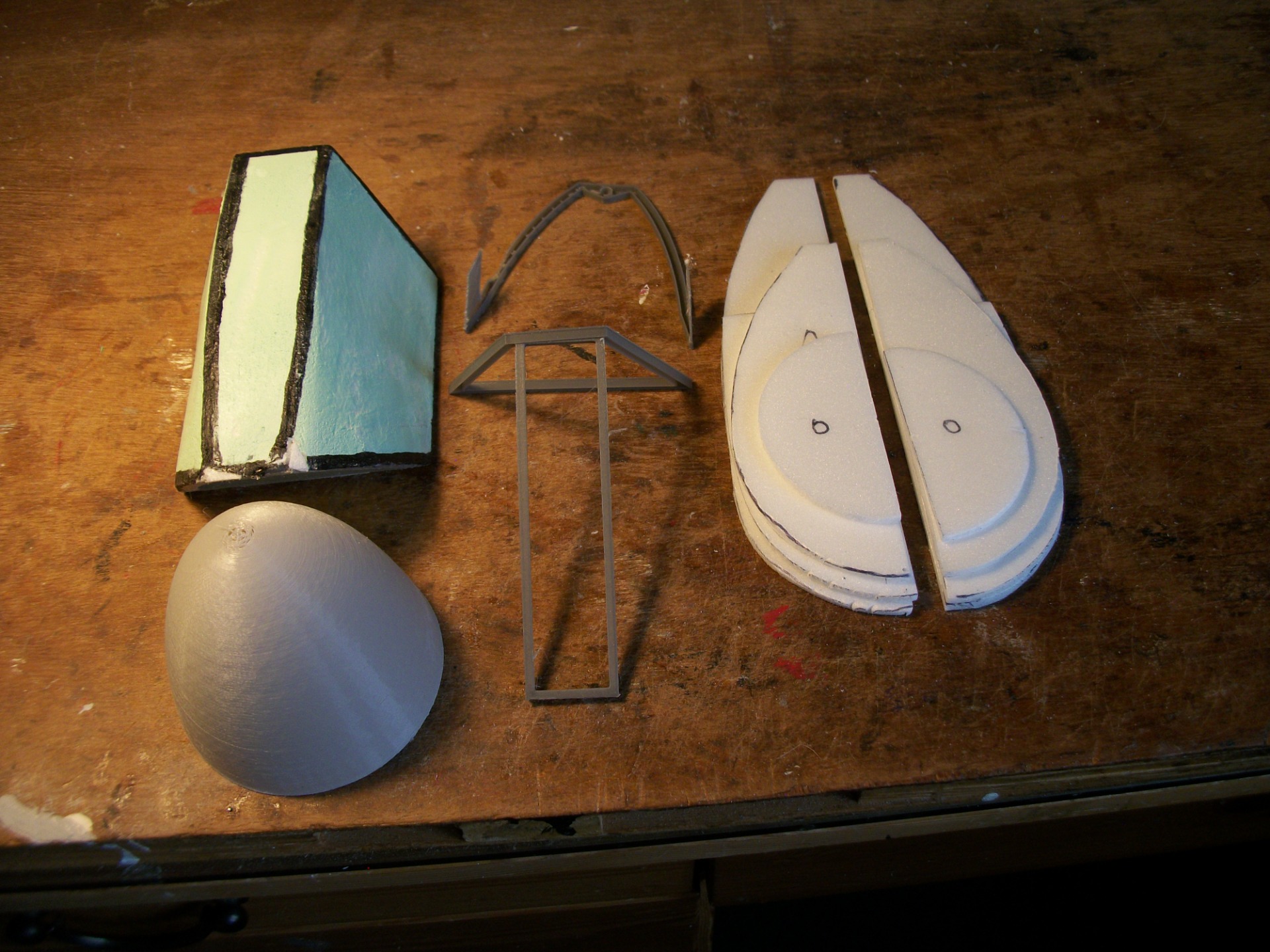

A new nose cone and cockpit frames were printed. Replacement Depron formers cut out.
The cockpit canopy was 'ejected' in the crash so was basically undamaged.
The original fuselage nose plan was retrieved.
Now ready to start building the new nose and all done on the same day as the crash.
"If you can build it from scratch then you can always repair it"

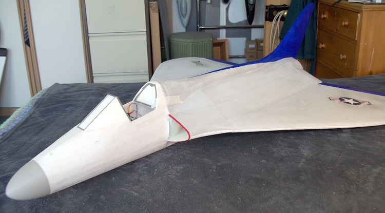

The new nose in place.
Once the glue has set it needs a bit of filling and sanding.
Then fix all the "electrics" back in the cockpit and test it still works.
21 Jun 2023 23:54 #53 by Quorneng
Replied by Quorneng on topic A bigger Skyray
Almost done.
Still got to organise fitting the Rx in the cockpit and some paint to finish off
