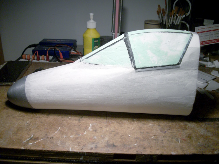

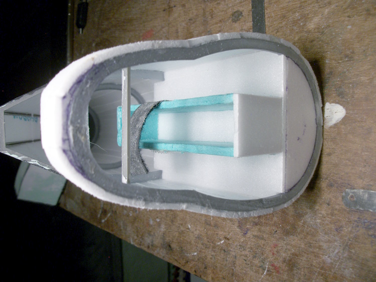

Another day going almost non stop and the nose section is now complete.
The cockpit has a flooor with the "salvaged" battery box added.
The cockpit floor is glued to both the formers and the skin so provides torsional stiffness to the "open" cockpit area.
The nose ahead of the battery box is completly empty.
 Maybe a good place to put the receiver.
Now I have just got to glue the nose onto the jest of the Skyray!  .
Last edit: 30 Oct 2023 21:07 by Quorneng.
30 Oct 2023 21:31 #77 by Eric
Replied by Eric on topic A bigger Skyray
I would advise against putting the receiver in front of the battery - in case the floor hits it again, the receiver stops, and the battery doesn't!
31 Oct 2023 10:51 #78 by Quorneng
Replied by Quorneng on topic A bigger Skyray
If I place the receiver in the nose it would be low down next to the skin. It would thus be below the level of the battery. In an impect hard enough to dislondge the battery it would pass over the receiver.  It will be using a Lemon 2.4 6ch that is in a plastic case not a sub micro 35meg 4ch with an exposed crystal!

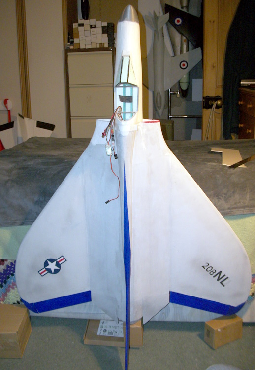

31 Oct 2023 21:36 #79 by Quorneng
The nose  is on!
It will have to sit like that for a couple of hours for the glue to dry a bit.
This shows the "electrics" that will have to find a home in the cockpit.
I may have to shorten some of the wires!
31 Oct 2023 22:00 #80 by THE BLACKBIRD
Replied by THE BLACKBIRD on topic A bigger Skyray
The top picture the nose looks to be on a little scewed
01 Nov 2023 07:49 #81 by Eric
Eoither it leans a degree or so to the right - - or the three-drawer cabinet behind is leaning a bit to the left!
01 Nov 2023 09:15 #82 by THE BLACKBIRD
I was lining it up with the fin,
01 Nov 2023 09:56 #83 by Quorneng
I thought that picture might cause some comment.
The Skyray is not sitting vertical in the picture nor was the camera 'square on' to the plane. If you line up the nose with the actual fin, not the blue line on the top of the fuselage, the nose is pretty straight. The original nose was lined up with the blue fuselage line meaning the fin was out.
What you can't see in the picture is the nose itself has a slightly "banana" as well as a tiny twist along its length, all courtesy of the difficulties of using printed formers that you can't pin the planks to during construction!
However compared to the enormous wing area and any differences built into that I am sure any oddities in the nose shape will make no difference to how it flies.

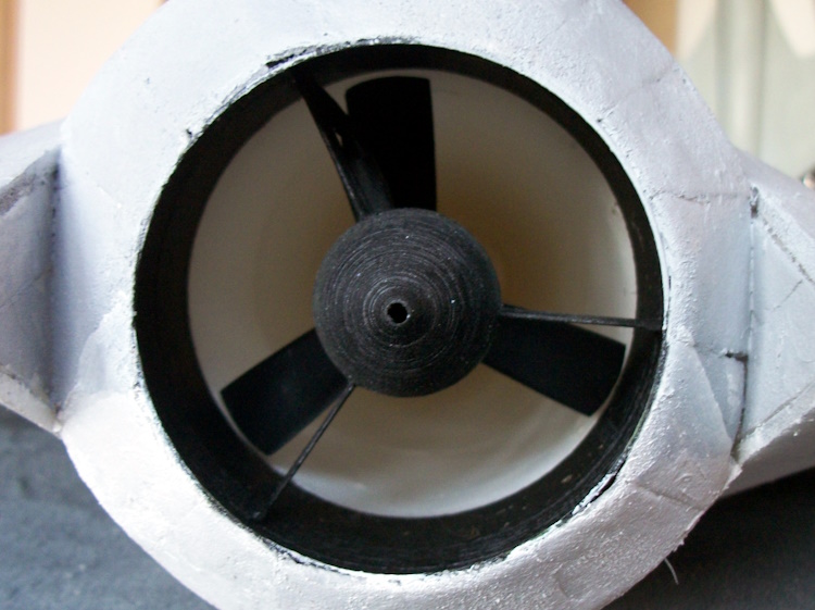

25 Feb 2024 11:52 #84 by Quorneng
After yesterday's flight showing it was rather underpowered on a 3s I flew this morning with a 4s albeit with a lower capacity 1300mAh  but giving virtually the same weight as the 1800 mAh 3s.
Quite eventful as after 4 minutes it was being chased by a big black dog! I had no option but to fly on until it was back on its lead in the car park.
After 8 minutes I was getting very concerned it would "run out of juice" particularly as it was a completely untried battery combination.
I need not have worried as subsequent testing showed it only draws 8.5A at full power on a 4s suggest a flight of 12 minutes would be possible.
Apart from being very light for its size the primary reason for the duration is it is not a conventional EDF but is powered by a tiny 28g  2805 drone motor driving a 3x4.5 3 blade prop,
Another to add to my collection of "silly" planes.

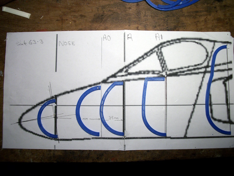

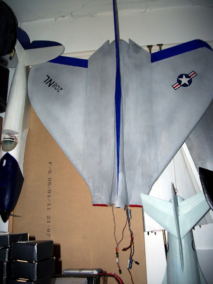

02 Nov 2024 20:29 - 02 Nov 2024 20:30 #85 by Quorneng
The lightweight Bigger Skyray has been hanging on the wall without its nose since May last year.
I thought it was about time I built it a new one.
The set of printed fuselage half formers over the plan.
It could take some time.
Last edit: 02 Nov 2024 20:30 by Quorneng.
