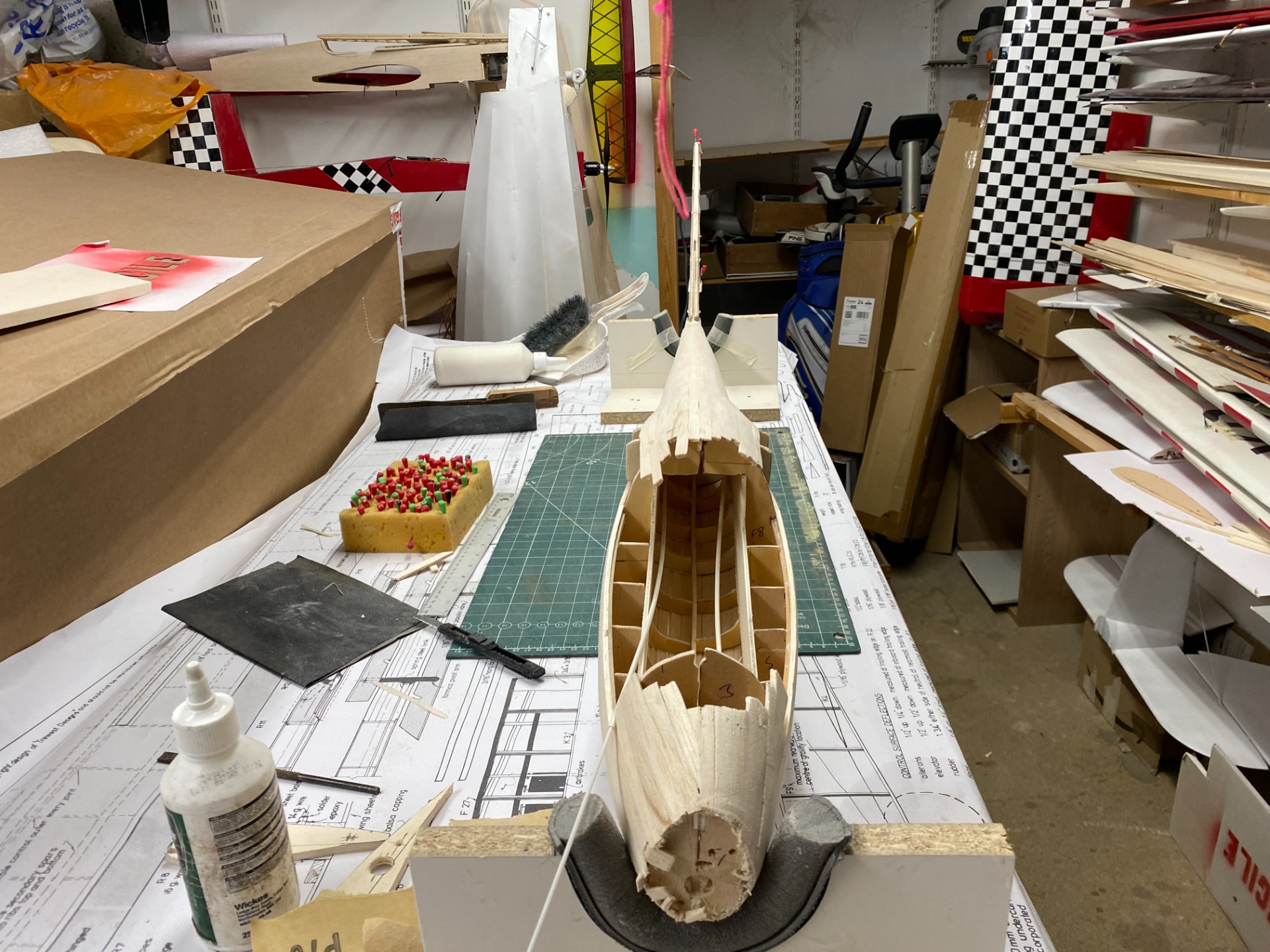

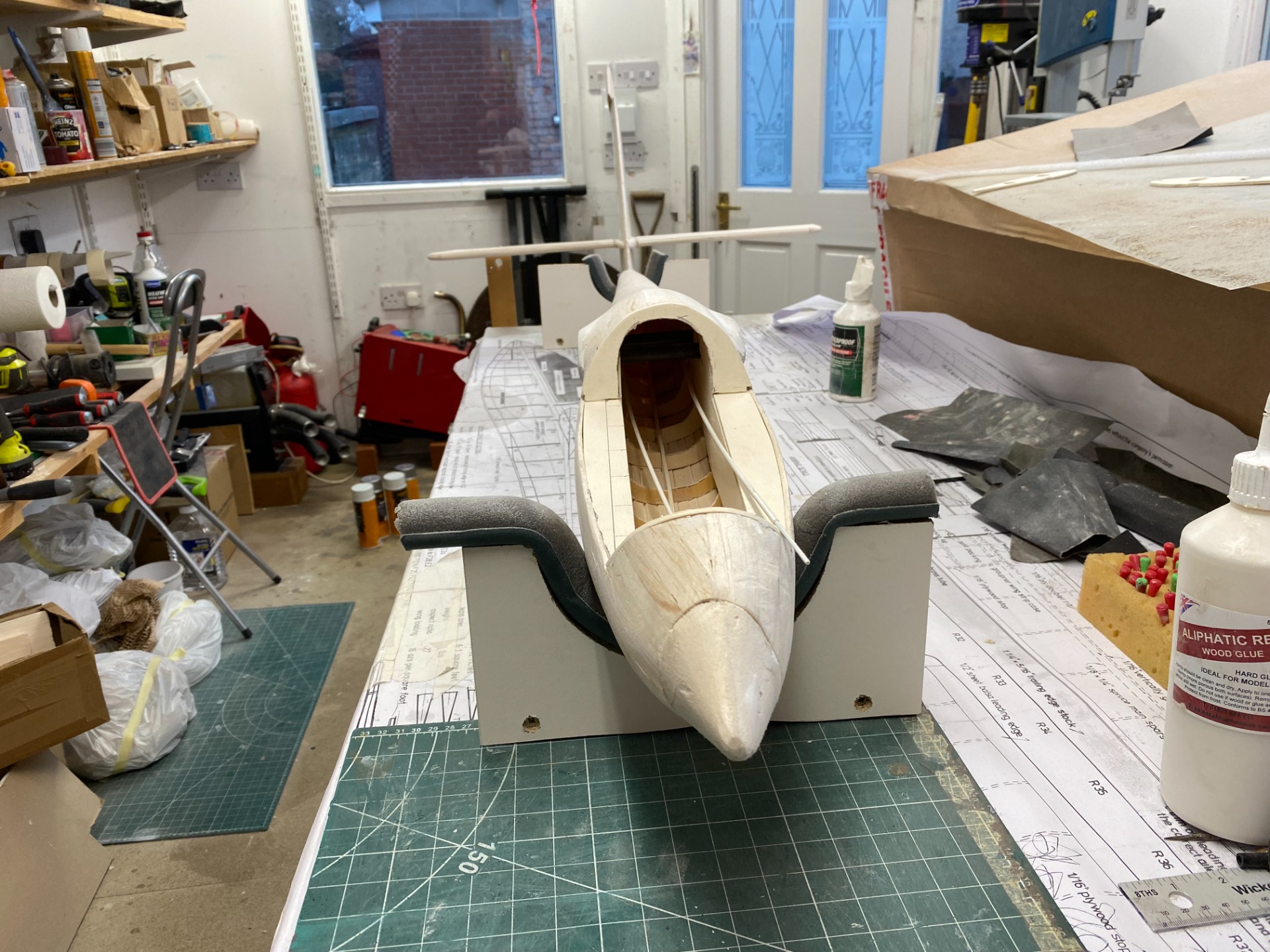

No its strait and very strong on the long narrow fuselage even with only half of it built, its planked with 3mm balsa, but by the time its all sanded down it will be 11/2 mm
Launch will be by bungee or slope soring even aerotow, but that will not concern me as ill not be able to go flying with no transport

I see that the plan calls for building two half fuselages, including the planking, then butting them together for sanding. That would keep it all straight.
Not the way you are doing it?.
27 Nov 2025 13:30 - 27 Nov 2025 13:35 #109 by THE BLACKBIRD
Replied by THE BLACKBIRD on topic ASW 17 Sailplane
IT IS STRAIGHT

With those relatively long thin planks and with a bit of care and attention I would expect it is straight.
Planking as a half shell over the plan is no guarantee it will remain straight once it is lifted from the plan. If there are any warps it is by then too late to do anything about it. You just have to hope the other half will come out the same so when joined they cancel each other out!

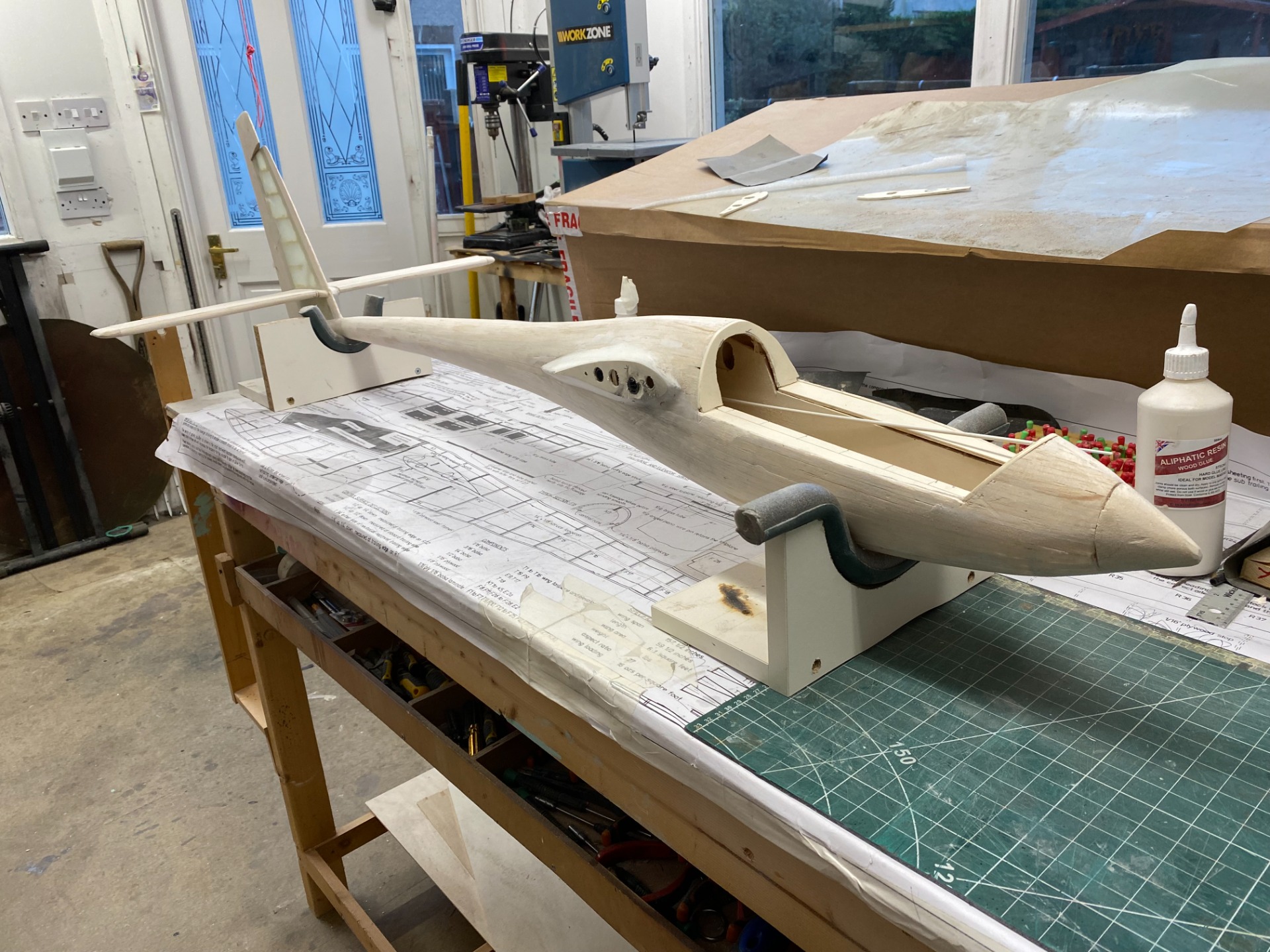

Straight as an arrow
Only bent where it should be

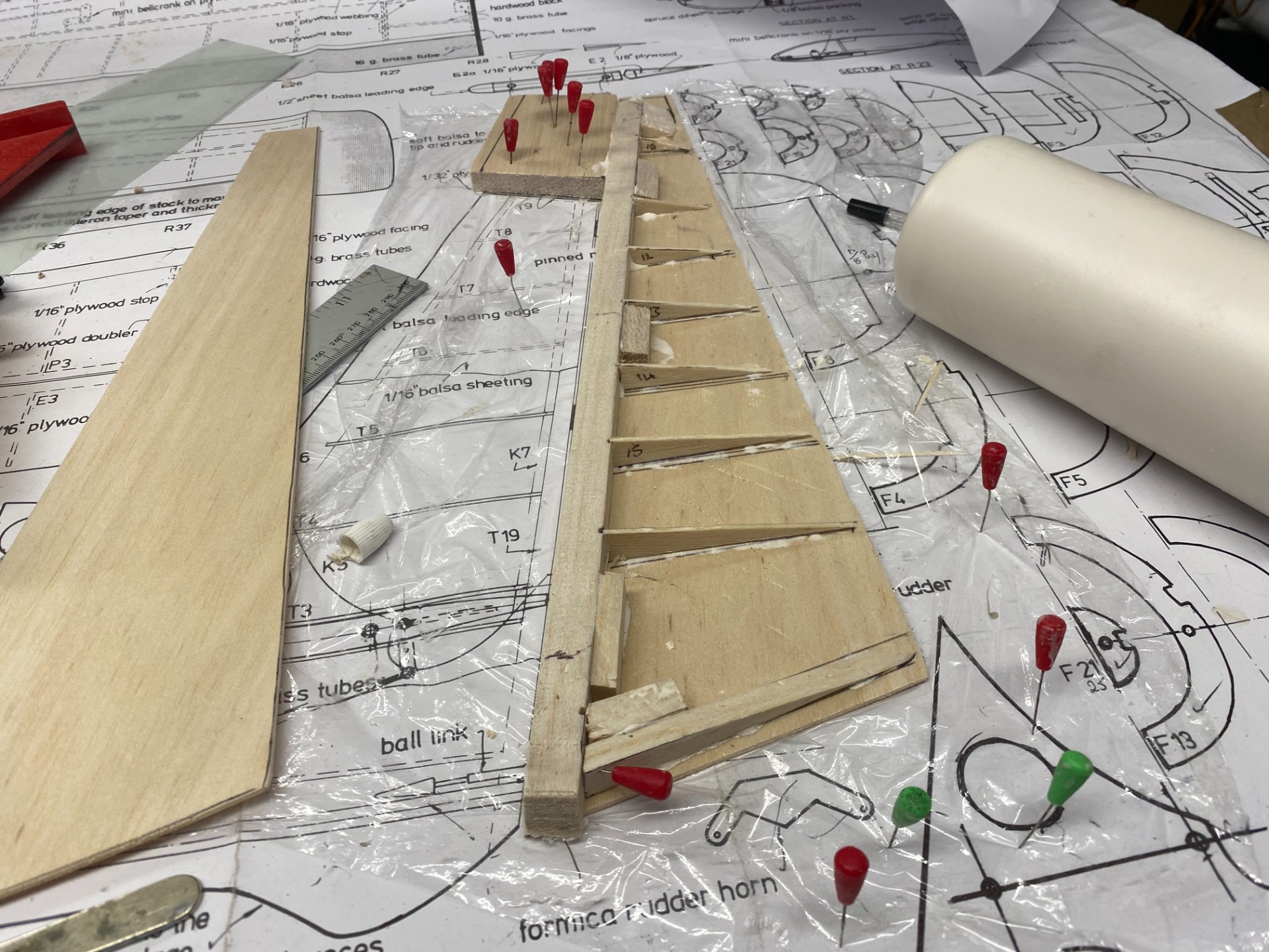

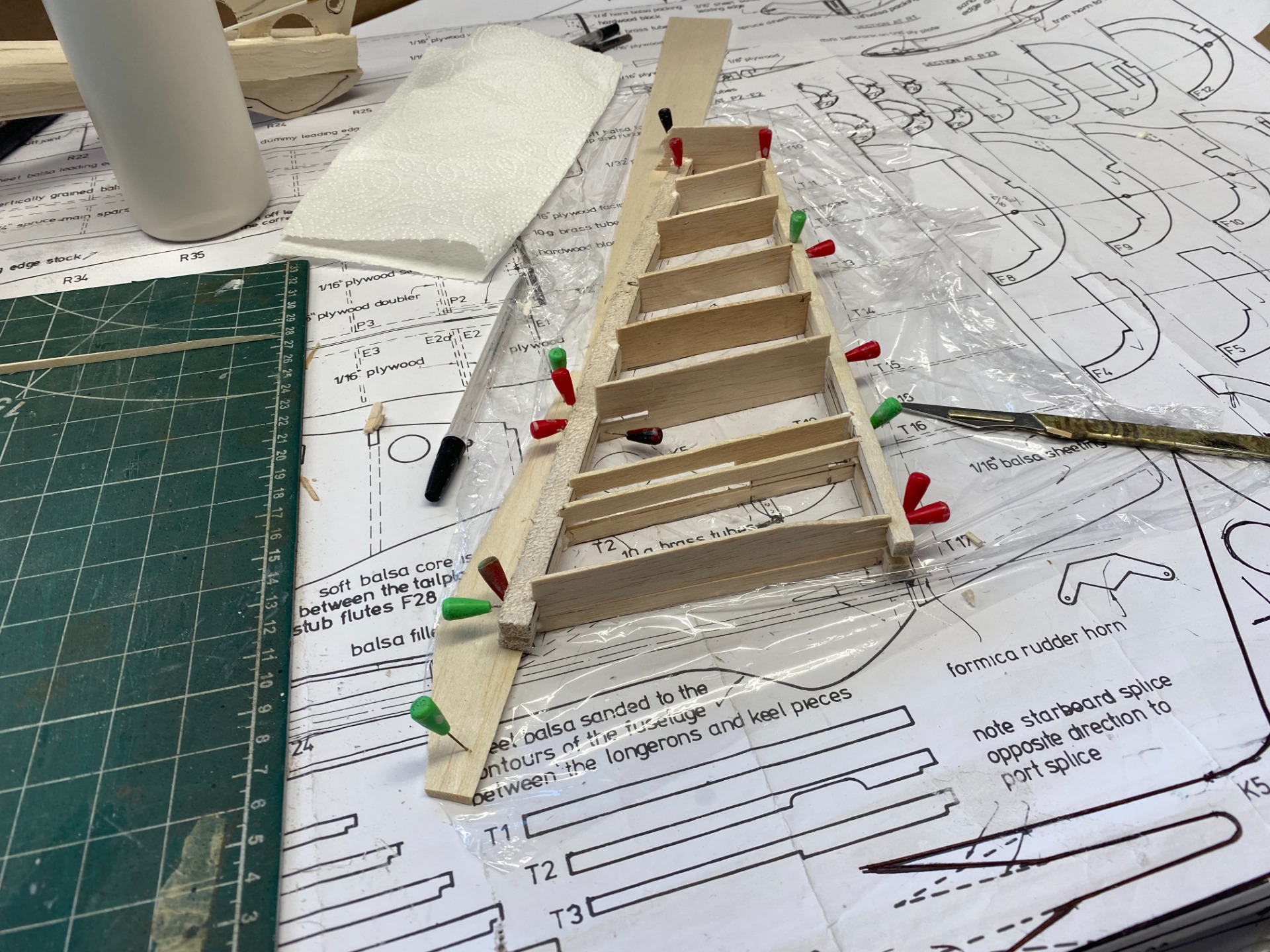

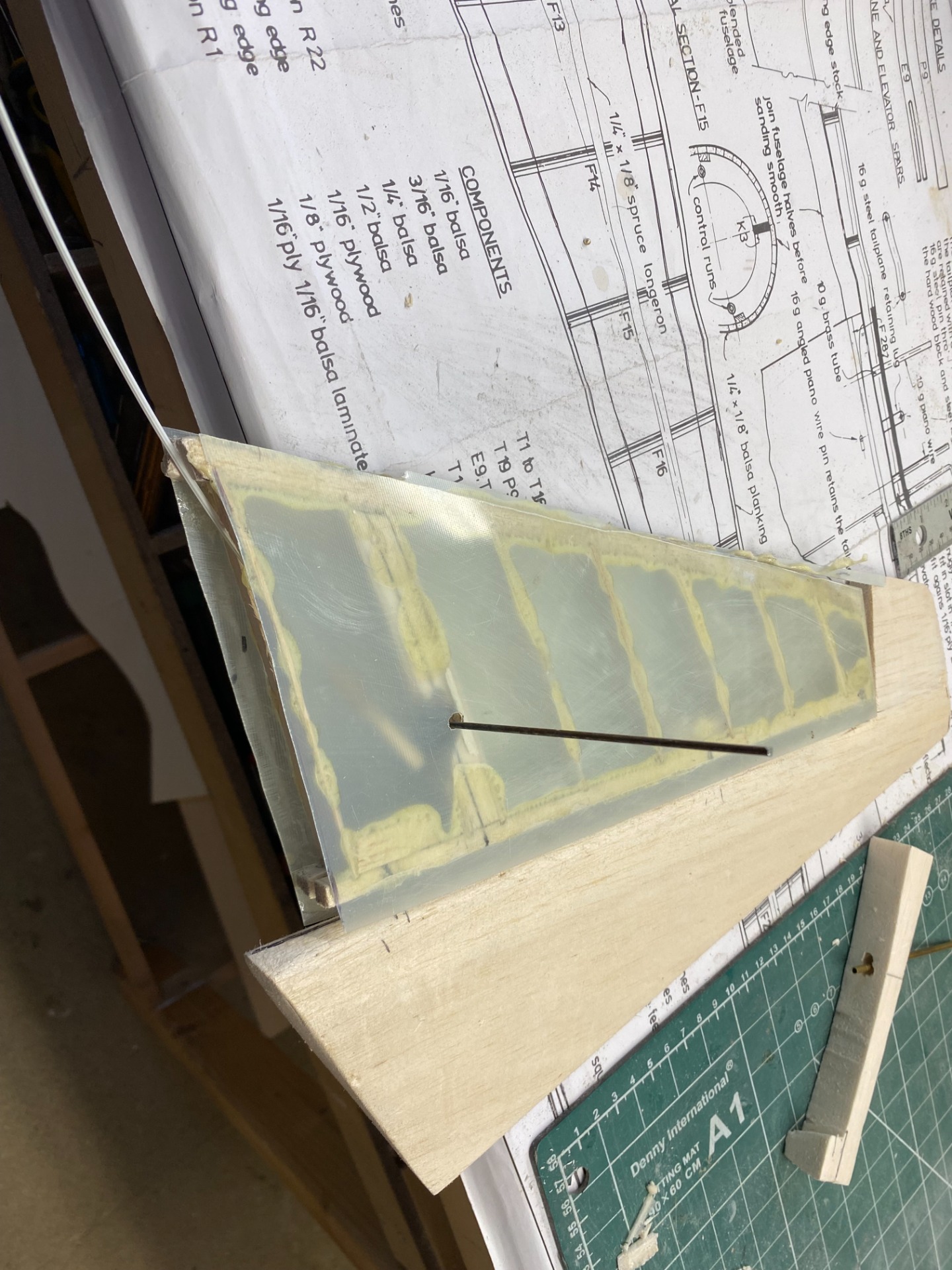

On to the fin, i had to make some changes to the way it is built. l did not like the back end of the fuselage and the way the fin was mounted
And the rudder

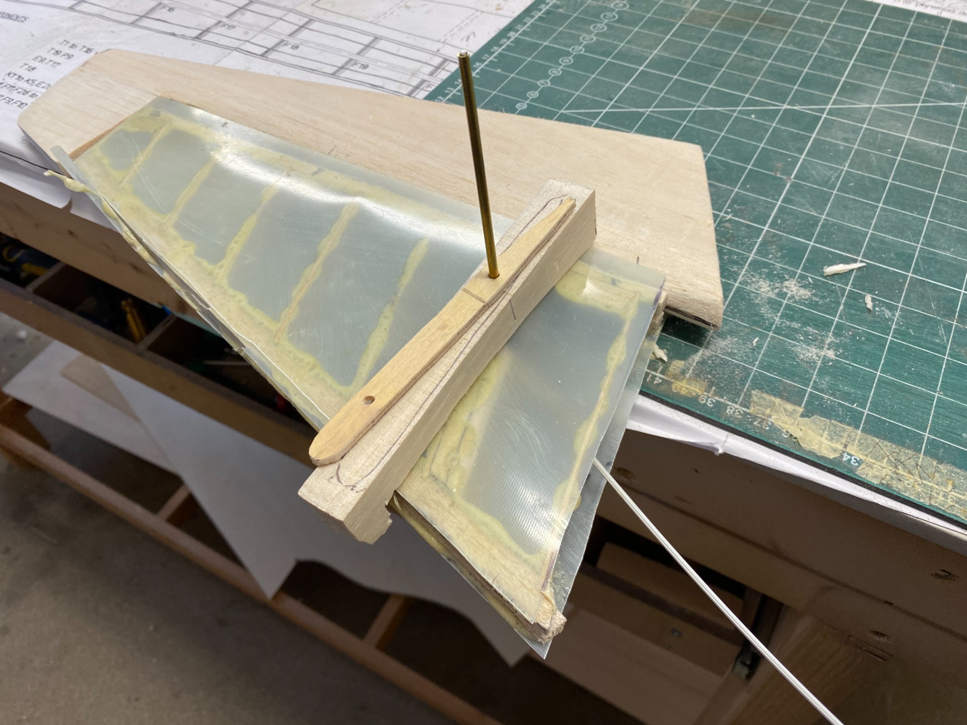

covered the fin in proskin to give it a lot of strength as it carries the tail plane, i silver soldered an elevator horn up and fit it in the fin before the final skin went on
It is a very tall fin and rudder

That looks like an all-moving tailplane - and I can see an error. You've put the pivot in, but where's the other wire that moves in the curved slot to actually move the tailplane?

I don't see a problem there Eric, the snake has a clevis which attaches to the arm that's soldered to the elevator mounting rod, the trick is going to be securing the elevators to the rod.

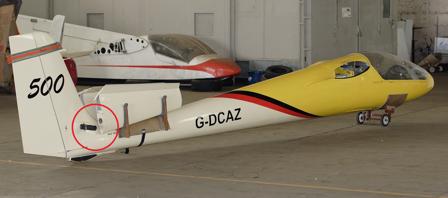

Not quite sure of the chord of the ASW17 tail plane but if it is all moving it is conventional and maybe essential for it to pivot around its likely centre of pressure to avoid putting a considerable load on the control linkage. That pivot rod looks to be well aft of the likely centre of pressure of the tail plane.
This is a picture of the parts of the all moving tail plane on a Slingsby Dart.
Note
a) The size of the pivot rod. It actually a substantial diameter tube!
b) How far forward its pivot point is compared to the root chord of the tail plane.
Just saying.
ps That moveable surface on the tailplane is not the elevator it is a big adjustable trim tab.

The pivot wire runs through the centre of the internal bellcrank as shown. That is also normally at about 1/3 chord of the tailplane. There should be another wire that goes through the angled other end of the bellcrank to the control rod. THAT wire is the one that drives the t/p to control pitch.

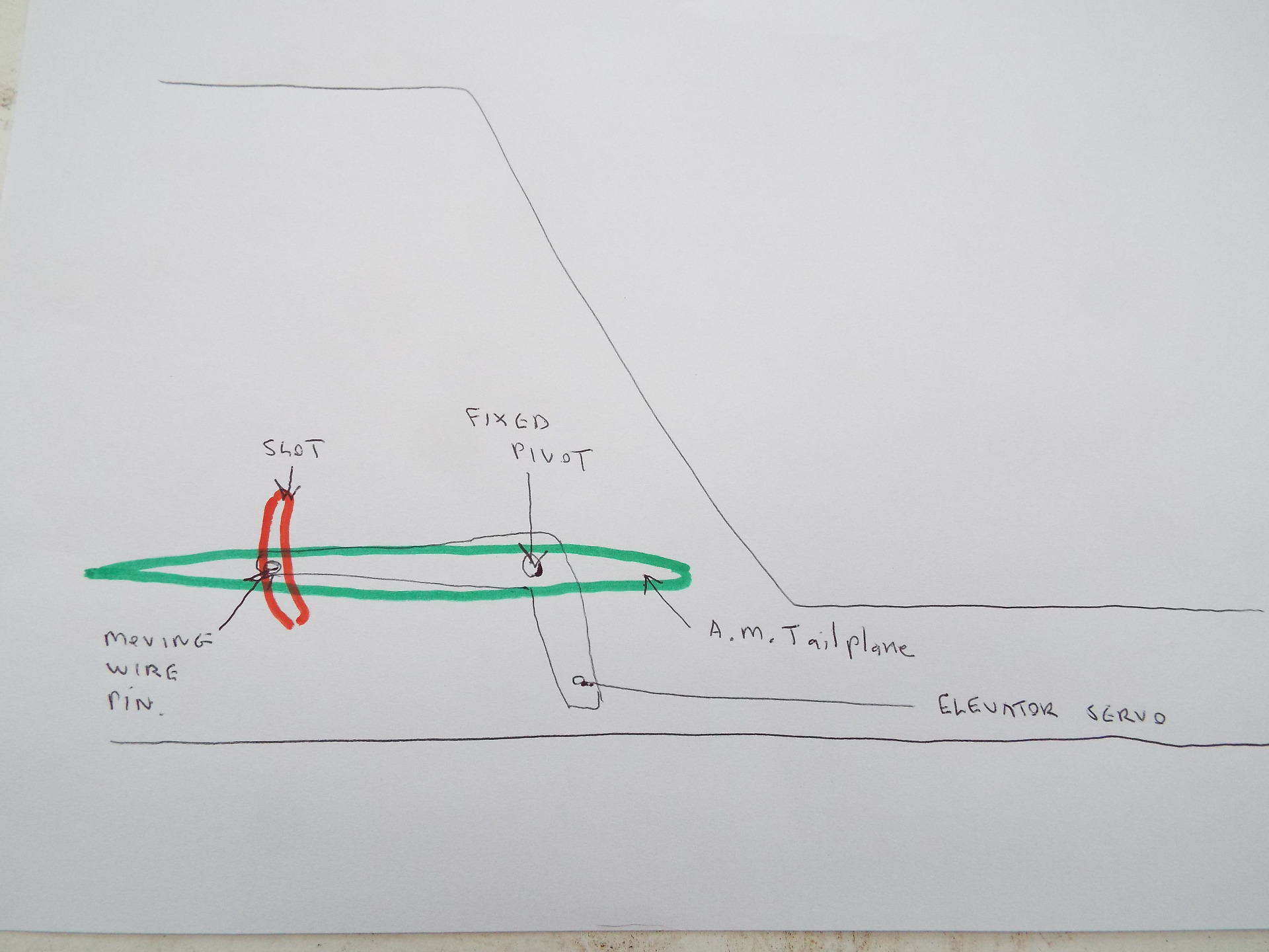

Found a work-around - Draw it - photograph it - download it to the pc - transfer it - and post it! (if it works!)
What I was trying to explain about BB's all-moving tailplane lacking a drive rod -

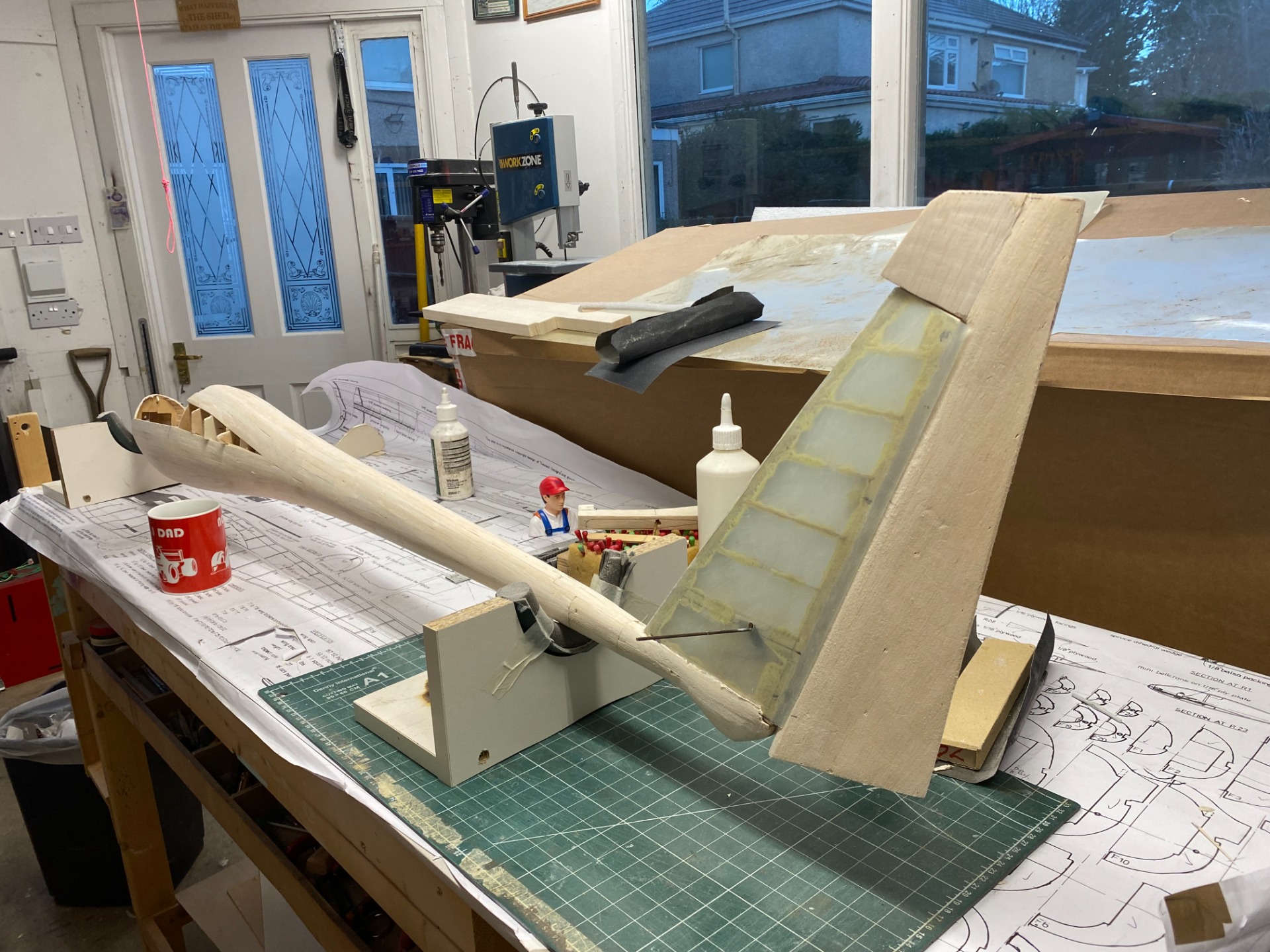

Not been well with the weather causing me problems with my knackard body, but done a little more
The tail planes slide on to the fin for ease of transport

That is a spectacular fuselage but just ahead of the fin it looks ever so thin.
It will break exactly there if you get into any sort of significant ground loop - just like the full size one I saw a few years back!
