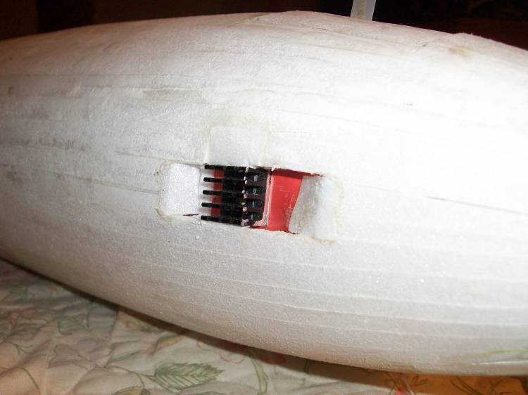

I thought the battery was running down to LVC but it appears the ESC is over heating (it reduces power if it gets over 110 degrees C :ohmy: ) so I have increased the size of the cut out over the heat sink.
It might however require a more 'engineered' solution.

Try a little 'bridge' over the vanes, to force the airflow through them.

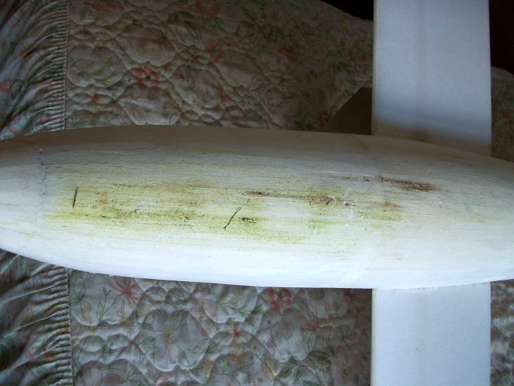

Flew again this morning but the video is almost useless. This still is about the best bit.
The additional cooling vents have helped but at full power the ESC still over heats, nevertheless it flies well at reduced power giving a duration in excess of 10 minutes.
The wet soggy grass leaves its mark!

18 Mar 2013 19:17 #85 by Sarah-Jane Smith
Replied by Sarah-Jane Smith on topic Fi 103 - the other V weapon
Will video it for you if you like when I come get those batteries. Paint the bottom green, problem sorted :woohoo:
18 Mar 2013 20:43 #86 by Quorneng
Replied by Quorneng on topic Fi 103 - the other V weapon
The underside cleans up well enough but rather than paint it green (neat idea!) I have stuck a clear plastic strip on the underside to give a bit of protection to the Depron as well.
Working on a stencil for the USAF markings.
Next calm day you can certainly video it - after you have flown the trainer through all three batteries! :P

As so much of the nose has to be rebuilt I am taking the opportunity to completely revise the ESC cooling arrangements.

My solution to the overheating issue consists of removing the shrink wrap that covers the heat sinks, placing the ESC flush with the surface of the fuselage and ducting air under it as well.
The under duct vents into the fuselage to exit through the launching finger hole. ;)
Well that's the theory! We shall see.
