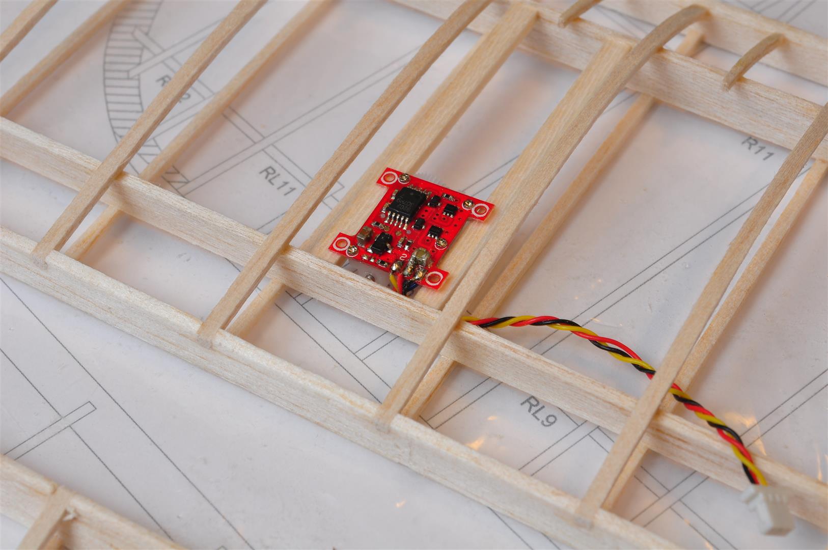

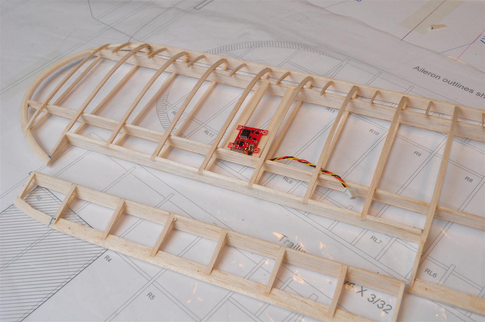

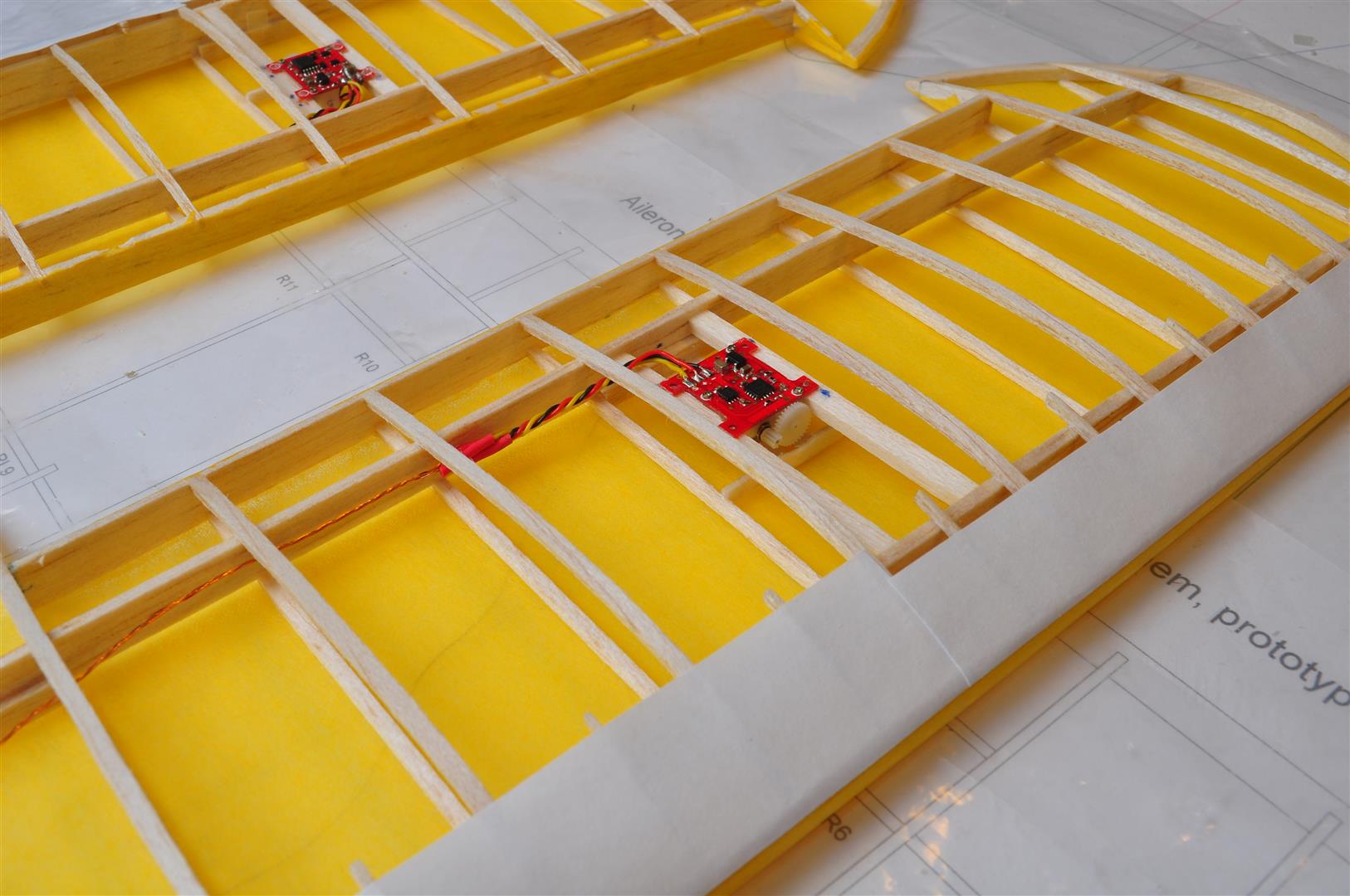

20 Mar 2018 09:38 - 20 Mar 2018 10:10 #283 by Septic
Unfortunately due to inclement weather the Indoors Scale R/C Nationals was cancelled so I now have even more time to make improvements to my Piper Cub. I have been playing with adding ailerons to the wings. This gives much more control, and has allowed me to reduce the dihedral to scale. This months RCM&E covers how I have added the ailerons, and very effective they are too. However flying the model has highlighted that I had become lazy with the rudder, and the Cub turns with the rudder and the wings are balanced with the ailerons. So I have been putting in lots of practice on the sim and flying quads to get all the sticks moving, and not focussing on just the right stick (mode 2).
anyway some pics showing the new wings under construction:
tap - tap.......rivet
Last edit: 20 Mar 2018 10:10 by .

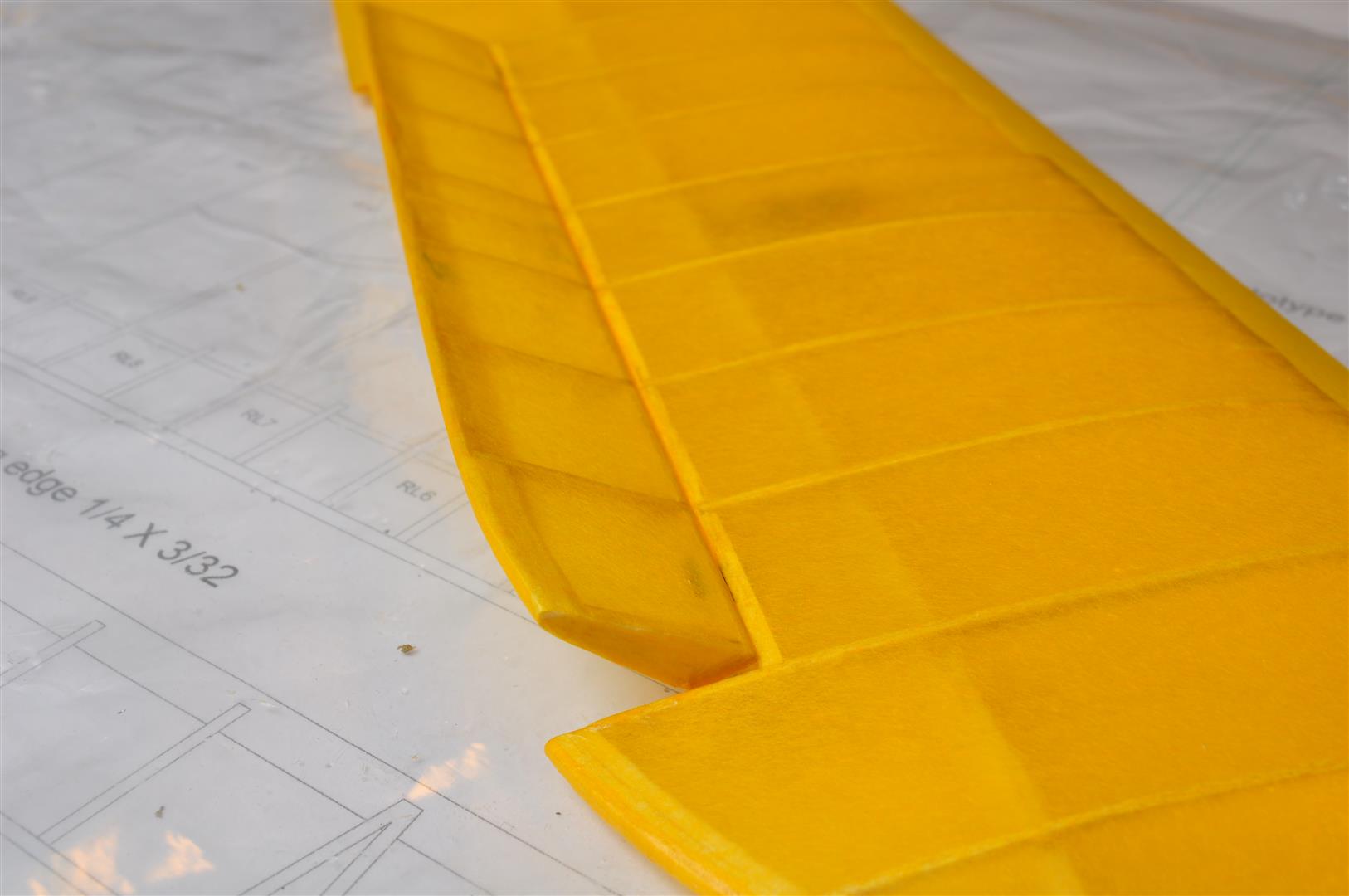

20 Mar 2018 09:42 #284 by Septic
One more picture showing how the ailerons are "pulled" down from their upwards resting position by thread. I have subsequently changed the thread for polyester clear or invisible thread, this doesn't "fluff" up as much when airbrushed.
The old wings weighed 10g each the new wings also weigh 10g each, but now include ailerons, servos, hinges and wire. So I am pleased that I have managed this with zero weight gain.
Thanks: Klipkopwildlife, Ex-Member, boz, Mike Rolls
