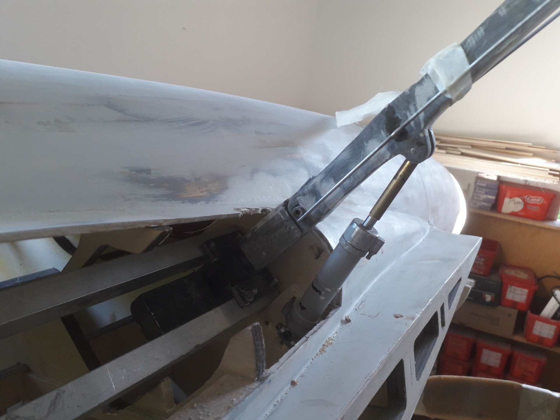

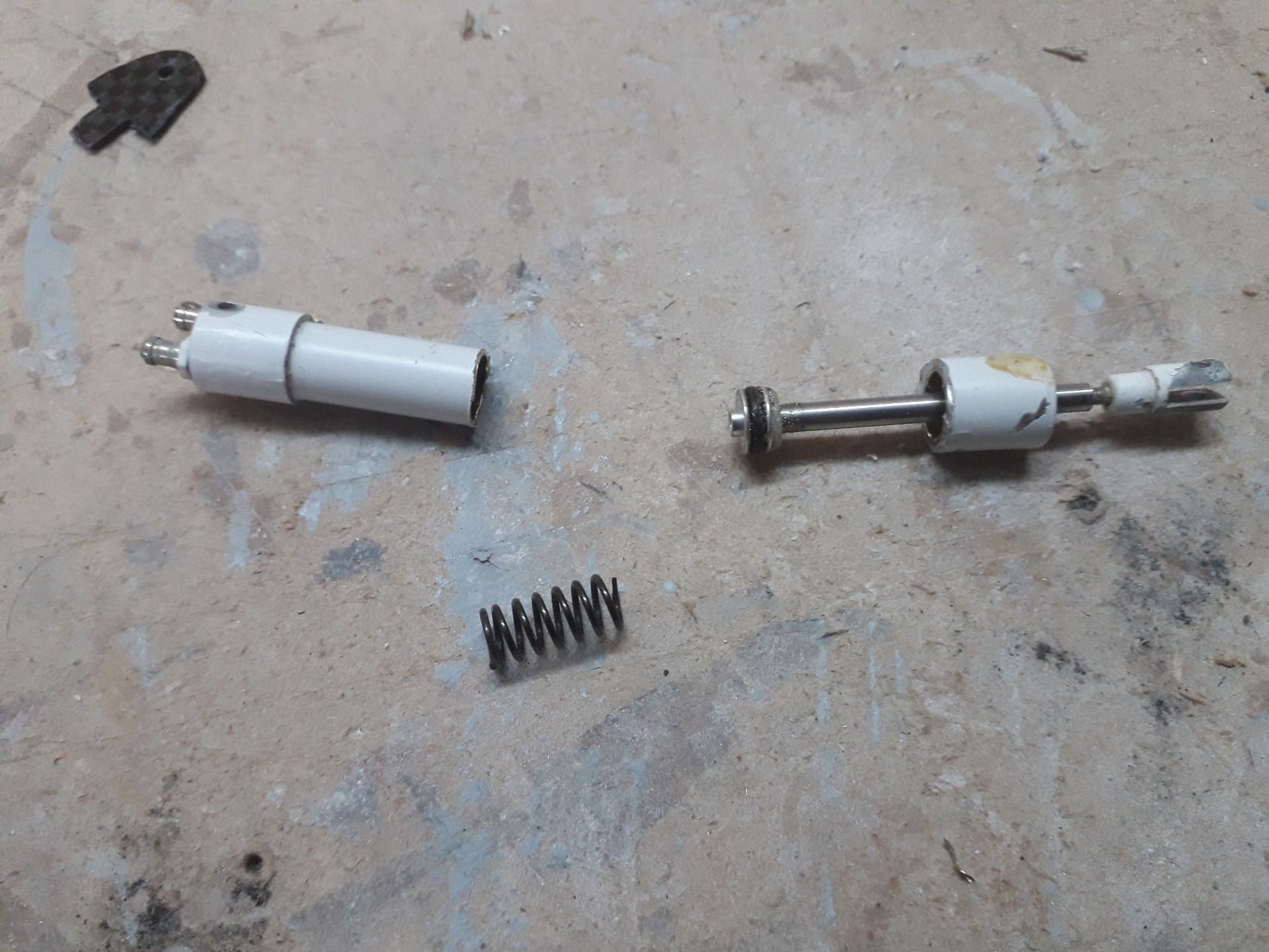

I have actually sorted it, got it to work ok, just having to add another ram to each leg to hold the leg straight when it retracts.
With having the joint where the leg pivots it tends to fold when closing
Had to cut a ram in two to get the spring in
Got the new gear doors cast

On your test rig you had the suspension leg positioned so it was almost vertical when the U/C was extended. From the pictures I would guess the spring unit would be working at 1:2 disadvantage - the spring would see twice the wheel load.
Now mounted in the fuselage the top of the suspension leg is much closer to the pivot axis so will be working at bigger disadvantage maybe as much 1:4. At this ratio Is the spring (it does look rather small) adequate for the planes likely weight?
13 Dec 2018 23:09 #260 by THE BLACKBIRD
Hi Simon the spring you see in the latest pictures is just for keeping the leg straight when it is retracting because as it retracts it looses the pressure of the main springs, here are two of these 1/2" in diameter each 1" long in the main piston, the two main springs are very strong so I think they will be ok
Time will tell of course
Thanks for asking and keeping me in the right direction as it is all just coming from the top of my head

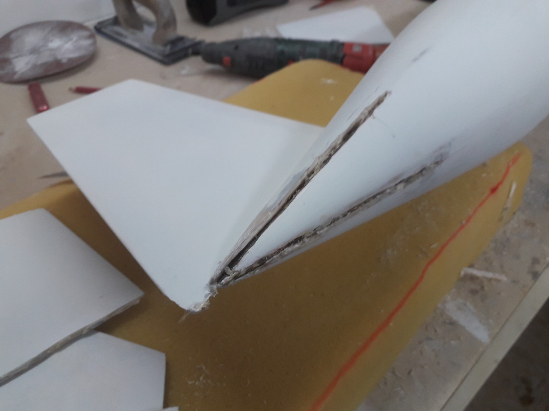

16 Dec 2018 19:50 - 17 Dec 2018 09:55 #261 by THE BLACKBIRD

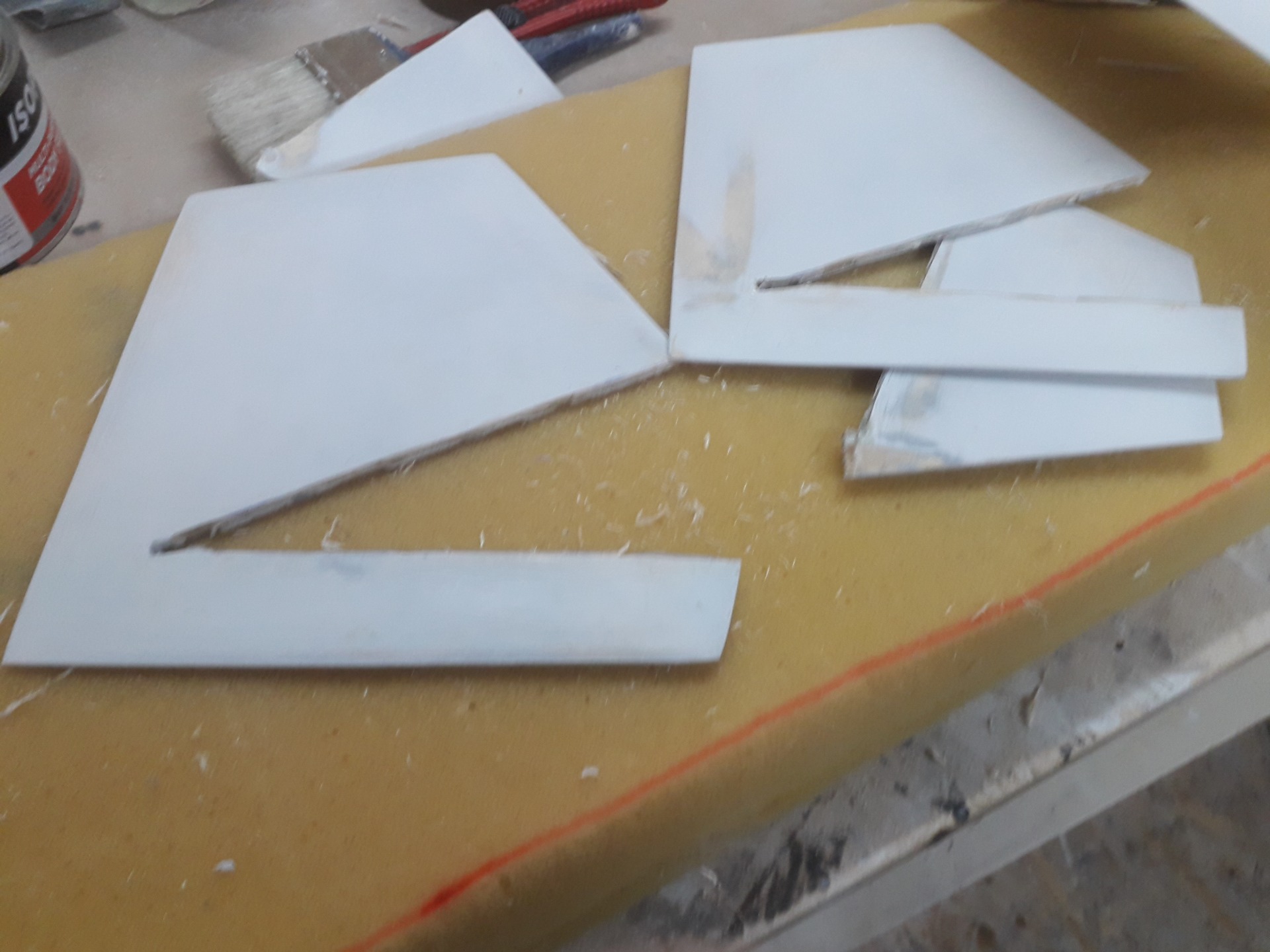

Cut the fins off the wing tanks without to much damage, they came in two pieces and sat on the surface of the tanks, very delicate and I could see them getting knocked of so I have cut them into four separate parts and if slotted the tanks so that will make a better job ,
Again pics in the wrong order

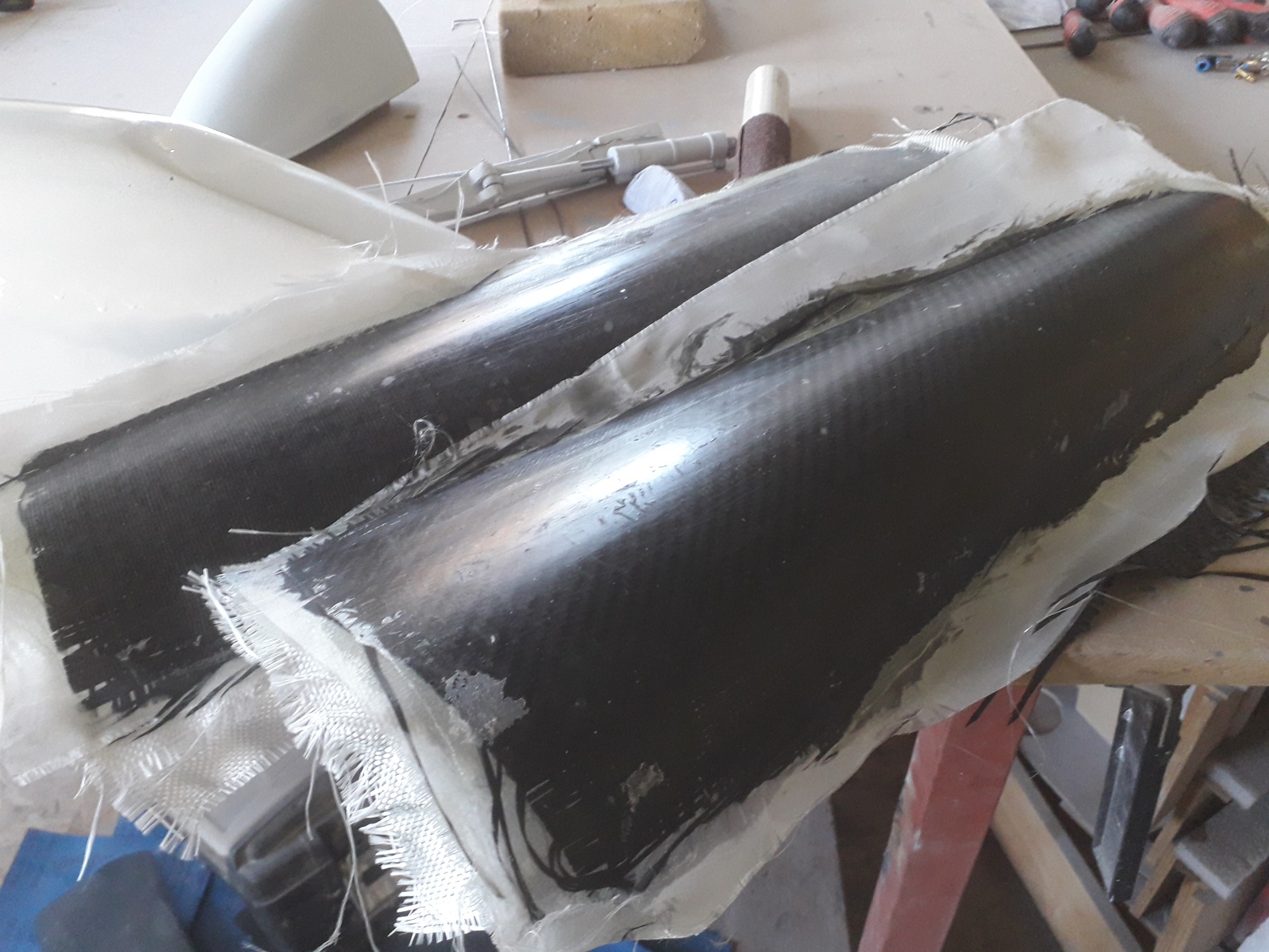

Hmmm been a bit of a mix up on this thread as the last posts are of the A 10
I glassed the other half of the tail cone today, give it a few days then see if it comes out ok

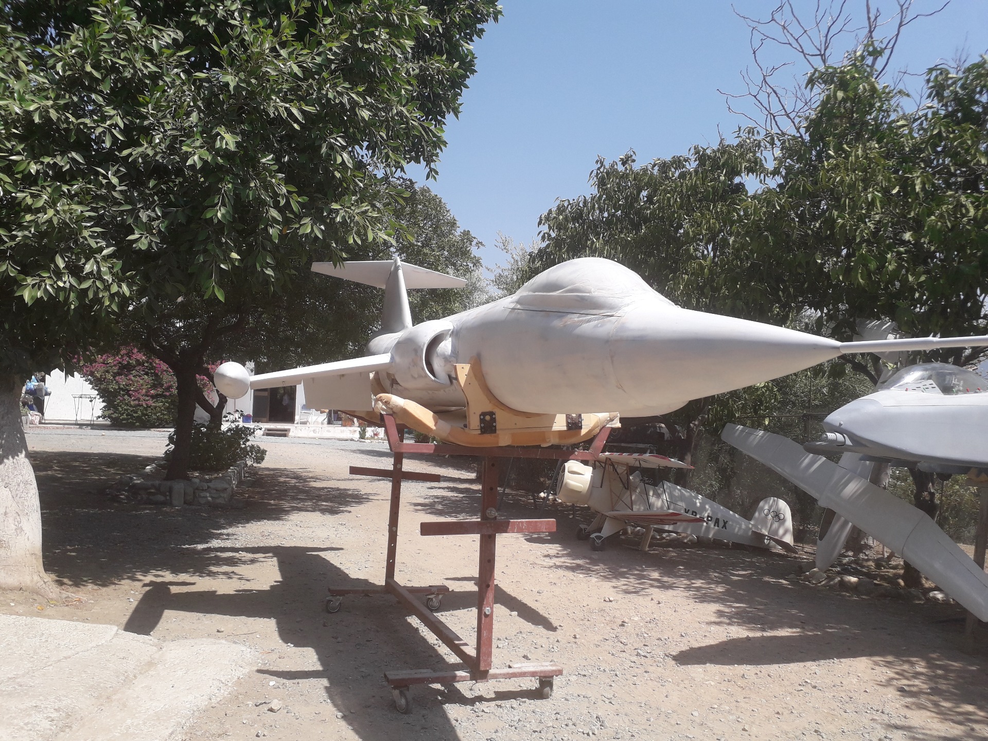

14 Aug 2019 21:13 - 14 Aug 2019 21:16 #264 by THE BLACKBIRD

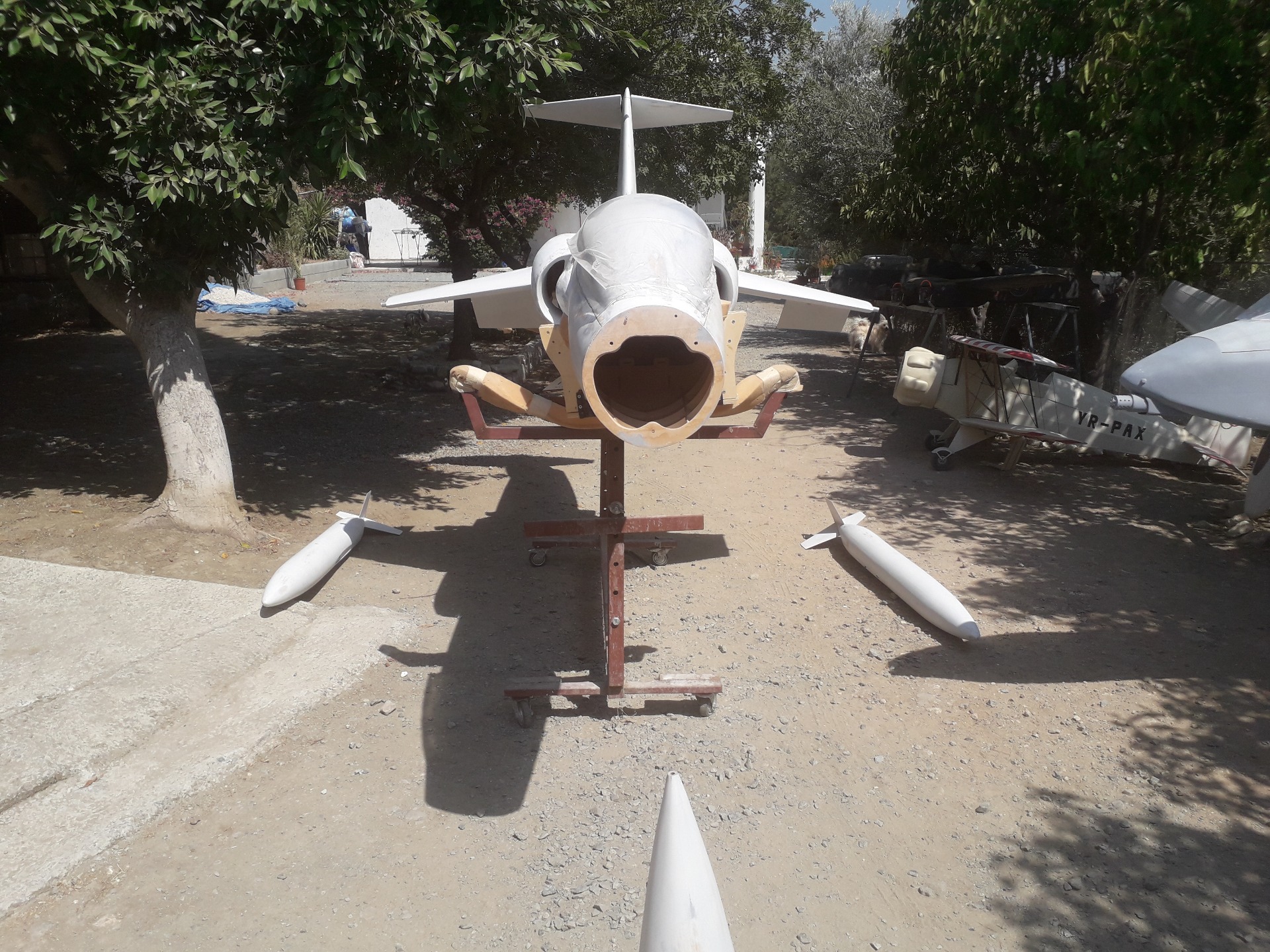

Put this together today along with my other models to photograph them, Demetris is posting them to different people trying to get buyer's

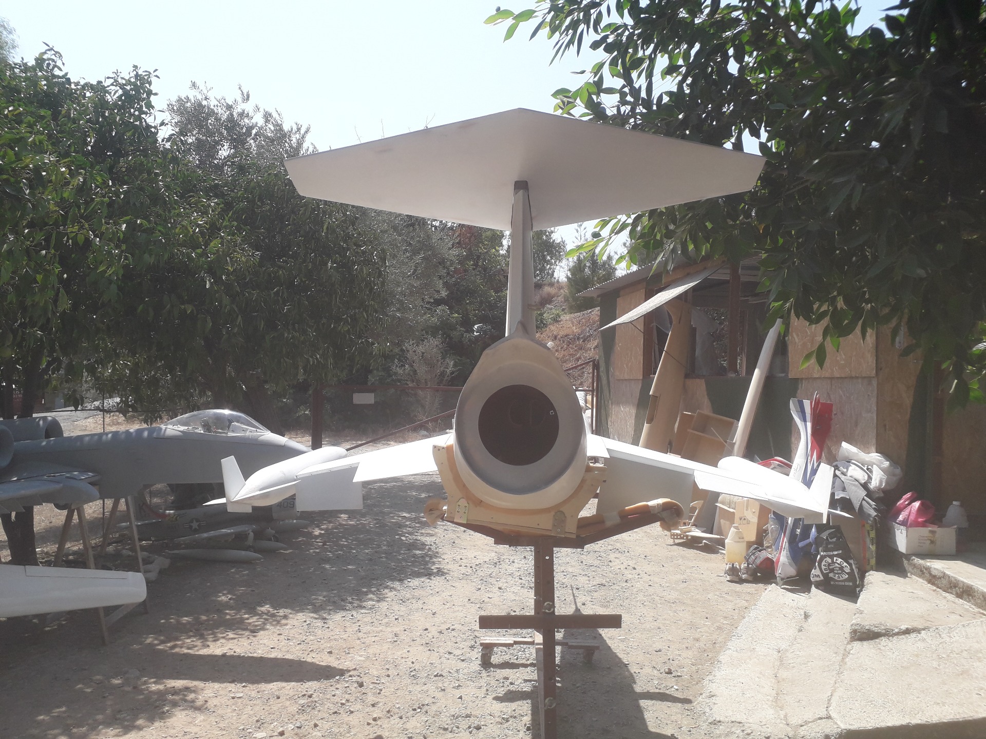

17 Aug 2019 21:35 #265 by THE BLACKBIRD

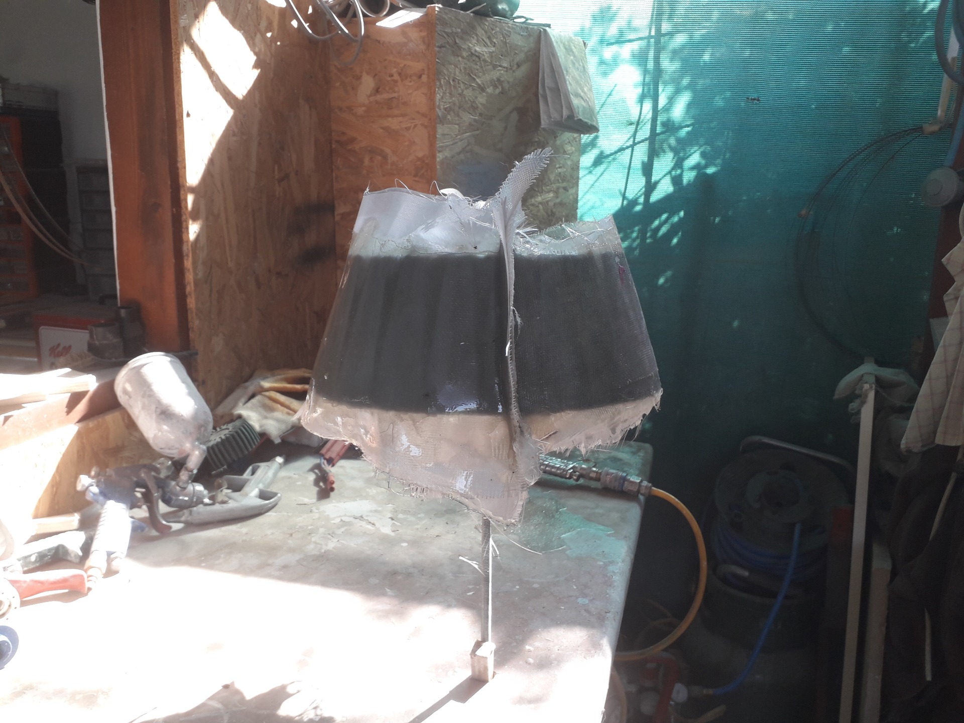

I laid up the nose gear doors and sprayed mould release pva on the mould for the thrust pipe, its not that good to be honest but i thought i would give it a go
If i was keeping it i would make another mould

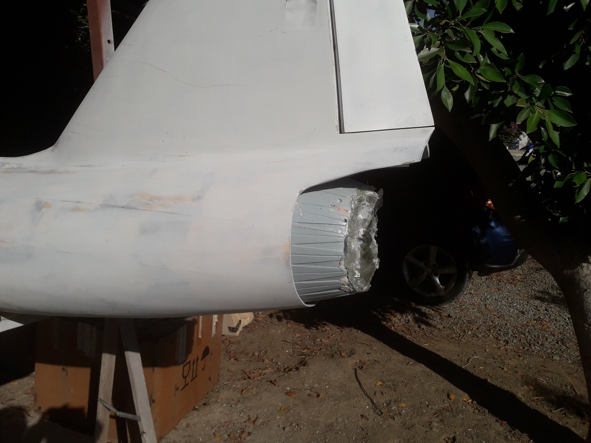

29 Aug 2019 08:42 - 29 Aug 2019 08:44 #266 by THE BLACKBIRD

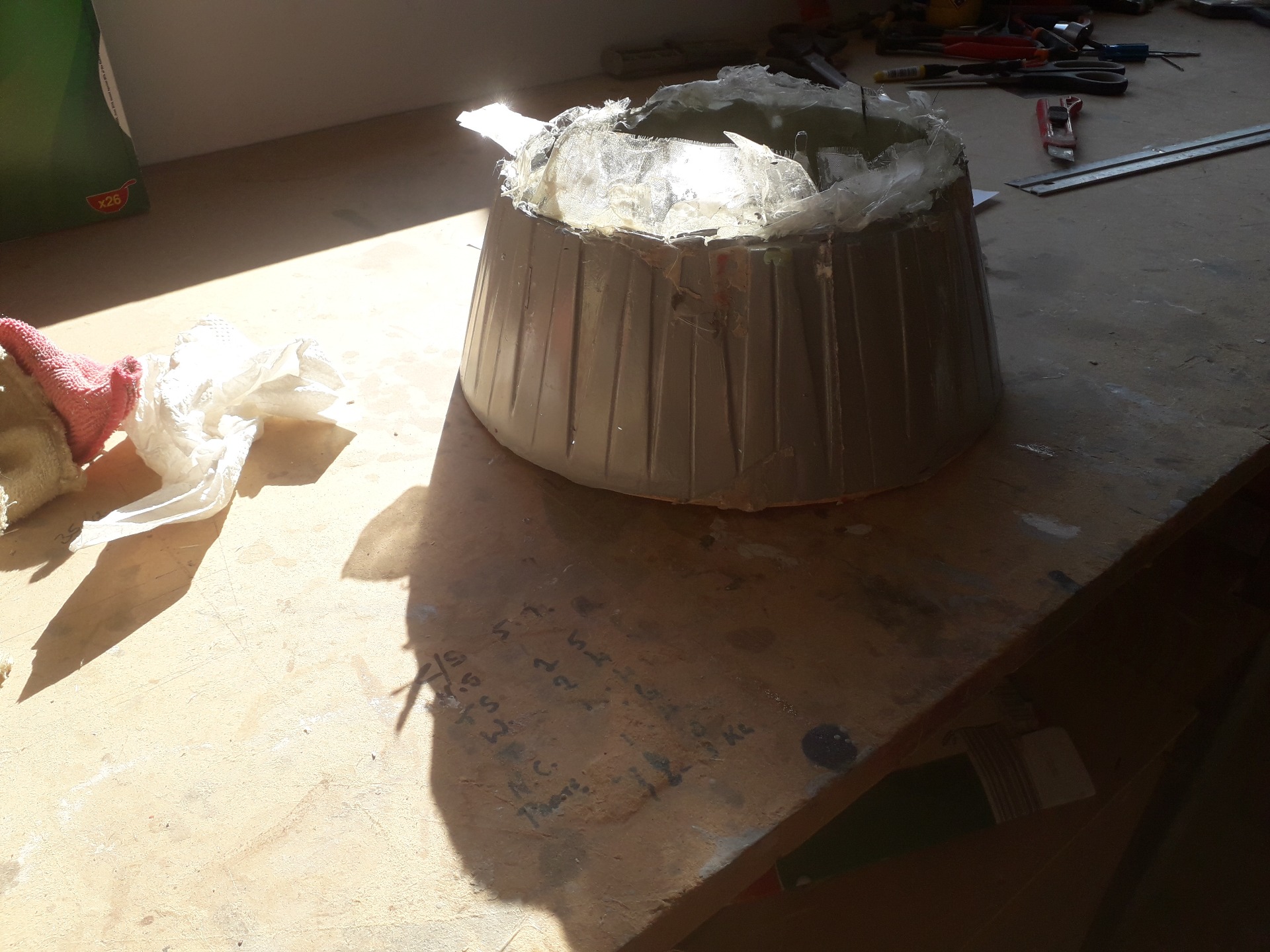

I cast the the tail pipe yesterday not expecting it to be much good to be honest
But its come out ok ish j
Just need to clean it up
Quite pleased the last part i make for it came out ok
Not that anybodies going to buy it

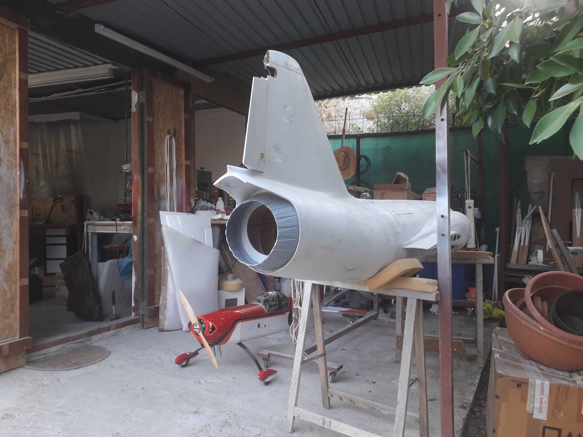

29 Aug 2019 19:18 #267 by THE BLACKBIRD
Started to clean it up tonight not to bad

31 Aug 2019 17:42 #268 by THE BLACKBIRD
Heres the tail pipe on the model
Im pleased with my final part
