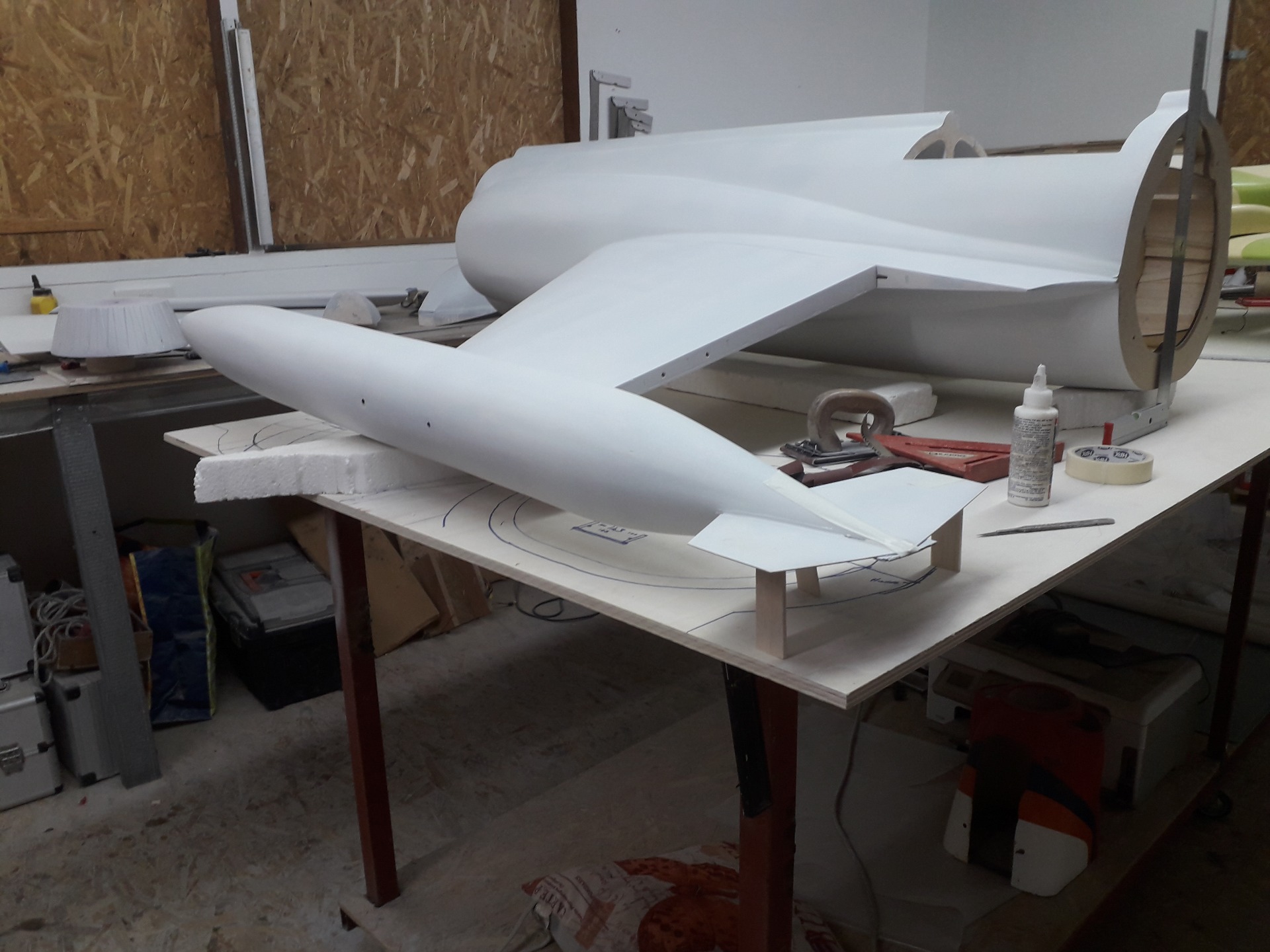

02 Nov 2018 11:55 #213 by THE BLACKBIRD
The first bit of white paint on the F104, primer on the tip tank and rudder

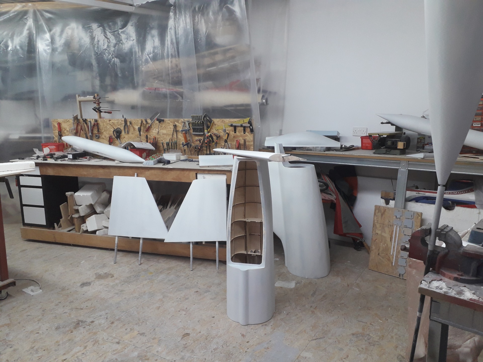

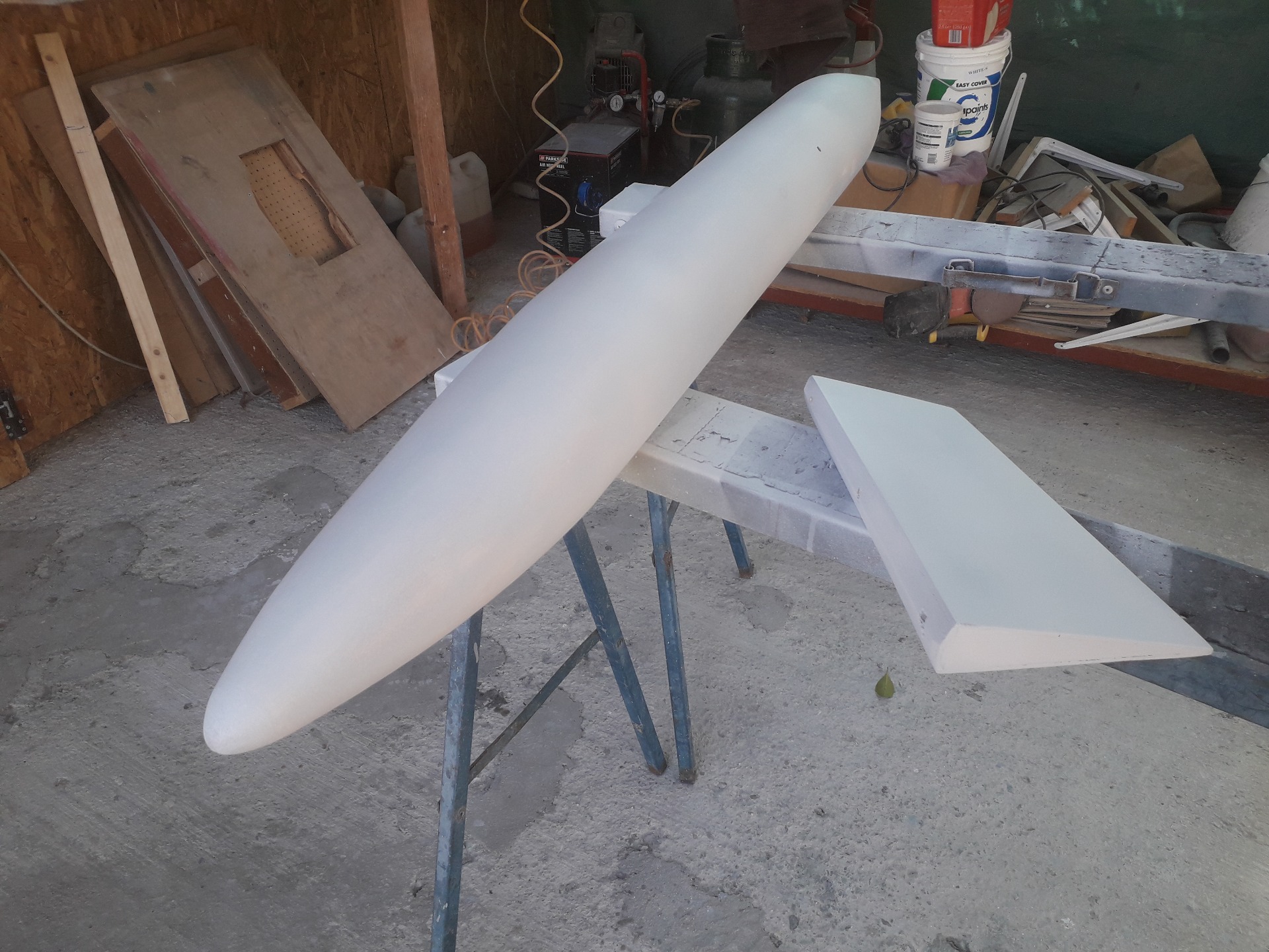

04 Nov 2018 12:17 #214 by THE BLACKBIRD
With no flying because of the high wind winds I thought I would spray the F104 just got started now it's chucking it down with rain
I called it a day at 1400 and went yo bed for the afternoon

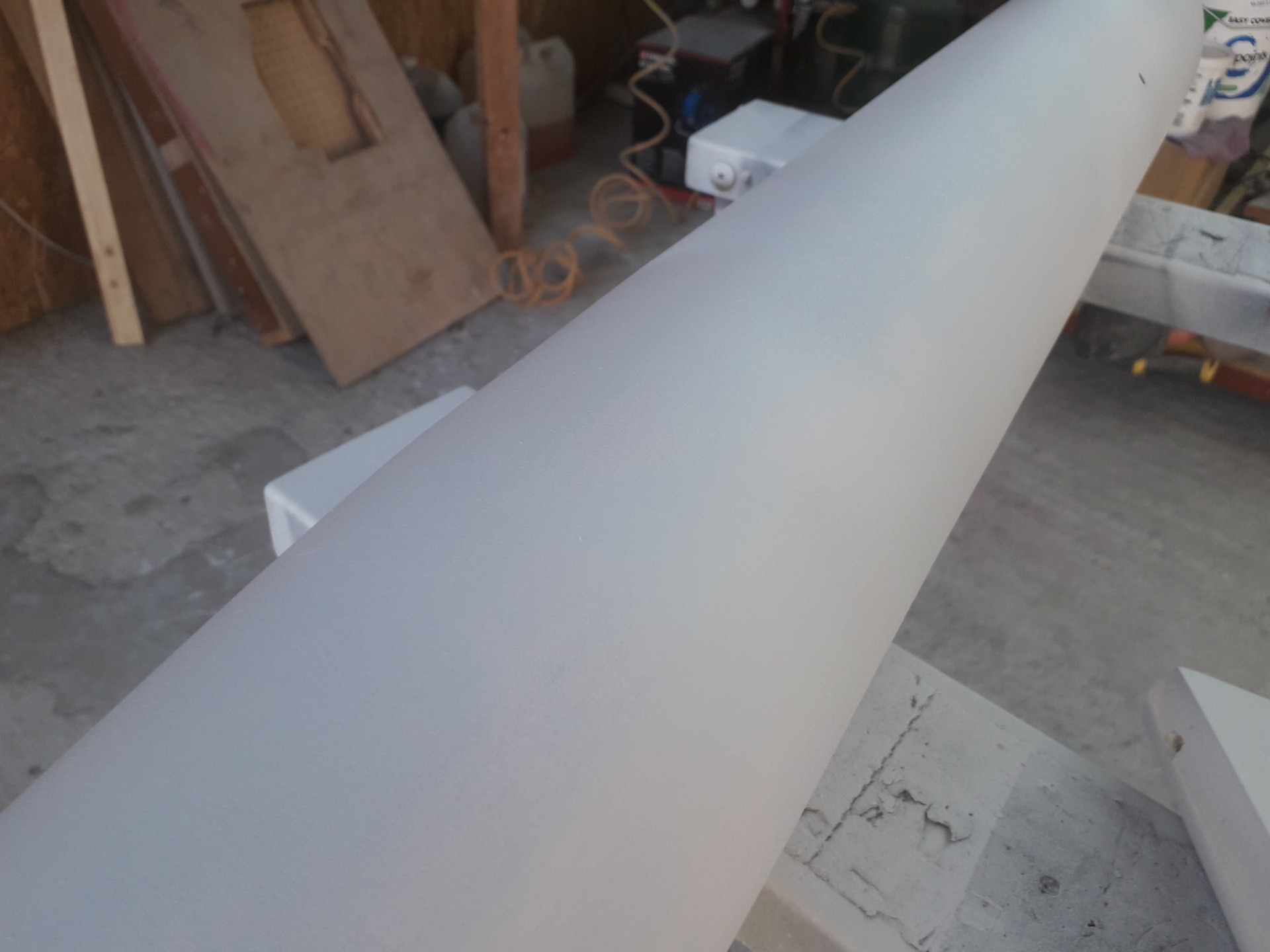

05 Nov 2018 16:37 - 05 Nov 2018 17:05 #219 by THE BLACKBIRD
She is all primed up first coat, now I suppose I sand it down and do it again
I though grey was the colour to show up the faults
White also makes a great job of it :(

05 Nov 2018 17:07 #220 by Klipkopwildlife
Replied by Klipkopwildlife on topic The Cyprus peanut scale twin engine F104
Looking good, I think grey primer has lots of solid bulk in it to fill up blemishes, it'll also push the weight up!
05 Nov 2018 19:52 #221 by THE BLACKBIRD
I used grey primer filler for a start then sanded it all off except for the low spots
I bought white primer for the glider as it will be white, thought I may as well use it on this one as well as the underneath is light grey also some of the top, the fin is white with blue diamonds on it

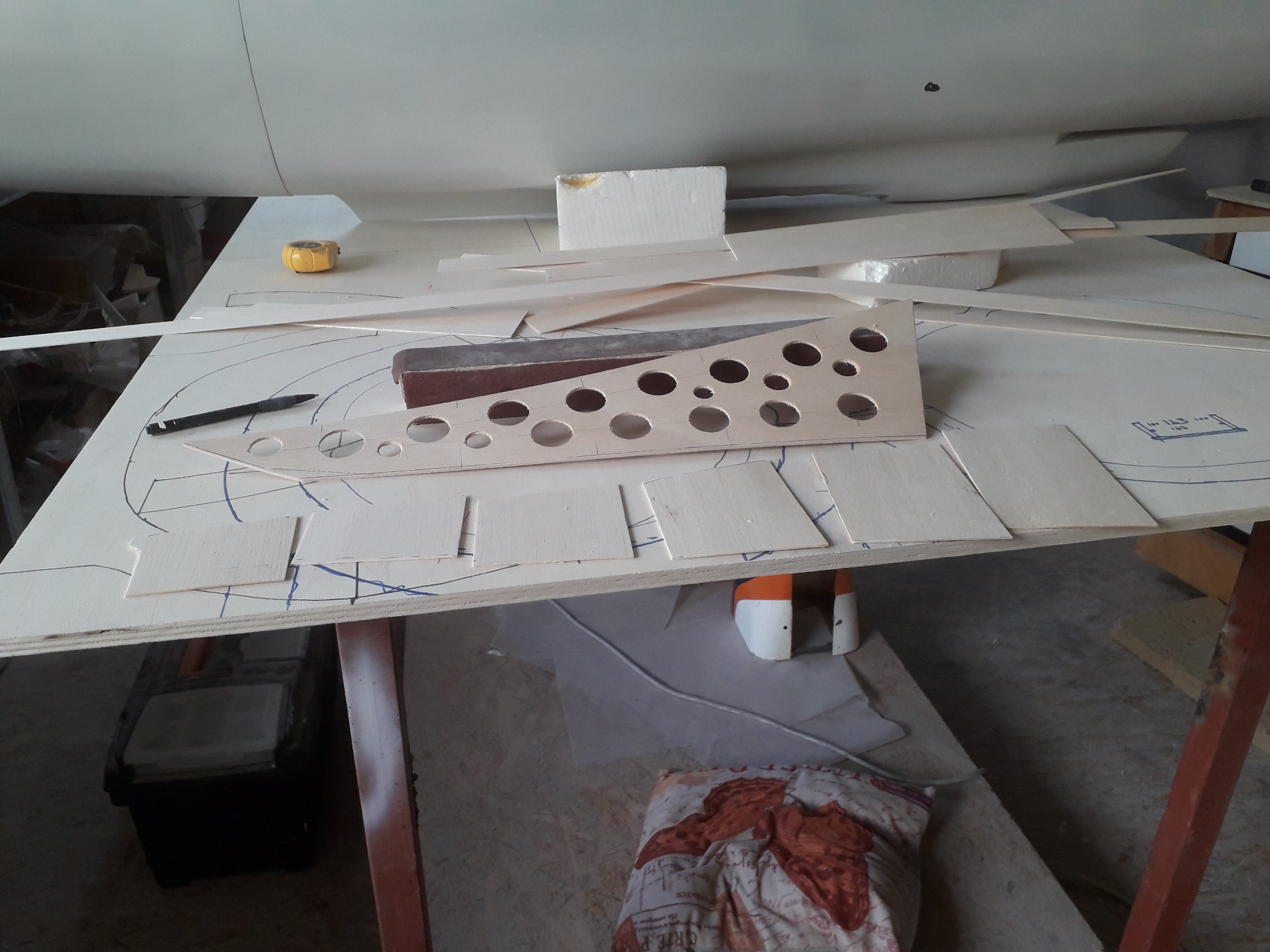

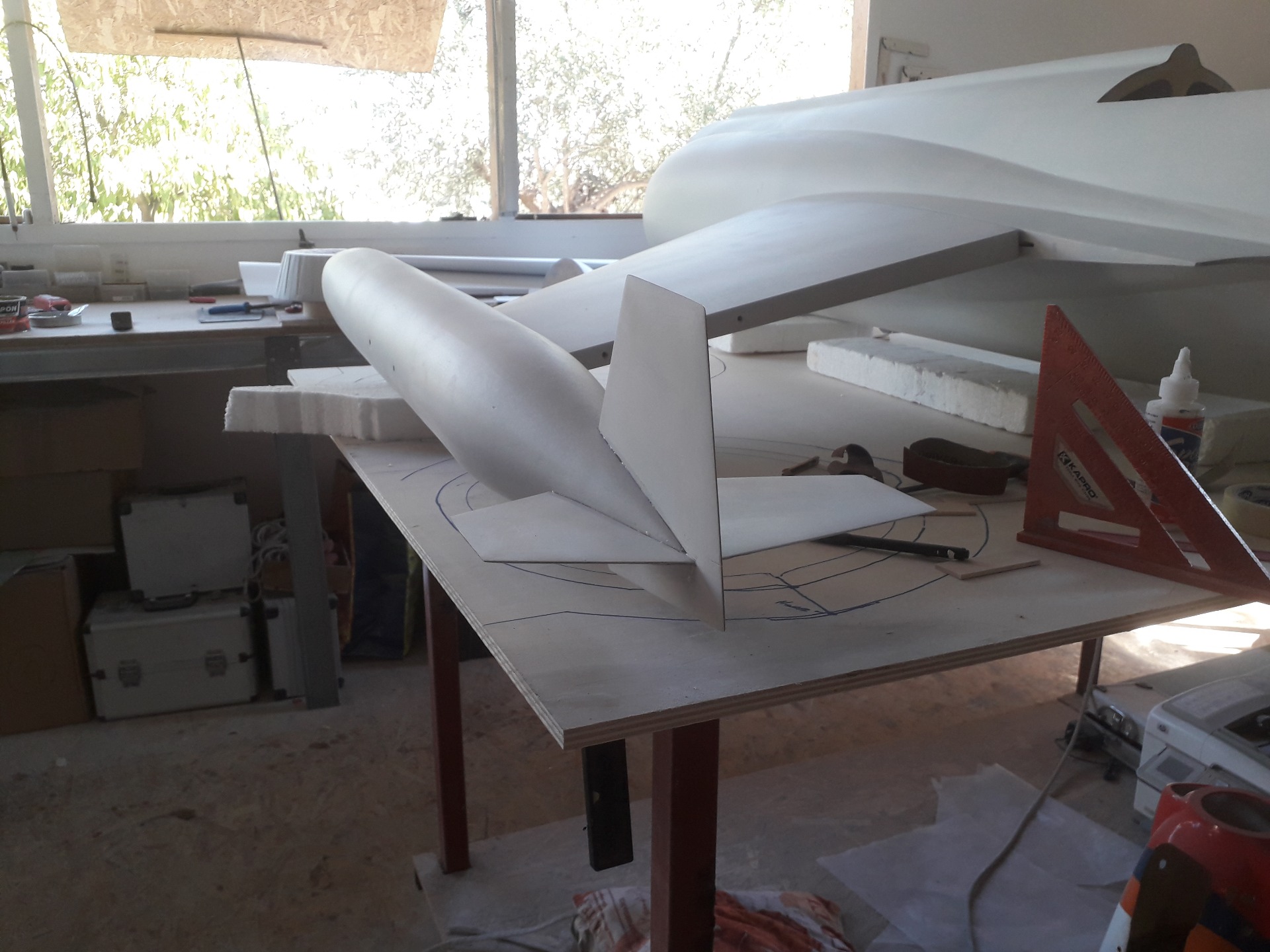

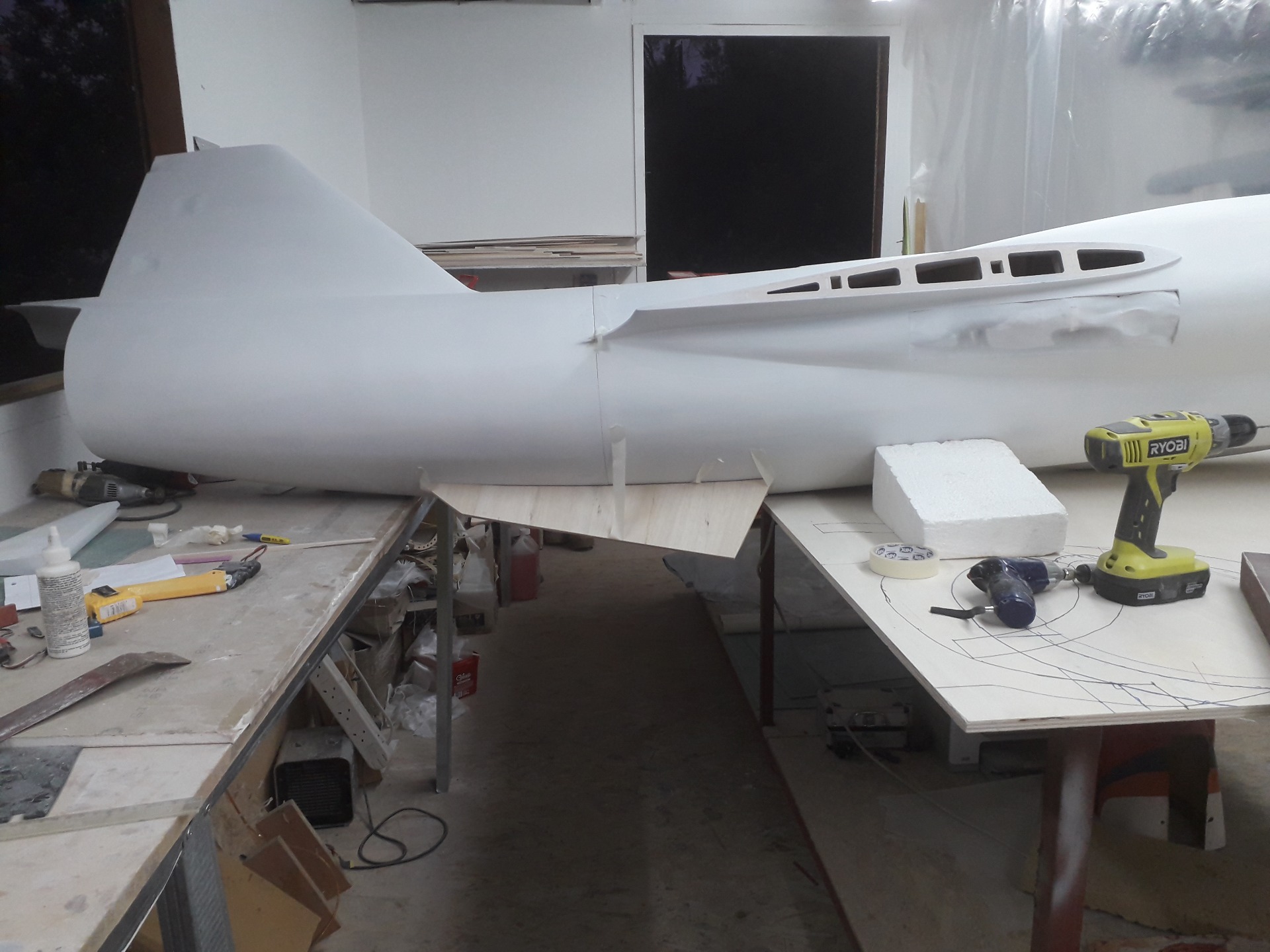

06 Nov 2018 20:02 - 06 Nov 2018 20:06 #222 by THE BLACKBIRD
Fins fitted to both wing tanks
Realised it needed a dorsal fin under the fuselage so I cut some 3mm lite ply and laminated 3mm balsa each side
Cut some steel plate and silver soldered it to a 3mm bolt to make a hatch lock
Last edit: 06 Nov 2018 20:06 by THE BLACKBIRD.

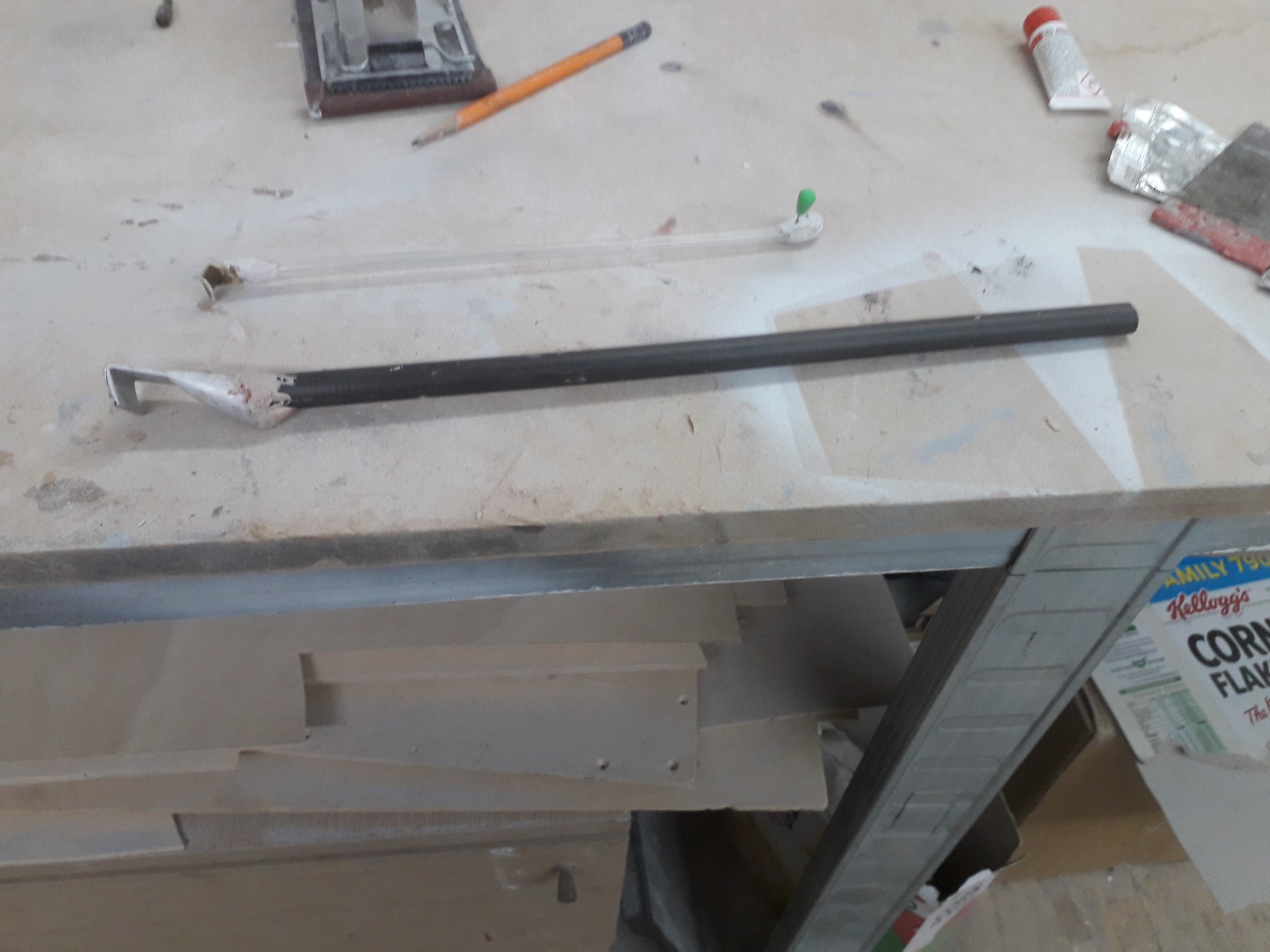

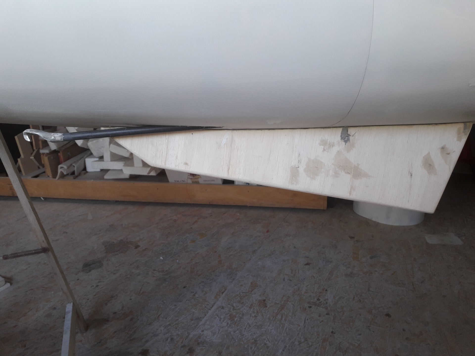

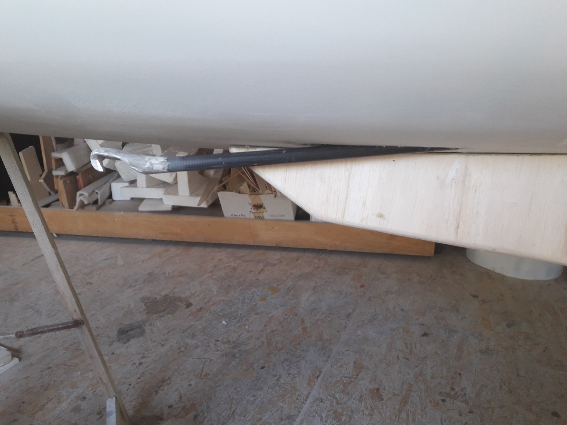

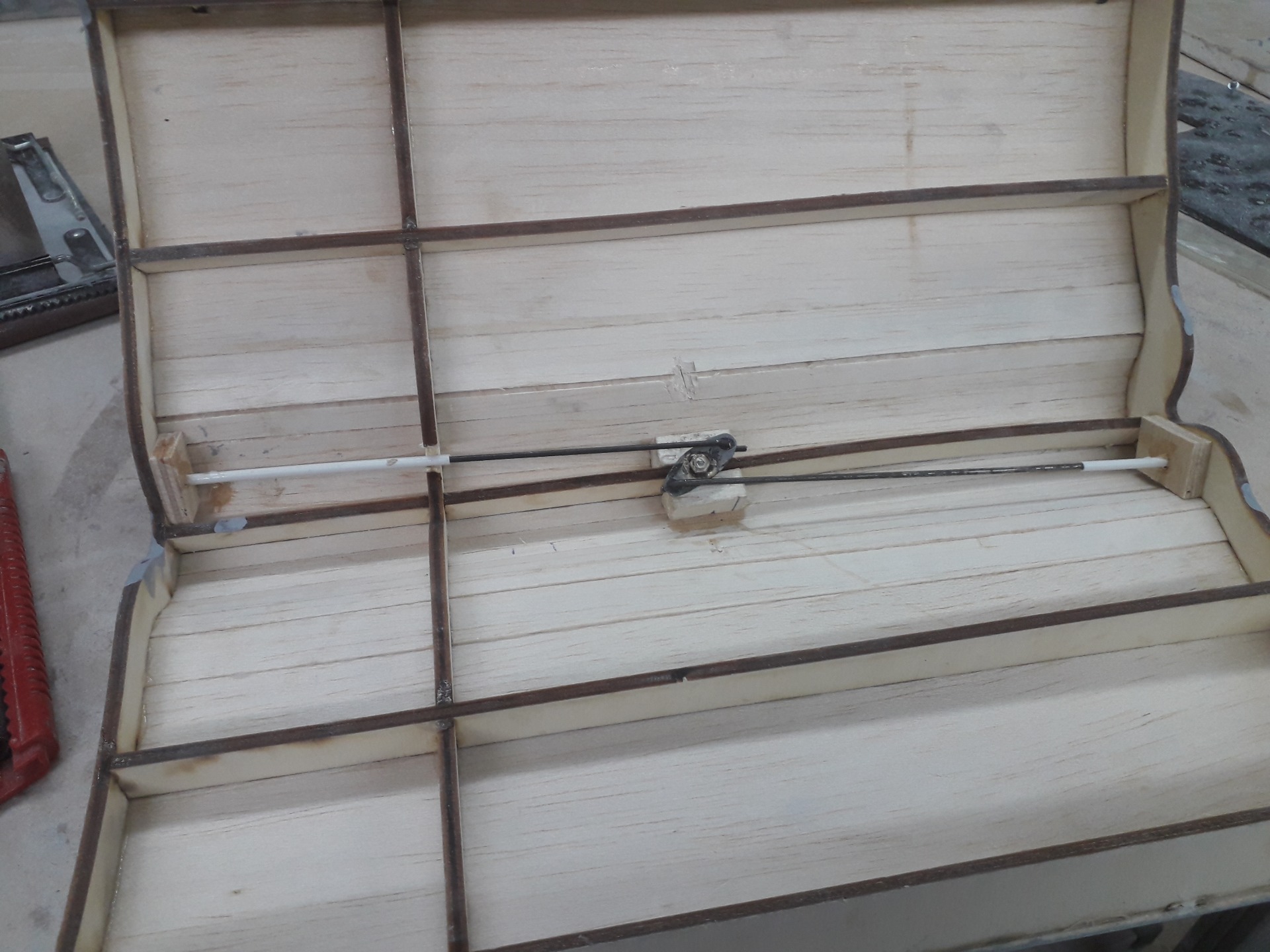

07 Nov 2018 19:54 - 07 Nov 2018 19:56 #223 by THE BLACKBIRD
Got the dorsal fin fitted, as it is going to be very vulnerable to getting knocks iv made it removable, held by one bolt and 3 carbon pins
It also needs an arester hooks had a go at one but it was way to small so did a larger one [attachment=21425]20181107_210100.jpg[/attachment
Also got the turbine hatch and canopy hatch locks finished

09 Nov 2018 16:27 - 09 Nov 2018 16:29 #224 by THE BLACKBIRD
Got the arester hook fitted, also made it so I can remove ky

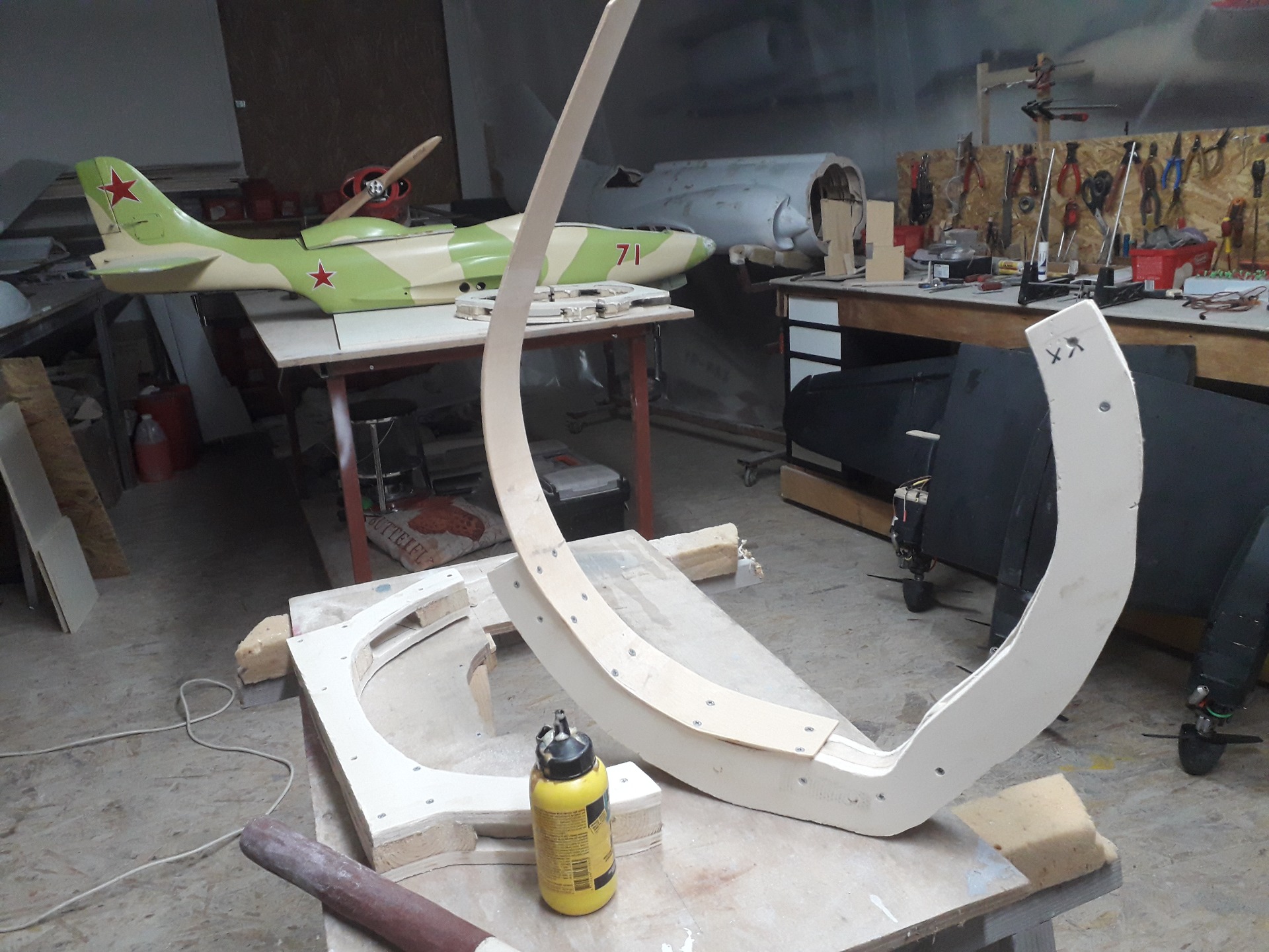

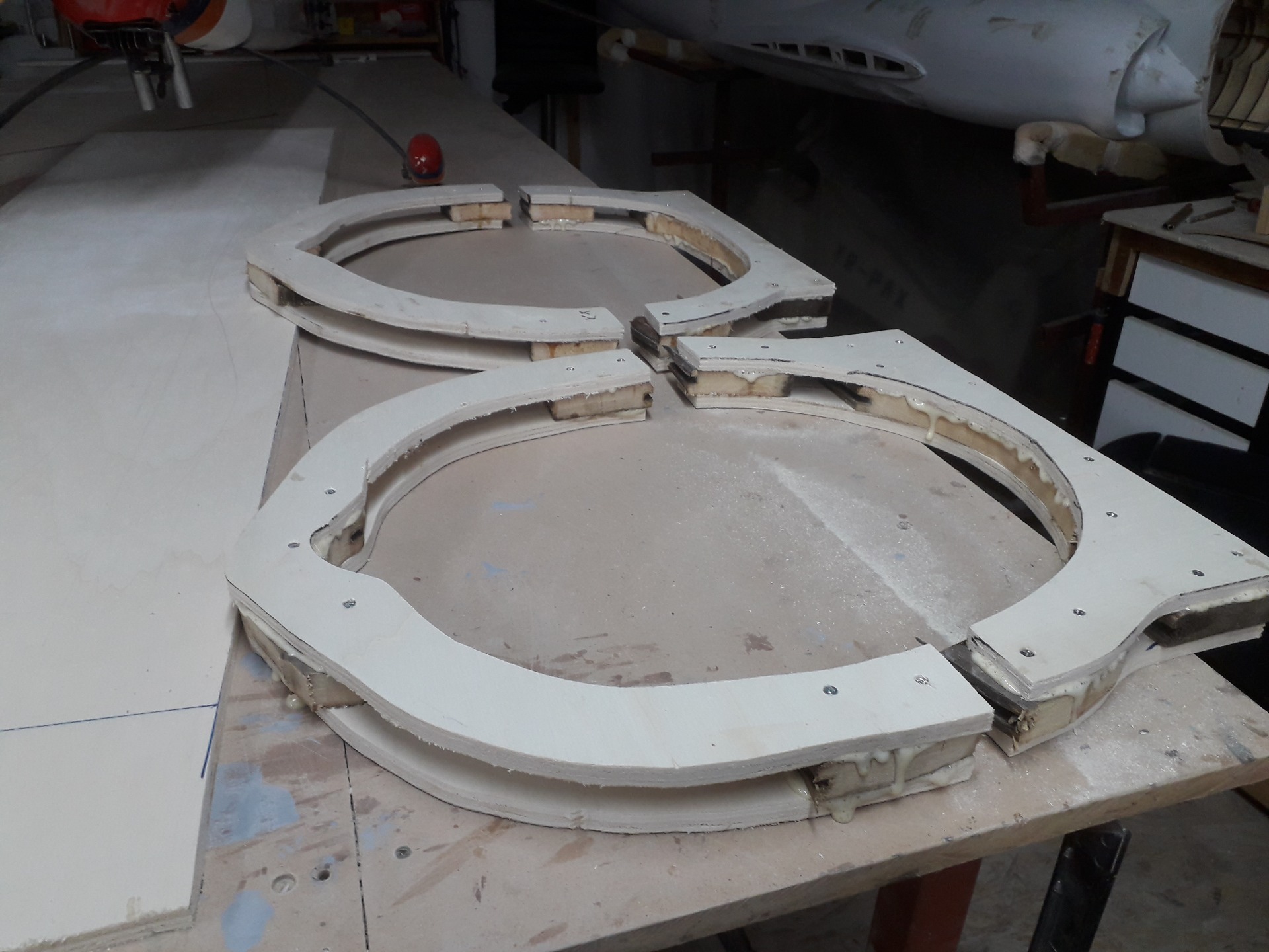

23 Nov 2018 20:45 #225 by THE BLACKBIRD
After such a negative week with the Lancaster I thought I would do something positive today so I started on the transporter for the 104
1/2" marine ply
