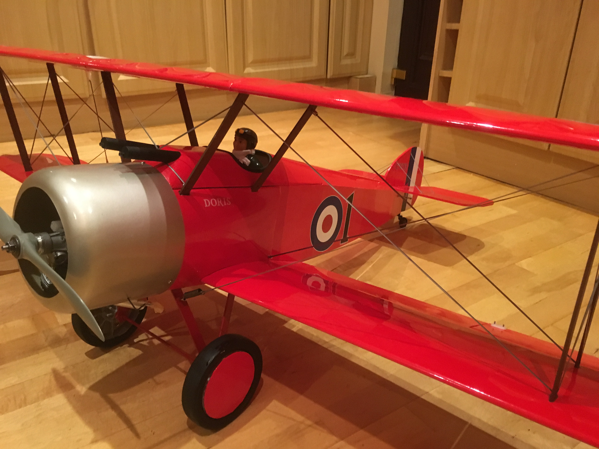

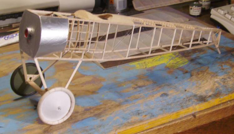

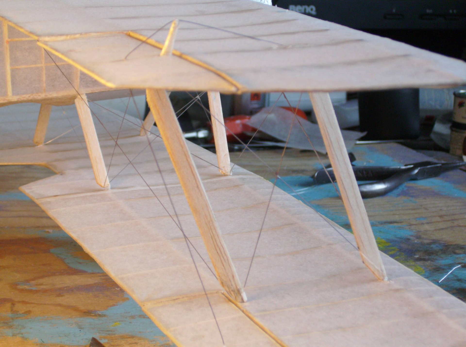

When I was building my Pup I was impressed by this picture of a true scale replica.
I really shows just how 'spindly' it was. With an empty weight of 787 lbs and the Le Rhone at 268 lb meant the airframe was just 519 lbs. Fuel, oil. pilot and gun added another 438 lbs giving a total of 1225 lbs.
The bare airframe was thus carrying 2.3 times its own weight.
Not many electric RC planes have a battery and motor that is even equal to the airframe weight.
A true scale Pup (officially the Scout) is a hard thing to model.
I did get fairly close.
One day I might try again but a bit bigger.

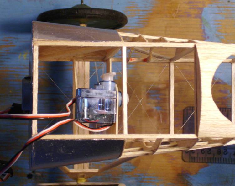

21 Dec 2020 17:27 - 21 Dec 2020 17:29 #9 by Quorneng
Replied by Quorneng on topic Thoughts on a scale Sopwith Camel
Klippy
You are correct the ailerons are all on a single wire circuit.
You don't need to put the aileron servo in the wing, It can go in the fuselage picking up the line in the lower wing which is exactly where the joy stick was connected in the full size.
I mounted both the aileron and elevator servos on top of each other in the fuselage just behind the firewall but left just enough room to get the battery in there as well.
The single arm on the aileron servo just picked up the lower line of the aileron circuit so outside the fuselage all the control runs were 'true' scale.
According to the Incomplete Guide the Camel used the RAF 16 section. As far as I can tell the Pup did as well, however the actual coordinates appear to be lost but those for RAF 15 are available.
It is only 6.5% thick so functional rigging is likely required. ;)
Last edit: 21 Dec 2020 17:29 by Quorneng.
