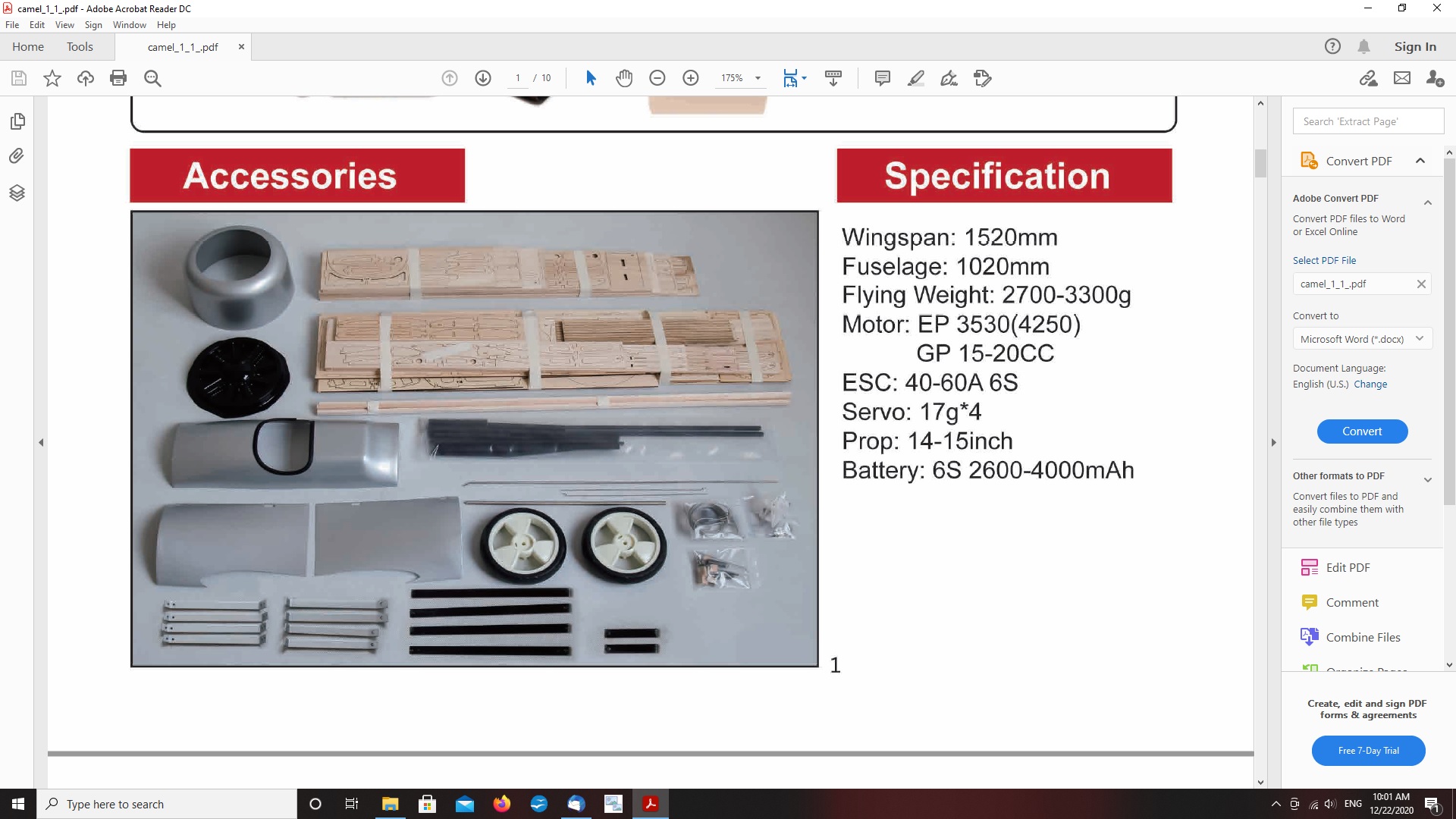

I'm certainly going to cheat and use the supplied airfoil section, here's a funny.
A 6 to 7lb model needs a 15 to 20cc engine?
The larger quoted motor will give about 800watts at full chat with the correct propeller, I see that as being in the 40 size glow motor range.
The smaller motor is quoted as about 315watts which I see as being dangerously low for this size of model!
