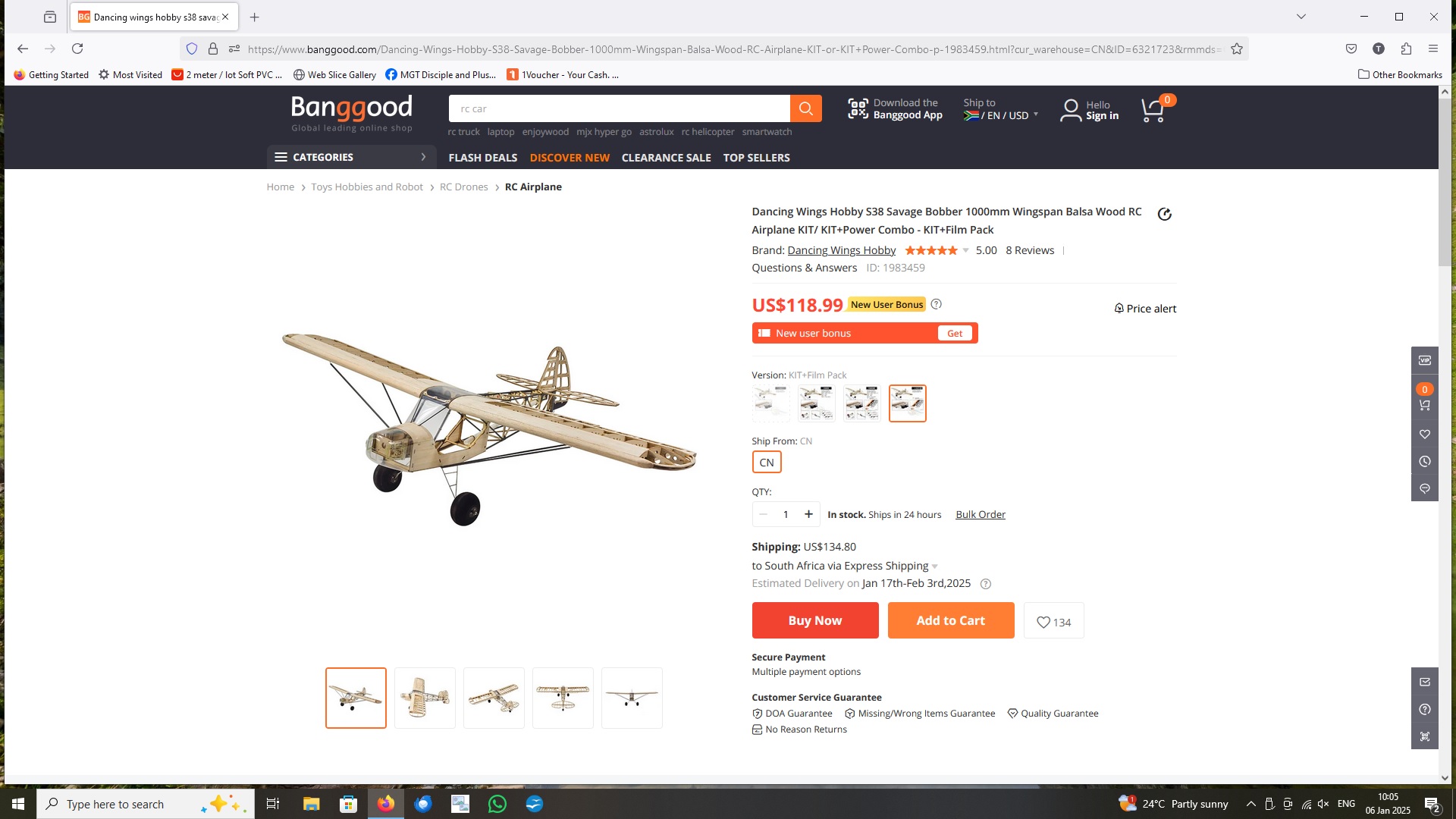

Hi Jon, you may not have noticed it but there was an S28 Savage Bobber on my bench while you were here.
It's available from Banggood
I am absolutely gobsmacked at the way prices have shot up, obviously I can't afford the postage any more.
If you can keep the weight down to 600gm the loading is 30gm/dm almost exactly the same as the FunCub so it would fly almost the same.
This project got shelved when I had difficulty gluing the rectangular carbon fibre longerons with Cyano and had to re-glue with Araldite, then I ran out of Araldite and moved on to something else.
The box contains a 1:1 plan and an illustrated construction manual. Pictures if you want them

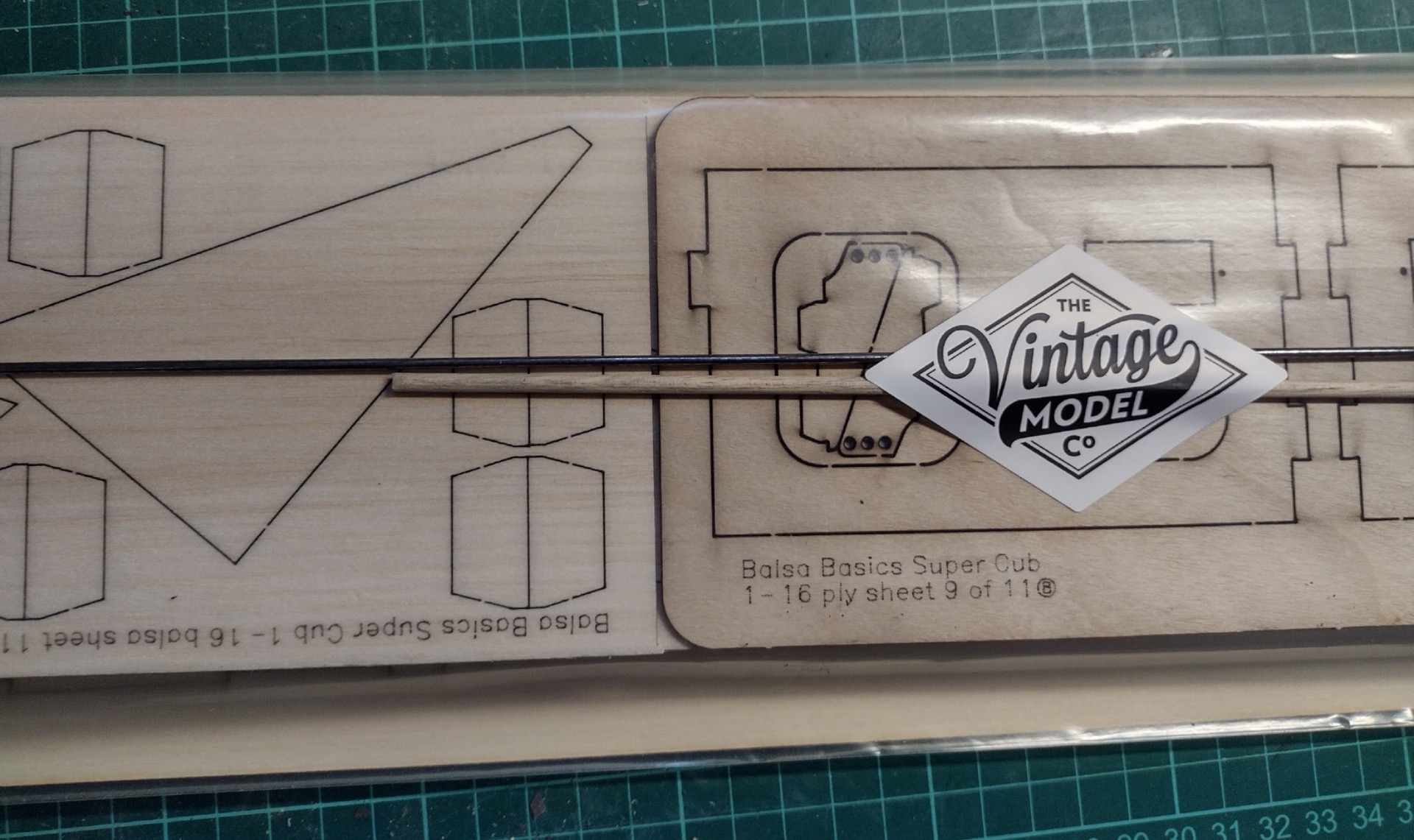

The basic balsa model arrived.  So here is an unboxing...

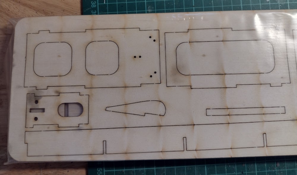

And inside, nicely wrapped packets and wood...  Minor scorching on the ply.  Tyres are nice and chunky.

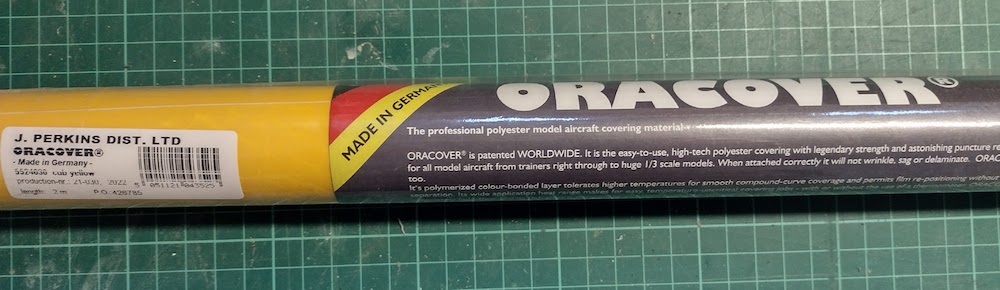

And the covering material.  German source - any one used this before?  I now have a 'mini' iron for attaching it.

If you weigh all the balsa & say if there's 50% offcuts then this will give you a starting point for the weight.
On the glue front I've been using SuperPhatic for the Cadet which is what I've tended to use on the small rubber kits & mostly its been fine but now I've started to sand the wings of the Cadet the wing tips have come away from the spar end formers - on both wings. I've a suspicion that the charring prevents the glue from wicking into the ends of the formers. I'm wary of sanding too much in case I make things undersize or make the former ends the wrong angle.
The charring on the VMC kits is nothing compared to the Dumas.
Last edit: 14 Jan 2025 15:50 by Magpie.

Oracover is rather like solarfilm, but thicker and heavier.
