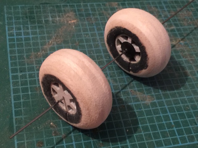

I've had a productive day in the model room today, starting with rough sanding of the other wheel:

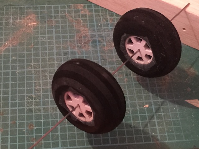

I decided to slap some paint on both of them to see how they look and I'm quite pleased with the result. They need fine sanding, sealing and further painting, but they're on track to be finished for the BMFA Scale Indoor Nats in two weeks time:

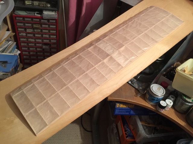

and the wing has been doped (it was covered yesterday and water shrunk this morning):
I'm using EzeDope for this one, mainly to prove that it's suitable for a competition scale model.

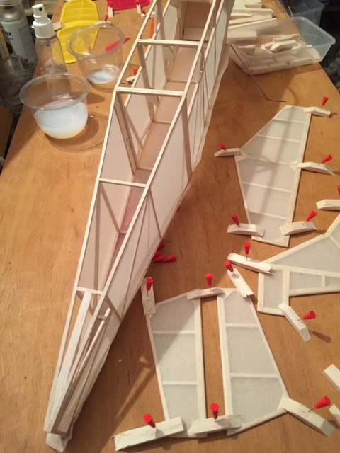

The empennage was doped and after being touch dry, pinned down to prevent warping:

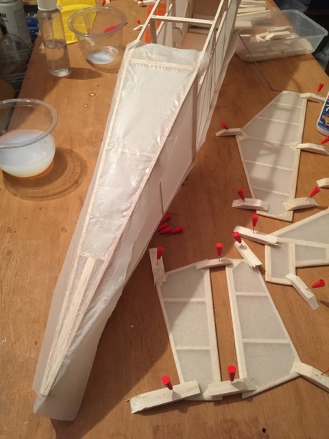

The fuselage is now covered and he whole model doped:

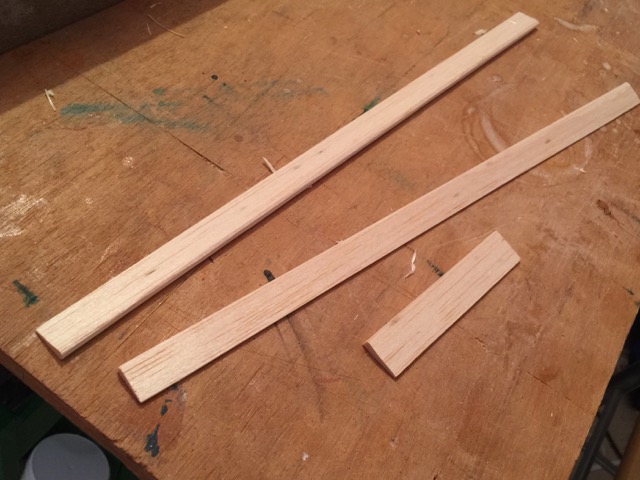

Following that I've been sheathing the tailwheel and main wheel legs with balsa. The technique is the same for all of the legs, I take the tapered laser cut strip prepared for each leg, score a centreline with a biro to accept the wire leg, taper the thickness of the strips, then roughly sand them to a circular cross section. The two prepared halves are then glued to the UC leg:
I'll leave it overnight to fully dry, then finish sand the leg, filling if necessary.
