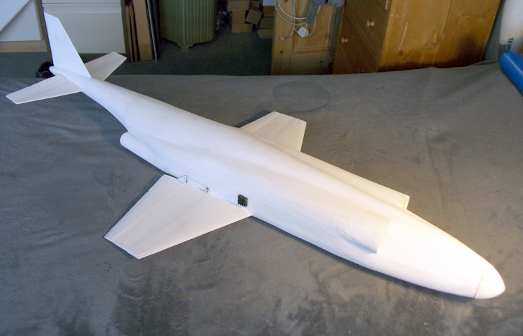

After raining on & off most of the morning at 3 pm the sun came out and more to the point there was virtually no wind so the Stiletto had its maiden actually two of them!
Total time 21 seconds. Minor damage on the first rather more on the second.
As you can tell from the damage the flight ended "taking out" the right hand side.
However the flight were long enough to confirm what was wrong. It is tail heavy and the elevator is pretty ineffective except at speed.
As I feared the CoG has to be pretty well spot on. Even a touch tail heavy and it simply tries to climb and with limited thrust it cannot accelerate so the pitch up just gets worse. With no airflow over the tail plane the elevator has no effect.
On the second flight some down elevator on launch delayed the rate of pitch up so it got higher before it stalled from near vertical. In the resulting dive the elevator only had any effect rather too late.
So a lack of thrust was not the problem, both hand launches went well, but simply being a bit tail heavy. From my experience with the Bachem Natter that "fuselage lift" can require a rather extreme forward CofG for stable flight.
Still so far so good. It could have been a lot worse.

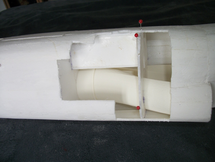

Made a start repairing the RH inlet and glued the RH wing back on.
but in the coarse of testing it appears than when the RH wing was ripped off the aileron link striped a tooth on the servo.
It will not be a simple job to extract it.
I do have a spare electrically dead servo with a good gear train but changing the gear wheels on a 3.7 g servo is a very questionable process.
Its all good fun!

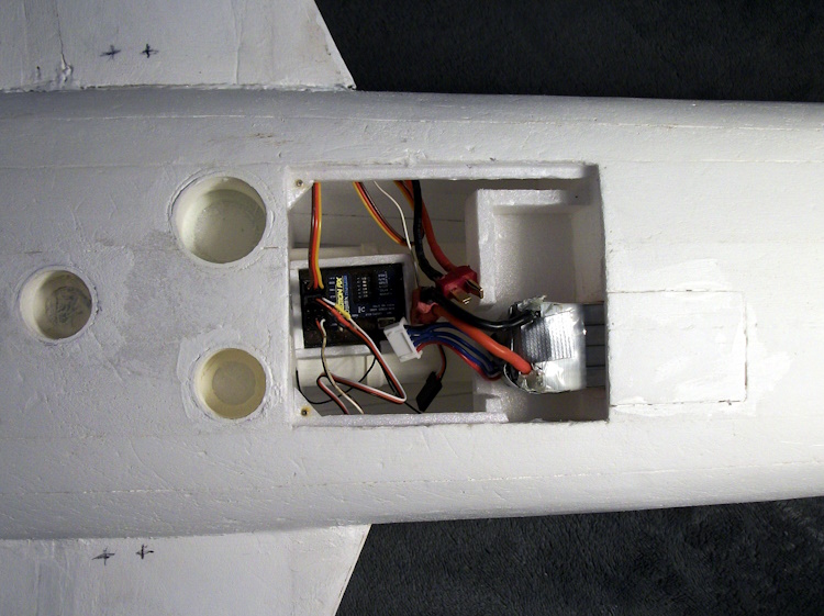

Now all fixed and ready to go.
The battery has been repositioned a bit further forward and to the left to counter the weight of the ESC on the right.
The previous and revised CofG positions are shown.
By my "trapezoidal" calculations this represent a CofG at 23%​​ effective chord. I have also removed the aileron droop which should reduce the nose up pitch,
I half expect the CofG will need to go a bit further forward however it is relatively easy to adjust things to allow the battery slide further forward.
We shall see once the wind dies down but that is not likely until after Easter according to the forecast!  ​​​​

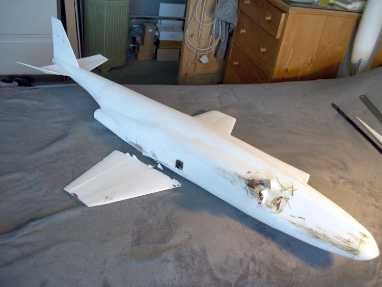

To recap the result of yesterdays flight attempt.
First operation as always is to cut back to an undamaged area.
It is always a bit alarming as you seem to throw away what may have been damaged but was still a pristine bit of a plane.

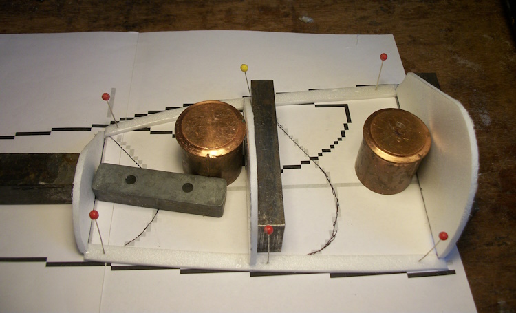

The first half planking is now complete so on with the other side. Once the RH side of the formers are added the planking can start again.
It is rather slow going as to avoid any distortion it is important to let the glue dry after a few planks are pinned in place.

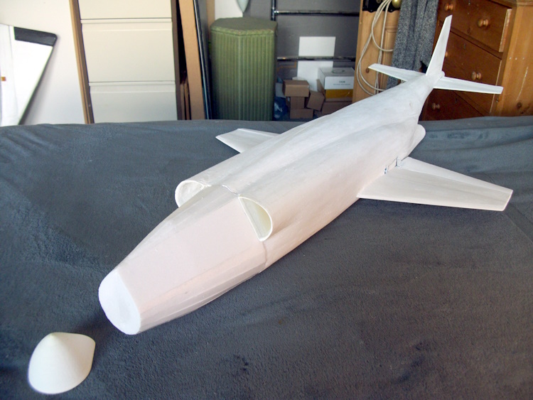

04 Apr 2024 18:47 #70 by Quorneng
Replied by Quorneng on topic Douglas X3 Stiletto
New nose completed and glued on with the replacement printed short nose.
The battery box has been extended by nearly 2 inches/
This should place the CofG to give manageable flight characteristics,
