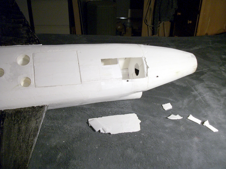

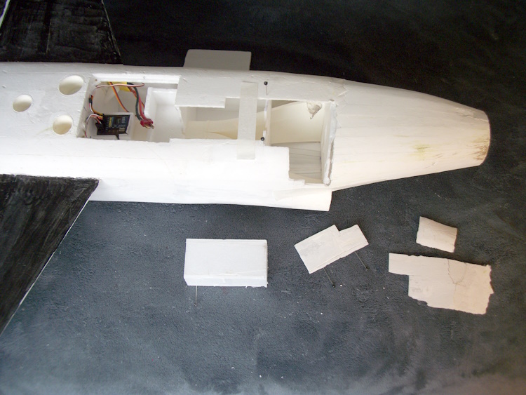

27 Apr 2024 22:42 #83 by Quorneng
Replied by Quorneng on topic Douglas X3 Stiletto
Repairs underway. First a cut back
Then start putting them back.
The battery box has been extended and refitted to allow the battery to go about 8mm further forward.
With the underside "stabilised" the top compression damage areas are cut away.
Should be complete in a couple of days but no rush as its going to rain quite a bit more over the next 6 days.

29 Apr 2024 21:26 #84 by Quorneng
Now all put back together.
The nose cone is LW-PLA and it has a nose compartment that has a 6 grams of lead shot in it. The access hole is just taped over so more can be added. It is now 4g heavier than the previous heavy PLA nose cone. In addition the battery is 8mm further forward. Hopefully this will have moved the CofG forward enough for a "reasonable" flight.

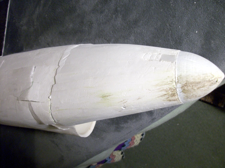

01 May 2024 14:31 #85 by Quorneng
Pretty calm this morning so another go!
2:15 this time. I was just about to organise a landing but as I slowed down just a bit control got difficult so the crushable nose cone had to do its job.
It went in pretty firmly with no significant ground slide as the grass is far to long for that! Note the completely crumpled LW-PLA nose cone with relatively minor local fuselage damage and more important no compression damage either.
