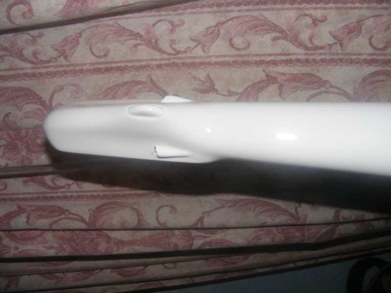

Back to the U2 - You may recall I said the canopy was held on by four tiny little minute black screws -
Well - it is, and it isn't! Those four little tiny minute black screws merely hold two strips of metal onto the sides of the canopy.
Those strips of metal are pulled on by a set of magnets.
So, I didn't need to take them out, at all! :oops:
I found this out while chatting to another modeller who has been thrashing one around the sky, and he found out by accident!

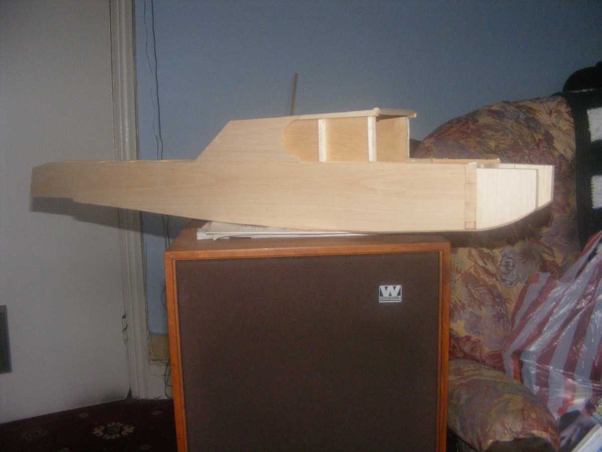

72 inches of space held in place by a few sticks.

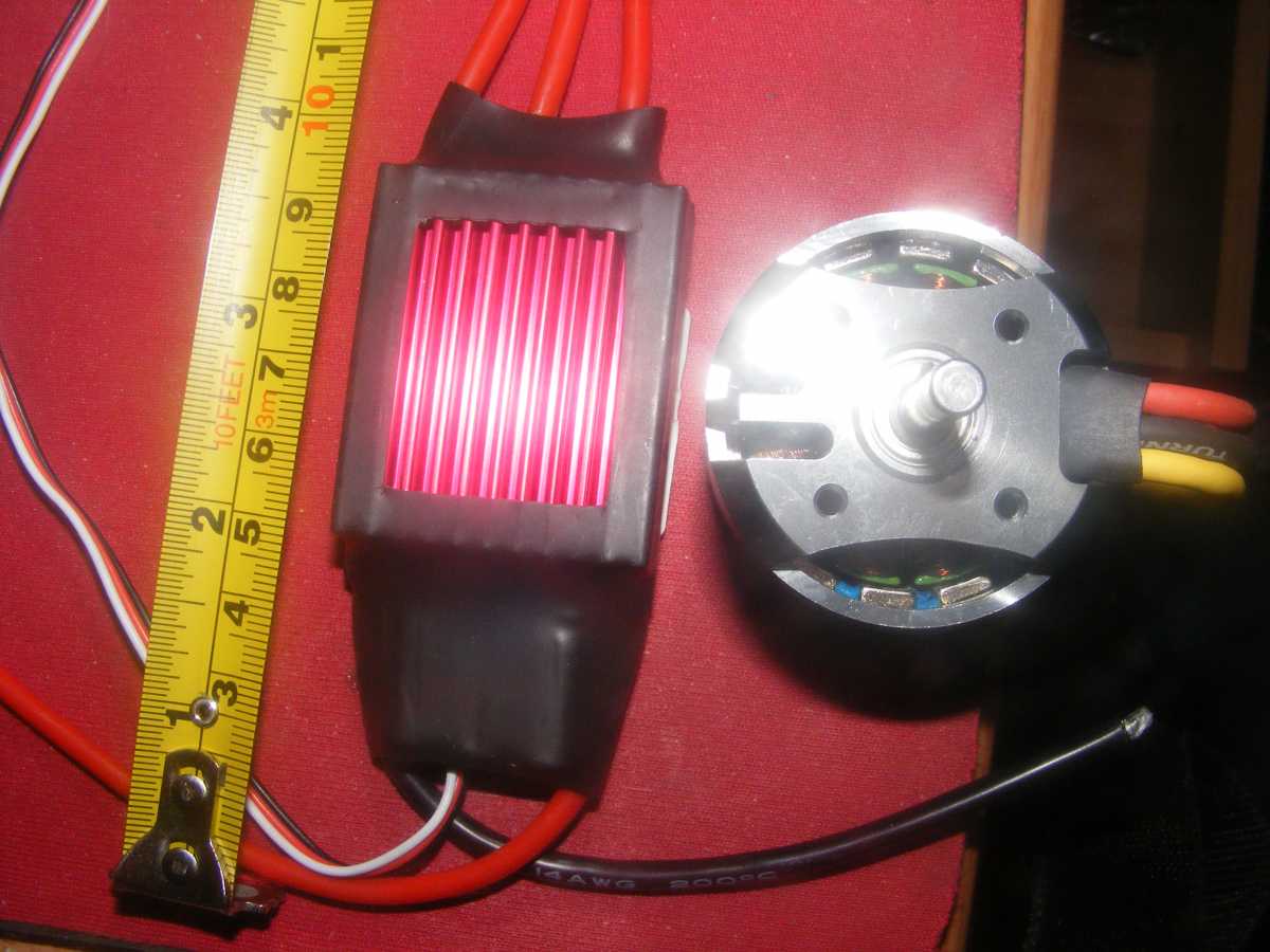

Two photos of an electric motor and 70 amp speedo - equivalent to a 2st 61 using a 3s lipo. The motor weighs 170 grammes, and the speedo is 65.
Claimed 14x6 prop 11.1v 403 watts 36 amps 2.23 kg thrust
...............................14.8v 785...........53..........3.05
