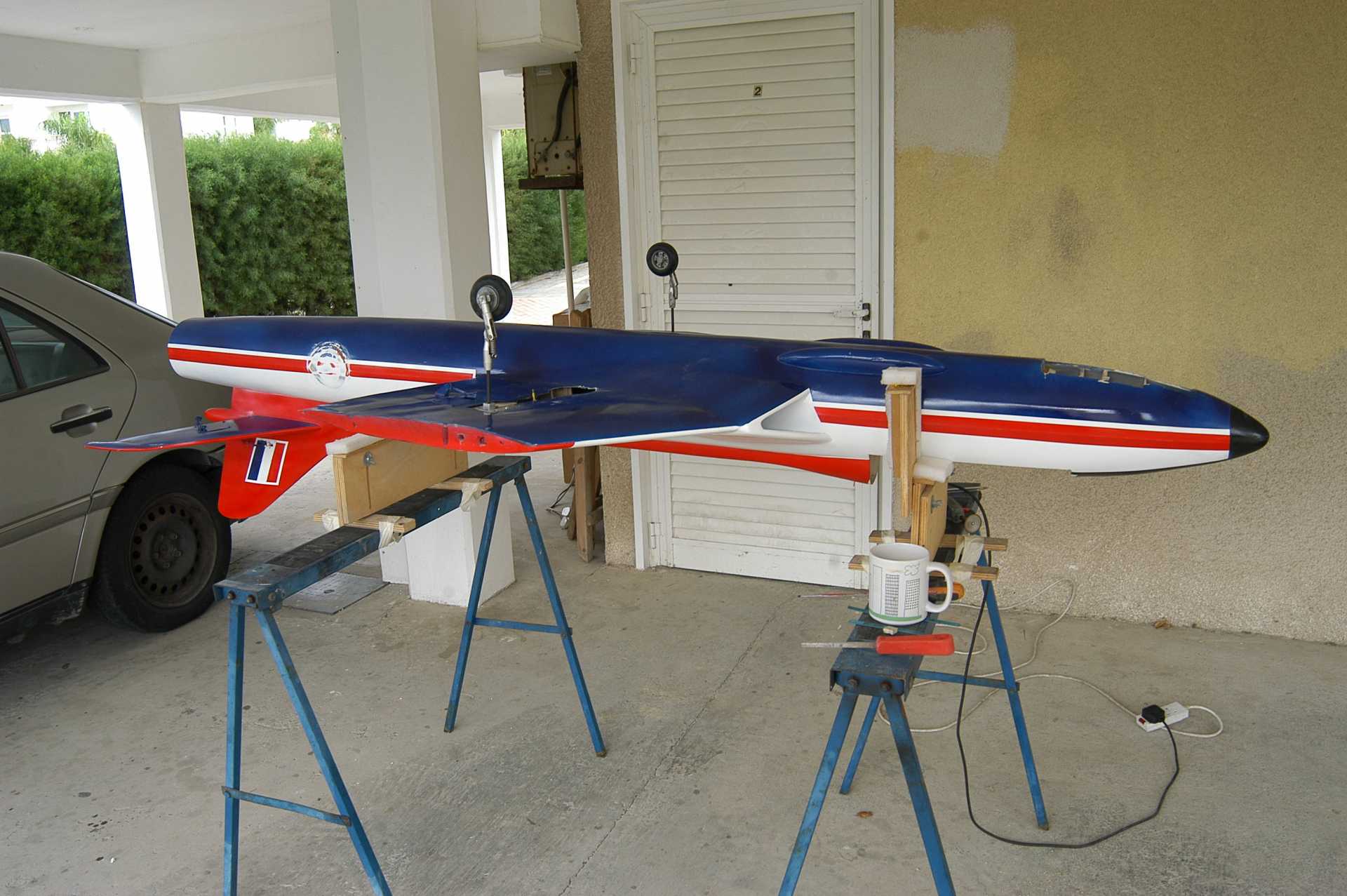

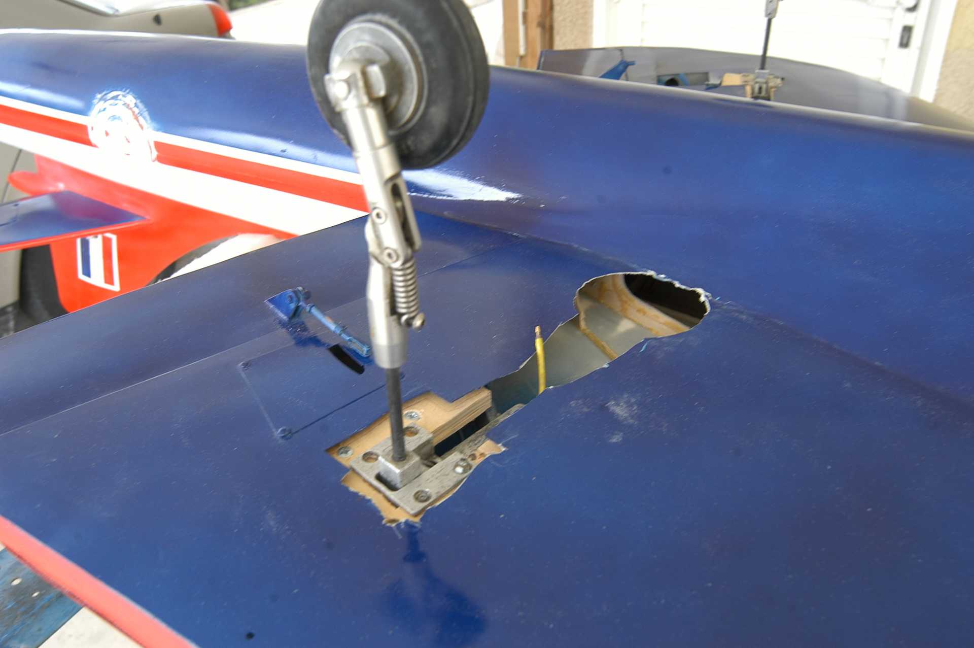

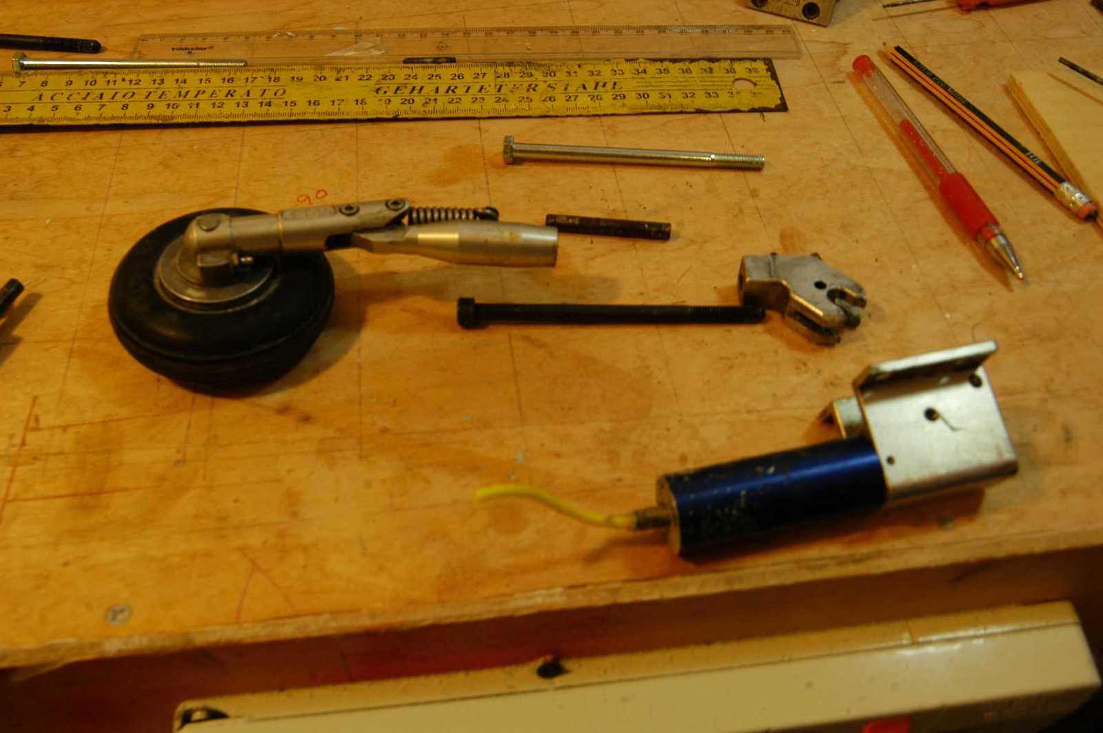

Dug the retracts out today that were one the two jets that iv crashed, im going to make them fit the Hunter some how
I will cancel the order for the proper retracts as I just cannot bring myself to pay that sort of money when the plane cost me less than half that to build
They will not be scale but who cares they are just there to get it up and down
Hopefully :whistle:
Just got to lengthen them by about 65mm and try and get the angles to work

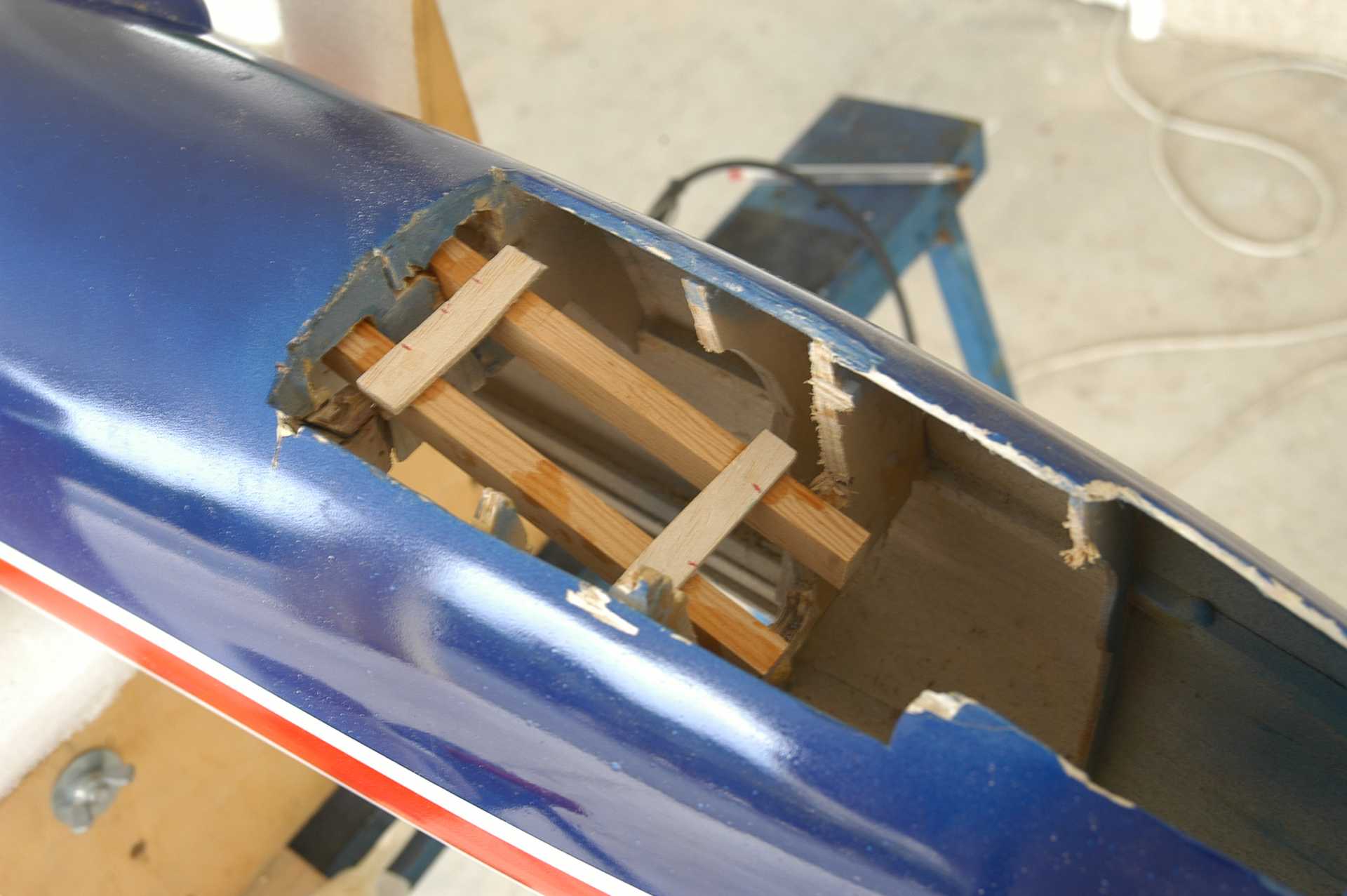

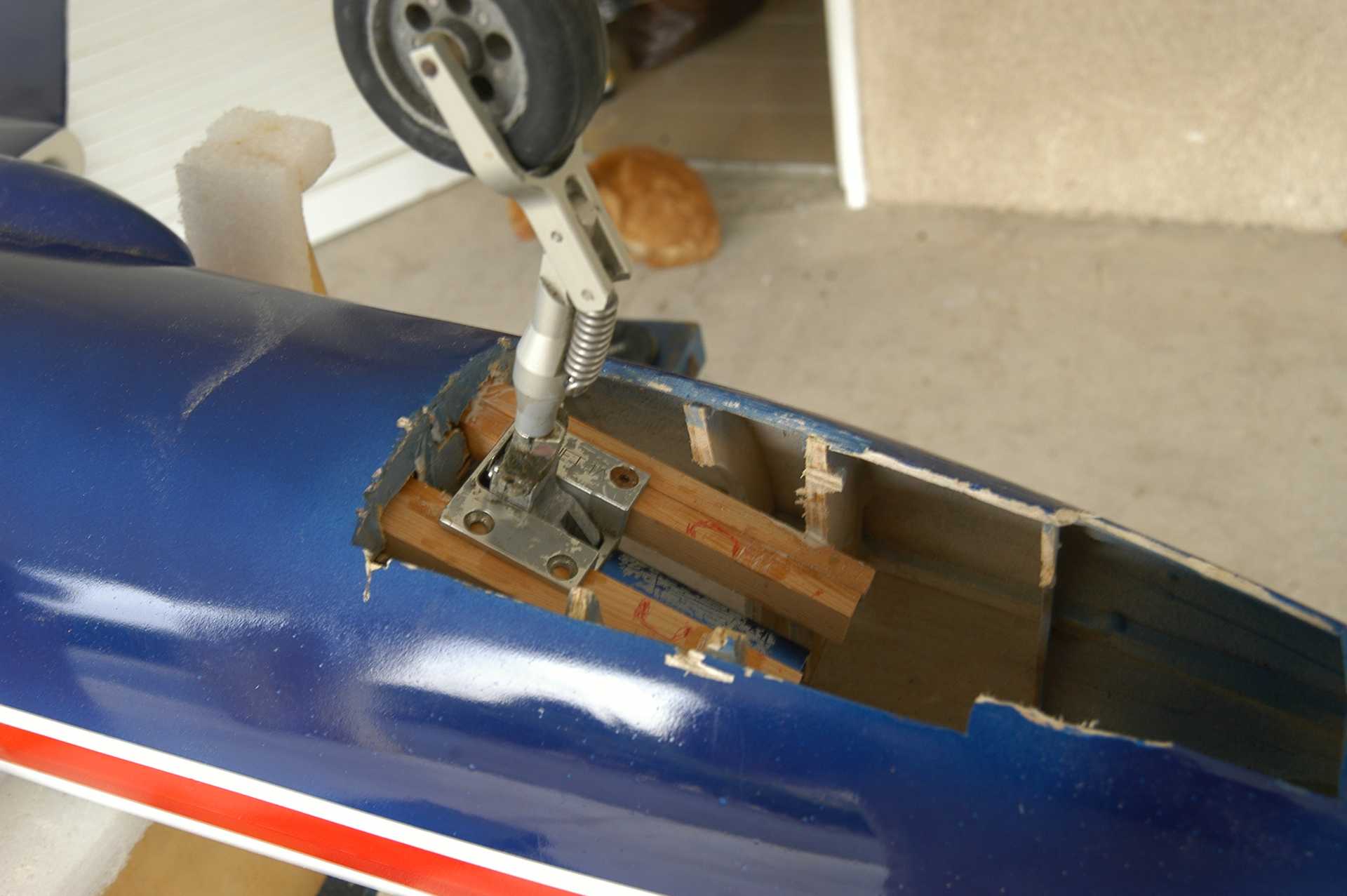

After a lot of jiggling about I recon I have got it sorted
Just got to beef up the leg wire but they are at the correct angle and they tuck away in the wings when retracted
The nose leg I had to carve out all the original supports and formers to get it to retract fully
just going to sort the air lines and fittings then it will be job done with a large saving of money :) :)

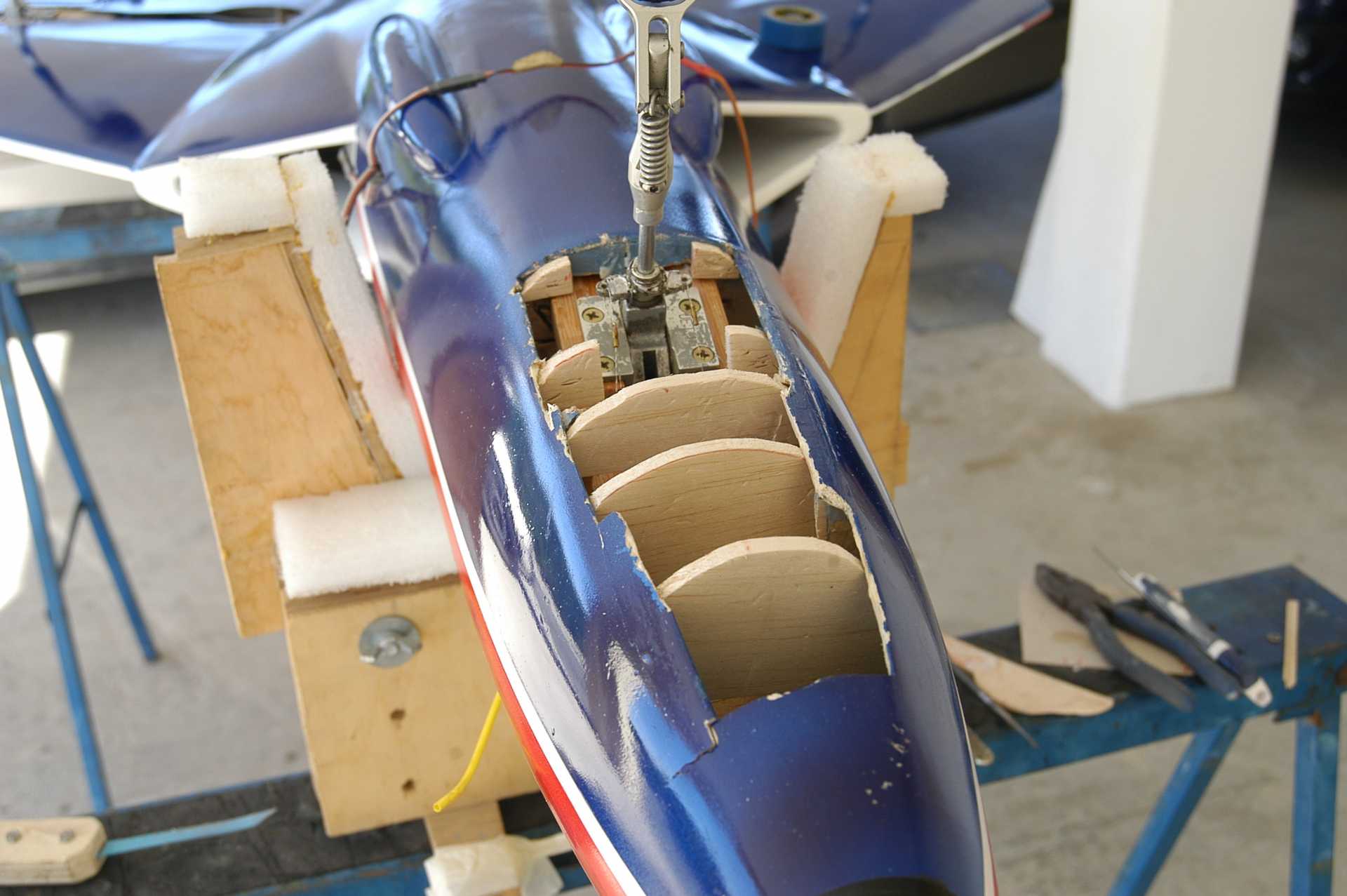

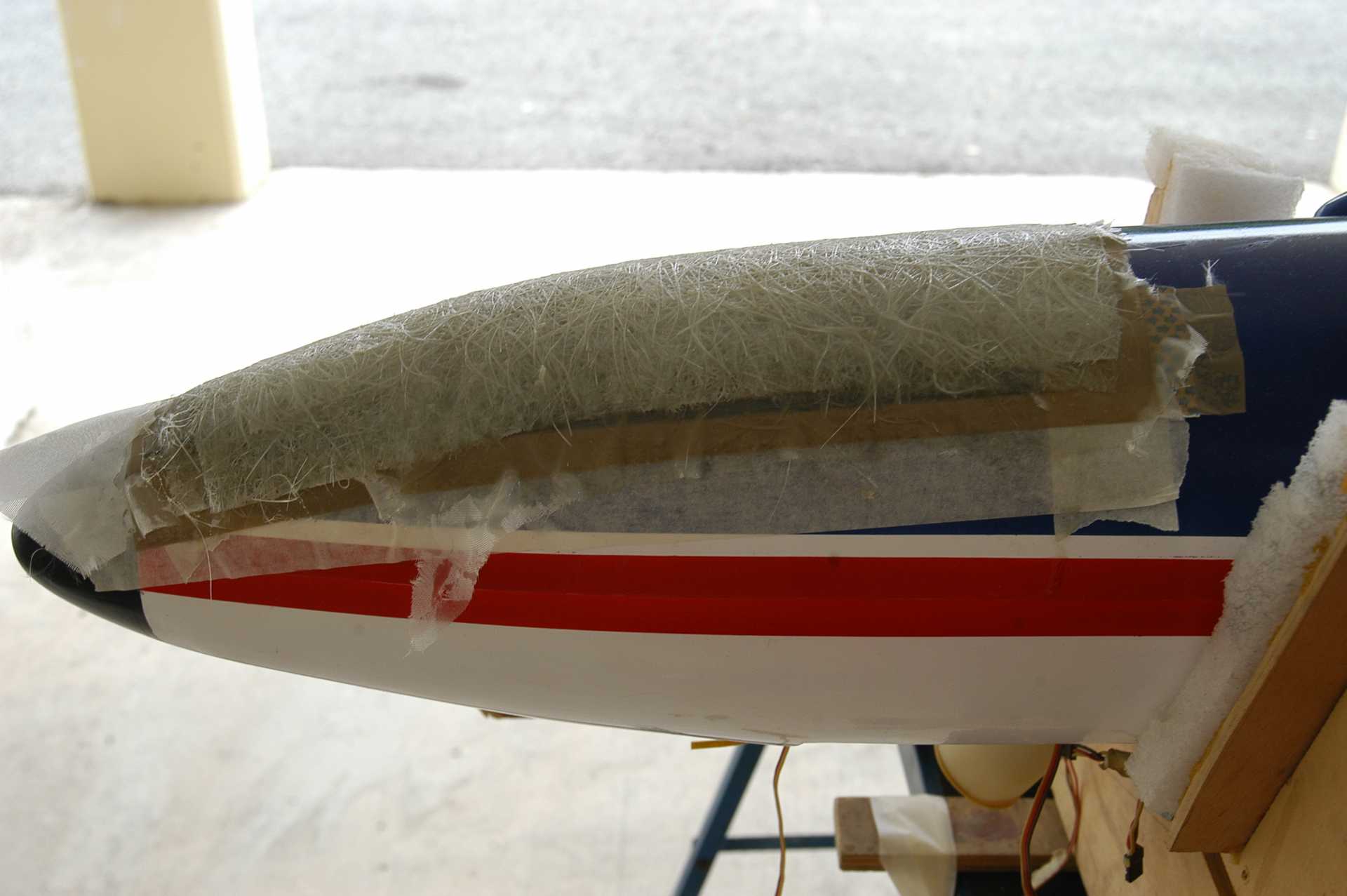

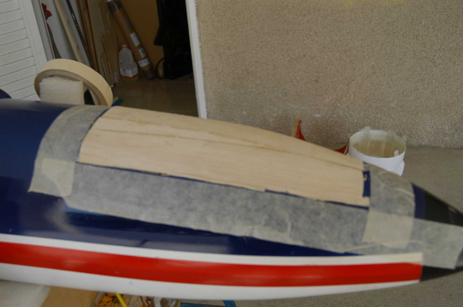

Started to fill in the front end where I had ripped it open
Planked it sanded it down and gave it a coat of fibre cloth and resin
Filling in the wheel wells
And trying to make some doors to fit, this is the plug to make a mould from, then ill do them in glass fibre
Having to put a curve on them

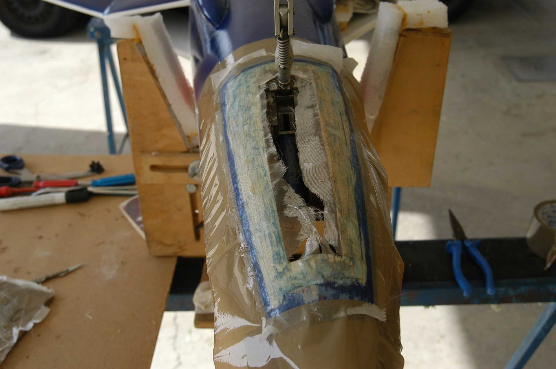

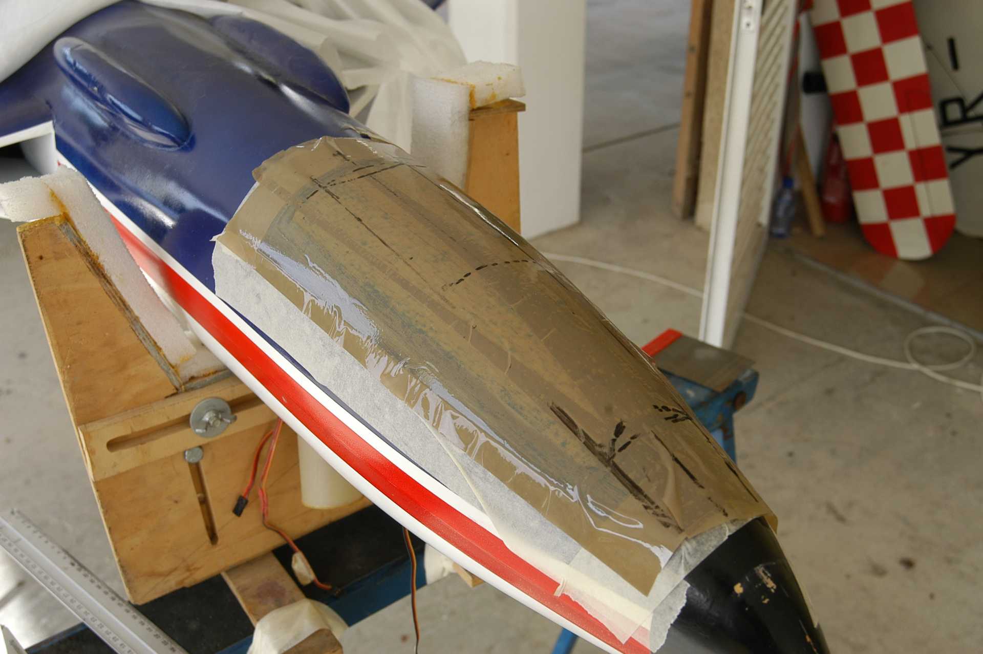

I covered the nose wheel area where I want to cast the fibre glass doors with brown packing tape, instead of polish and mould release
Then glassed straight on top of it to make the mould
And the same for the main gear door
And it worked a treat, just popped off, surprised and pleased

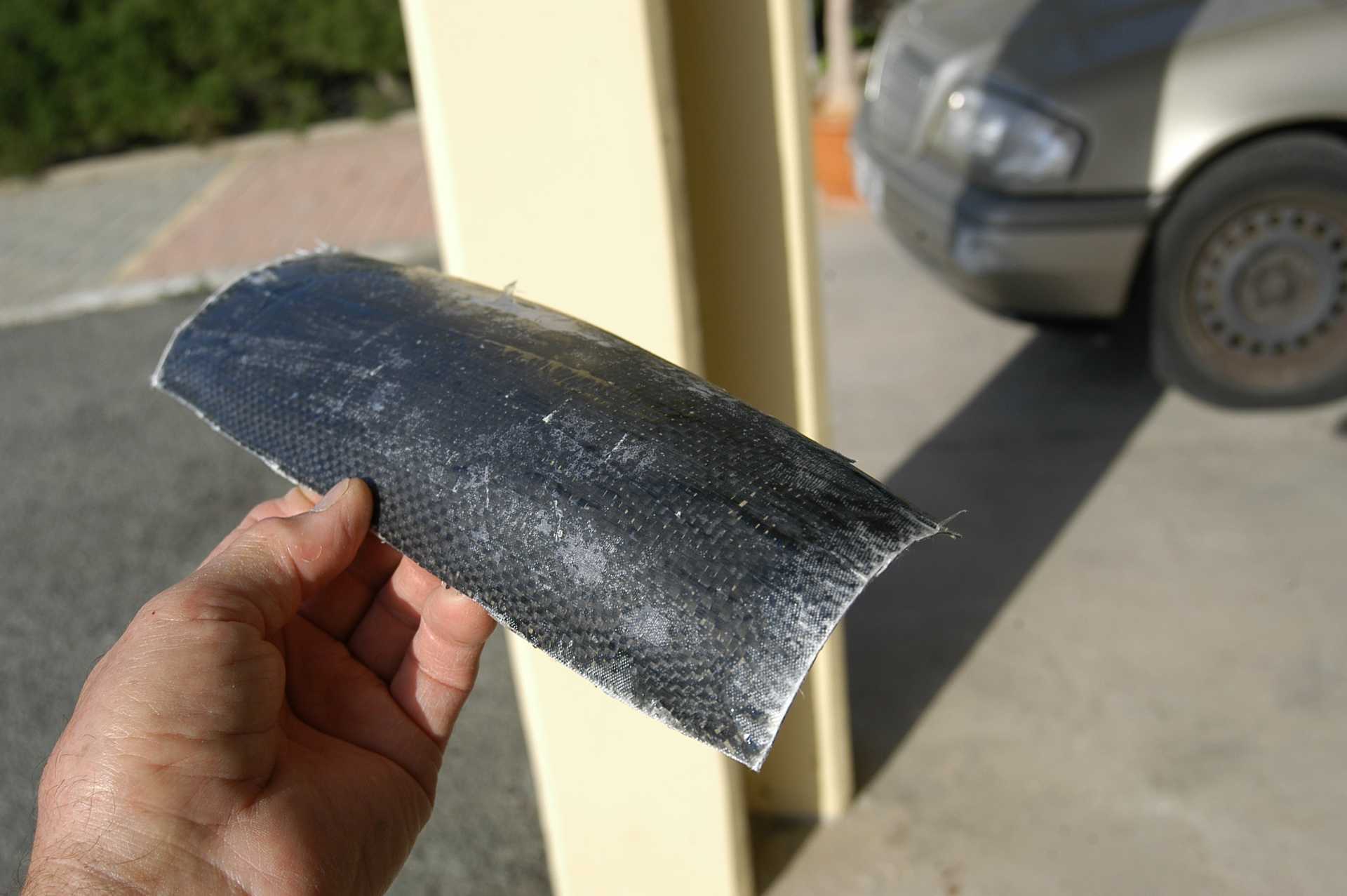

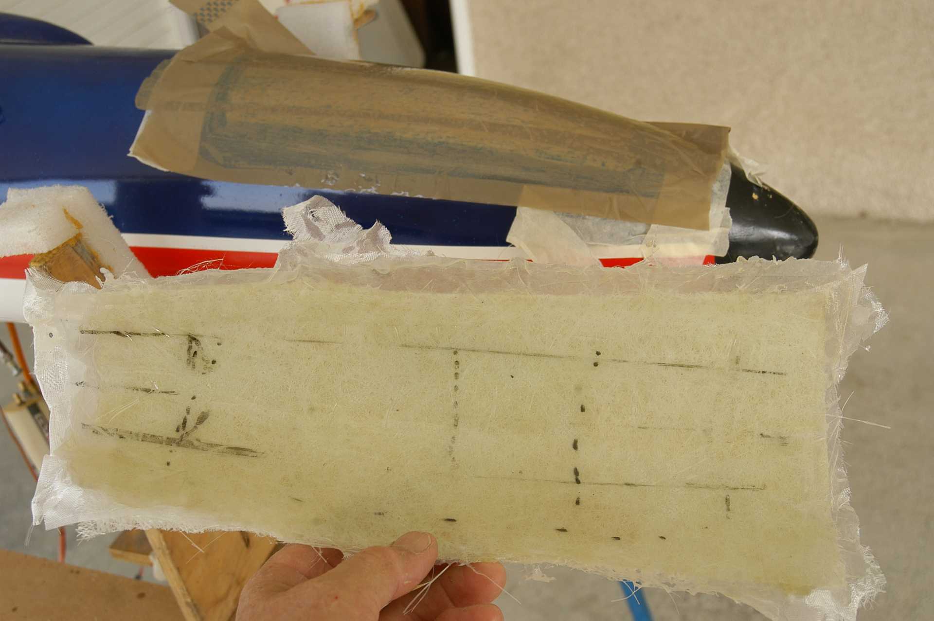

I cast the nose wheel door with 6 layers off cloth and one layer of carbon cloth to give it extra strength, don't realy know what im doing as I have never used it before,
Like most things I do in modelling now days is all a learning curve
Had some more dam resin that has not gone off, its still tacky after a couple of days, on the single layer I put on the nose door planking, had to scrape it all off, what a bloody game.
Done it again using polyester resin this time instead of epoxy :S

Cast some main gear doors, pleased with the way they came out, nice and thin and flexible so they will sit snug against the wing, well that's the theory anyway :S
And the nose leg door came out ok as well, very rigid with the carbon inlay
