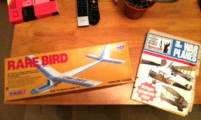

Coming soon to a forum thread near you, The Rare Bird with a wing span of 90cms. Suitable for towline launch or slope soaring
This thread is rated a PG and may contain scenes of [strike]se..[/strike] (yeah, right!) , violence (hammer to balsa), nudity (bare balsa, stop dribbling Beardie :evil: !) and bad language (oh flippin eck, bloomin nora etc)
Although the temptation to kick a fluffy stuffed cat may be strong at times, we would like to assure readers that no animals will be hurt in the making of this thread........although there may be a few glued accidently to the table!! :evil:
Will start this build tonight hopefully, when Izzy has gone home, being as she got hold of a red felt tip at home the other day and coloured the westie in!! It is now sporting a lovely "pink" patch to its side fur!!! so I trust her near this glue and crafting knife like a hole in the head!!
