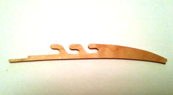

plywood skid/towhook 1.5mm thick x 2 put together and glued then sanded (fiddily suckers to get inbetween! )
17 Dec 2013 20:02 #34 by Eric
Replied by Eric on topic D.P.R Rare Bird Sailplane
Use a cardboard nail-file!

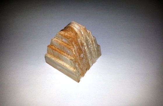

All nose block laminations glued together ready for sanding (looking foward to this bit! :) )
Everything has now been sanded nice and flush to its counterparts. I like a neat job :lol: :lol: :lol:

any tips on the nose mucho appreciated before I start sanding- am not 100% sure which way up it is supposed to be but looking at the plan the smooth areas (see picture) are the top and bottom of the nose, the "steps" part (cant think how to describe it lol) are the sides of the nose.
17 Dec 2013 20:20 #38 by alan cantwell
Replied by alan cantwell on topic D.P.R Rare Bird Sailplane
Wont matter much if you attack with sandpaper, but if you use a razor plane, the two bits at the bottom may cause you grief, the grains going across the other pieces, you need the grain all going the right way, or the crossgrained wood may prove troublesome, make sure you use a block with some course paper, going down in grades, see if you can find some garment paper for that final sanding--lovely stuff :)
17 Dec 2013 20:29 #39 by Sarah-Jane Smith
Replied by Sarah-Jane Smith on topic D.P.R Rare Bird Sailplane
These pieces were already dye cut onto the sheets of balsa :( so didnt have much option with the two bottom pieces grain going wrong direction but if I was doing it myself free hand I would have all grain same way, cos am a finicky one hehe!
Am I supposed to round the edges too, or do they remain sharp?
17 Dec 2013 20:35 #40 by alan cantwell
a nice rounded shape, just like your
erm, nose :whistle:
17 Dec 2013 20:41 #41 by Sarah-Jane Smith
alan cantwell wrote: a nice rounded shape, just like your
erm, nose :whistle:
ROFLMAO-I won't tell you what it is resembling at the moment, cos it is rude, but it is not an appendage I have!! haha!
How rounded are we talking, like making it more a cone shape all the way around or just rounded a tad?
17 Dec 2013 21:02 #42 by Eric
Like a rounded cone, not a pyramid! Although as the fuselage is basically a square box, start square at the fus, and go rounder as it goes towards the point.
The stepped edges are the sides, so look at the fus, hold the nose block on, and see which way looks best to you, if the other two sides aren't identical.
You usually find the underside is the flatter of the two.
The drawing should show you, as well.

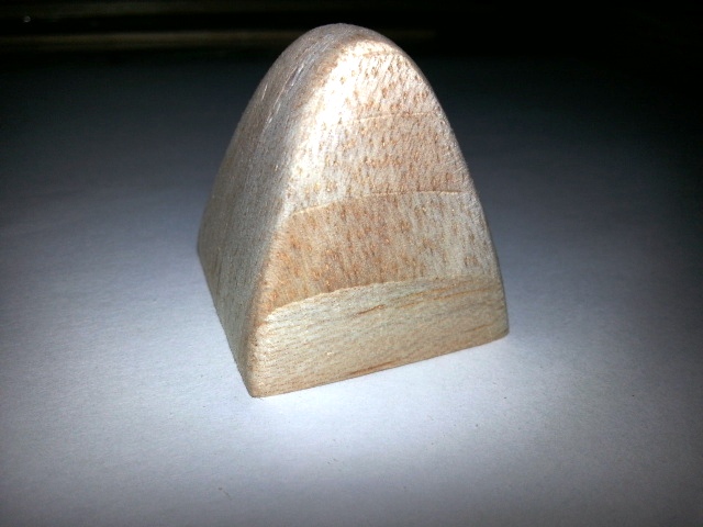

More rounding needed?
Thanks: blue123, old fart
17 Dec 2013 22:36 #44 by Eric
As I said above - match it to the fuselage shape, at the base, but round off the corners more as you go towards the top.
