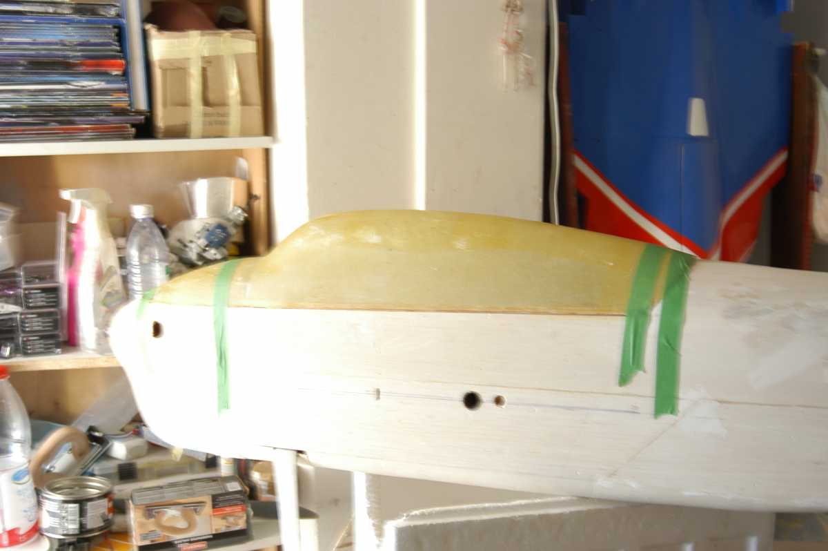

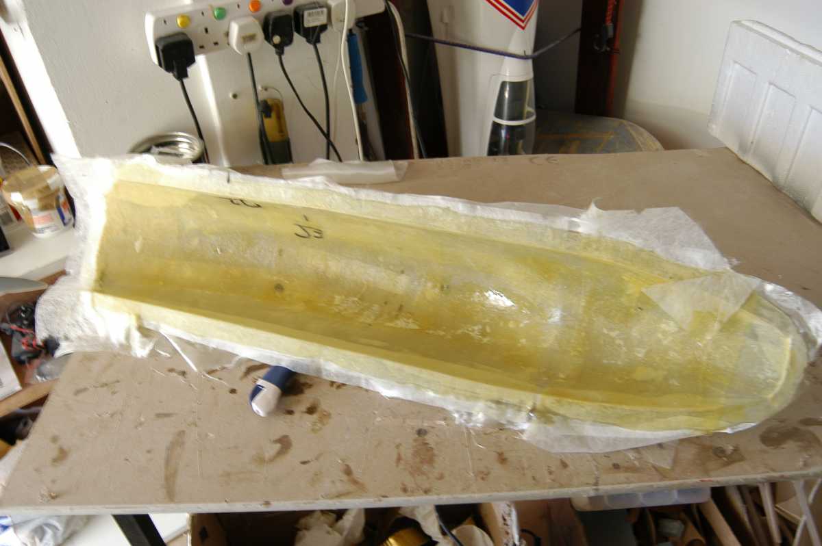

Another NEARLY successful bit of fibre ing, did the hatch and it came out of the mold ok
Only problem is trying to keep it as light as possible i made it to thin, so will have to do another one :S
If it fly's ok
We will find out in the morning, a 6-30 maiden awaits :unsure: :dry:

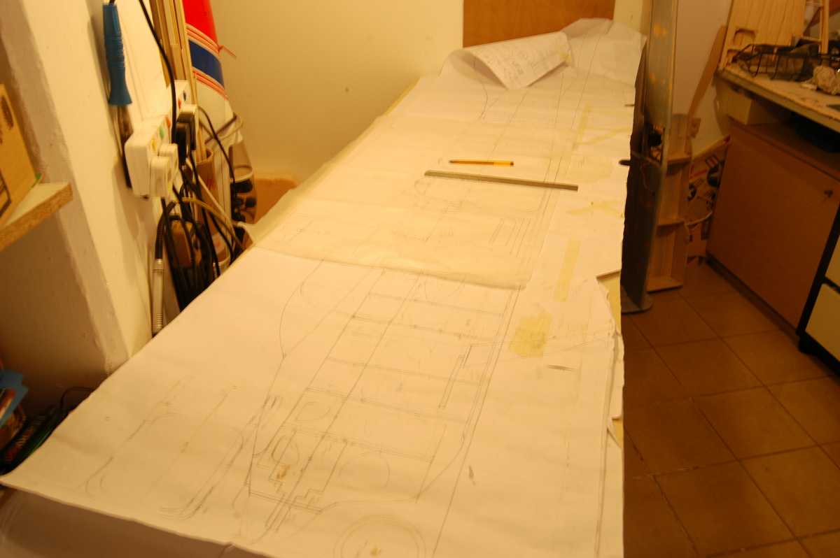

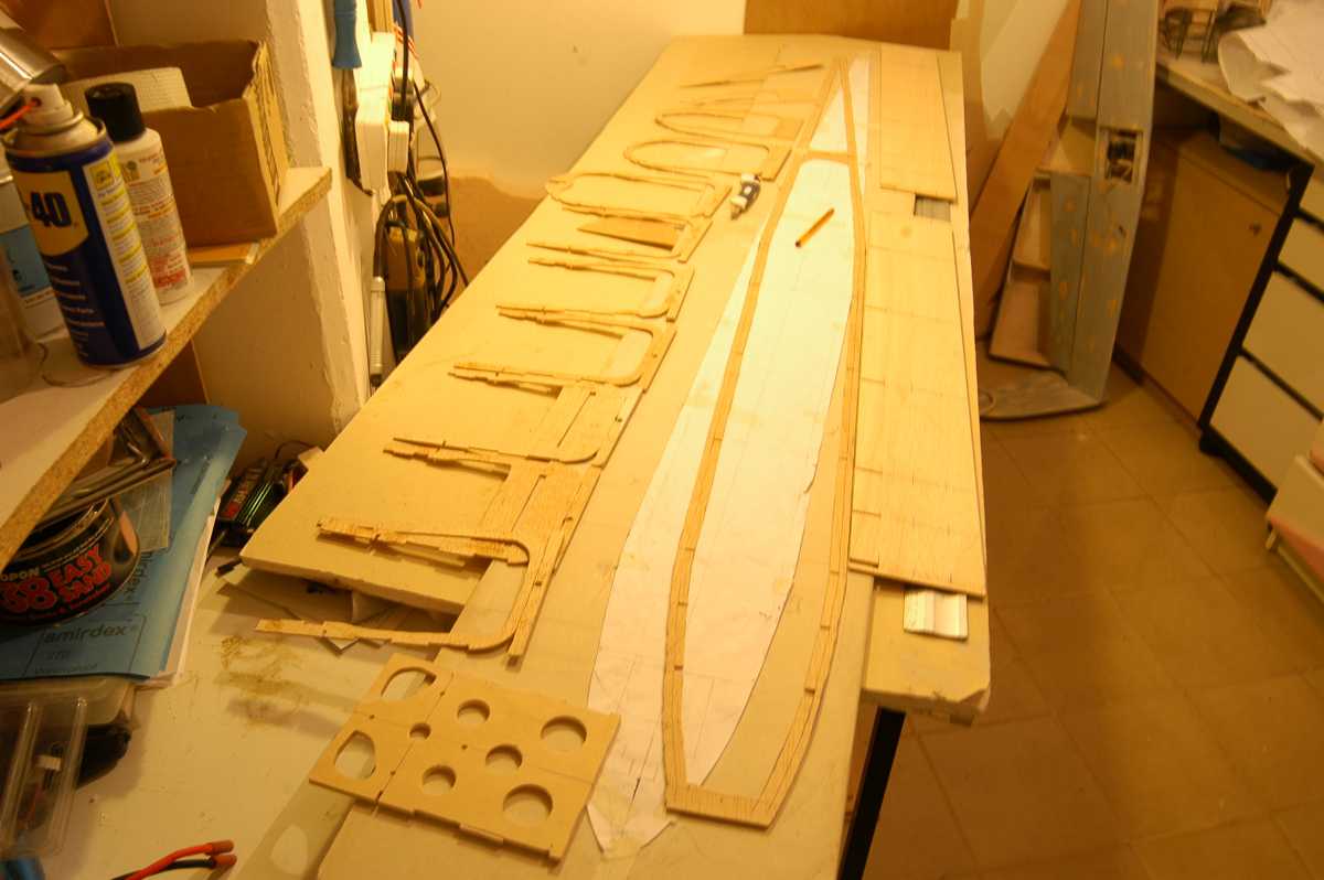

11 May 2014 06:19 #43 by THE BLACKBIRD
Replied by THE BLACKBIRD on topic THE CYPRUS OWN DESIGN 2m x 2m F3A

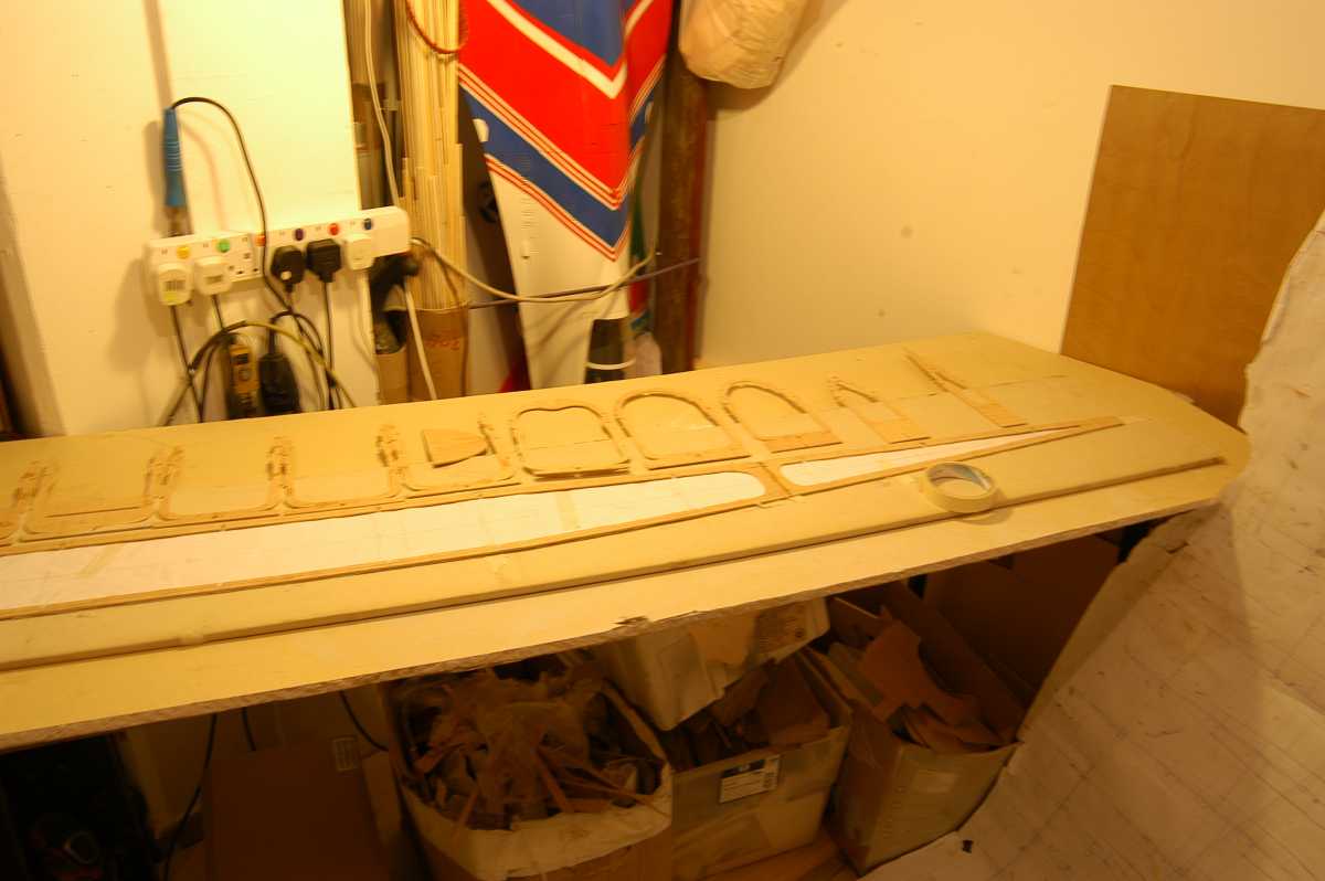

VERSION TWO
Made a start last night got the drawings out
Markked the formers out
After a couple of hours with my scroll saw
I had the formers cut from 2mm ply and the side strengtheners from 3mm ply
I had marked the formers for 2mm side pieces but found i did not have enough so will have to make some ajustments to the formers

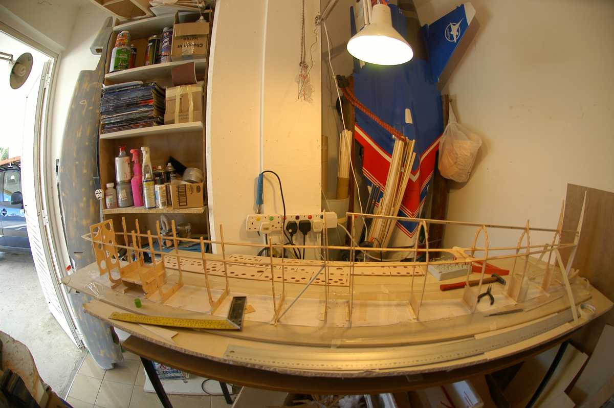

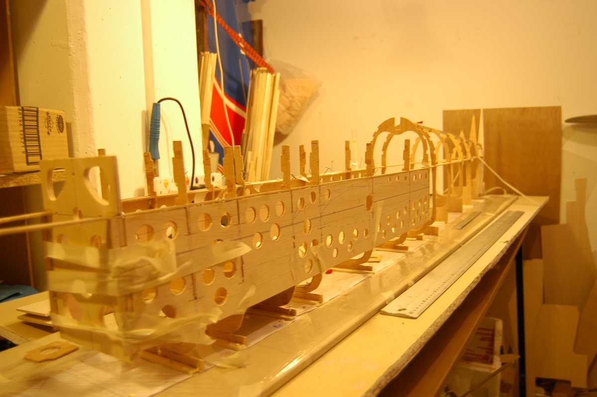

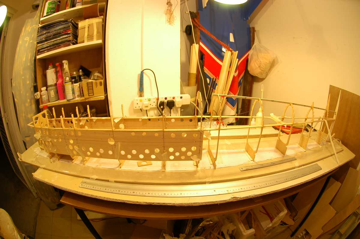

11 May 2014 18:46 #44 by THE BLACKBIRD
In answer to our leader :P another post with a lot of pics to fill it up :)

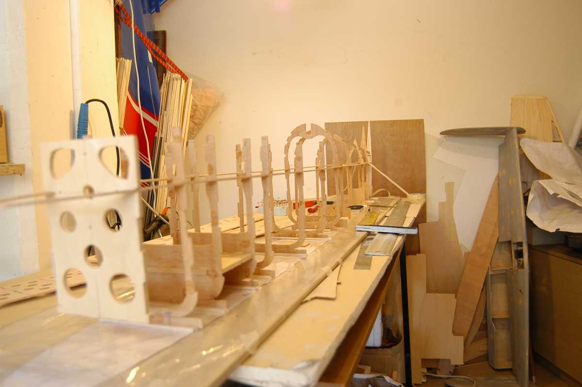

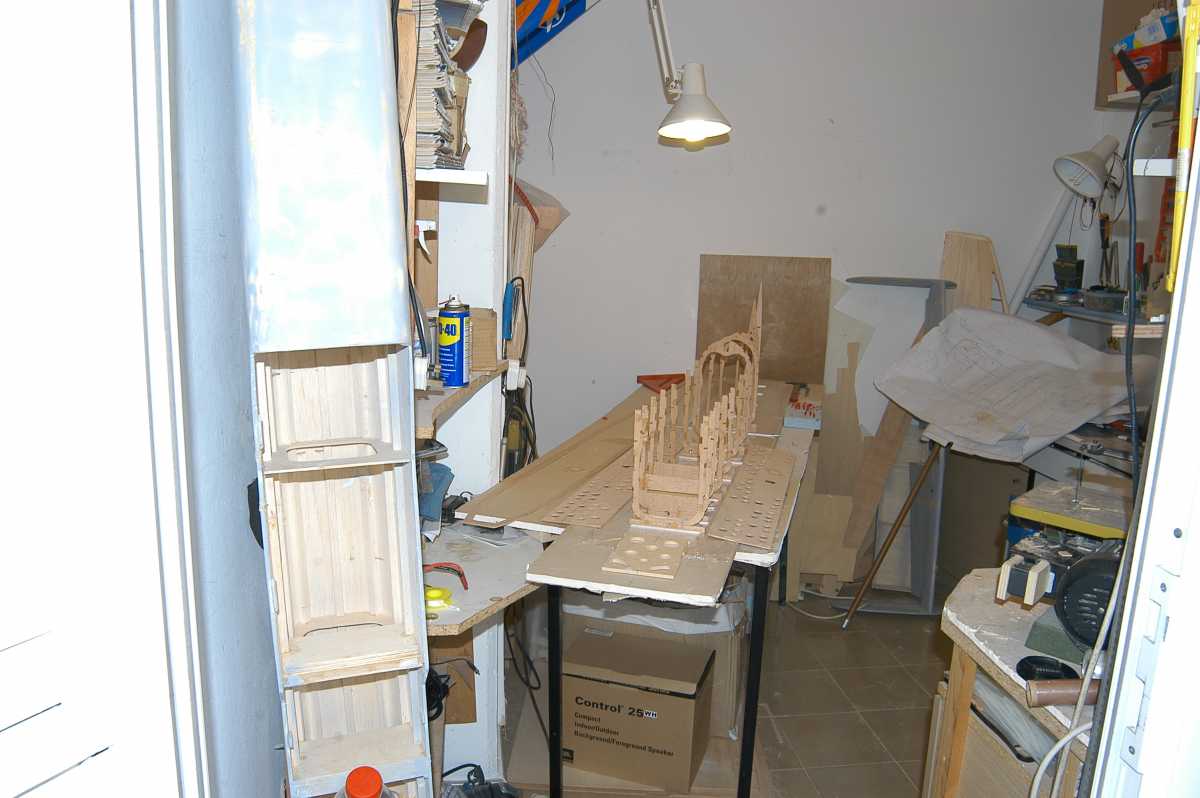

Setting up the formers
Then the horizontal crutch
Then the side strengtheners
