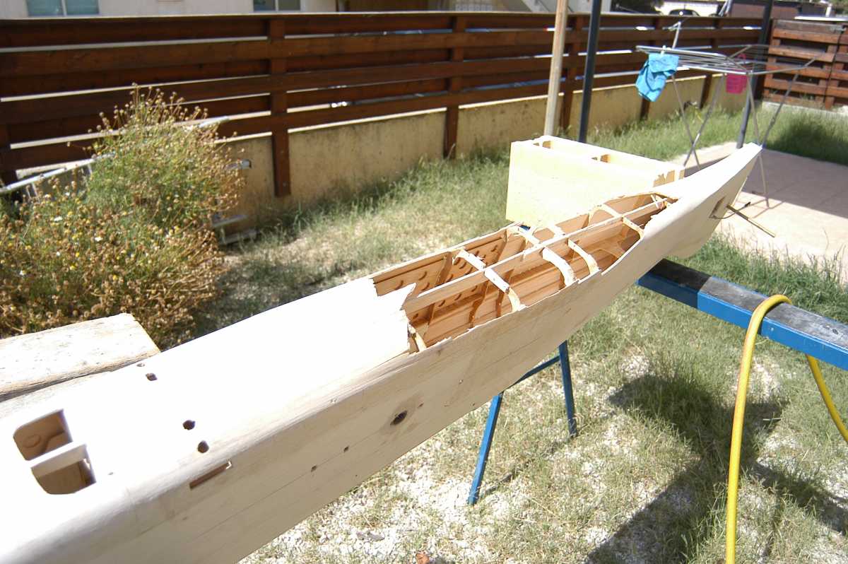

When you are scratch building in the outback like this place i have to use what i can get hold of, but i think it will be ok Alan

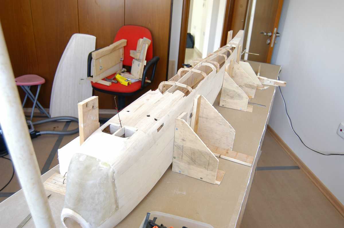

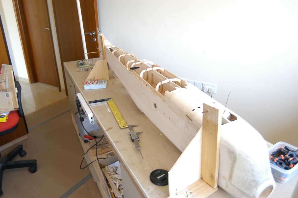

The hose pipe and concrete blocks did not work ( i must build them to strong ) so i stuck my fist through it and ripped the bottom planking off
I made up some square angles to brace it with and spent a long time trying to get it straight
added some temporary braces inside , but i have no sheeting to plank it :S :S

How did you manage to build it bent in the first place? :S

If i knew that Owen i would not have had a bent fuslarge :) i realy have no idea how i did it, but whats amazed me is the fact that i never noticed it because it's quite a while since i planked the bottom, must be losing me touch or mind :silly:
Dont know wether to practice my glassing on it or cover with film :ohmy:

I built a bent one years ago, so I just made sure that everything lined up properly and it flew just fine. :)

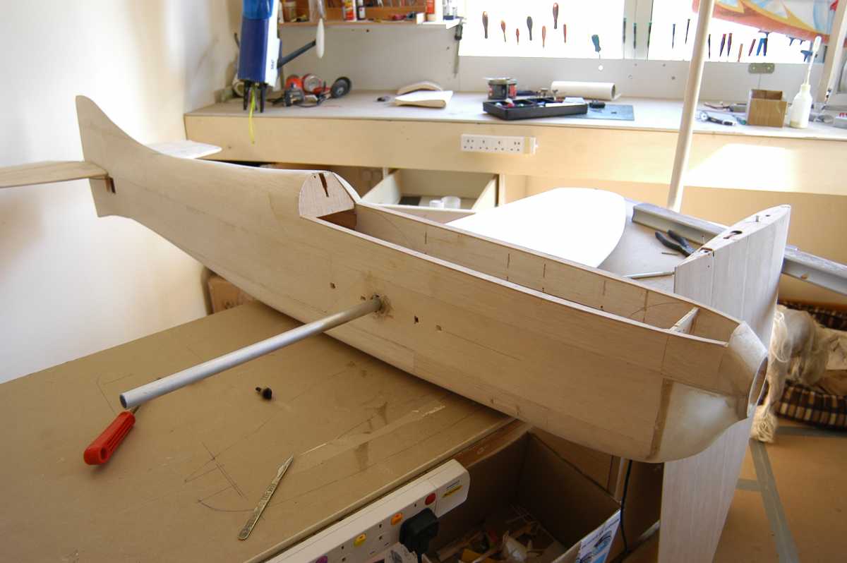

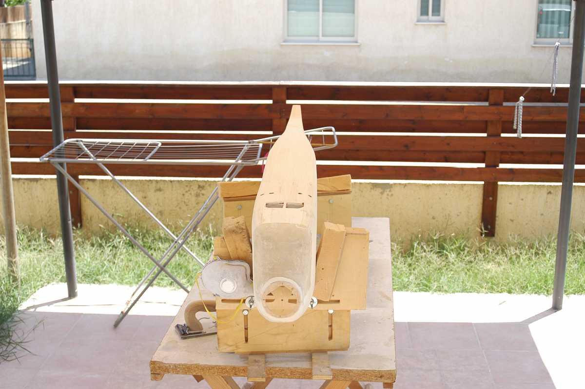

Got the planking done and released it from the bench and its come out perfic :P :P :P
Had to realine the wings and conopy / hatch as they did not seat well
So im pleased with it, think im going to do it in the 4oz glass cloth that i have or it means waiting three weeks if i order tomorrow

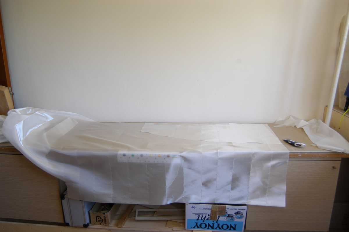

Cutting all the cloth to sizes,
Cloth all fixed and drying

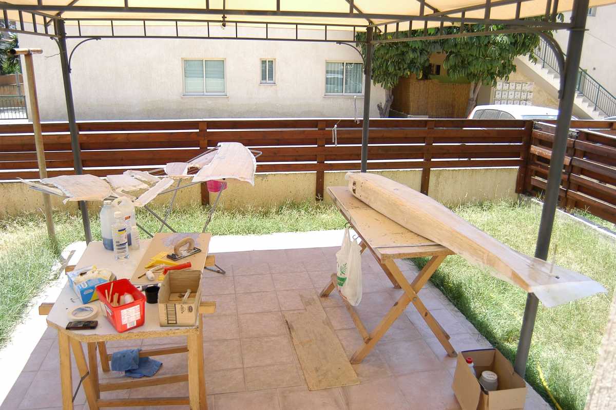

Gott it all glassed and rubbed down, and i put a second coat of resin on with a roller today and hung it all out to dry
Will give it a couple of days to harden then wet and dry sand it all off ready to spray primer on
