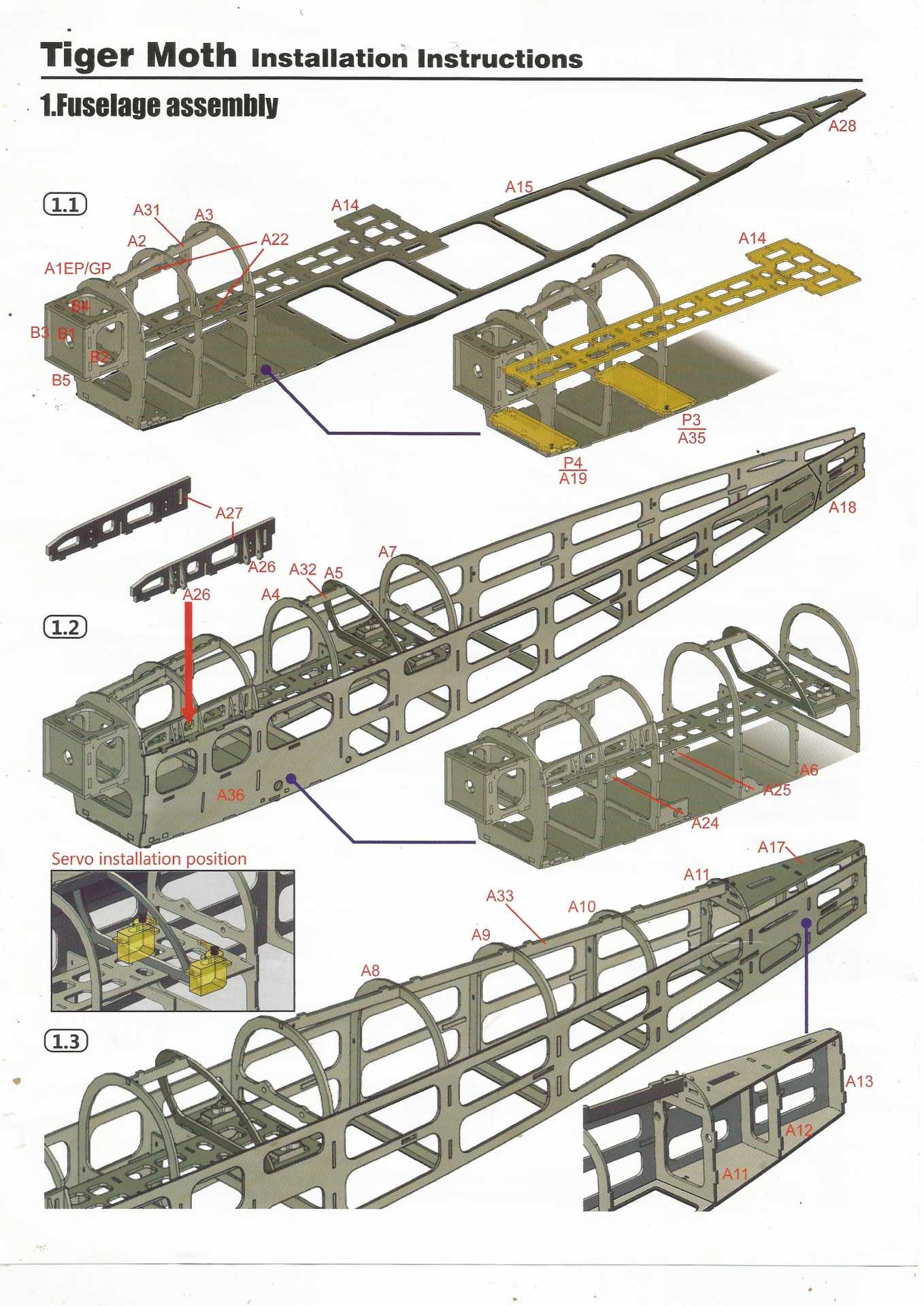

03 Jan 2018 09:17 #7 by Klipkopwildlife
Replied by Klipkopwildlife on topic Tiger Moth
Opening the box, which feels quite heavy, reveals a large quantity of laser cut wood, most of which appears to be light ply.
And no instructions! Definitely not for the beginner then, just 6 sides (3 pages) of pictures.
The first decision, Glow or Electric. The legend A1EP/GP at the top left would appear to indicate that there are different bulkheads to be used.
Thanks: old fart, Ex-Member, boz, Firewood, Squirrelnet

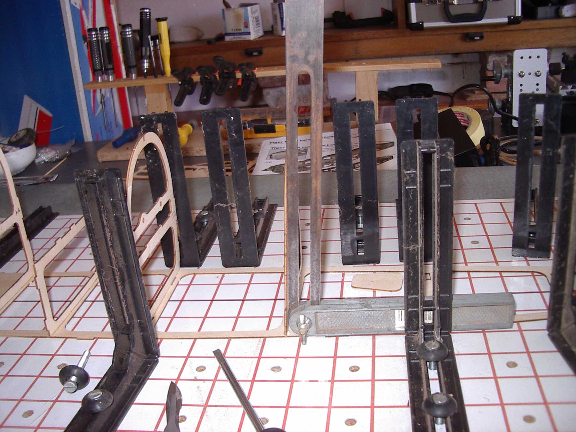

03 Jan 2018 10:06 #8 by Klipkopwildlife
Sure enough the sheet showing the part numbers shows 2 different bulkheads. A Brownie point here, not all manufacturers provide a reference sheet, Goldberg for example!
At this point I made the decision to Epoxy all front bulkhead parts, I only use Araldite 24hr since I have had problems with most local epoxys'.
So first job glue A1GP together since I'm a committed 'oily hand'.
My first photo should have been a pile of laser cut sheets, it is instead the bottom fuselage former firmly secured to the building board!
Thanks: Quorneng, old fart, Ex-Member, boz, Firewood, Squirrelnet

03 Jan 2018 17:28 - 03 Jan 2018 18:05 #11 by Klipkopwildlife
Thanks Andy, I've emailed Sarik with a query about carriage.
Main formers 1,2 and 3 in place, A1 is epoxied, I thought I was going to cyano the others but the stuff I have won't work, wicks into the grain but won't stick, so I'm going with aliphatic glue, just takes longer.
Another disappearing photo, I thought I was going to show you gluing A1 -3 nicely square.

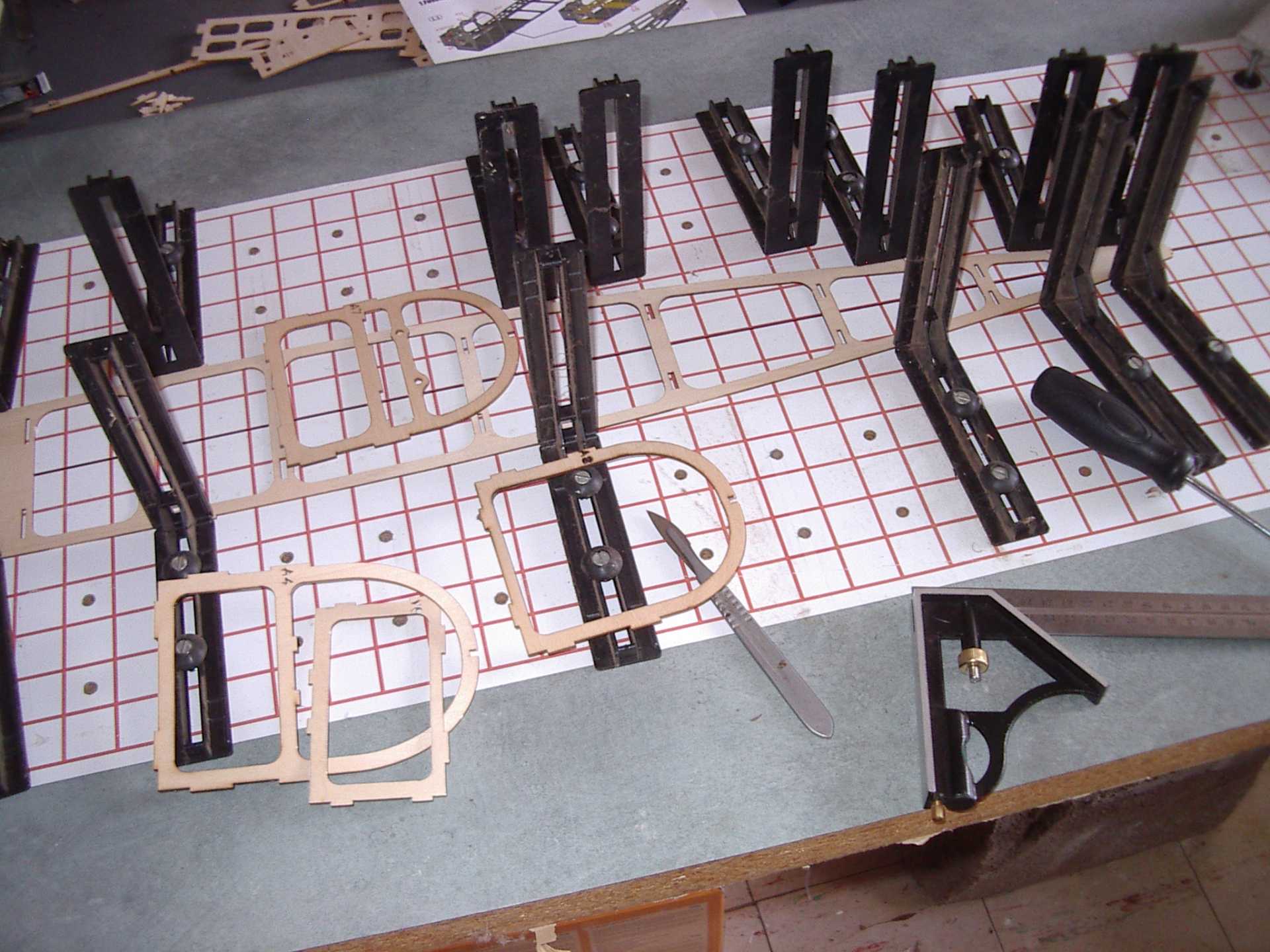

06 Jan 2018 07:32 - 03 Mar 2018 13:24 #13 by Klipkopwildlife
2 steps back now, do not try and push the parts out of the sheet, this 'crumble wood' as Eric would call it splits and cracks with very little provocation. Sometime the cutting doesn't quite go all the way through.
As can be seen here, study the back of the sheet and use a blade to complete the cut. Then there's the tabs, they're there so that bits don't fall out during removal from the cutter and while packaging. I study the back of the sheet first and press my blade against each tab, about half way through, then turn over and repeat, the parts will push out very easily. Without cracking or breaking.
NOTE, many of the parts have lightening holes cut in them that have to be cut out, Save the holes, you might need them later!
