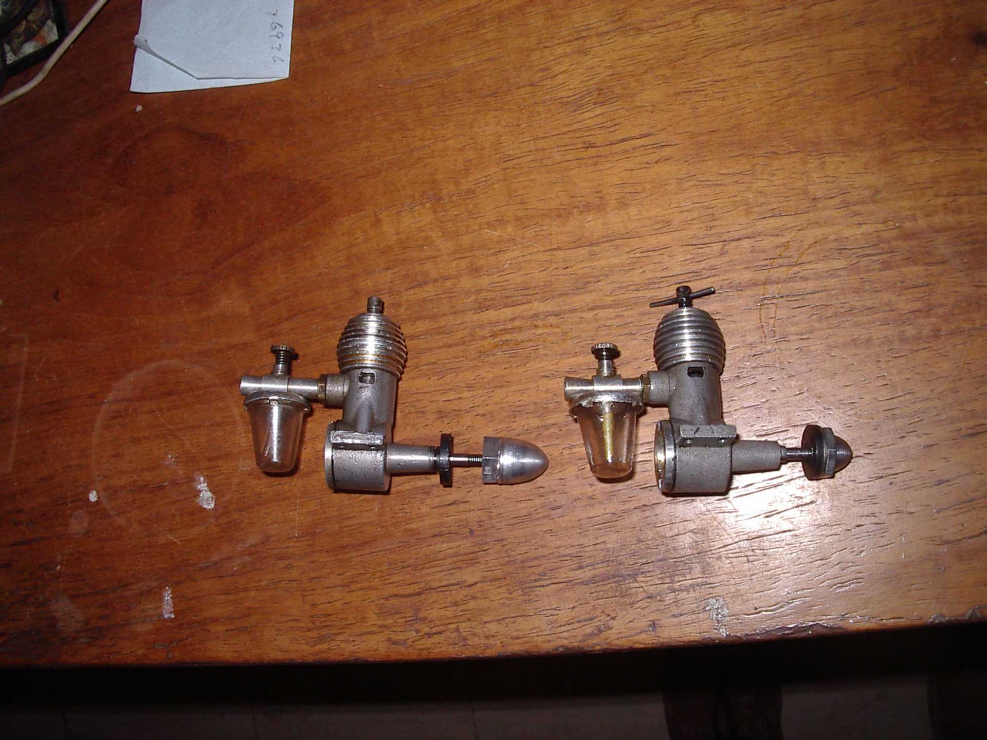

Well, she runs! Not well but it's a major step forward. Compression is good but the mixture seems to be very variable.
First the new rod.
On the left is an old rod that failed when the piston was slightly tight in the upper cylinder (TDC) The new one is 4mm thick at the big end and 5.7mm wide. The taper is roughly 10o and the neck under the small end is 2.7mm. This size is 4.5mm under the small end to clear the piston skirt. The new small end is 3.5mm thick and 4mm wide. Bearing centres are 19.5mm apart.
As you can see there's not a lot of room.

The piston seems to travel rather far past the exhaust ports at bottom dead centre so now I have a bench mark I'm making a conrod with 20.5mm between bearing centres.

The new conrod was a little better but I'm now in the situation where I don't think the very small amount of fuel I have is any good. I don't have any ether to make new and any new supply is at least 4 weeks away. However both engines can now be considered as runners so I made the unilateral decision to send them back to Box otherwise we'd be waiting for another 2 months! When I was packing them up I noted that they were posted to me on the 12/12/2016. What with the awful postal service in this country and the fact that I can only afford to go to town once a month, anything I do has a very long turn around time! I have videoed the run and will post it on the tube as soon as I can remember my login name!

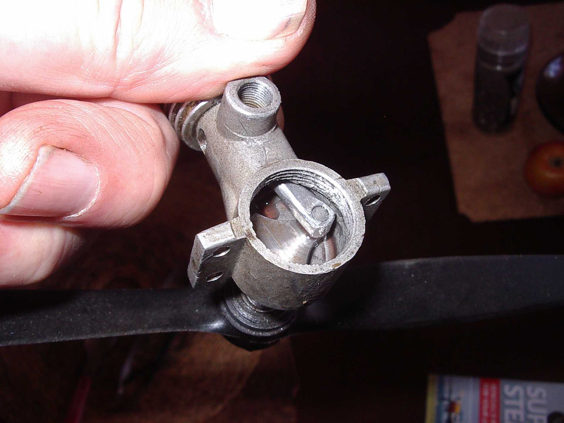

Time to put this to bed, Box has contacted me to say he's received his engines but due to a family bereavement him won't be able to do anything with them for a while.
The project was a qualified success, one motor runs well, the other is not so good. The one with the clean tank starts and runs nicely, the other one runs, but not well. I think it's a problem in the tank, needle valve assembly. I was reluctant to do anything about it since the bowl is only held on with tabs and I see they've been opened before and I didn't want to be the one to break them!
