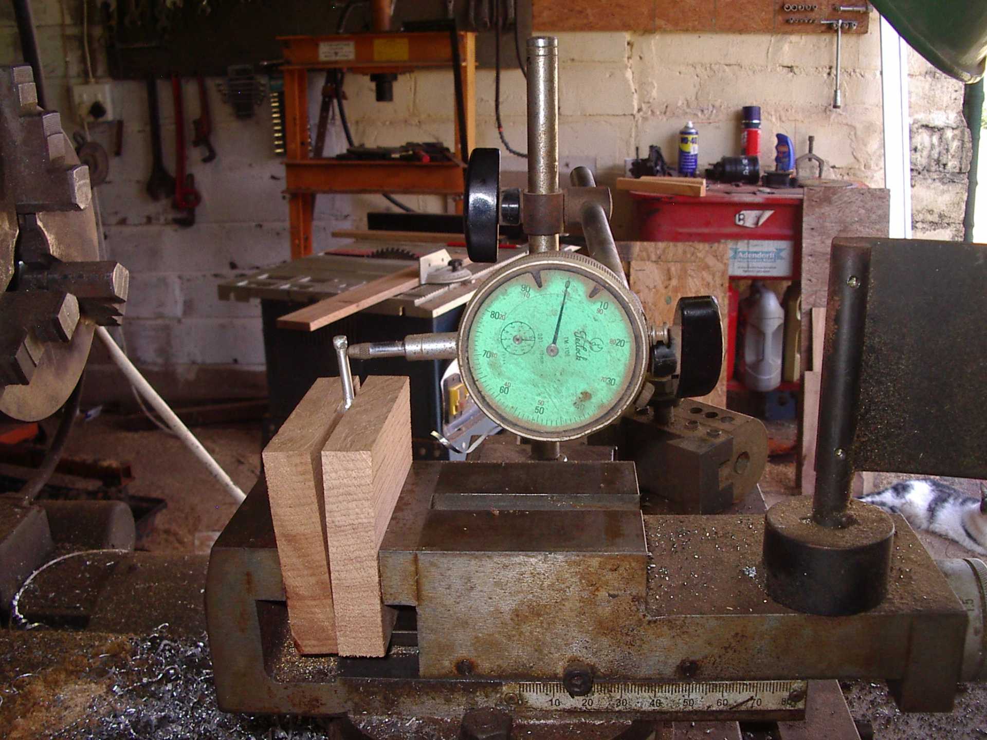

The long and short of it is that #1 won't start. I pulled out my Mills 1.3, that started on the same fuel, so the only explanation is that we have insufficient compression in #1, so as the Americans say, 'go back 5 and punt'.
I'm still cogitating over that.
#2 with the bent conrod. The problem with aluminium is it work hardens very quickly so I will only get one chance. I'm currently figuring out a way to straighten it that is repeatable. ie, if I go too far I won't be able to bring it back again. Which will mean making a new conrod. And we already know that I will never get a reamer that size.
Watch this space.

Klipkopwildlife wrote: #2 with the bent conrod. The problem with aluminium is it work hardens very quickly so I will only get one chance. I'm currently figuring out a way to straighten it that is repeatable. ie, if I go too far I won't be able to bring it back again.
When I was in my first workshop engineering practice training, there was an old boy who liked to show the tyros how fast aluminium hardened by cracking a thin piece with a single blow with a hammer. He would mount the piece in a vice and knock it over 90 degrees and usually it would split most of the way across. Looking back, its maybe as likely the ally tore against the sharp edges of the vice as hardening and cracking, but still, we were young and impressionable.
It is also easy to anneal though - heating it with a flame to almost melting temp and allowing to cool slowly will soften it 'again'. The method I was always taught to judge the correct time to stop heating is to rub bar soap on the piece and stop when it turns brown. The internet says using permanent marker also works.to indicate when to stop. I have a question mark over how deep the heat and thus annealing has penetrated using this method but heating slowly should help and I guess metal conducts quickly.
I put 'again' in quotes because soft aluminium doesn't machine easily so the conrod was probably made from something a bit harder in the first place - for wear resistance too? - so it might need hardening again after straightening. Heat and quench as I'm sure you know.
Hope that helps, good luck, looking forward to hearing how the reality works out.

27 Mar 2017 08:43 - 27 Mar 2017 10:14 #89 by Klipkopwildlife
Replied by Klipkopwildlife on topic 2 little Indians
Jewellers reamers only go up to about 1.6mm, plus, with only 2 or 4 cutting edges the hole they make will never be round. But thanks for the input, every little helps.
I have successfully straightened the conrod.
I put hardwood jaws in the vice and used a clock to measure how much deformation I was applying.
and after. I wound the carriage up to the chuck and applied a known amount of bending. I found that .1mm of bend gave .01mm of permanent set.
Once straight I reassembled the engine ready for testing.
