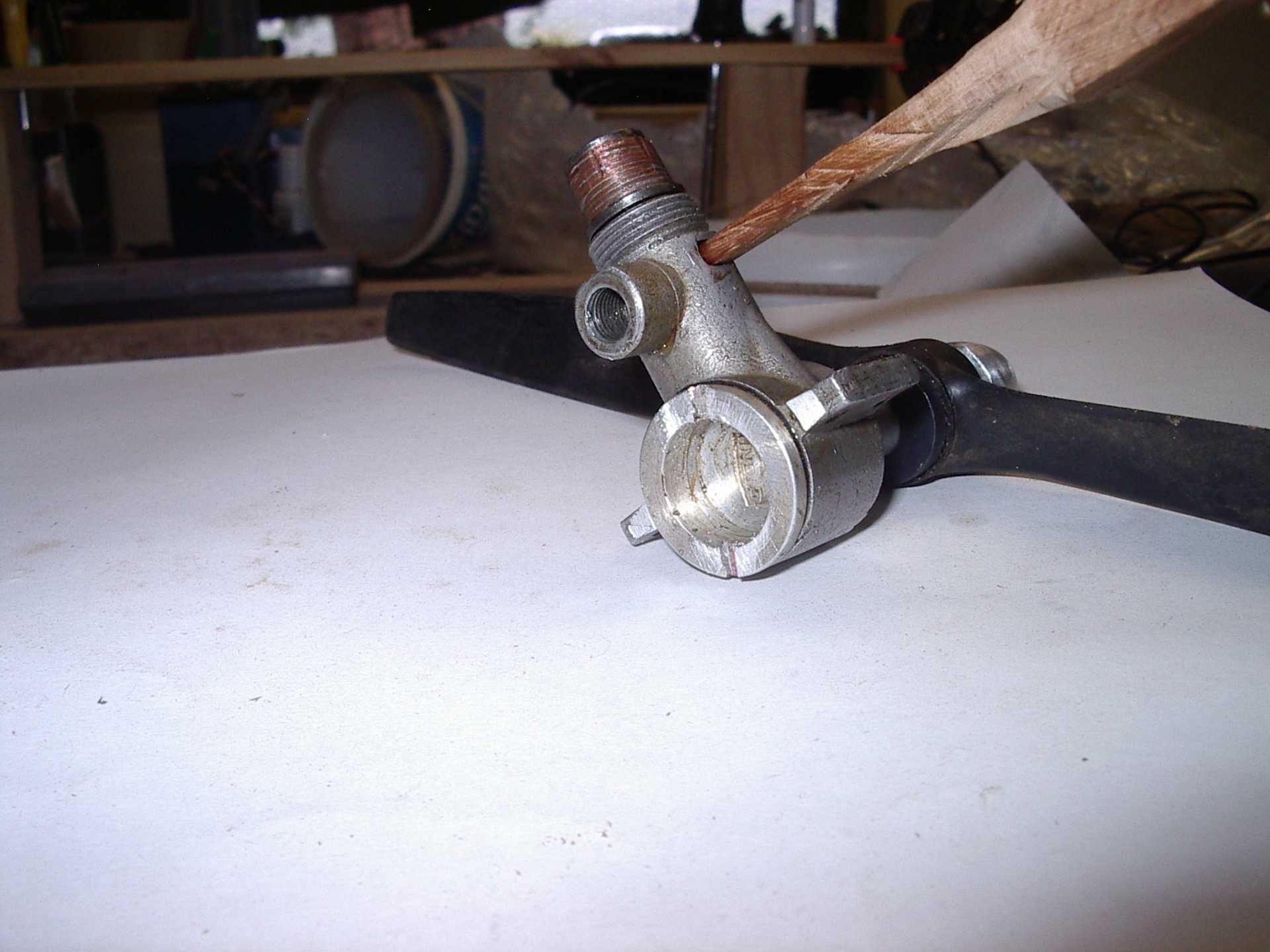

The cylinder must be the right way round.
Those two little holes are opened by the piston skirt when it's close to top dead centre. I was surprised to see they're staggered, I suppose it's an attempt to soften the intake pulse.
No such attempt here to soften the transfer, as the piston reaches bottom dead centre and rams everything into the cylinder.
My little helper, Hex is her name, she's always around my feet so often gets called cooking fat when I fall over her.
Thanks: THE BLACKBIRD, old fart, boz, Squirrelnet
06 Mar 2017 18:06 #62 by Klipkopwildlife
Replied by Klipkopwildlife on topic 2 little Indians
Back plate on, I've cut a piece of hardwood the stop the cylinder from shying away when I tighten the cylinder fins down.
And then the carb is on, I've put a smidgeon of Locktight on the thread, as much to seal as lock.
Thanks: Quorneng, THE BLACKBIRD, old fart, boz, Squirrelnet

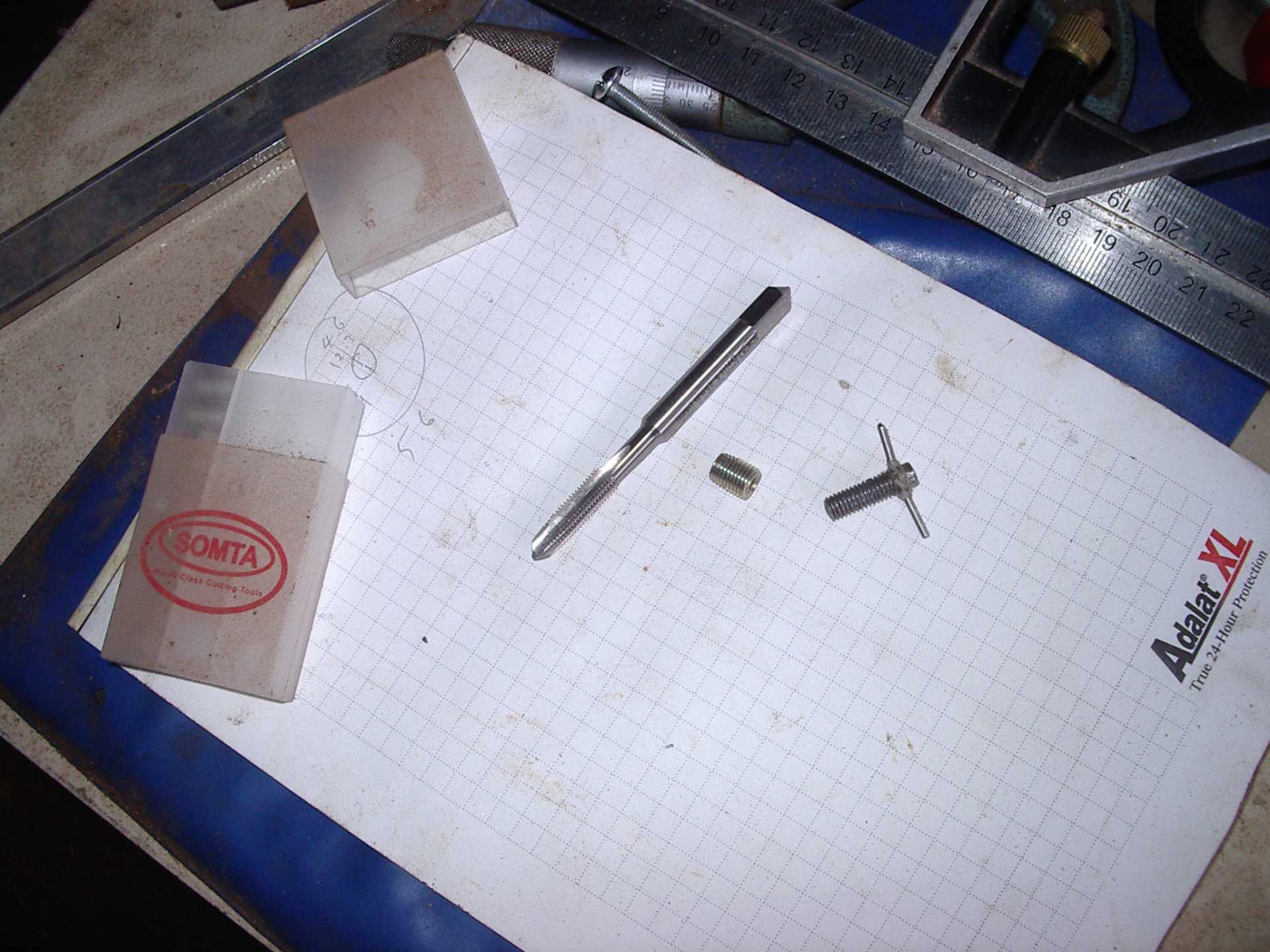

It's obvious that the fin assembly has been modified, I'm guessing the thread for the compression screw stripped.
#2 has a 4BA screw, #1 has a 5mm screw.
I don't have Heli coils in 4mm but I do have this thread repair kit. The outer is about 6.5mm (1/4" Garry) the inner is 4mm
I always try and tap using this method, all too often then tap doesn't go in straight when you're doing it by hand.
07 Mar 2017 08:33 - 07 Mar 2017 08:35 #65 by Klipkopwildlife
Thread repair is in and trimmed back to height.
I've used the old compression screw and spun it down to 4mm, then threaded it and blued it.
And the final part, screwing it down tight using soft jawed pliers and we're ready for a test run.
Last edit: 07 Mar 2017 08:35 by Klipkopwildlife.
