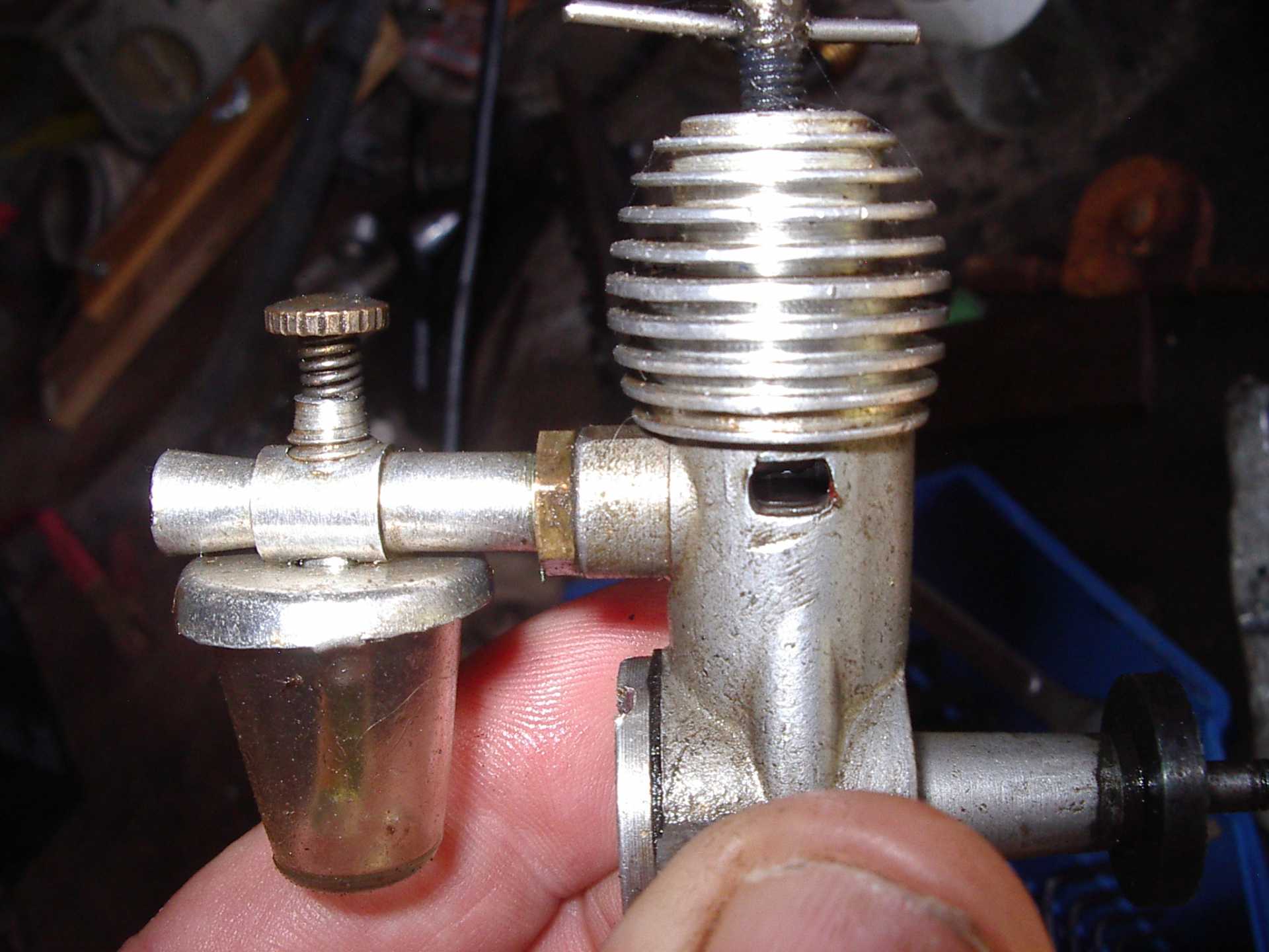

As I said, neither engine will start, I found this with #2
At bottom dead centre the piston is proud of the exhaust port which would indicate an overlong long conrod.
So I checked #1 and found this
You can just see the piston is quite well below the exhaust port at bottom dead centre. A short conrod, or something else?
I'm beginning to wonder if, in the dim and distant past, components from these two engines may have been inadvertently switched!

I would agree with that, a mix up of some sort, barrel, or con rod, "but I don't know much" boz.

Thinking about the piston it could be meehanite which a lot of model pistons were made of..Not sure if that would spread at all. Thought strikes me re con rods/pistons. Just swap the two assys over and check lengths etc again.Could be just a swapover mixup/error.Might also be piston height differences to throw into the equation too.

I doubt the piston not completely clearing the exhaust port would in itself prevent the engine from running but if this means the transfer port holes in the cylinder liner are not on the right place relative to the piston at BDC then it most likely would.
Its the 'transfer' part of the two stroke cycle that is the tricky bit. ;)
