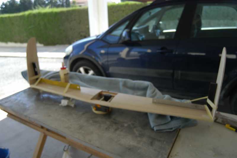

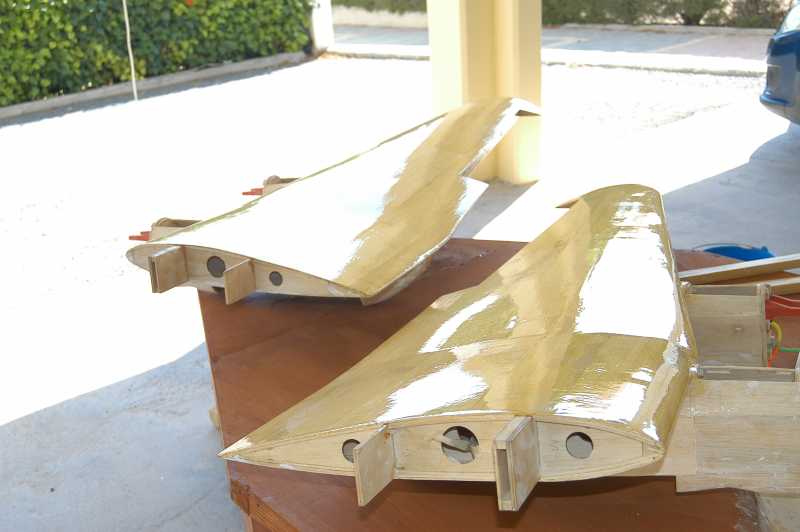

18 Jul 2012 02:48 #49 by THE BLACKBIRD
Replied by THE BLACKBIRD on topic Re: The Cyprus LANCASTER
Glassed the tops of the wings and ailerons today
and did some work on the tail feathers

19 Jul 2012 01:00 #51 by THE BLACKBIRD
I just measured everything from the formers, i built mine different to you i fix all my formers to the bench vertical and in the correct place and did not take it off until the top sheeting was on then i worked everything from the formers it came out spot on.

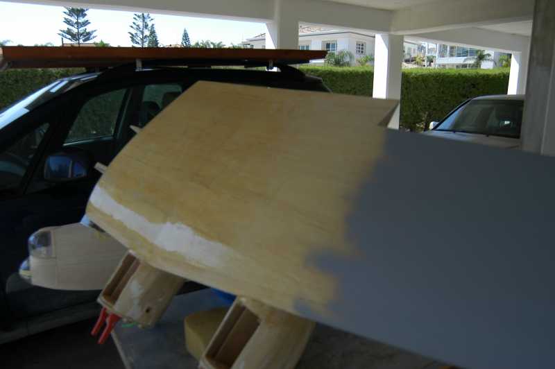

19 Jul 2012 01:25 #52 by THE BLACKBIRD
I between dips in the pool to COOL DOWN done a little more
This show the wing with two coats of glass on it, half of it rubbed down, the shinny bit is not sanded and a prime coat of grey to show up any flaws, i will then rub down the prime coat until it is nearly completely gone then panel line it another prime coat light rub down then top coat.
dont know about rivets on here,
Im still trying to learn the art of finnishing i try different things on each one i do.

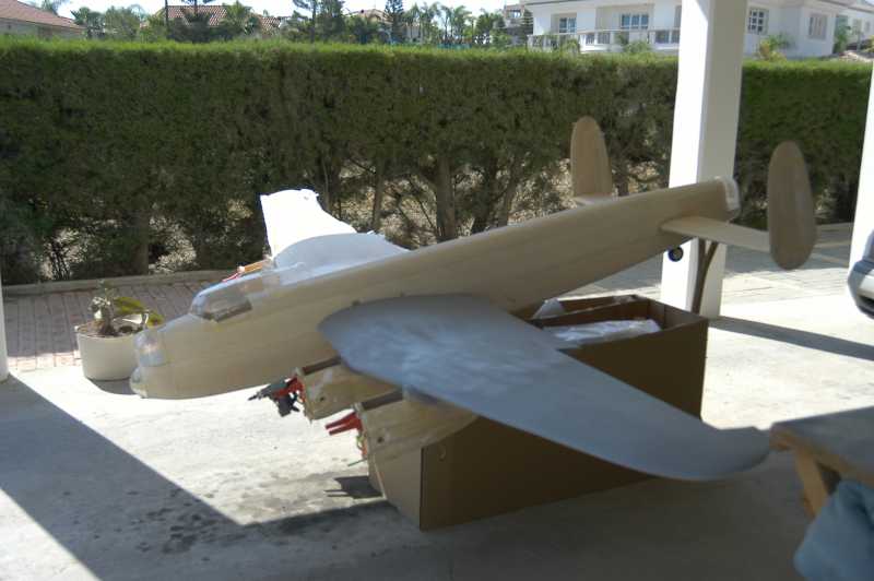

21 Jul 2012 22:23 - 03 Jul 2013 23:43 #55 by THE BLACKBIRD
Had another go at it today, got the wing repaired and did one nacil in glass cloth and resin and the other three in that awful Poly C and heavey weight tissue then im going to give it a coat of resin and ill see how that comes out,
The back is still bad hope it go's before the end of August.
They say lightning never strikes twice in the same place, the dam wind here has stuck again this time the fuselarge took off the bench an finnished up 10m away with a hole in the top and gravel rash. and i had it taped to the bench in light of yesterdays event.
At least i know it flys first the wing and then the fuselarge :) :cheer: :P
