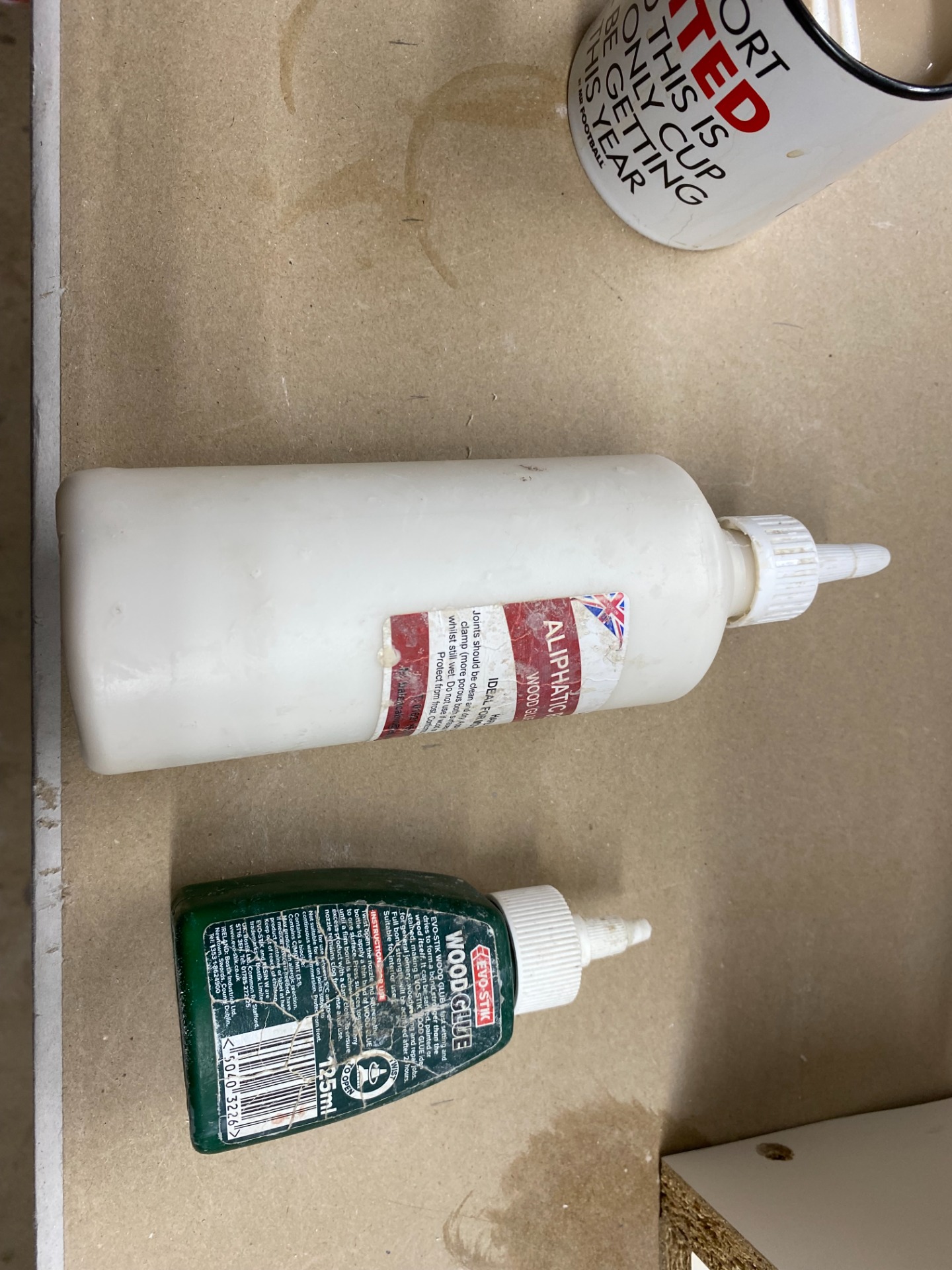

Surprising just how much glue is used to build this
I started with the new large bottle and iv just put all the remaining contents into the small one, it just filled it
Last edit: 09 Jan 2026 14:10 by THE BLACKBIRD.
