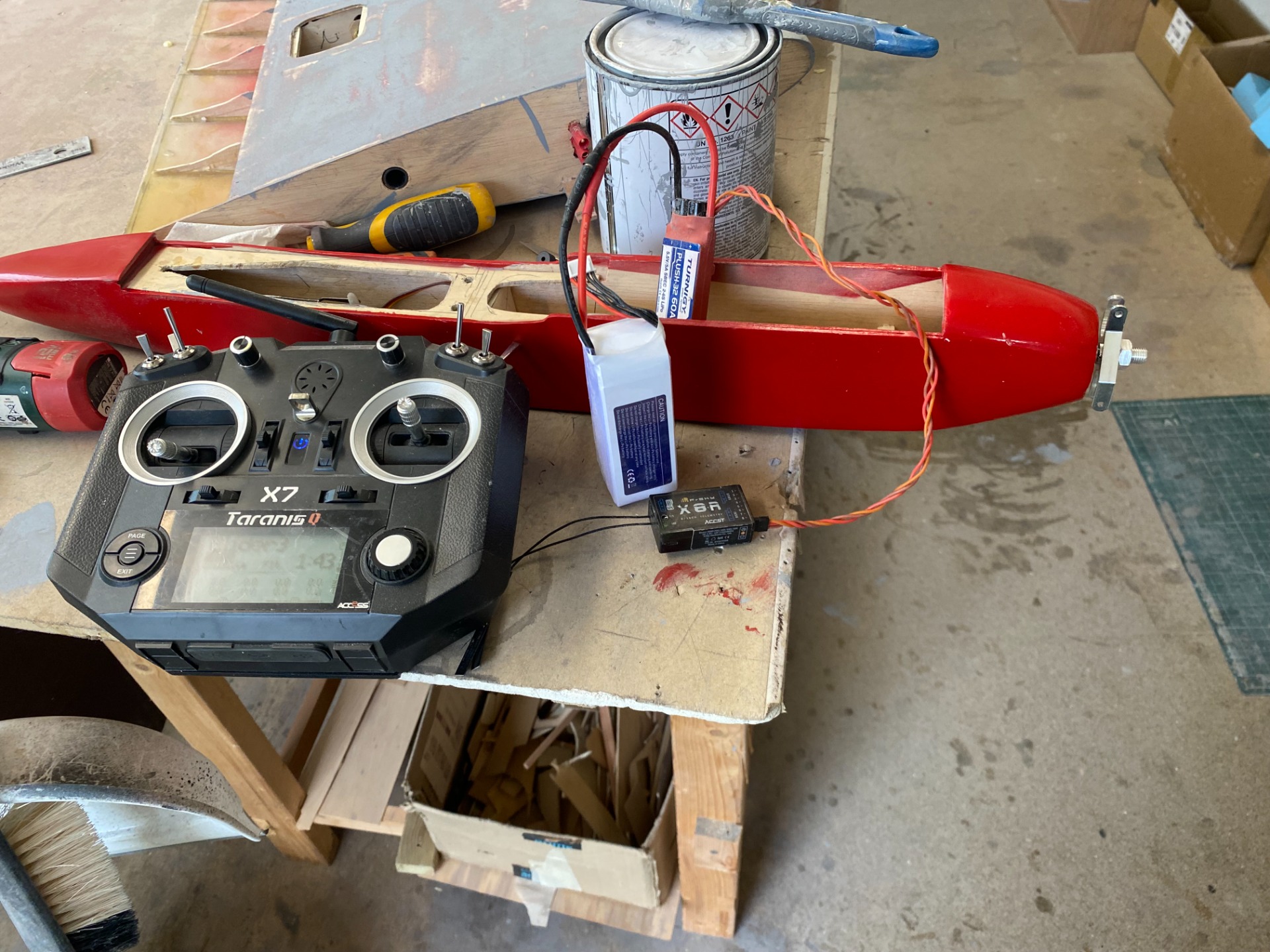

Put the motor and Hobby King ESC in the glider
And nothing   no beeps the only thing that happened was the green led in the RX showed

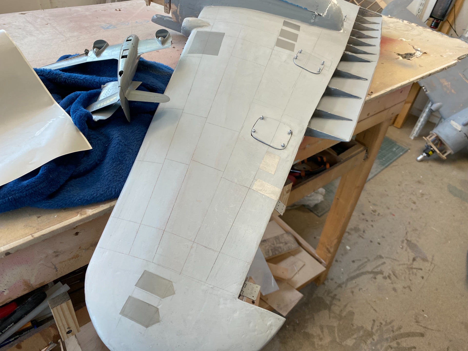

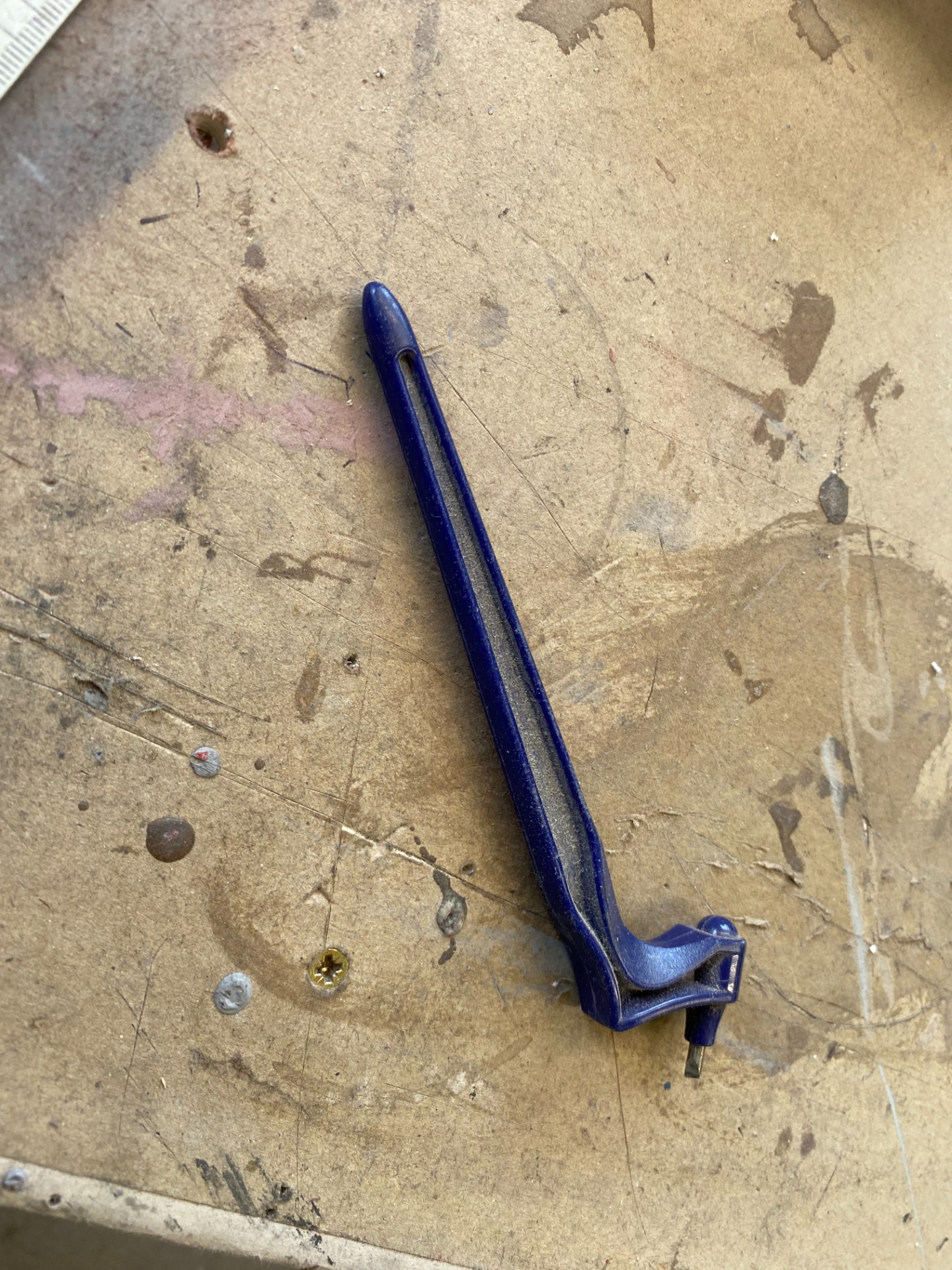

I primed the underside of a wing and flatted it back with 1200 wet and dry then drew the panel lines on with a pencil, i then scribed the lines with a cutting toot iv had for years to cut different shapes
Then added the take off panels

The non-working radio - move the transmitter away from the receiver. It might be too close, and is swamping the thing, so it won't boot up.
