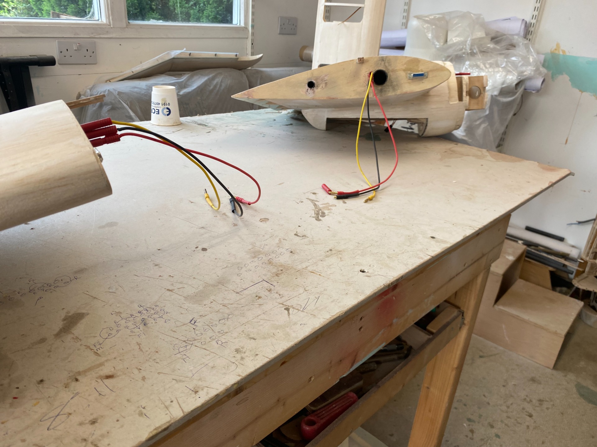

21 Jun 2026 19:06 #143 by THE BLACKBIRD
I covered the elevators in orotex to try to copy the cloth covering on the real ones, its not as good as the solartex used to be but ill see how it turns out
Also did a bit of wiring
And carried on with the glassing of the tail plane

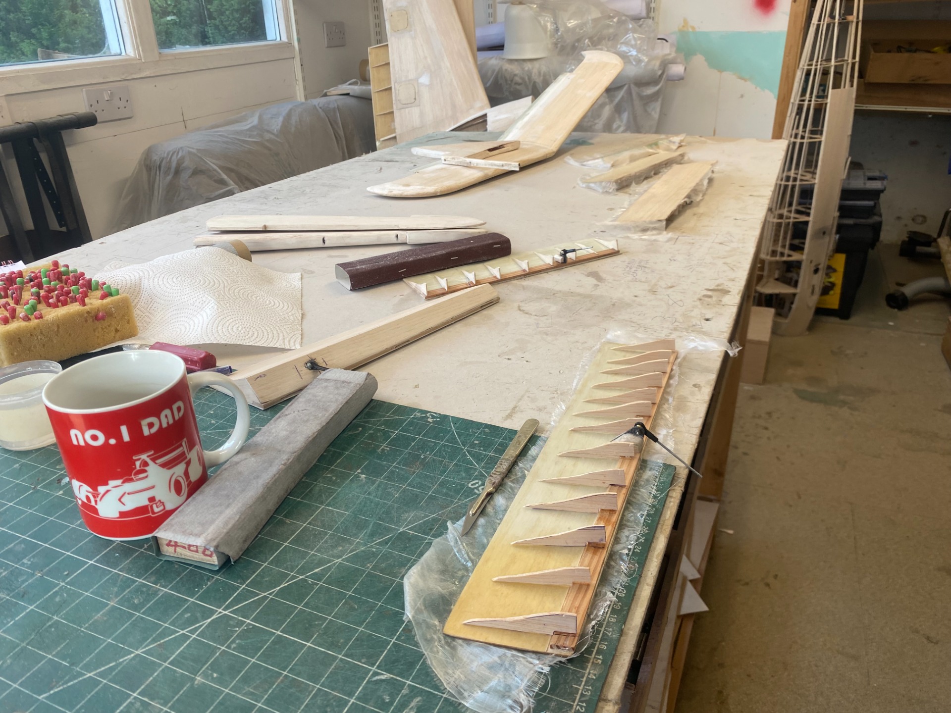

22 Jun 2026 19:30 - 22 Jun 2026 19:32 #144 by THE BLACKBIRD
Im losing it, i ordered some poly resin to cover to foam wingtips with glass, i had some epoxy resin but that eats the foam so last night i did one side of the wingtips with the poly resin and today
Its the poly that eats the foam   i got it the wrong way round
Anyway i cut it off and glued some more on
Been cleaning the edges of the flaps and ailerons where i glassed them ready for the second side to be done
Or a second coat of resin over the glassed side
