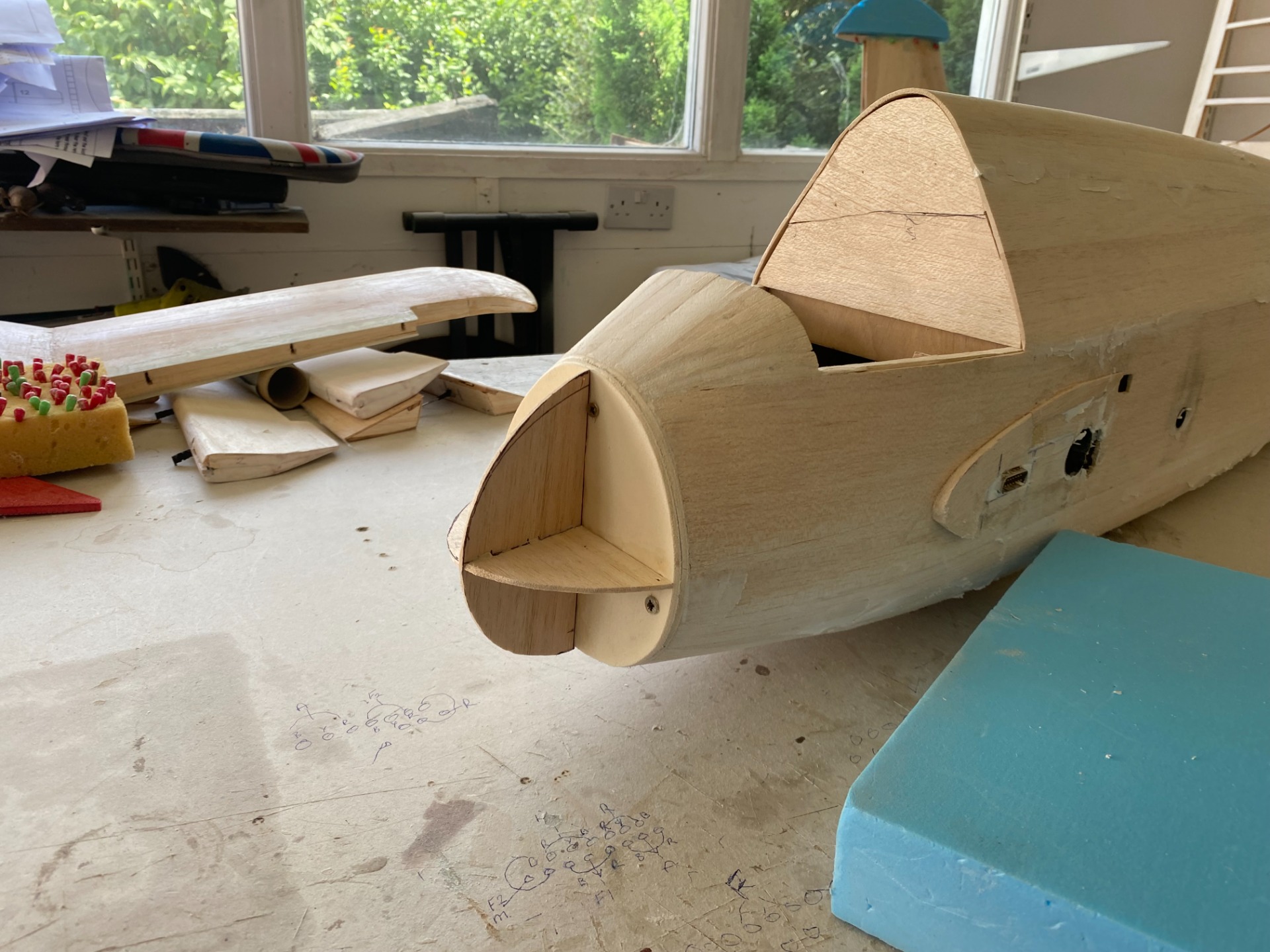

28 Jun 2026 21:11 #154 by THE BLACKBIRD
Iv used the whole of this new bottle of glue on this model alone
must get lighter as it dries out
Started on the nose it will be detachable for access to the batteries and ESCs

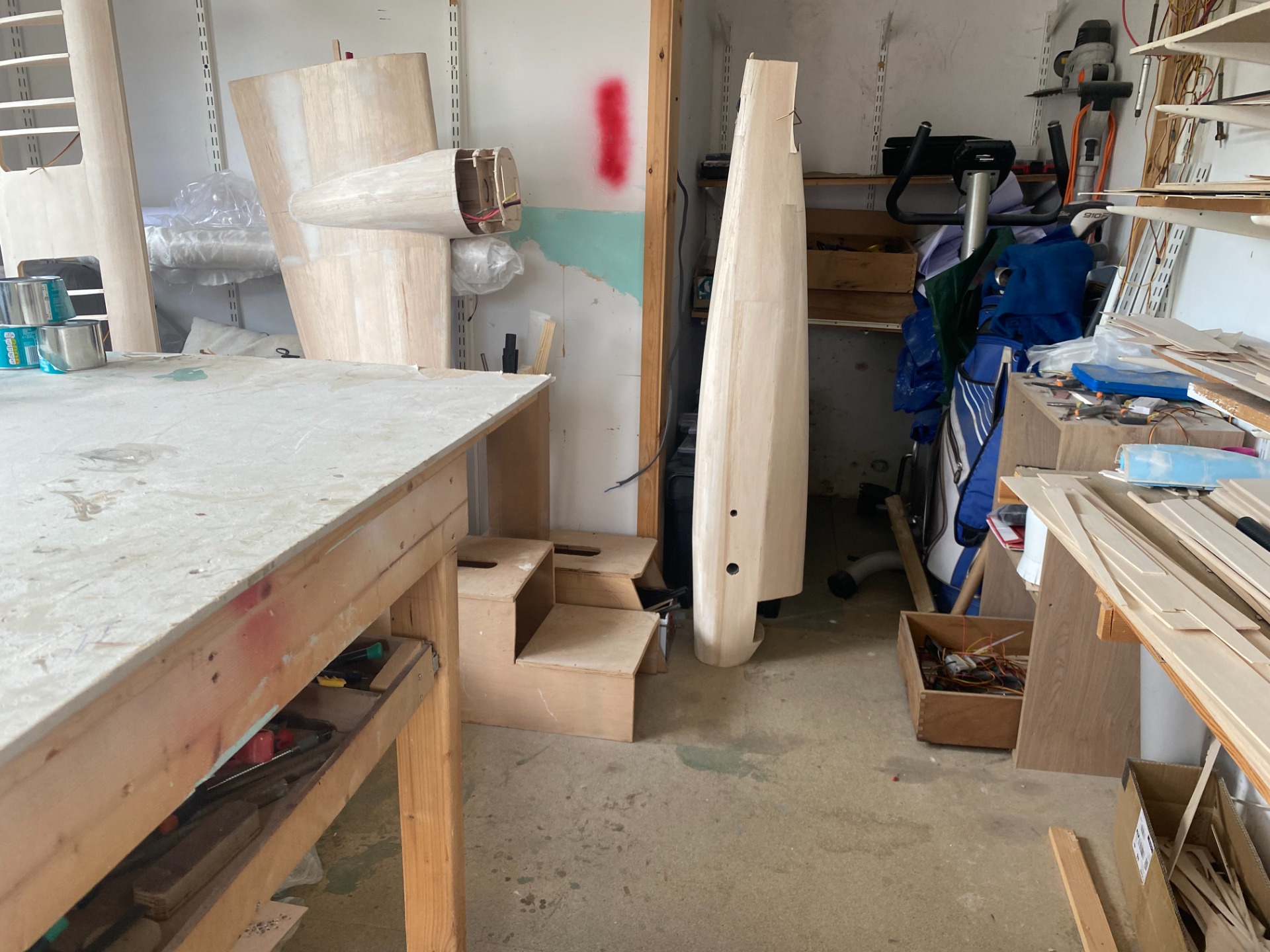

02 Jul 2026 14:27 #163 by THE BLACKBIRD
I got the refund from RC-Mall in China and Leeds model shop want to refund me for the W meter
02 Jul 2026 23:09 #164 by THE BLACKBIRD
Not much to show today i sanded down and filled the 2 air intakes and manage to put my elbow through the top of the wing
And i started anew on the retracts hoping to make a better job of it this time with all new materials

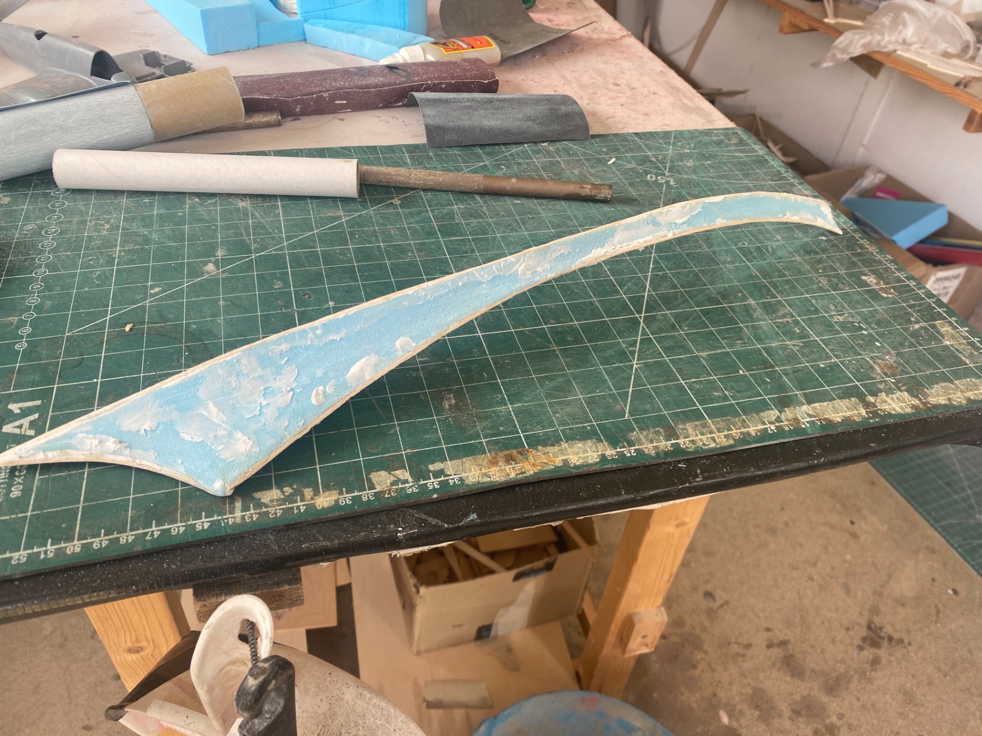

03 Jul 2026 19:24 #165 by THE BLACKBIRD
Thought i would have a go at glassing the underside of a wing
It looks to have come out ok, time will tell
Then i did a bit on the retracts

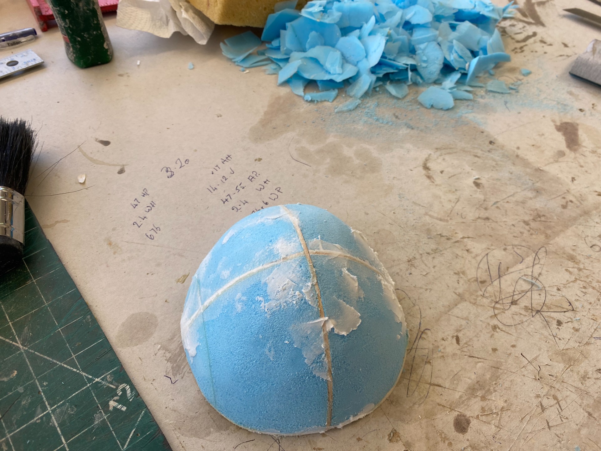

And finally  i prepped the nose cone for making the mould
