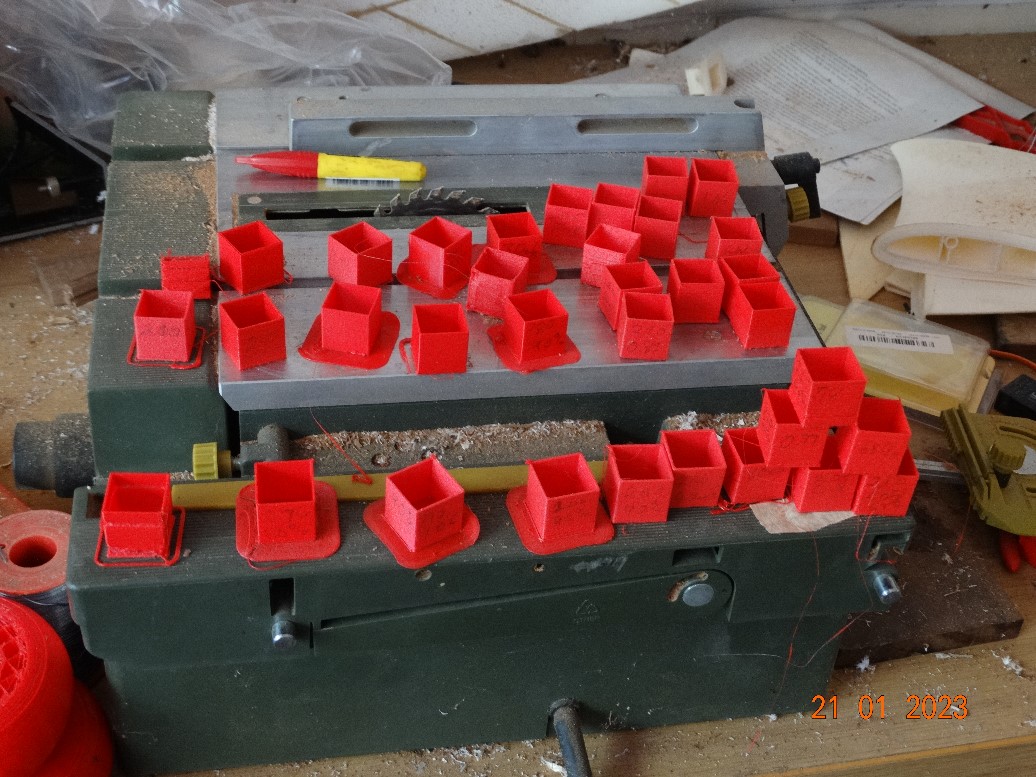

I've been struggling and getting nowhere for about the last 2 weeks. I decided to try a locally produced LW-PLA.
I just can't get it right, I can only get about a 10% reduction in weight. When I try and print anything the feed stops part way through.
I'm at my wits end.
I can't believe I managed to print an entire plane. I'm about to try and use some of my precious Esun LW-PLA, of which I have very little, to see if the problem might be the material.

As you say you have printed a complete and quite big plane so I imagine the Esun LW-PLA will solve your feed problem unless of course you  have changed something!

Let's see, motherboard upgraded to from SKR V1.3 to SKR V1.4, changed the home printed PLA 'X' carriage back to the Anet aluminium one, modified the Anet carriage to take, first my home turned e3d type feed block, then my old e3d feed block. When that didn't work I bought and fitted a new e3d feed block like Simons, I even fitted new Bowden feed pipes. Granted I did find a feed problem with the filament pinch lever loosening over time (3 hours) which I fixed. I have been in regular contact with DaVinci labs over this and they convinced me that the problem was my settings. Others on their web site rave over this stuff. It's called Way Less by a company called Fil X in Cape Town. None of my rolls have any instruction sheet included (as referred to on the spool) but they sent me what should have been in the package. This gives me temperatures and flow rates, any increase in temperature and feeding stops, any decrease in flow rate (to get the required wall thickness (aka weight) and feeding stops.
Load shedding and home commitments don't help of course. I was about to return everything to the specification that I used for the Seagull (a large job) when I I thought, bugger it, let me put the Esun LW-PLA in that I used for the Seagull (still to be maidened)
Eureka! Having been convinced that the was nothing wrong with the new filament the tried and trusted works fine. Thanks for the input Simon, I pre-empted you by about 3 hours.

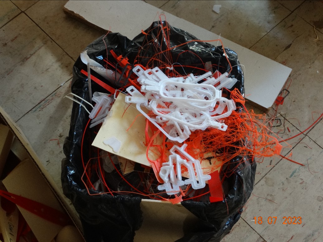

I'm having a problem with the thinner sections of wing, trailing edge printed vertically, I noticed that it tends to happen where the part approaches the front (open) section of the bed so I decided the fully enclose my printer.
We'll see if that works.

Perhaps it is the cooler weather you are having and drafts?
Cold with no drafts here in the winter - sometimes I needed to take a hair dryer to the Prusa Mini because it refused to start when the room was <15C.

Enclosing the bed area didn't help
I noticed that Cura had an update, 5.4 so I've switched to it.
Lots of stringing but usable.
