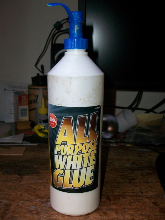

06 Feb 2020 17:47 #53 by Quorneng
Replied by Quorneng on topic Folland Gnat T1
Martin
Being basically mean the stuff I use is "All Purpose White glue" as used in school projects. Its only half the price of the proper stuff from Evo-stick.
This was just £1 from Asda.

06 Feb 2020 18:58 #55 by Specialbuilder
Replied by Specialbuilder on topic Folland Gnat T1
Quorneng, I was thinking of getting just like that! I, too am tight as a canard's derriere.
