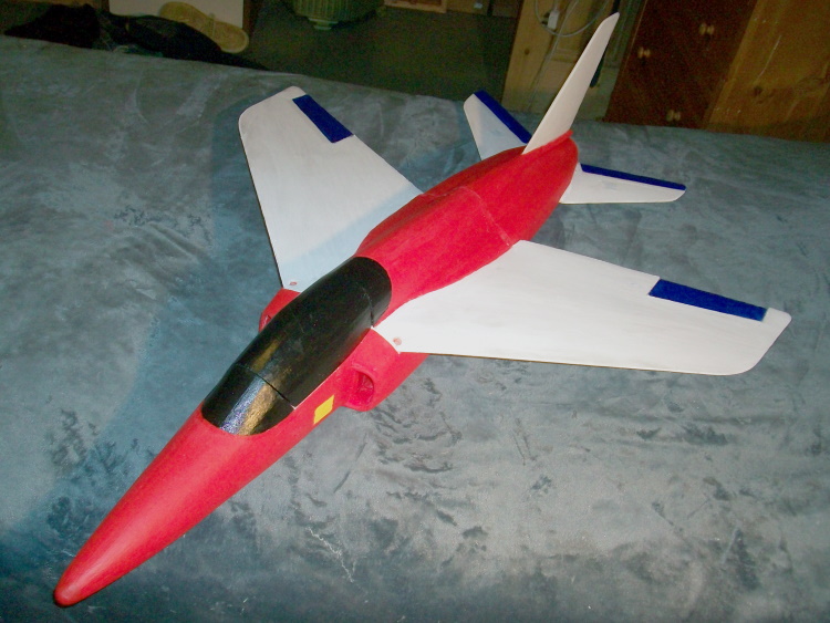

Broke the nose again.
It looks like I seriously misjudged the torque roll on hand launch and it would have helped if I had remembered to switch on the gyro! :woohoo:
The result is it banked to about 45 degrees soon after launch touched a wing tip and still at full power it 'cartwheeled' snapping off the nose rather than crushing it as it did before.
The break is fairly clean on the tension side of the break but significant skin crushing occurred on the compression side. The impact forced the battery forward several inches into the nose damaging formers, but not the skin, as it went. ;)
The only damage to the wing apart from a green stain on the wing tip ;) was to 'strain' 2 of the wing bolt mountings but easily fixed.
Its hard to believe it actually flew before and that was when it had a significant twist in its wing. :P

17 Mar 2020 22:37 - 17 Mar 2020 22:38 #104 by Quorneng
Replied by Quorneng on topic Folland Gnat T1
Slowly 'making good' each side of the break in preparation to gluing the nose back on.
The flat floor, which is also a structural member, is where the gyro rx will sit. The battery will be mounted vertically in the next compartment forward alongside the ESC. Both compartments will be accessible under the removable canopy.
It had better fly next time. I doubt I will be motivated to repair it yet again.:unsure:
